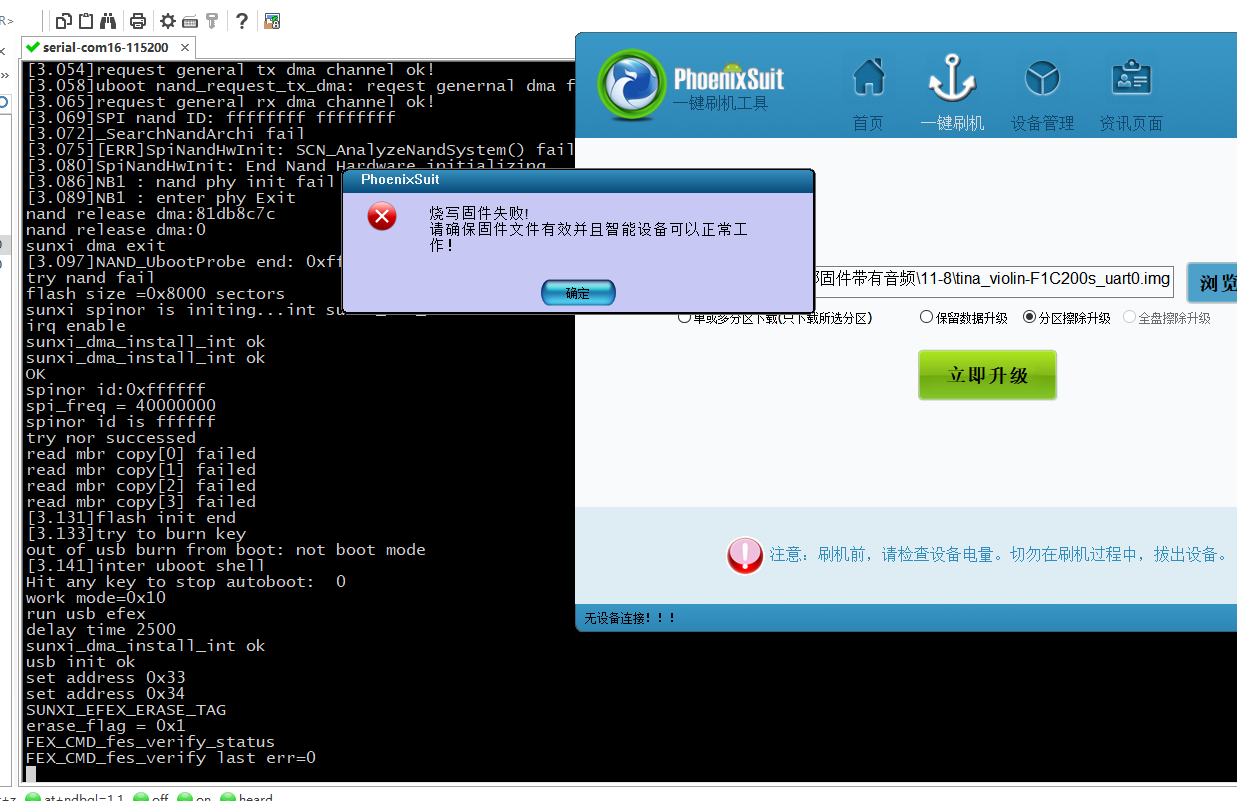

#12 Re: 全志 SOC » 问题求助 tina下播放音频 » 2021-07-15 15:01:54
linux小白 wrote:
哇酷小二 wrote:
你的 tina版本是多少?
烧一个这个试一试:
F1C100s tina3 程序, 请教屏闪是怎么回事?
https://whycan.com/t_3156.html
tina3的,好的,谢谢大佬,我试试看
不行啊,大佬我这烧不进去,用的是荔枝派nano

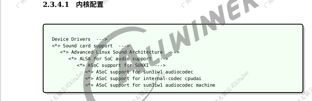

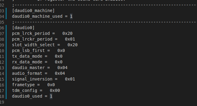

#15 全志 SOC » 问题求助 tina下播放音频 » 2021-07-15 12:57:55
linux小白
回复: 14
求助大佬,有没有大佬知道f1c100s的音频配置,下面是我配置好之后产生的问题,我不太清楚还要什么地方没有配置,我都是按照官方的文档来配置的,进入系统后输入下面的命令,然后又报出打不开驱动的提示
root@TinaLinux:~#
root@TinaLinux:~# aplay -D plughw:0,0 FormatFactoryPart1.wav
Playing WAVE 'FormatFactoryPart1.wav' : Signed 16 bit Little Endian, Rate 44100 Hz, Mono
aplay: pcm_write:1940: write error: I/O error
root@TinaLinux:~#
root@TinaLinux:~# aplay FormatFactoryPart1.wav
ALSA lib pcm_direct.c:1824:(_snd_pcm_direct_get_slave_ipc_offset) Invalid value for card
aplay: main:722: audio open error: No such device
启动日志的信息
[    0.626023] failed to get gpio-spk and gpio_num
[    0.631203] headphonevol:59,spkervol:27,maingain:4,pa_sleep_time:350
[    0.639105] sun3iw1p1-pinctrl pio: missing allwinner,pins property in node daudio0
[    0.647848] sun3iw1p1-pinctrl pio: missing allwinner,pins property in node daudio0

#21 全志 SOC » 请教一下大佬们,关于F1C100S的音频驱动问题 » 2021-04-30 15:32:17
linux小白
回复: 11
求助论坛大佬!!!
有没有大佬弄过tina下的F1C100S的音频驱动配置,
我把Device Drivers->Sound card support->Advanced Linux Sound Architecture->ALSA for audio support->Allwinner SoC Audio support都选上了,还是没法驱动声卡,系统启动时还提示了failed to open for pcm 0,0,但是我在系统内核中并没有找到找到这个驱动选项。
下面系统的启动过程

[    1.847720] failed to get gpio-spk and gpio_num
[    1.852900] headphonevol:59,spkervol:27,maingain:4,pa_sleep_time:350
[    1.860811] sun3iw1p1-pinctrl pio: missing allwinner,pins property in node daudio0
[    1.869561] sun3iw1p1-pinctrl pio: missing allwinner,pins property in node daudio0
[    1.878054] [daudio]request pinctrl handle
[    1.882539] for audio failed
[    1.885971] sunxi-daudio: probe of 1c22000.daudio failed with error -22
[    1.894804] sunxi-internal-codec 1c23c00.codec: ASoC: DAPM unknown pin HPOUTR
[    1.902861] sunxi-internal-codec 1c23c00.codec: ASoC: DAPM unknown pin HPOUTL
[    1.910789] sunxi-internal-codec 1c23c00.codec: ASoC: DAPM unknown pin SPKL
[    1.918566] sunxi-internal-codec 1c23c00.codec: ASoC: DAPM unknown pin SPKR
[    1.926329] sunxi-codec-machine sound.2: ASoC: DAPM unknown pin External Speaker
[    1.934894] sunxi-internal-cpudai 1c23c00.cpudai0-controller: ASoC: pcm constructor failed: -12
[    1.944646] sunxi-codec-machine sound.2: ASoC: can't create pcm SUNXI-CODEC :-12
[    1.952902] sunxi-codec-machine sound.2: ASoC: failed to instantiate card -12
[    1.961203] snd_soc_register_card failed -12
[    1.966076] sunxi-codec-machine: probe of sound.2 failed with error -12
