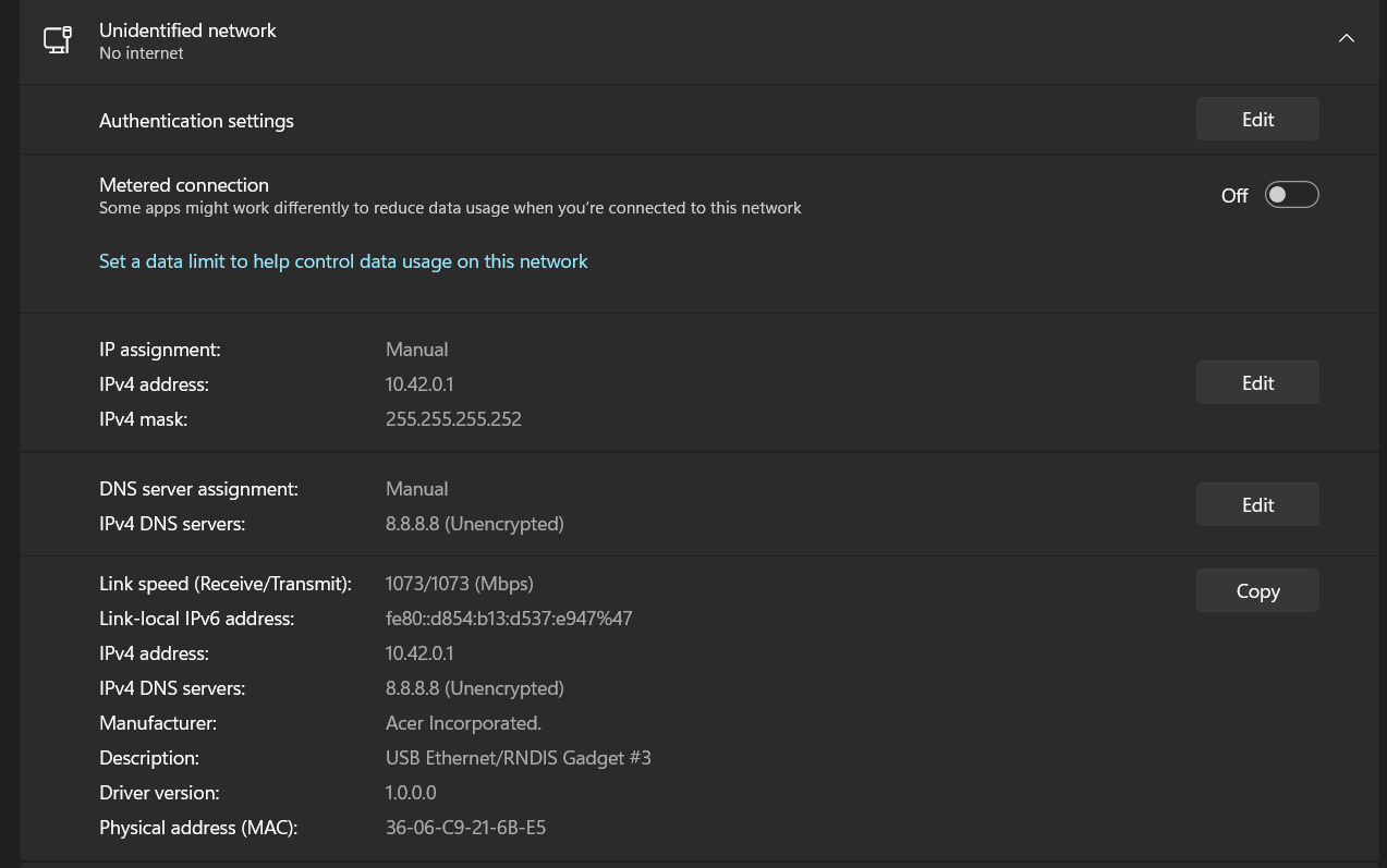

#1 Re: 全志 SOC » problem while activating ssh on mangopi-r3 based on F1C200S » 2022-06-03 01:17:36
disabled other network card on PC?
no but I connected my raspberrypi zero using the same way by assigning static ip and it worked for me.
so I assume the problem in the mangoPi not the pc
I also tried to connect my mangoPi to linux pc and assigning static ip but no change.

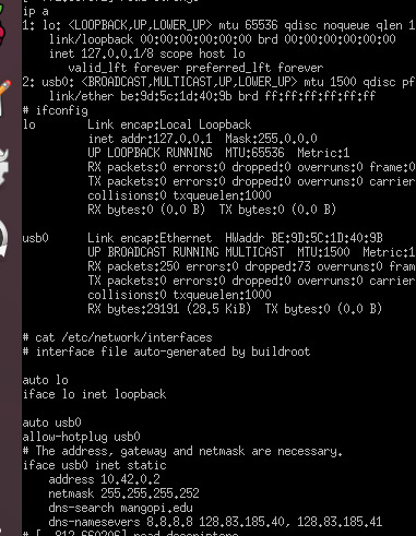

after booting linux
check the usb RNDIS  is working by
 ip a
now, change the file the interfaces file in /etc/network/interfaces
 nano /etc/network/interfaces
auto usb0
#I tried also to comment the following line but it doesn't work.
allow-hotplug usb0
# The address, gateway and netmask are necessary.
iface usb0 inet static
    address 10.42.0.2
    netmask 255.255.255.252
    dns-search mangopi.edu
    dns-namesevers 8.8.8.8 128.83.185.40, 128.83.185.41
the total steps
I set a static ip in windows11

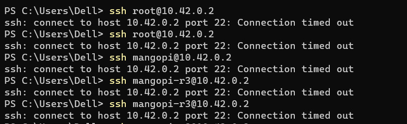

when trying to connect using ssh,  I got that!
also when trying
 ping 10.42.0.2
I got
 Request timed out.
What's the problem?
