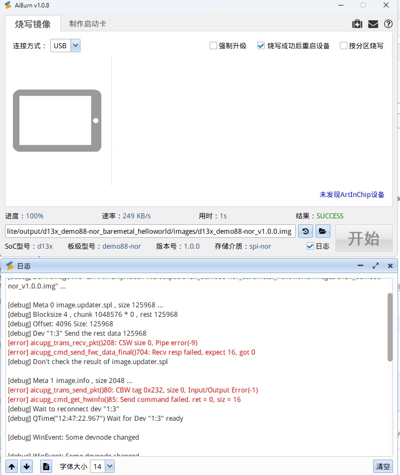

烧录失败问题
前面烧录都正常,今天发现烧录不对,Aiburn显示成功,但是log里面有错误,实际上img也没有烧录进去,还是旧的。
看看是什么问题?

[debug] [2023-12-20 12:41:50] Start burn online ...
[debug] [2023-12-20 12:41:50] Progress range: 0 ~  294912
[debug] [2023-12-20 12:41:50] Burn Image file "E:/ArtinChip/baremetal/output/d13x_demo88-nor_baremetal_helloworld/images/d13x_demo88-nor_v1.0.0.img" ...
[debug] [2023-12-20 12:41:50] Meta 0 image.updater.spl , size 96272 ...
[debug] [2023-12-20 12:41:50] Blocksize 4 , chunk 1048576 * 0 , rest 96272
[debug] [2023-12-20 12:41:50] Offset: 4096 Size: 96272
[debug] [2023-12-20 12:41:50]  Dev "1:3" Send the rest data 96272
[error] [2023-12-20 12:41:51] aicupg_trans_recv_pkt()208:             CSW size 0, Pipe error(-9)
[error] [2023-12-20 12:41:51] aicupg_cmd_send_fwc_data_final()704:    Recv resp failed, expect 16, got 0
[debug] [2023-12-20 12:41:51] Don't check the result of image.updater.spl
[debug] [2023-12-20 12:41:51] Meta 1 image.info , size 2048 ...
[error] [2023-12-20 12:41:51] aicupg_trans_send_pkt()80:              CBW tag 0x41, size 0, Input/Output Error(-1)

[error] [2023-12-20 12:43:36] aicupg_trans_recv_pkt()182:             CBW size 0, Pipe error(-9)
[debug] [2023-12-20 12:43:36] Update "success_cnt" of "2023-12-20"
[debug] [2023-12-20 12:43:36] WinEvent: Some devnode changed
[debug] [2023-12-20 12:43:36] No device available
[debug] [2023-12-20 12:43:37] WinEvent: Some devnode changed
[debug] [2023-12-20 12:43:37] No device available
[debug] [2023-12-20 12:43:38] WinEvent: Some devnode changed
[debug] [2023-12-20 12:43:38] No device available
[debug] [2023-12-20 12:44:18] WinEvent: Some devnode changed
[debug] [2023-12-20 12:44:18] There are "1" device available
[debug] [2023-12-20 12:44:18] Try to connect the ArtInChip device ...
[debug] [2023-12-20 12:44:18] Try to get Usb device hd info...
[debug] [2023-12-20 12:44:18] Boot device1: "0"
[debug] [2023-12-20 12:44:18] Boot device2: "0"
[debug] [2023-12-20 12:44:18] The status of ArtInChip device:  true
[debug] [2023-12-20 12:44:56] Start burn online ...
[debug] [2023-12-20 12:44:56] Progress range: 0 ~  294912
[debug] [2023-12-20 12:44:56] Burn Image file "E:/ArtinChip/baremetal/output/d13x_demo88-nor_baremetal_helloworld/images/d13x_demo88-nor_v1.0.0.img" ...
[debug] [2023-12-20 12:44:56] Meta 0 image.updater.spl , size 96272 ...
[debug] [2023-12-20 12:44:56] Blocksize 4 , chunk 1048576 * 0 , rest 96272
[debug] [2023-12-20 12:44:56] Offset: 4096 Size: 96272
[debug] [2023-12-20 12:44:56]  Dev "1:3" Send the rest data 96272
[error] [2023-12-20 12:44:57] aicupg_trans_recv_pkt()208:             CSW size 0, Pipe error(-9)
[error] [2023-12-20 12:44:57] aicupg_cmd_send_fwc_data_final()704:    Recv resp failed, expect 16, got 0
[debug] [2023-12-20 12:44:57] Don't check the result of image.updater.spl
[debug] [2023-12-20 12:44:57] Meta 1 image.info , size 2048 ...
[error] [2023-12-20 12:44:57] aicupg_trans_send_pkt()80:              CBW tag 0x132, size 0, Input/Output Error(-1)
[error] [2023-12-20 12:44:57] aicupg_cmd_get_hwinfo()85:              Send command failed. ret = 0, siz = 16
[debug] [2023-12-20 12:44:57] Wait to reconnect dev "1:3"
[debug] [2023-12-20 12:44:57] QTime("12:44:57.542") Wait for Dev "1:3" ready
[debug] [2023-12-20 12:44:57] WinEvent: Some devnode changed
[warn ] [2023-12-20 12:44:57] Set upg work mode: 0
[debug] [2023-12-20 12:44:57] Blocksize 1 , chunk 1048576 * 0 , rest 2048
[debug] [2023-12-20 12:44:57] Offset: 0 Size: 2048
[debug] [2023-12-20 12:44:57]  Dev "1:3" Send the rest data 2048
[debug] [2023-12-20 12:44:57] Meta 2 image.target.spl , size 96272 ...
[debug] [2023-12-20 12:44:57] Blocksize 2048 , chunk 1048576 * 0 , rest 96272
[debug] [2023-12-20 12:44:57] Offset: 102400 Size: 96272
[debug] [2023-12-20 12:44:57]  Dev "1:3" Send the rest data 98304
[debug] [2023-12-20 12:44:57] Meta 3 image.target.os , size 96784 ...
[debug] [2023-12-20 12:44:57] Blocksize 2048 , chunk 1048576 * 0 , rest 96784
[debug] [2023-12-20 12:44:57] Offset: 200704 Size: 96784
[warn ] [2023-12-20 12:44:57] Invalid progress position:  "294928"
[debug] [2023-12-20 12:44:57] Burn online successfully!
[debug] [2023-12-20 12:44:57] Reboot the device ...
[error] [2023-12-20 12:44:57] aicupg_trans_recv_pkt()182:             CBW size 0, Pipe error(-9)
[debug] [2023-12-20 12:44:58] Update "success_cnt" of "2023-12-20"
[debug] [2023-12-20 12:44:58] WinEvent: Some devnode changed
[debug] [2023-12-20 12:44:58] No device available
[debug] [2023-12-20 12:45:32] Try to scan the current disk device ...
[debug] [2023-12-20 12:45:37] No device available
[debug] [2023-12-20 12:45:46] Http request: http://aitestserver.artmem.com:8080/api/get_last_version?app_id=1
[error] [2023-12-20 12:45:46] Http request error: QNetworkReply::HostNotFoundError
[debug] [2023-12-20 12:45:49] Http request: http://aitestserver.artmem.com:8080/api/get_last_version?app_id=1
[error] [2023-12-20 12:45:49] Http request error: QNetworkReply::HostNotFoundError
[debug] [2023-12-20 12:45:50] Http request: http://aitestserver.artmem.com:8080/api/get_last_version?app_id=1
[error] [2023-12-20 12:45:50] Http request error: QNetworkReply::HostNotFoundError
[debug] [2023-12-20 12:46:06] WinEvent: Some devnode changed
[debug] [2023-12-20 12:46:06] There are "1" device available
[debug] [2023-12-20 12:46:06] Try to connect the ArtInChip device ...
[debug] [2023-12-20 12:46:06] Try to get Usb device hd info...
[debug] [2023-12-20 12:46:06] Boot device1: "0"
[debug] [2023-12-20 12:46:06] Boot device2: "0"
[debug] [2023-12-20 12:46:06] The status of ArtInChip device:  true
[debug] [2023-12-20 12:46:07] Start burn online ...
[debug] [2023-12-20 12:46:07] Progress range: 0 ~  294912
[debug] [2023-12-20 12:46:07] Burn Image file "E:/ArtinChip/baremetal/output/d13x_demo88-nor_baremetal_helloworld/images/d13x_demo88-nor_v1.0.0.img" ...
[debug] [2023-12-20 12:46:07] Meta 0 image.updater.spl , size 96272 ...
[debug] [2023-12-20 12:46:07] Blocksize 4 , chunk 1048576 * 0 , rest 96272
[debug] [2023-12-20 12:46:07] Offset: 4096 Size: 96272
[debug] [2023-12-20 12:46:07]  Dev "1:3" Send the rest data 96272
[error] [2023-12-20 12:46:08] aicupg_trans_recv_pkt()208:             CSW size 0, Pipe error(-9)
[error] [2023-12-20 12:46:08] aicupg_cmd_send_fwc_data_final()704:    Recv resp failed, expect 16, got 0
[debug] [2023-12-20 12:46:08] Don't check the result of image.updater.spl
[debug] [2023-12-20 12:46:08] Meta 1 image.info , size 2048 ...
[error] [2023-12-20 12:46:08] aicupg_trans_send_pkt()80:              CBW tag 0x1ab, size 0, Input/Output Error(-1)
[error] [2023-12-20 12:46:08] aicupg_cmd_get_hwinfo()85:              Send command failed. ret = 0, siz = 16
[debug] [2023-12-20 12:46:08] Wait to reconnect dev "1:3"
[debug] [2023-12-20 12:46:08] QTime("12:46:08.186") Wait for Dev "1:3" ready
[debug] [2023-12-20 12:46:08] WinEvent: Some devnode changed
[warn ] [2023-12-20 12:46:08] Set upg work mode: 0
[debug] [2023-12-20 12:46:08] Blocksize 1 , chunk 1048576 * 0 , rest 2048
[debug] [2023-12-20 12:46:08] Offset: 0 Size: 2048
[debug] [2023-12-20 12:46:08]  Dev "1:3" Send the rest data 2048
[debug] [2023-12-20 12:46:08] Meta 2 image.target.spl , size 96272 ...
[debug] [2023-12-20 12:46:08] Blocksize 2048 , chunk 1048576 * 0 , rest 96272
[debug] [2023-12-20 12:46:08] Offset: 102400 Size: 96272
[debug] [2023-12-20 12:46:08]  Dev "1:3" Send the rest data 98304
[debug] [2023-12-20 12:46:08] Meta 3 image.target.os , size 96784 ...
[debug] [2023-12-20 12:46:08] Blocksize 2048 , chunk 1048576 * 0 , rest 96784
[debug] [2023-12-20 12:46:08] Offset: 200704 Size: 96784
[warn ] [2023-12-20 12:46:08] Invalid progress position:  "294928"
[debug] [2023-12-20 12:46:08] Burn online successfully!
[debug] [2023-12-20 12:46:08] Reboot the device ...
[error] [2023-12-20 12:46:08] aicupg_trans_recv_pkt()182:             CBW size 0, Pipe error(-9)
[debug] [2023-12-20 12:46:08] Update "success_cnt" of "2023-12-20"
[debug] [2023-12-20 12:46:08] No device available
[debug] [2023-12-20 12:46:56] Current file path: "E:/ArtinChip/baremetal/output/d13x_demo88-nor_baremetal_helloworld/images/d13x_demo88-nor_v1.0.0.img"
[debug] [2023-12-20 12:47:08] Parse the image header from "E:/ArtinChip/luban-lite/output/d13x_demo88-nor_baremetal_helloworld/images/d13x_demo88-nor_v1.0.0.img"
[debug] [2023-12-20 12:47:08] Soc type: "d13x"
[debug] [2023-12-20 12:47:08] Board type: "demo88-nor"
[debug] [2023-12-20 12:47:08] Image version: "1.0.0"
[debug] [2023-12-20 12:47:08] Storage type: "spi-nor"
[debug] [2023-12-20 12:47:08] Storage ID: ""
[debug] [2023-12-20 12:47:08] Meta count: "4"
[debug] [2023-12-20 12:47:08] Refresh the partition tree ...
[debug] [2023-12-20 12:47:08]   Part name: image.target.spl , size: 125968
[debug] [2023-12-20 12:47:08]   Part name: image.target.os , size: 122320
[debug] [2023-12-20 12:47:12] WinEvent: Some devnode changed
[debug] [2023-12-20 12:47:12] There are "1" device available
[debug] [2023-12-20 12:47:12] Try to connect the ArtInChip device ...
[debug] [2023-12-20 12:47:12] Try to get Usb device hd info...
[debug] [2023-12-20 12:47:12] Boot device1: "0"
[debug] [2023-12-20 12:47:12] Boot device2: "0"
[debug] [2023-12-20 12:47:12] The status of ArtInChip device:  true
[debug] [2023-12-20 12:47:22] Start burn online ...
[debug] [2023-12-20 12:47:22] Progress range: 0 ~  376832
[debug] [2023-12-20 12:47:22] Burn Image file "E:/ArtinChip/luban-lite/output/d13x_demo88-nor_baremetal_helloworld/images/d13x_demo88-nor_v1.0.0.img" ...
[debug] [2023-12-20 12:47:22] Meta 0 image.updater.spl , size 125968 ...
[debug] [2023-12-20 12:47:22] Blocksize 4 , chunk 1048576 * 0 , rest 125968
[debug] [2023-12-20 12:47:22] Offset: 4096 Size: 125968
[debug] [2023-12-20 12:47:22]  Dev "1:3" Send the rest data 125968
[error] [2023-12-20 12:47:22] aicupg_trans_recv_pkt()208:             CSW size 0, Pipe error(-9)
[error] [2023-12-20 12:47:22] aicupg_cmd_send_fwc_data_final()704:    Recv resp failed, expect 16, got 0
[debug] [2023-12-20 12:47:22] Don't check the result of image.updater.spl
[debug] [2023-12-20 12:47:22] Meta 1 image.info , size 2048 ...
[error] [2023-12-20 12:47:22] aicupg_trans_send_pkt()80:              CBW tag 0x232, size 0, Input/Output Error(-1)
[error] [2023-12-20 12:47:22] aicupg_cmd_get_hwinfo()85:              Send command failed. ret = 0, siz = 16
[debug] [2023-12-20 12:47:22] Wait to reconnect dev "1:3"
[debug] [2023-12-20 12:47:22] QTime("12:47:22.967") Wait for Dev "1:3" ready
[debug] [2023-12-20 12:47:22] WinEvent: Some devnode changed
[debug] [2023-12-20 12:47:23] WinEvent: Some devnode changed
[warn ] [2023-12-20 12:47:23] Set upg work mode: 0
[debug] [2023-12-20 12:47:23] Blocksize 1 , chunk 1048576 * 0 , rest 2048
[debug] [2023-12-20 12:47:23] Offset: 0 Size: 2048
[debug] [2023-12-20 12:47:23]  Dev "1:3" Send the rest data 2048
[debug] [2023-12-20 12:47:23] Meta 2 image.target.spl , size 125968 ...
[debug] [2023-12-20 12:47:23] Blocksize 2048 , chunk 1048576 * 0 , rest 125968
[debug] [2023-12-20 12:47:23] Offset: 131072 Size: 125968
[debug] [2023-12-20 12:47:23]  Dev "1:3" Send the rest data 126976
[debug] [2023-12-20 12:47:23] Meta 3 image.target.os , size 122320 ...
[debug] [2023-12-20 12:47:23] Blocksize 2048 , chunk 1048576 * 0 , rest 122320
[debug] [2023-12-20 12:47:23] Offset: 258048 Size: 122320
[debug] [2023-12-20 12:47:23]  Dev "1:3" Send the rest data 122880
[warn ] [2023-12-20 12:47:23] Invalid progress position:  "377872"
[debug] [2023-12-20 12:47:23] Burn online successfully!
[debug] [2023-12-20 12:47:23] Reboot the device ...
[error] [2023-12-20 12:47:23] aicupg_trans_send_pkt()104:             CSW tag 0x268, size 0, Pipe error(-9)
[debug] [2023-12-20 12:47:23] Update "success_cnt" of "2023-12-20"
[debug] [2023-12-20 12:47:23] No device available

楼主 #2 2023-12-21 14:16:31
sjshe3326
注册时间: 2020-10-19
已发帖子: 125
积分: 69.5
Re: 烧录失败问题
@ ArtInChip  1.34 工具哪里下?
换了个空的FLASH又可以下了 奇怪。

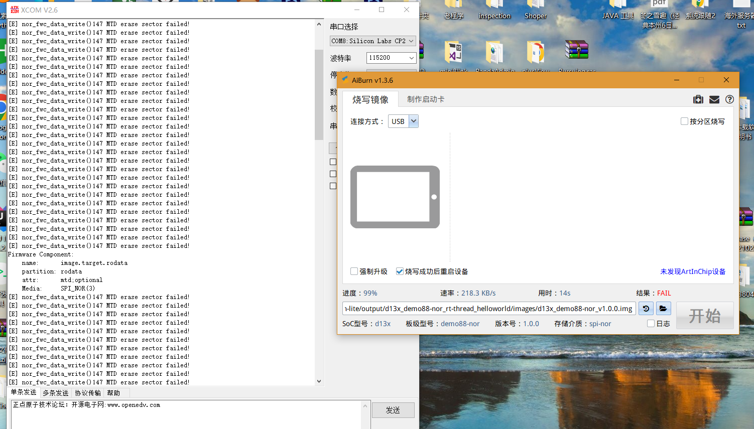

#4 2024-01-23 11:37:23
已发帖子: 1,409
积分: 1373.5
Re: 烧录失败问题
我也遇到了类似问题,gitee上下载的1.36,板子是d133cbs, w25q128, 编译时,lunch 4, m, lunch6, m.
第一次烧录需要39s。
现在每次烧录是2s,显示成功了,但是我修改源码,在application/os/helloword/main.c,加入了while(1)循环,里面加了些rt_kprintf()语句,然后调用rt_thread_delay(1000),觉得应该是每秒打印信息,结果烧录后却没有。
感觉只是执行了第一次烧录的程序,后来的烧录显示成功,但实际上没烧录进去...

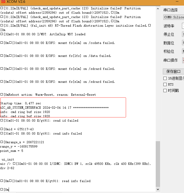

ps显示线程列表,看到有gt911和alarmsvc线程,找到这两个的启动相关注释掉:
// INIT_DEVICE_EXPORT(rt_hw_gt911_port);
// INIT_PREV_EXPORT(rt_alarm_system_init);
结果烧录后,ps里还能看到这两个.
启动信息如下:
tinySPL [Built on Jan 22 2024 08:57:26]
[W] usbh_get_connect_id()107 usb 0 port change wait failed.
[E] main()137 Not find udisk.
Reboot action: Warm-Reset, reason: External-Reset
Firmware Component:
    partition:
    attr:      required
    Media:     RAM(0)
qspi0 freq (input): 100000000Hz
qspi0 freq ( bus ): 50000000Hz
qspi0 freq ( bus ): 100000000Hz
Firmware Component:
    partition: spl
    attr:      mtd;required
    Media:     SPI_NOR(3)
Firmware Component:
    partition: os
    attr:      mtd;required
    Media:     SPI_NOR(3)
Firmware Component:
    partition: rodata
    attr:      mtd;optional
    Media:     SPI_NOR(3)
Going to reboot ...

烧录信息如下:
[debug] Software Version: "1.3.6"
[debug] Machine Name: "DESKTOP-HQF1R40"
[debug] System Name: "Windows 10 (10.0)"
[debug] CPU Architecture: "x86_64"
[debug] Parse the image header from "F:/MCU/ArtinChip/luban-lite/output/d13x_demo88-nor_rt-thread_helloworld/images/d13x_demo88-nor_v1.0.0.img"
[debug] Soc type: "d13x"
[debug] Board type: "demo88-nor"
[debug] Image version: "1.0.0"
[debug] Storage type: "spi-nor"
[debug] Storage ID: ""
[debug] Meta count: "5"
[debug] Refresh the partition tree ...
[debug] Part name: image.target.spl , size: 130320
[debug] Part name: image.target.os , size: 698716
[debug] Part name: image.target.rodata , size: 2093056
[debug] Current connect type: 0
[debug] No device available
[debug] WinEvent: Some devnode changed
[debug] There are "1" device available
[debug] Try to connect the ArtInChip device "1:3-1" ...
[debug] Try to get Usb device hd info...
[debug] Get Usb device hd info success
[debug] The status of ArtInChip device: true
[debug] Start burn online ...
[debug] Progress range: 0 ~ 3055616
[debug] Burn Image file "F:/MCU/ArtinChip/luban-lite/output/d13x_demo88-nor_rt-thread_helloworld/images/d13x_demo88-nor_v1.0.0.img" ...
[debug] Meta 0 image.updater.spl , size 130320 ...
[debug] Blocksize 4 , chunk 1048576 * 0 , rest 130320
[debug] Offset: 4608 Size: 130320
[debug] Dev "1:3-1" Send the rest data 130320
[error] aicupg_trans_recv_pkt()208: CSW size 0, Pipe error(-9)
[error] aicupg_cmd_send_fwc_data_final()777: Recv resp failed, expect 16, got 0
[debug] Don't check the result of image.updater.spl
[debug] Meta 1 image.info , size 2048 ...
[error] aicupg_trans_send_pkt()80: CBW tag 0x51, size 0, Pipe error(-9)
[error] aicupg_cmd_get_hwinfo()106: Send command failed. ret = 0, siz = 16
[debug] Wait to reconnect dev "1:3-1"
[debug] QTime("02:21:30.613") Wait for Dev "1:3-1" ready
[warn ] Set upg work mode: 0
[debug] Blocksize 1 , chunk 1048576 * 0 , rest 2048
[debug] Offset: 0 Size: 2048
[debug] Dev "1:3-1" Send the rest data 2048
[debug] Meta 2 image.target.spl , size 130320 ...
[debug] Blocksize 2048 , chunk 1048576 * 0 , rest 130320
[debug] Offset: 135680 Size: 130320
[debug] Meta 3 image.target.os , size 698716 ...
[debug] Blocksize 2048 , chunk 1048576 * 0 , rest 698716
[debug] Offset: 266752 Size: 698716
[debug] Dev "1:3-1" Send the rest data 698716
[debug] Meta 4 image.target.rodata , size 2093056 ...
[debug] Blocksize 2048 , chunk 1048576 * 1 , rest 1044480
[debug] Offset: 967168 Size: 2093056
[debug] Dev "1:3-1" Send chunk 0 ...
[debug] Dev "1:3-1" Send the rest data 1044480
[debug] Burn online successfully!
[debug] Insert statistic of "2024-01-23"
[debug] Reboot the device ...
[error] aicupg_trans_send_pkt()104: CSW tag 0xbe, size 0, Pipe error(-9)

usb烧录时,会有这两个报错:
[error] aicupg_trans_send_pkt()80: CBW tag 0x654, size 0, Pipe error(-9)
[debug] QTime("06:35:22.073") Wait for Dev "1:3-1" ready
怀疑是spi的问题。
看了下,spi0的cs,wp,hold三个管脚各接10k电阻上拉到3.3V。spi线没有走灯长,不过spi flash离d133很近,线走的不长。
我以为是spi0设置速度的问题,看了下,默认是100M最大速度,我修改成了1M最大速度,没效果。
怀疑是ldo电压的问题。
又看论坛其他网友又通过配置ldo1x和ldo18解决的,看了下默认配置,默认打开ldo18(7)关闭ldo1x的。
修改为,打开ldo1x(4),打开ldo18(3),没效果。
修改为,关闭ldo1x,打开ldo18(3),没效果。
修改为,关闭ldo1x,关闭ldo18,无没效果。
我板子是有独立的dc/dc电路提供1.8V和1.1V的,基本是参考官方的那个图纸画的。
最近编辑记录 Gentlepig (2024-01-23 15:00:51)

用示波器测量了下,dc/dc 1.1V纹波相当的大,是负载太重或者太轻?。目前关闭了芯片自身的ldo18和ldo1x输出。
最近编辑记录 Gentlepig (2024-01-23 17:31:57)
#8 2024-01-24 10:25:22
已发帖子: 1,409
积分: 1373.5
Re: 烧录失败问题
我将1.1V dc/dc的使能管脚的电阻去掉,此时dc/dc应该不工作了,测量1.1V这里,测试出1.2V电压,但是不稳定,应该是启动后按配置关闭ldo1x输出,然后反复重启。
让芯片进入boot状态,此时1.2V稳定了,那么怀疑是boot状态,默认ldo1x输出1.2V。而我的dc/dc供电是1.1V,这样上电时,dc/dc输出有1.2V电压,让dc/dc没稳定工作,造成了很大的纹波?
另,几个默认配置,都是关闭LDO1X,打开LDO18,而且LDO18配置为7,查手册,7对应是1.92V,3才是1.80V。
另,虽然LDO1X默认没打开,但是打开后,默认配置为6,6对应1.20V, 4才对应1.10V.
猜测,boot状态下,ldo1x和ldo18都是打开的,而且电压是1.20V和1.92V,都比推荐的外部供电电压值高。
我将dc/dc1.1V使能,更改电阻使输出变为1.2V。结果上电后,虽然能进系统,但是示波器测量1.2V还是有很大的纹波。
烧录功能虽然显示success,但实际运行的还是之前的程序。
3.3V  纹波410mV
1.8V 纹波170mV
1.2V 纹波410mV
dc/dc电路布局有问题?我测量了下之前画的t113-s3板子,3路dc/dc电路输出纹波大概在130mV左右。都没这么高。
两个板子的dc/dc部分,都是用的sy8088,布局基本没变。
以上情况,是两个板子都用同一个usb供电时测得的。
最近编辑记录 Gentlepig (2024-01-24 11:26:57)

第一次下载的程序里,main函数里我加入了while循环里面定时打印信息,在串口可以看到。
修改了程序,把这部分注释掉,编译,再次下载,花费了38秒,显示烧录成功。

既然这个板子无法烧录成功,就打算用rtt的sf命令擦除flash。结果没成功:
aic /> sf bench yes
Erasing the sf_cmd 16777216 bytes data, waiting...
Erase benchmark success, total time: 0.000S.
Writing the sf_cmd 16777216 bytes data, waiting...
Write benchmark success, total time: 5.279S.
Reading the sf_cmd 16777216 bytes data, waiting...
Data check ERROR! Please check you flash by other command.
Read sf_cmd failed, already rd for 0 bytes, read 256 each time
Read benchmark has an error. Error code: 3.
This flash operate has an error. Error code: 3.
aic />
查看flash状态寄存器:
aic /> sf status
The sf_cmd flash status register current value is 0xFC.
aic />
查手册,倒数第二位是写保护位,目前是0,未开启写保护。
通过sf read可以读flash内容:
Read the sf_cmd flash data success. Start from 0x00000000, size is 1000. The data is:
Offset (h) 00 01 02 03 04 05 06 07 08 09 0A 0B 0C 0D 0E 0F
[00000000] 41 49 43 20 45 3C 01 11 01 00 01 00 10 3B 00 00 AIC E<.......;..
[00000010] 00 00 00 00 00 00 00 00 00 00 10 30 00 01 10 30 ...........0...0
[00000020] 00 00 00 00 00 00 00 00 00 3B 00 00 10 00 00 00 .........;......
[00000030] 00 00 00 00 00 00 00 00 00 00 00 00 00 00 00 00 ................
[00000040] C0 39 00 00 B0 00 00 00 00 01 00 00 B0 38 00 00 .9...........8..
[00000050] 00 3C 00 00 00 00 00 00 00 00 00 00 00 00 00 00 .<..............
[00000060] 00 00 00 00 00 00 00 00 00 00 00 00 00 00 00 00 ................
[00000070] 00 00 00 00 00 00 00 00 00 00 00 00 00 00 00 00 ................
[00000080] 00 00 00 00 00 00 00 00 00 00 00 00 00 00 00 00 ................
[00000090] 00 00 00 00 00 00 00 00 00 00 00 00 00 00 00 00 ................
[000000A0] 00 00 00 00 00 00 00 00 00 00 00 00 00 00 00 00 ................
[000000B0] 00 00 00 00 00 00 00 00 00 00 00 00 00 00 00 00 ................
[000000C0] 00 00 00 00 00 00 00 00 00 00 00 00 00 00 00 00 ................
[000000D0] 00 00 00 00 00 00 00 00 00 00 00 00 00 00 00 00 ................
[000000E0] 00 00 00 00 00 00 00 00 00 00 00 00 00 00 00 00 ................
[000000F0] 00 00 00 00 00 00 00 00 00 00 00 00 00 00 00 00 ................
[00000100] 50 42 50 20 98 D1 9D DD 97 02 00 00 93 82 82 0F PBP ............
[00000110] 23 A0 82 00 23 A2 92 00 23 A4 22 01 23 A6 32 01 #...#...#.".#.2.
[00000120] 23 A8 42 01 23 AA 52 01 23 AC 62 01 23 AE 72 01 #.B.#.R.#.b.#.r.
[00000130] 23 A0 82 03 23 A2 92 03 23 A4 A2 03 23 A6 B2 03 #...#...#...#...
[00000140] 23 A8 22 02 23 AA 12 02 23 AC A2 02 23 AE B2 02 #.".#...#...#...
通过sf write写,写0或者写0xff,再读出来,还是上边这些数据。
写不成功,但又没开启写保护,奇怪了。
有问题的这个板子,通过rtt的sf status命令,可以读spi flash的状态寄存器,是0xFC,而另一个正常的板子,读出来是0x00.
通过sf status 0  0 将状态寄存器也改为0x00,然后就可以正常烧录了。
这是解决办法,问题的原因不明。另,如果烧录的不是rtt版本的程序,不知道该用什么办法来解决了。

通过sf status 0 0这个命令,将问题板的spi flash状态寄存器也修改为0x00,就可以继续烧录了。
问题原因不明,rtt环境下可以通过这个方法解决。裸机环境下就不知道怎么解决了。

有时候提示烧录失败,程序也会运行成功!换了新flash就不再提示烧录失败了!由此可以判断烧录提示失败有可能flash造成的,

不知道我买的SY8088iaac 有问题还是怎么的 有两片1.8V有问题,之前3.3V 好好的,也坏掉了
均出现烧录失败的问题 都是供电导致的
这个是焊接问题 虚焊导致的,板子都没问题了
