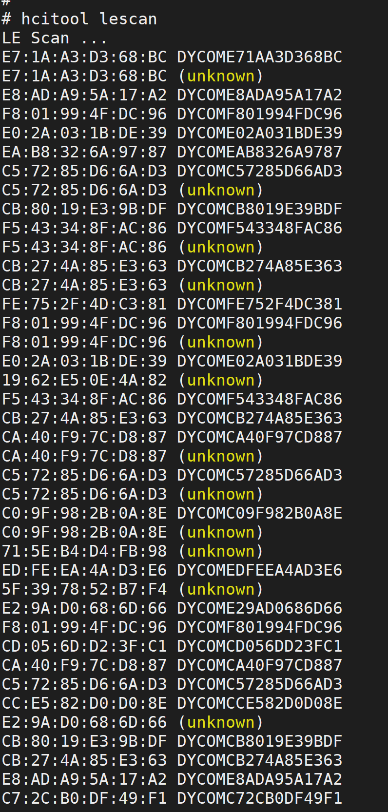

弄了个极度经典版的 hcitool.c :

精简了一下,可以一直搜索附近的BLE设备

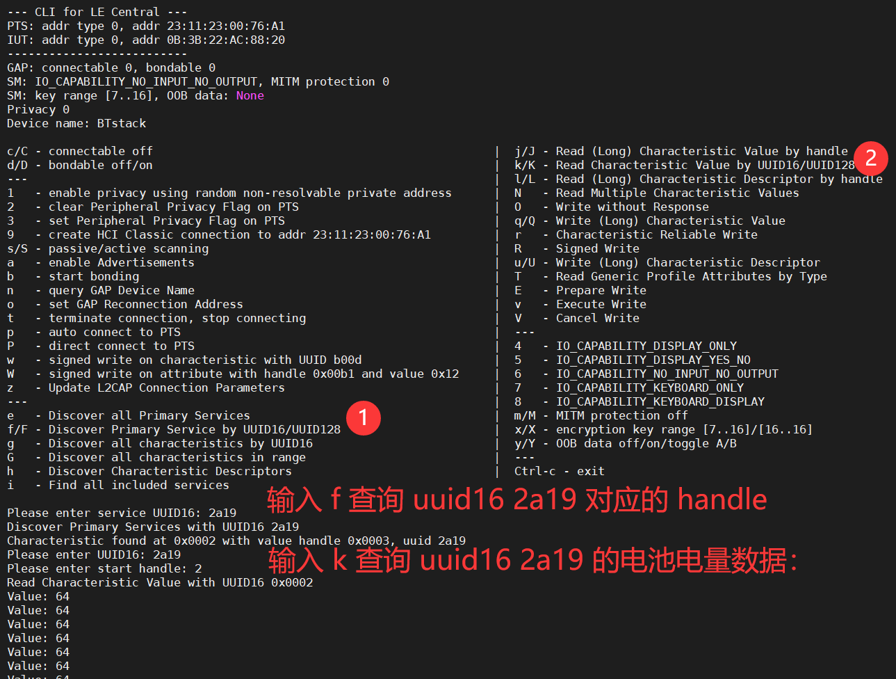

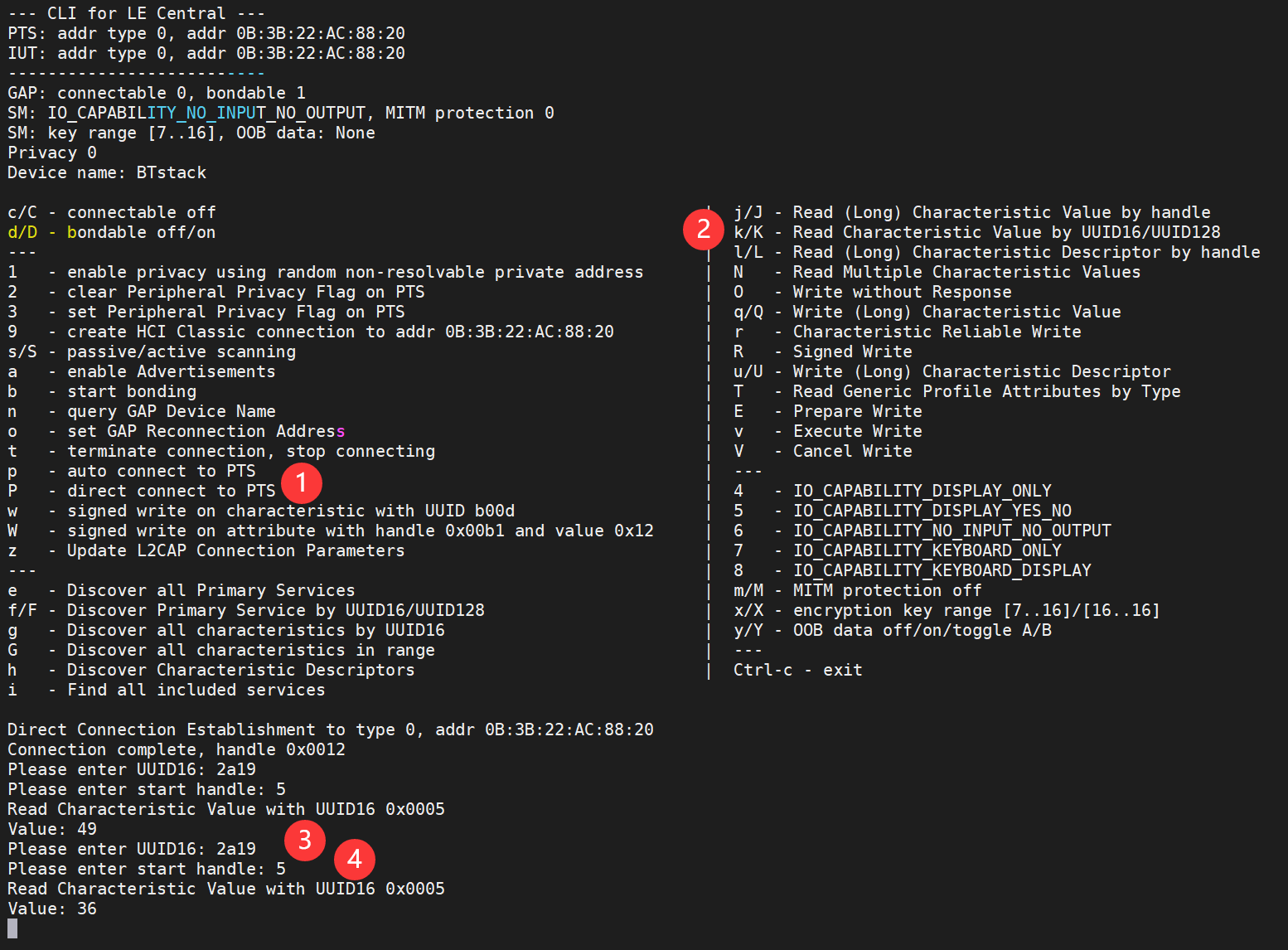

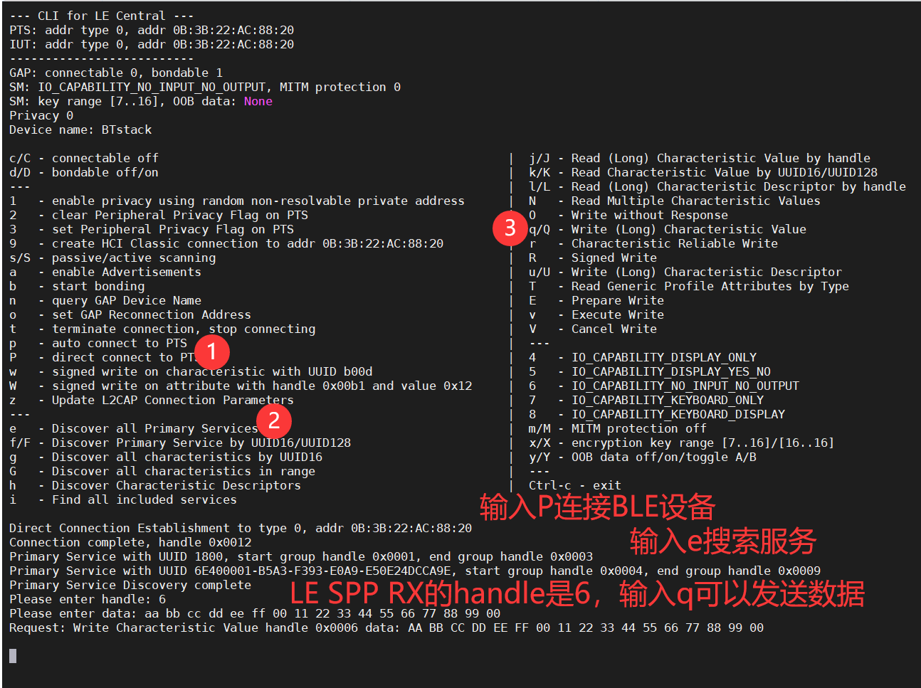

先输入P执行连接,
运行 btstack 的测试程序:ble_central_test -u /dev/ttyS1
楼主 #9 2023-12-31 16:31:32
memory
注册时间: 2021-08-11
已发帖子: 708
积分: 683
Re: ble scan 扫描不到所有设备

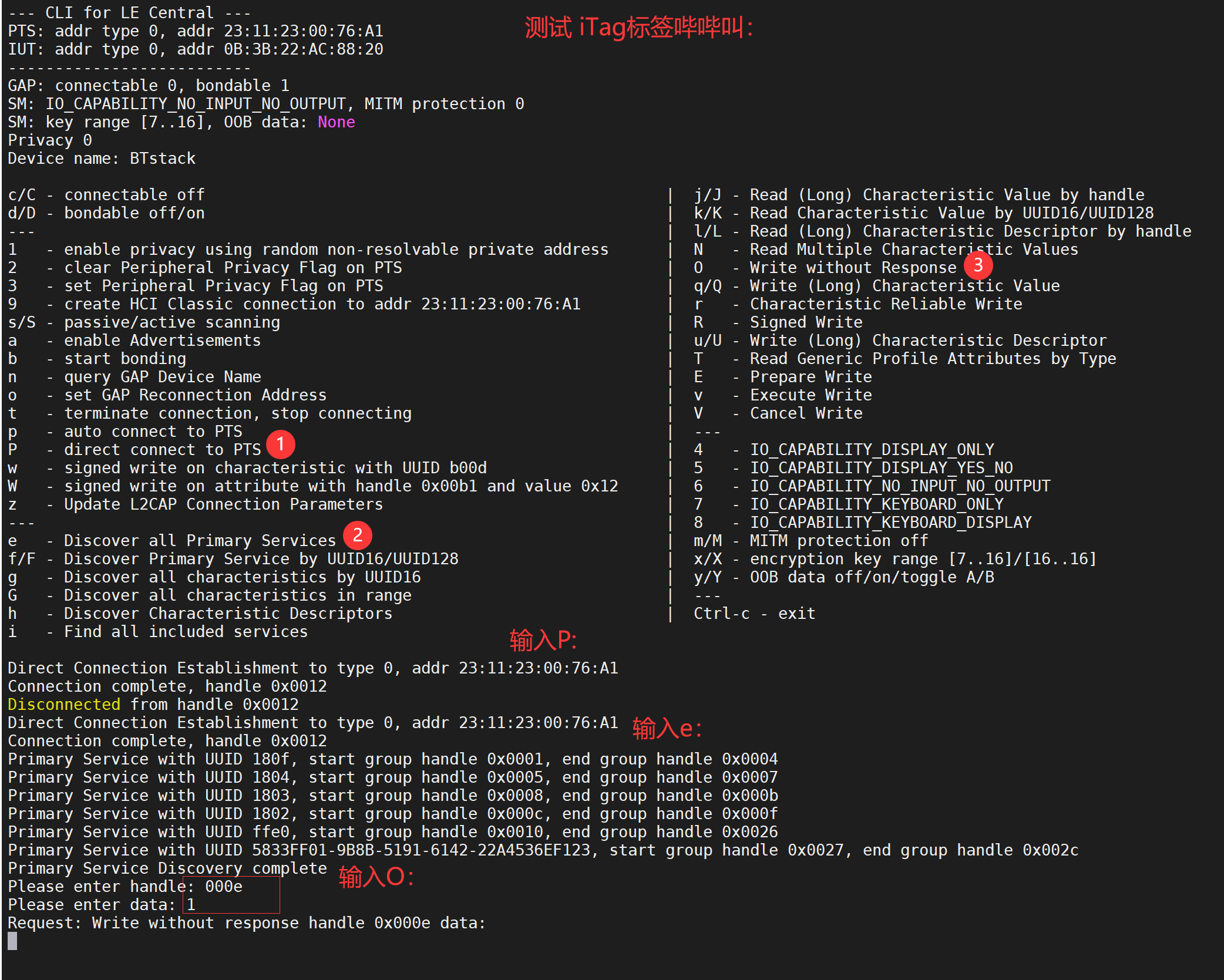

SM: IO_CAPABILITY_NO_INPUT_NO_OUTPUT, MITM protection 0
SM: key range [7..16], OOB data: None
Privacy 0
Device name: BTstack
c/C - connectable off                                                 |  j/J - Read (Long) Characteristic Value by handle
d/D - bondable off/on                                                 |  k/K - Read Characteristic Value by UUID16/UUID128
---                                                                   |  l/L - Read (Long) Characteristic Descriptor by handle
1   - enable privacy using random non-resolvable private address      |  N   - Read Multiple Characteristic Values
2   - clear Peripheral Privacy Flag on PTS                            |  O   - Write without Response
3   - set Peripheral Privacy Flag on PTS                              |  q/Q - Write (Long) Characteristic Value
9   - create HCI Classic connection to addr 23:11:23:00:76:A1         |  r   - Characteristic Reliable Write
s/S - passive/active scanning                                         |  R   - Signed Write
a   - enable Advertisements                                           |  u/U - Write (Long) Characteristic Descriptor
b   - start bonding                                                   |  T   - Read Generic Profile Attributes by Type
n   - query GAP Device Name                                           |  E   - Prepare Write
o   - set GAP Reconnection Address                                    |  v   - Execute Write
t   - terminate connection, stop connecting                           |  V   - Cancel Write
p   - auto connect to PTS                                             |  ---
P   - direct connect to PTS                                           |  4   - IO_CAPABILITY_DISPLAY_ONLY
w   - signed write on characteristic with UUID b00d                   |  5   - IO_CAPABILITY_DISPLAY_YES_NO
W   - signed write on attribute with handle 0x00b1 and value 0x12     |  6   - IO_CAPABILITY_NO_INPUT_NO_OUTPUT
z   - Update L2CAP Connection Parameters                              |  7   - IO_CAPABILITY_KEYBOARD_ONLY
---                                                                   |  8   - IO_CAPABILITY_KEYBOARD_DISPLAY
e   - Discover all Primary Services                                   |  m/M - MITM protection off
f/F - Discover Primary Service by UUID16/UUID128                      |  x/X - encryption key range [7..16]/[16..16]
g   - Discover all characteristics by UUID16                          |  y/Y - OOB data off/on/toggle A/B
G   - Discover all characteristics in range                           |  ---
h   - Discover Characteristic Descriptors                             |  Ctrl-c - exit
i   - Find all included services

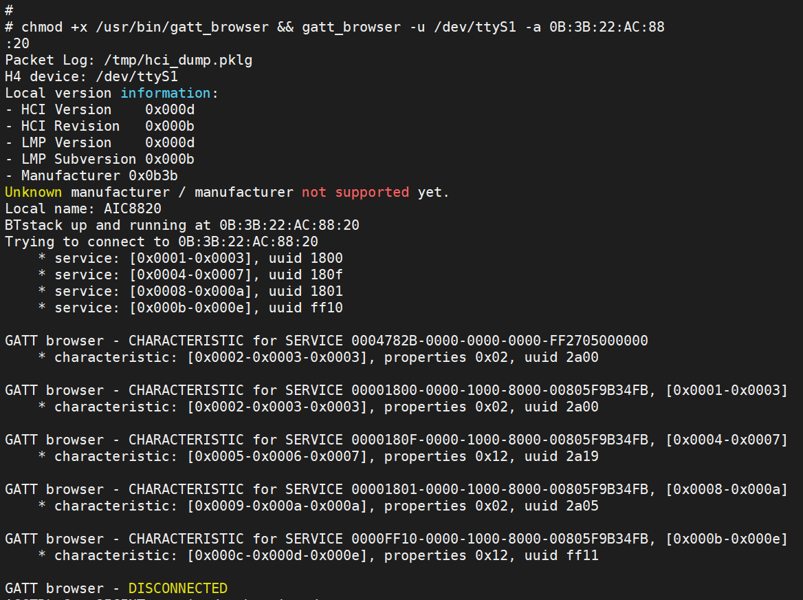

Direct Connection Establishment to type 0, addr 23:11:23:00:76:A1
Connection complete, handle 0x0012
Primary Service with UUID 180f, start group handle 0x0001, end group handle 0x0004
Primary Service with UUID 1804, start group handle 0x0005, end group handle 0x0007
Primary Service with UUID 1803, start group handle 0x0008, end group handle 0x000b
Primary Service with UUID 1802, start group handle 0x000c, end group handle 0x000f
Primary Service with UUID ffe0, start group handle 0x0010, end group handle 0x0026
Primary Service with UUID 5833FF01-9B8B-5191-6142-22A4536EF123, start group handle 0x0027, end group handle 0x002c
Primary Service Discovery complete
Please enter service UUID16: 180f

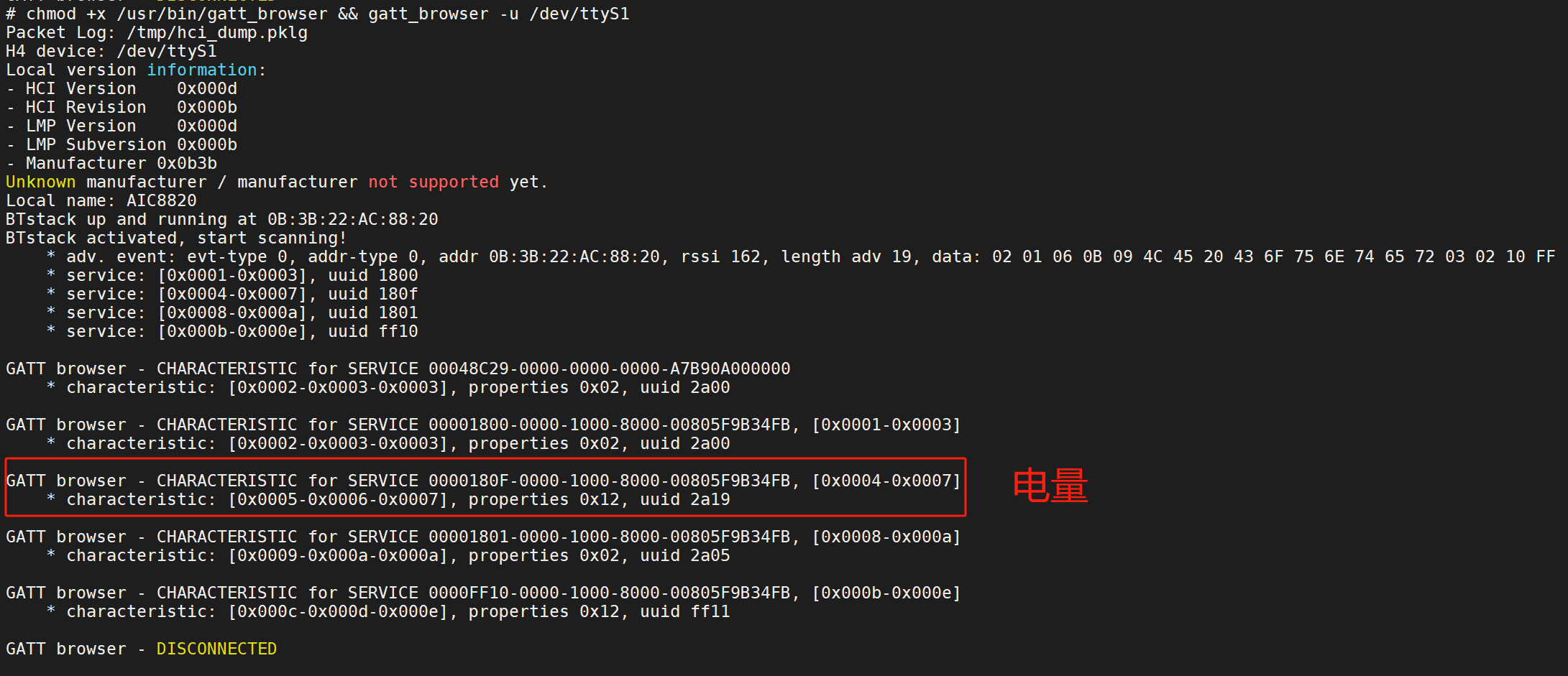

Discover Primary Services with UUID16 180f
Characteristic found at 0x0002 with value handle 0x0003, uuid 2a19
Please enter service UUID16: 1804
Discover Primary Services with UUID16 1804
Characteristic found at 0x0006 with value handle 0x0007, uuid 2a07
Please enter service UUID16: 1803
Discover Primary Services with UUID16 1803

查询 2a19 对应的 handle:
先输入P连接BLE设备,输入k,2a19,5获取电量数据:

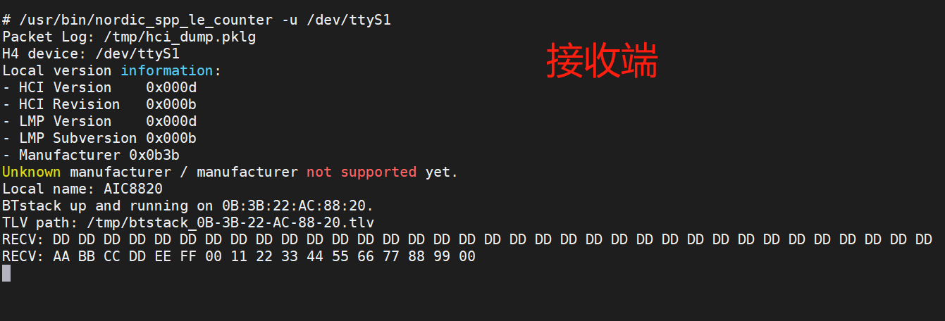

发送端(/usr/bin/ble_central_test -u /dev/ttyS1):
接收端(/usr/bin/nordic_spp_le_counter -u /dev/ttyS1):

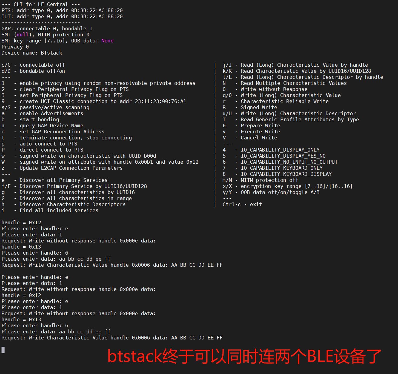

btstack终于可以同时连两个BLE设备了

输入 P 连接第一个设备,输入a切换到第一个设备对应的handle
输入O
输入e回车
输入1回车
第一个设备哔哔哔响
输入 A 连接第二个设备,输入b切换到第二个设备对应的handle
输入q
输入6回车
输入16进制数据
第二个设备收到串口数据
