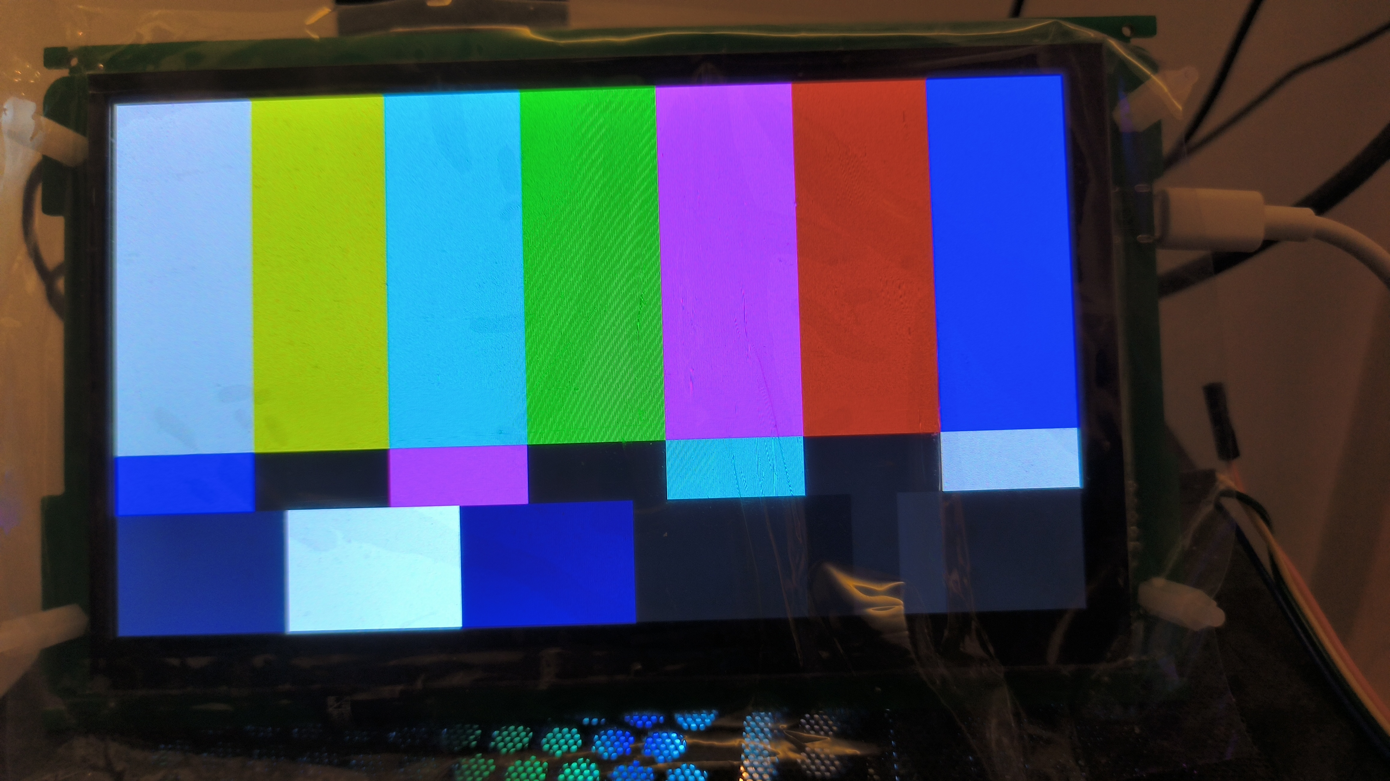

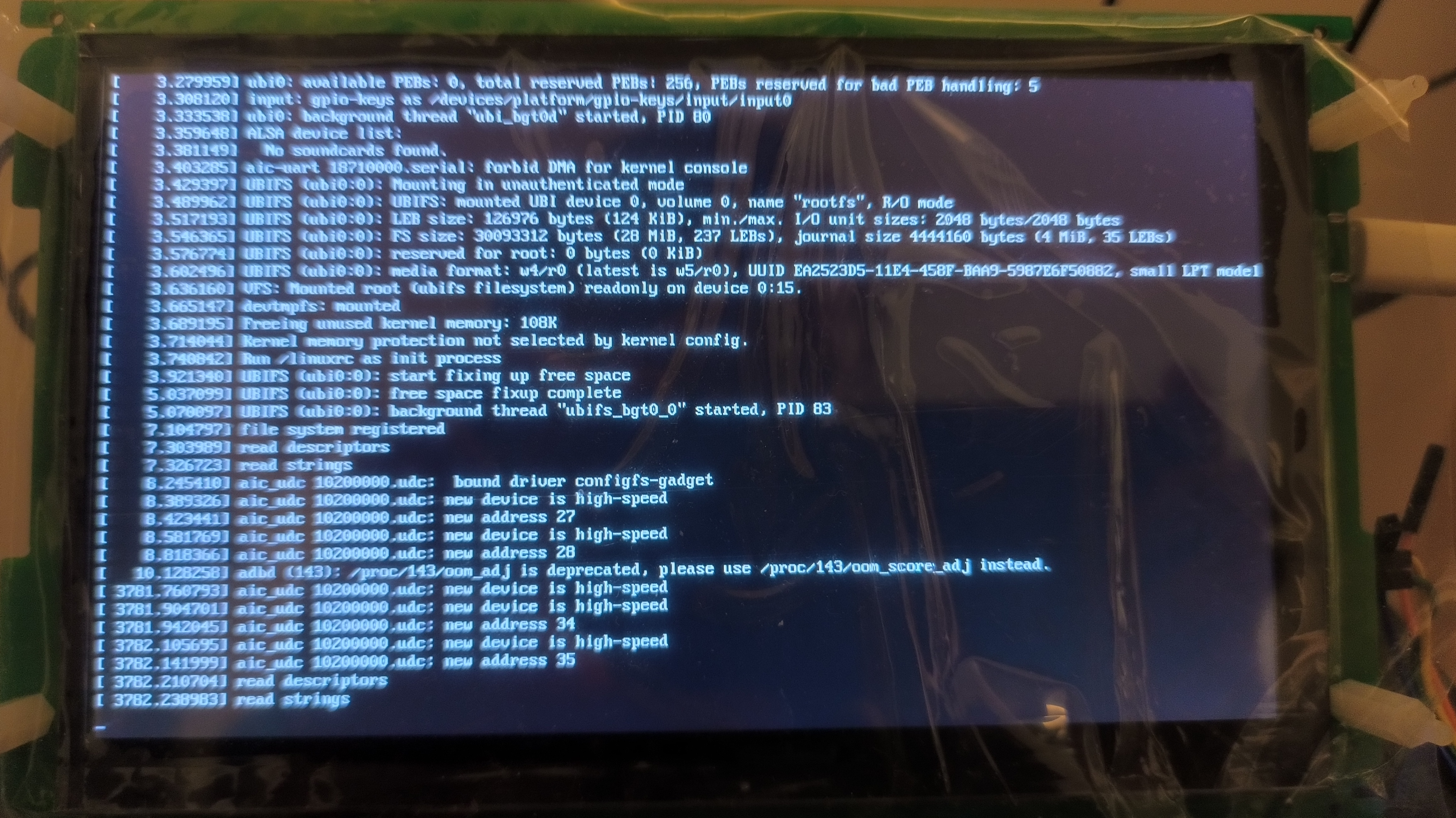

Linux启动,fb console 开始工作
modetest 打印输出 ArtInChip KMS 信息
[aic@] # modetest
trying to open device 'artinchip'...done

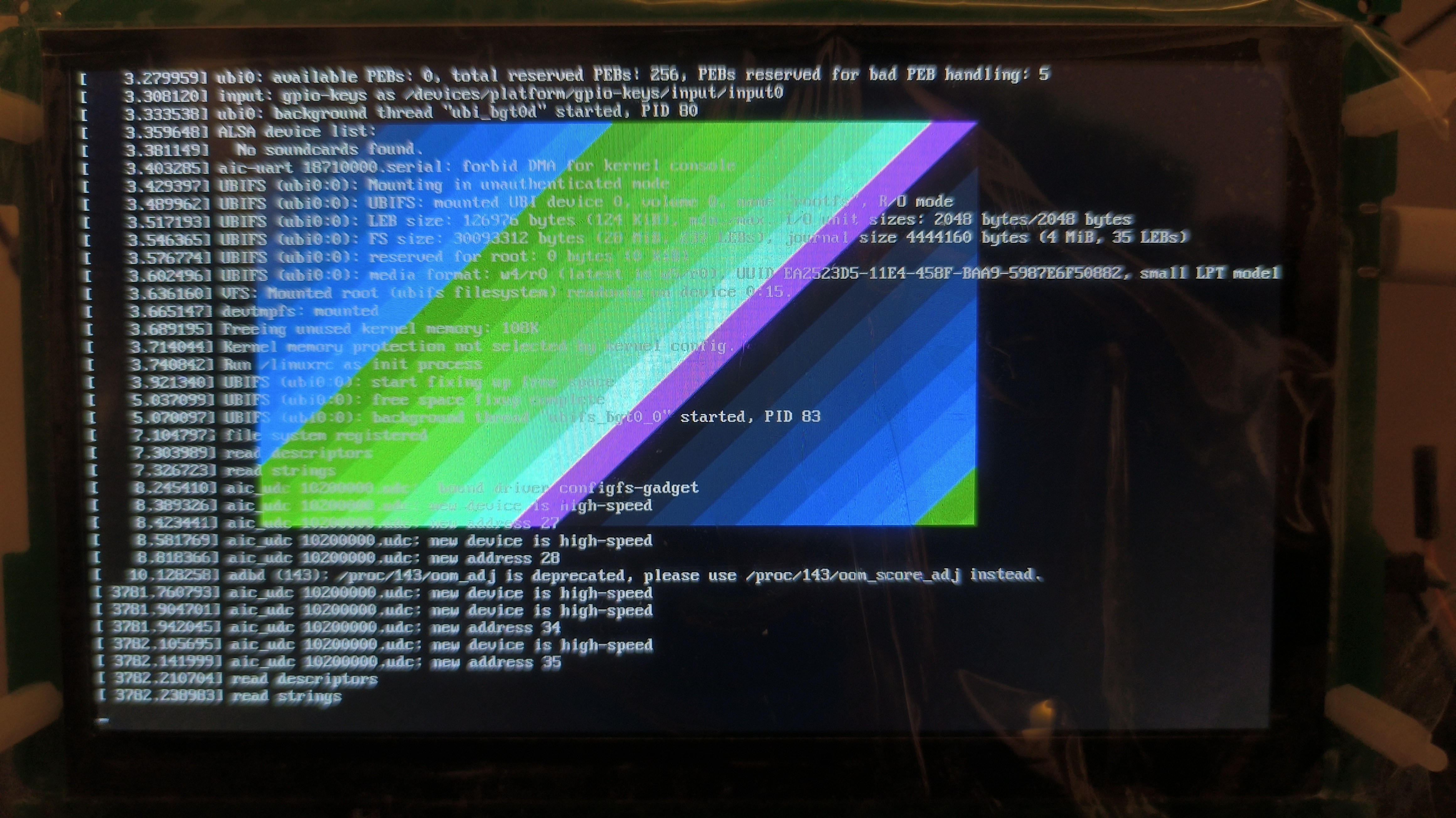

modetest set a mode
modetest -M artinchip -s 44@42:1024x600

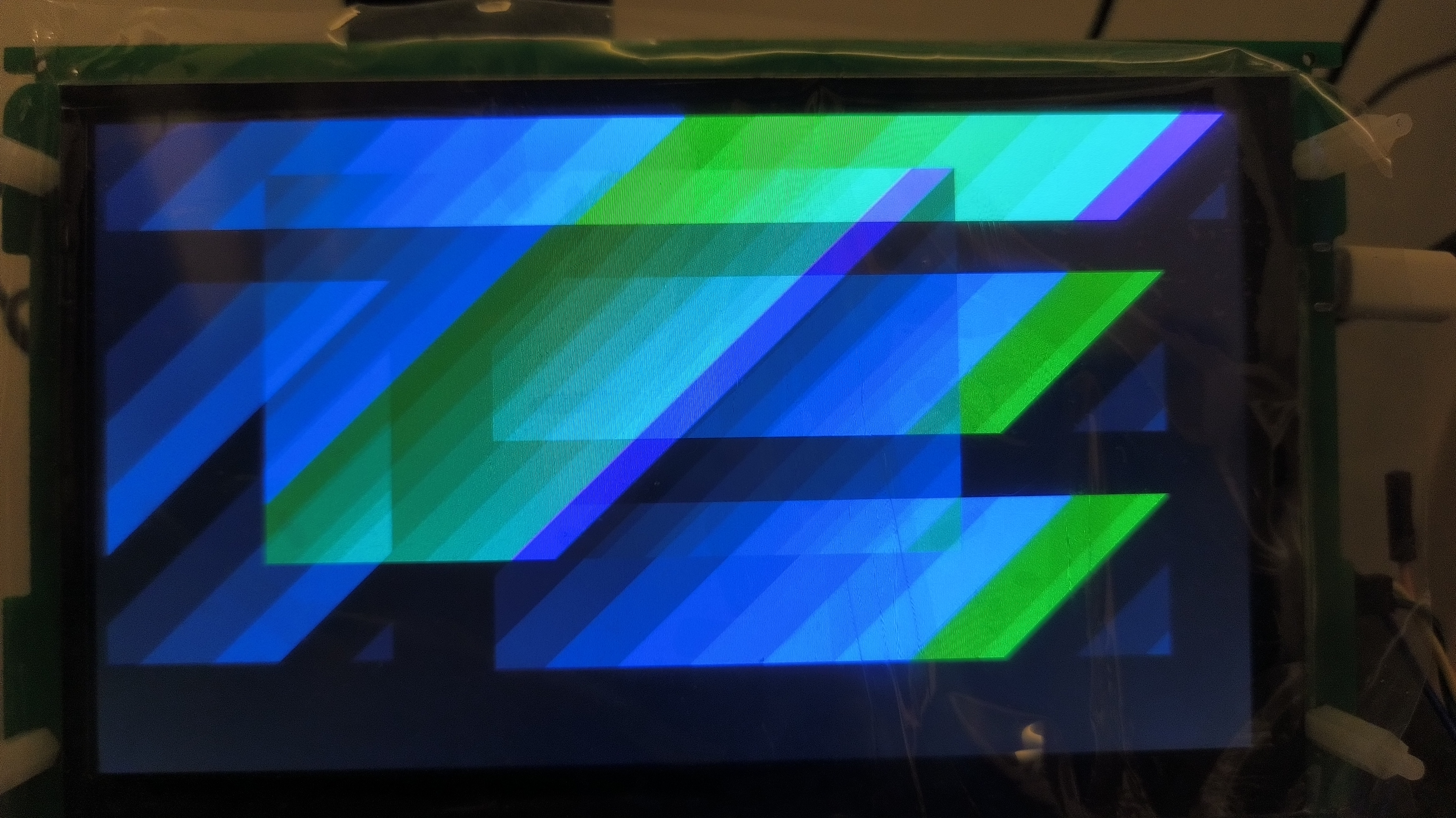

配置 4 个 UI 矩形窗口,开启 Video 图层 1024x600, YUV420P 格式,进行 3/5 缩放,全局 alpha 模式,global alpha = 128
modetest -M artinchip -P 31@42:1000x100+10+0 -P 32@42:250x350+10+150 -P 33@42:600x150+350+150 -P 34@42:600x150+350+360 -w 35:pixel\ blend\ mode:2 -w 35:alpha:128 -P 35@42:1024x600+150+50*0.6@YU12
pixel  blend  mode : alpha 模式,[0, 2], 0: pixel alpha; 1: 混合 alpha; 2: 全局 alpha
alpha: 全局 alpha 数值
配置 colorkey,开启 Video 图层 1024x600, YUV420P 格式,进行 0.6 缩放,colorkay = 0
modetest -M artinchip  -w 35:alpha_en:0 -w 35:colorkey:0-P 35@42:1024x600+150+50*0.6@YU12
alpha_en: alpha blend ctrl, alpha 默认开启 ,需要手动关闭,然后使能 colorkey
colorkey: bit 24: colorkey ctrl, 1(default): disable colorkey, 0: enable colorkey
              bit[23:16]: R value
              bit[15:8]: G value
              bit[7:0]: B value
              十进制输入
