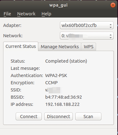

Ubuntu下普通用户运行 wpa_gui 出错的解决方案
修改socket文件的拥有者权限:
sudo chown -R ubuntu:ubuntu/var/run/wpa_supplicant/

命令行测试:
wpa_cli -i wlx60fb00f2ccfb -p /var/run/wpa_supplicant/ scan
wpa_cli -i wlx60fb00f2ccfb -p /var/run/wpa_supplicant/ scan_result
wpa_cli -i wlx60fb00f2ccfb -p /var/run/wpa_supplicant/ status
