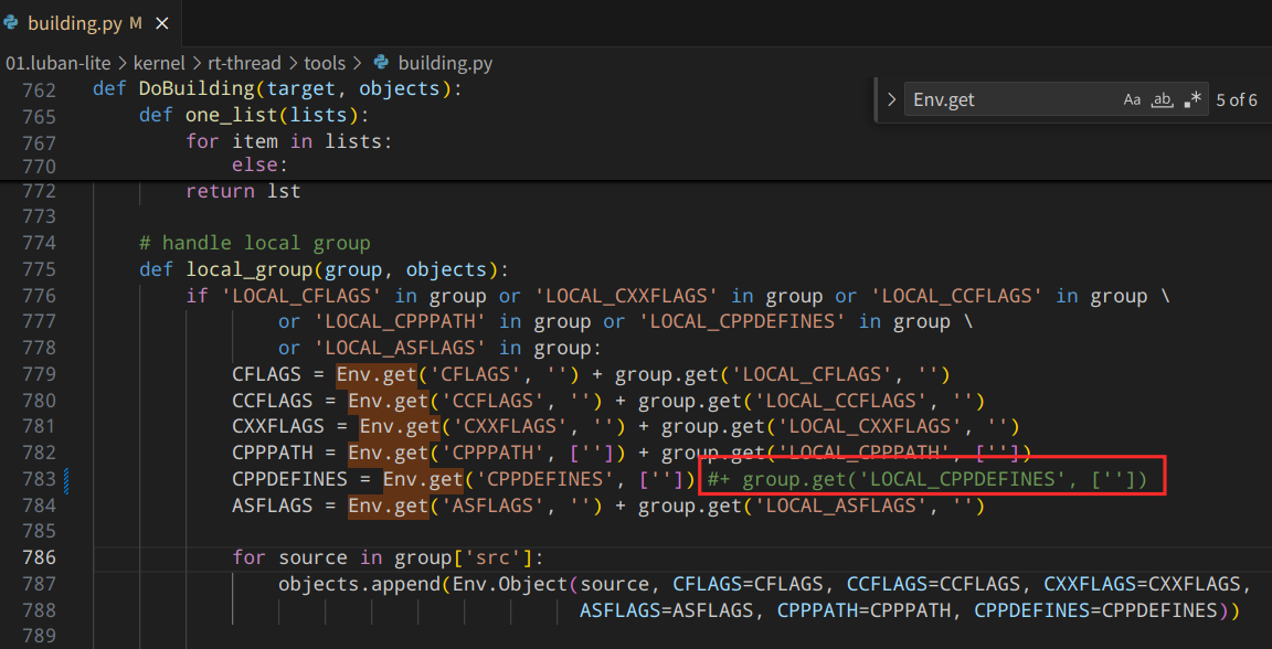

Luban-lite rt-thread系统在SCons4.5.2环境下编译错误,解决办法如下:
方法1:将SCons降级为4.4版本
参考https://club.rt-thread.org/ask/question/ca770500d30d66e7.html
方法2: 修改kernel/rt-thread/tools/building.py文件,具体如下图所示,注释掉红框中的内容即可
参考https://github.com/RT-Thread/rt-thread/issues/7991

方法二改法不太妥当。新版本下,Env.get函数返回的是deque、group.get函数返回的是list,再者不能用加号来组合。最好按下述修改:将deque转为list
diff --git a/kernel/rt-thread/tools/building.py b/kernel/rt-thread/tools/building.py
index 24bcf5cc..cf329981 100644
--- a/kernel/rt-thread/tools/building.py
+++ b/kernel/rt-thread/tools/building.py
@@ -779,8 +779,8 @@ def DoBuilding(target, objects):
             CFLAGS = Env.get('CFLAGS', '') + group.get('LOCAL_CFLAGS', '')
             CCFLAGS = Env.get('CCFLAGS', '') + group.get('LOCAL_CCFLAGS', '')
             CXXFLAGS = Env.get('CXXFLAGS', '') + group.get('LOCAL_CXXFLAGS', '')
-            CPPPATH = Env.get('CPPPATH', ['']) + group.get('LOCAL_CPPPATH', [''])
-            CPPDEFINES = Env.get('CPPDEFINES', ['']) + group.get('LOCAL_CPPDEFINES', [''])
+            CPPPATH = list(Env.get('CPPPATH', [''])) + group.get('LOCAL_CPPPATH', [''])
+            CPPDEFINES = list(Env.get('CPPDEFINES', [''])) + group.get('LOCAL_CPPDEFINES', [''])
