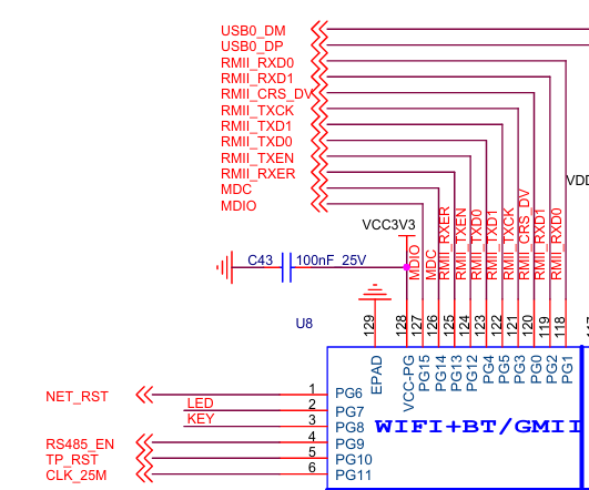

全志T113的主线内核的EMAC问题
内核版本是6.12.35
内核日志如下:
[    0.264623] dwmac-sun8i 4500000.ethernet: IRQ eth_wake_irq not found
[    0.268356] ehci-platform 4200000.usb: irq 36, io mem 0x04200000
[    0.272992] dwmac-sun8i 4500000.ethernet: IRQ eth_lpi not found
[    0.273002] dwmac-sun8i 4500000.ethernet: IRQ sfty not found
[    0.273382] dwmac-sun8i 4500000.ethernet: PTP uses main clock
[    0.275620] hub 2-0:1.0: 1 port detected
[    0.281819] dwmac-sun8i 4500000.ethernet: Current syscon value is not the default 58000 (expect 0)
[    0.303961] ehci-platform 4200000.usb: USB 2.0 started, EHCI 1.00
[    0.314219] dwmac-sun8i 4500000.ethernet: No HW DMA feature register supported
[    0.319352] hub 1-0:1.0: USB hub found
[    0.323451] dwmac-sun8i 4500000.ethernet: RX Checksum Offload Engine supported
[    0.329956] hub 1-0:1.0: 1 port detected
[    0.339431] dwmac-sun8i 4500000.ethernet: COE Type 2
[    0.623933] usb 1-1: new high-speed USB device number 2 using ehci-platform
[    0.629268] dwmac-sun8i 4500000.ethernet: TX Checksum insertion supported
[    0.815287] hub 1-1:1.0: USB hub found
[    0.819142] dwmac-sun8i 4500000.ethernet: Normal descriptors
[    0.827001] hub 1-1:1.0: 4 ports detected
[    0.835403] dwmac-sun8i 4500000.ethernet: Chain mode enabled
[    1.263936] usb 1-1.3: new high-speed USB device number 3 using ehci-platform
[    1.537277] dwmac-sun8i 4500000.ethernet: EMAC reset timeout
[    1.542964] dwmac-sun8i 4500000.ethernet eth0: stmmac_dvr_remove: removing driver
[    1.584892] dwmac-sun8i 4500000.ethernet: probe with driver dwmac-sun8i failed with error -110
设备树配置如下:
&emac {
    pinctrl-0 = <&rmii_pg_clk25m_pins>;
    pinctrl-names = "default";
    phy-mode = "rmii";
    phy-handle = <&ip101gr>;
    phy-supply = <&reg_3v3>;
    clocks = <&ccu CLK_BUS_EMAC>,<&ccu CLK_EMAC_25M>;
    clock-names = "stmmaceth","ephy25m";
    use_ephy25m = <1>;
&mdio{
    reset-assert-us = <10000>;
    reset-post-delay-us = <150000>;
    reset-deassert-us = <150000>;
    reset-gpios = <&pio 6 6 GPIO_ACTIVE_LOW>; /* PG6 */
    ip101gr: ethernet-phy@0 {
        // compatible = "ethernet-phy-ieee802.3-c22";
        // compatible = "ethernet-phy-id001c.c816";
        compatible = "ethernet-phy-id0243.0c54","ethernet-phy-ieee802.3-c22";
        reg = <0>;
现在的问题是我没办法识别出PHY,而且用示波器去看EPHY-25M引脚也没有时钟输出,问一下主线内核该怎么开启内部时钟输出?

困扰了我好久,在网上翻出这个
按照 https://lore.kernel.org/netdev/20230605154010.49611-2-detlev.casanova@collabora.com/T/#u
格式修改对应的phy驱动
然后在phy节点添加 clocks = <&ccu CLK_EMAC_25M>;
#4 2025-10-01 00:44:03

参考实现,内核版本 6.12.0
diff --git a/drivers/net/phy/icplus.c b/drivers/net/phy/icplus.c
