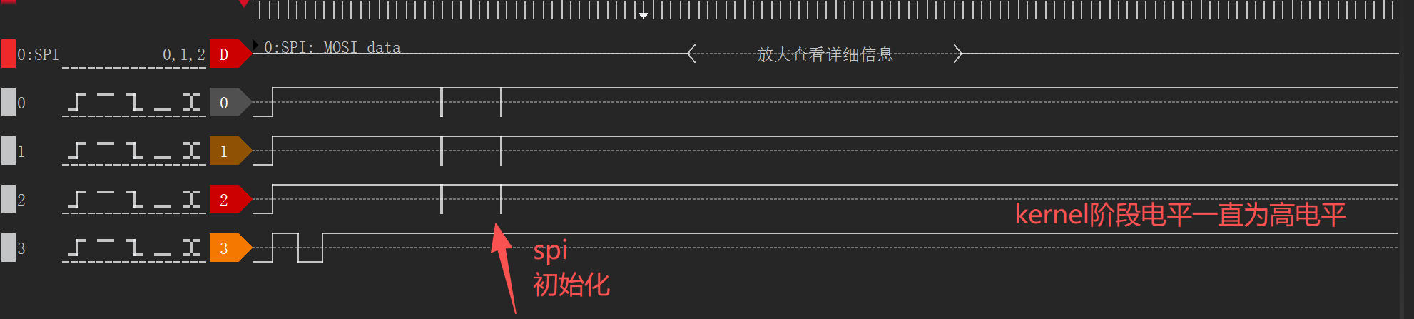

求助,F1C100S 显示屏有问题
上一篇帖子在u-boot里用引脚模拟spi,初始化了rgb屏幕,然后正常显示了logo,现在kernel运行过程中,屏幕会渐渐变暗,然后完全黑屏。用逻辑分析仪抓过波形初始化后spi和rst没有其他跳变一直是高电平。进入系统后,有fb0,但是不会雪花屏幕,屏幕没有任何输出,只有背光,背光是在uboot里打开的。求各位大佬提供个思路在问题在哪里。boot传入的参数mem=31M ,跳过了最后1M.
linux版本4.14
逻辑分析仪器波形
.jpg

[    0.000000] Linux version 4.14.0 (root@DESKTOP-S2CLG0O) (gcc version 7.2.1 20171011 (Linaro GCC 7.2-2017.11)) #9 Sat Dec 13 21:46:01 CST 2025
[    0.000000] Built 1 zonelists, mobility grouping on.  Total pages: 7874
[    0.000000] Kernel command line: console=ttyS1,115200 mem=31M panic=5 rootwait root=/dev/mtdblock3 rw rootfstype=jffs2
[    0.000000] Memory: 21648K/31744K available (6144K kernel code, 212K rwdata, 1392K rodata, 1024K init, 251K bss, 10096K reserved, 0K cma-reserved, 0K highmem)
[    0.000000]     vmalloc : 0xc2000000 - 0xff800000   ( 984 MB)
[    0.000000]     lowmem  : 0xc0000000 - 0xc1f00000   (  31 MB)
[    0.000000]       .data : 0xc0a00000 - 0xc0a35140   ( 213 kB)
[    0.000000]        .bss : 0xc0a3a54c - 0xc0a792ec   ( 252 kB)
[    0.000046] sched_clock: 32 bits at 24MHz, resolution 41ns, wraps every 89478484971ns
[    0.000115] clocksource: timer: mask: 0xffffffff max_cycles: 0xffffffff, max_idle_ns: 79635851949 ns
[    0.000667] Console: colour dummy device 80x30
[    0.000760] Calibrating delay loop... 203.16 BogoMIPS (lpj=1015808)
[    0.070240] pid_max: default: 32768 minimum: 301
[    0.070587] Mount-cache hash table entries: 1024 (order: 0, 4096 bytes)
[    0.070634] Mountpoint-cache hash table entries: 1024 (order: 0, 4096 bytes)
[    0.072067] CPU: Testing write buffer coherency: ok
[    0.073720] Setting up static identity map for 0x80100000 - 0x80100058
[    0.076206] devtmpfs: initialized
[    0.082570] clocksource: jiffies: mask: 0xffffffff max_cycles: 0xffffffff, max_idle_ns: 19112604462750000 ns
[    0.082635] futex hash table entries: 256 (order: -1, 3072 bytes)
[    0.082897] pinctrl core: initialized pinctrl subsystem
[    0.084959] NET: Registered protocol family 16
[    0.086462] DMA: preallocated 256 KiB pool for atomic coherent allocations
[    0.088269] cpuidle: using governor menu
[    0.113552] SCSI subsystem initialized
[    0.113881] usbcore: registered new interface driver usbfs
[    0.114026] usbcore: registered new interface driver hub
[    0.114232] usbcore: registered new device driver usb
[    0.114681] pps_core: LinuxPPS API ver. 1 registered
[    0.114708] pps_core: Software ver. 5.3.6 - Copyright 2005-2007 Rodolfo Giometti <giometti@linux.it>
[    0.114767] PTP clock support registered
[    0.115248] Advanced Linux Sound Architecture Driver Initialized.
[    0.118253] clocksource: Switched to clocksource timer
[    0.145022] NET: Registered protocol family 2
[    0.146458] TCP established hash table entries: 1024 (order: 0, 4096 bytes)
[    0.146535] TCP bind hash table entries: 1024 (order: 0, 4096 bytes)
[    0.146588] TCP: Hash tables configured (established 1024 bind 1024)
[    0.146864] UDP hash table entries: 256 (order: 0, 4096 bytes)
[    0.146925] UDP-Lite hash table entries: 256 (order: 0, 4096 bytes)
[    0.147391] NET: Registered protocol family 1
[    0.148500] RPC: Registered named UNIX socket transport module.
[    0.148544] RPC: Registered udp transport module.
[    0.148561] RPC: Registered tcp transport module.
[    0.148577] RPC: Registered tcp NFSv4.1 backchannel transport module.
[    0.149689] NetWinder Floating Point Emulator V0.97 (double precision)
[    0.151463] Initialise system trusted keyrings
[    0.152042] workingset: timestamp_bits=30 max_order=13 bucket_order=0
[    0.169032] NFS: Registering the id_resolver key type
[    0.169129] Key type id_resolver registered
[    0.169149] Key type id_legacy registered
[    0.169273] jffs2: version 2.2. (NAND) ? 2001-2006 Red Hat, Inc.
[    0.183211] Key type asymmetric registered
[    0.183257] Asymmetric key parser 'x509' registered
[    0.183499] Block layer SCSI generic (bsg) driver version 0.4 loaded (major 251)
[    0.183533] io scheduler noop registered
[    0.183551] io scheduler deadline registered
[    0.184273] io scheduler cfq registered (default)
[    0.184309] io scheduler mq-deadline registered
[    0.184328] io scheduler kyber registered
[    0.194796] suniv-pinctrl 1c20800.pinctrl: initialized sunXi PIO driver
[    0.366968] Serial: 8250/16550 driver, 8 ports, IRQ sharing disabled
[    0.394056] 1c25000.serial: ttyS0 at MMIO 0x1c25000 (irq = 22, base_baud = 6250000) is a 16550A
[    0.416700] 1c25400.serial: ttyS1 at MMIO 0x1c25400 (irq = 23, base_baud = 6250000) is a 16550A
[    0.895098] console [ttyS1] enabled
[    0.921219] 1c25800.serial: ttyS2 at MMIO 0x1c25800 (irq = 24, base_baud = 6250000) is a 16550A
[    0.936581] panel-simple panel: panel supply power not found, using dummy regulator
[    0.945927] SCSI Media Changer driver v0.25
[    0.953888] m25p80 spi0.0: w25q128 (16384 Kbytes)
[    0.959632] 4 ofpart partitions found on MTD device spi0.0
[    0.965135] Creating 4 MTD partitions on "spi0.0":
[    0.970056] 0x000000000000-0x000000100000 : "u-boot"
[    0.977599] 0x000000100000-0x000000110000 : "dtb"
[    0.984920] 0x000000110000-0x000000510000 : "kernel"
[    0.992461] 0x000000510000-0x000001000000 : "rootfs"
[    1.000636] ehci_hcd: USB 2.0 'Enhanced' Host Controller (EHCI) Driver
[    1.007171] ehci-platform: EHCI generic platform driver
[    1.012809] ohci_hcd: USB 1.1 'Open' Host Controller (OHCI) Driver
[    1.019120] ohci-platform: OHCI generic platform driver
[    1.024780] usbcore: registered new interface driver usb-storage
[    1.031521] udc-core: couldn't find an available UDC - added [g_cdc] to list of pending drivers
[    1.040545] i2c /dev entries driver
[    1.046989] usbcore: registered new interface driver usbhid
[    1.052680] usbhid: USB HID core driver
[    1.070720] NET: Registered protocol family 17
[    1.075414] Key type dns_resolver registered
[    1.081967] Loading compiled-in X.509 certificates
[    1.094765] [drm] Supports vblank timestamp caching Rev 2 (21.10.2013).
[    1.101518] [drm] No driver support for vblank timestamp query.
[    1.108511] sun4i-drm display-engine: bound 1e60000.display-backend (ops 0xc0739368)
[    1.117264] sun4i-drm display-engine: bound 1c0c000.lcd-controller (ops 0xc073871c)
[    1.171449] Console: switching to colour frame buffer device 40x30
[    1.193603] sun4i-drm display-engine: fb0:  frame buffer device
[    1.200776] [drm] Initialized sun4i-drm 1.0.0 20150629 for display-engine on minor 0
[    1.209317] vcc3v3: disabling
[    1.212309] ALSA device list:
[    1.215340]   #0: Loopback 1
[    1.318103] random: crng init done
[    1.784698] VFS: Mounted root (jffs2 filesystem) on device 31:3.
[    1.792645] devtmpfs: mounted
[    1.800487] Freeing unused kernel memory: 1024K
Starting logging: OK
Starting network: OK
Welcome to Lichee Pi
lichee login:
最近编辑记录 arvinHou (2025-12-13 22:11:09)
