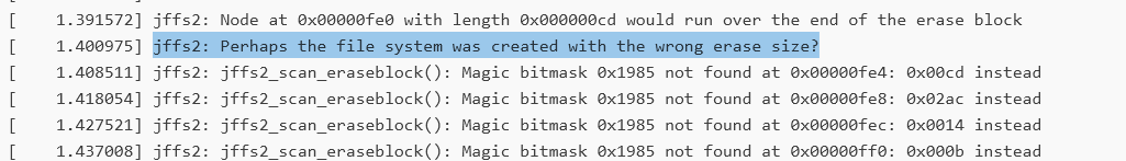

V3S W25Q256 挂载 文件系统失败
好像是解析分区失败,提示 VFS: Cannot open root device "31:03" or unknown-block(31,3): error -19
以下是调试输出信息:

device 0 offset 0x110000, size 0x500000
SF: 5242880 bytes @ 0x110000 Read: OK
   Loading Device Tree to 42dfa000, end 42dffe7a ... OK

[    0.775882] m25p80 spi0.0: w25q256 (32768 Kbytes)

楼主 #1 2026-01-24 18:17:06
zl
注册时间: 2026-01-21
Re: V3S W25Q256 挂载 文件系统失败
上面的问题解决了,现在是新的问题
