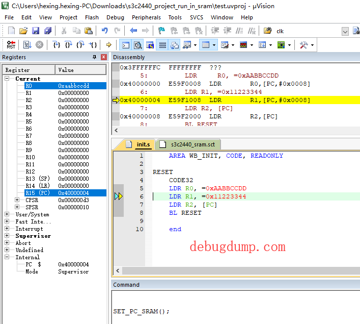

MDK 裸奔 S3C2440
MDK 裸奔 S3C2440
源码下载: s3c2440_project_run_in_sram_1.7z

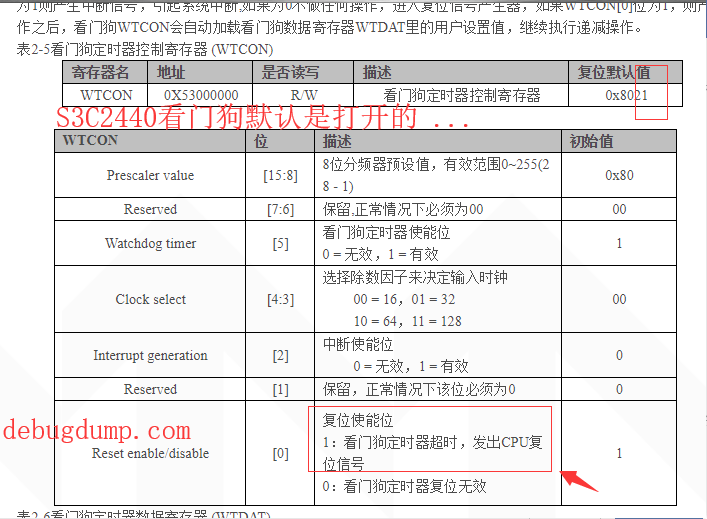

S3C2440的看门狗默认是开着的,
怪不得一全速跑就飞了。。。

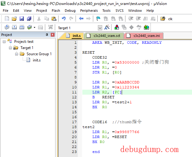

Re: MDK 裸奔 S3C2440
LDR R0, =0x53000000 ;关闭看门狗
LDR R1, =0
STR R1, [R0]
添加三条指令即可关闭看门狗.
