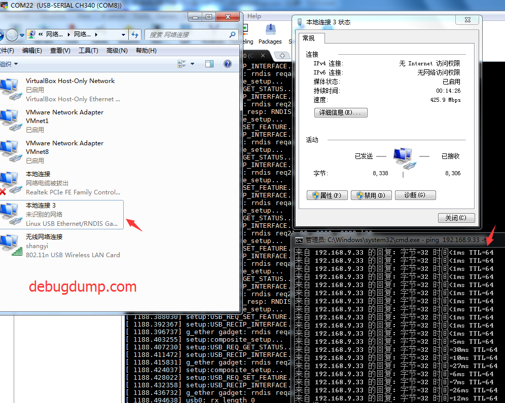

f1c100s USB otg device 模式可以用吗?
进 device 模式,能调用 USBC_EnableDpDmPullUp,但是 D+ 脚没有拉高,所以接电脑没反应。请各位大神指点下,多谢了!

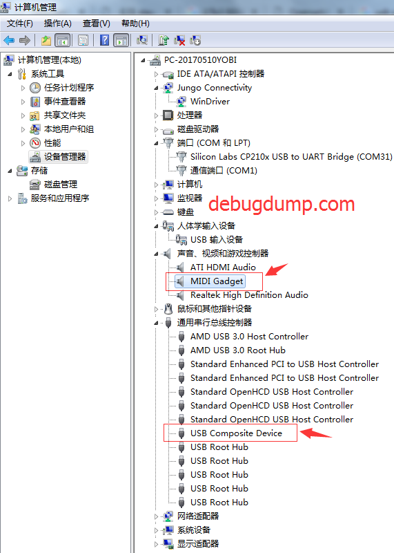

修改 sunxi_usb_device_enable:
	is_udc_enable = 1; // 添加这句 !!!
	if (udc->driver && is_udc_enable) {
		sunxi_udc_enable(udc);
		cfg_udc_command(SW_UDC_P_ENABLE);
	DMSG_INFO_UDC("sunxi_usb_device_enable end\n");

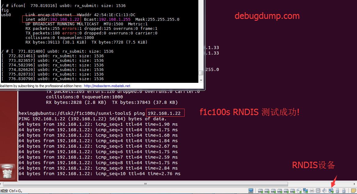

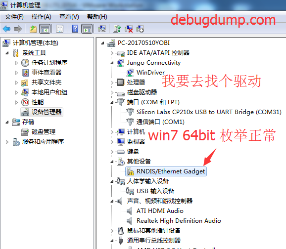

这样改完, device 就可以跑起来了?
可以枚举,但是我测试 RNDIS 还有问题,INT 节点通讯有问题。
其他的CDC, AUDIO有没有测试?

buildroot login: [    6.486512]
[    6.486512] insmod_device_driver
[    6.486512]
[    6.493465] [udc]: sunxi_usb_device_enable start
[    6.501559] [udc]: open_usb_clock
[    6.505354] sunxi_udc_disable
[    6.510459] [udc]: usbd_stop_work
[    6.514323] sunxi_udc_enable called
[    6.520230] [udc]: CONFIG_USB_GADGET_DUALSPEED: USBC_TS_MODE_HS
[    6.528155] [udc]: usbd_start_work
[    6.532009] [udc]: usbd_start_work
[    6.535807] [udc]: sunxi_usb_device_enable end
[    6.587526] [udc]: IRQ: suspend
[    6.591083] [udc]: ERR: usb speed is unkown
[    6.695260] [udc]: IRQ: reset
[    6.698649] [udc]: (1:star,2:end): vfs_read:0, vfs_write:0,dma_working:0,amount:0,file_offset:0
[    6.708326] [udc]: irq: reset happen, throw away all urb
[    6.732285] USB ep0 irq
[    6.735083] [udc]:
[    6.735083] +++++++++++++++++++++++++++++++++++++
[    6.742660] [udc]:  usb enter high speed.
[    6.747126] [udc]:
[    6.747126] +++++++++++++++++++++++++++++++++++++
[    6.754702] sunxi_udc_handle_ep0--3--0
[    6.758899] ep0: bRequest = 6 bRequestType 128 wLength = 64
[    6.765140] W: req.actual(0), req.length(18), len(18), total(18)
[    6.771848] pw: (0xc191eae8, 18, 18)
[    6.775989] USB ep0 irq
[    6.778764] sunxi_udc_handle_ep0--3--0
[    6.782972] [udc]: IRQ: reset
[    6.786312] [udc]: (1:star,2:end): vfs_read:0, vfs_write:0,dma_working:0,amount:0,file_offset:0
[    6.795978] [udc]: irq: reset happen, throw away all urb
[    6.816255] USB ep0 irq
[    6.819041] sunxi_udc_handle_ep0--3--0
[    6.823220] ep0: bRequest = 5 bRequestType 0 wLength = 0
[    6.829132] USB_REQ_SET_ADDRESS ...
[    6.833342] USB ep0 irq
[    6.836104] sunxi_udc_handle_ep0--3--3
[    6.840280] EP0_END_XFER ... what now?
[    6.844453] crq_bRequest = 0x5
[    6.847855] [udc]: Set address 5
[    6.861265] USB ep0 irq
[    6.864044] sunxi_udc_handle_ep0--3--0
[    6.868253] ep0: bRequest = 6 bRequestType 128 wLength = 18
[    6.874515] W: req.actual(0), req.length(18), len(18), total(18)
[    6.881228] pw: (0xc191eae8, 18, 18)
[    6.885369] USB ep0 irq
[    6.888132] sunxi_udc_handle_ep0--3--0
[    6.892328] ep0: bRequest = 6 bRequestType 128 wLength = 255
[    6.898659] W: req.actual(0), req.length(75), len(64), total(64)
[    6.905363] pw: (0xc191eae8, 75, 64)
[    6.909379] USB ep0 irq
[    6.912122] sunxi_udc_handle_ep0--3--1
[    6.916293] EP0_IN_DATA_PHASE ... what now?
[    6.920947] W: req.actual(64), req.length(75), len(11), total(75)
[    6.927747] pw: (0xc191eae8, 75, 75)
[    6.931755] USB ep0 irq
[    6.934496] sunxi_udc_handle_ep0--3--0
[    6.938691] ep0: bRequest = 6 bRequestType 128 wLength = 255
[    6.945023] W: req.actual(0), req.length(4), len(4), total(4)
[    6.951432] pw: (0xc191eae8, 4, 4)
[    6.955228] USB ep0 irq
[    6.957956] sunxi_udc_handle_ep0--3--0
[    6.962162] ep0: bRequest = 6 bRequestType 128 wLength = 255
[    6.968500] W: req.actual(0), req.length(44), len(44), total(44)
[    6.975206] pw: (0xc191eae8, 44, 44)
[    6.979216] USB ep0 irq
[    6.981959] sunxi_udc_handle_ep0--3--0
[    6.986158] ep0: bRequest = 6 bRequestType 128 wLength = 18
[    6.992385] W: req.actual(0), req.length(18), len(18), total(18)
[    6.999083] pw: (0xc191eae8, 18, 18)
[    7.003086] USB ep0 irq
[    7.005823] sunxi_udc_handle_ep0--3--0
[    7.010016] ep0: bRequest = 6 bRequestType 128 wLength = 255
[    7.016330] W: req.actual(0), req.length(4), len(4), total(4)
[    7.022735] pw: (0xc191eae8, 4, 4)
[    7.026531] USB ep0 irq
[    7.029259] sunxi_udc_handle_ep0--3--0
[    7.033464] ep0: bRequest = 6 bRequestType 128 wLength = 255
[    7.039798] W: req.actual(0), req.length(66), len(64), total(64)
[    7.046495] pw: (0xc191eae8, 66, 64)
[    7.050495] USB ep0 irq
[    7.053237] sunxi_udc_handle_ep0--3--1
[    7.057423] EP0_IN_DATA_PHASE ... what now?
[    7.062078] W: req.actual(64), req.length(66), len(2), total(66)
[    7.068745] pw: (0xc191eae8, 66, 66)
[    7.072735] USB ep0 irq
[    7.075477] sunxi_udc_handle_ep0--3--0
[    7.079670] ep0: bRequest = 6 bRequestType 128 wLength = 255
[    7.085997] W: req.actual(0), req.length(44), len(44), total(44)
[    7.092702] pw: (0xc191eae8, 44, 44)
[    7.096702] USB ep0 irq
[    7.099437] sunxi_udc_handle_ep0--3--0
[    7.119925] USB ep0 irq
[    7.122723] sunxi_udc_handle_ep0--3--0
[    7.126905] ep0: bRequest = 6 bRequestType 128 wLength = 18
[    7.133130] W: req.actual(0), req.length(18), len(18), total(18)
[    7.139818] pw: (0xc191eae8, 18, 18)
[    7.144049] USB ep0 irq
[    7.146818] sunxi_udc_handle_ep0--3--0
[    7.151010] ep0: bRequest = 6 bRequestType 128 wLength = 9
[    7.157147] W: req.actual(0), req.length(9), len(9), total(9)
[    7.163562] pw: (0xc191eae8, 9, 9)
[    7.167493] USB ep0 irq
[    7.170251] sunxi_udc_handle_ep0--3--0
[    7.174447] ep0: bRequest = 6 bRequestType 128 wLength = 75
[    7.180676] W: req.actual(0), req.length(75), len(64), total(64)
[    7.187384] pw: (0xc191eae8, 75, 64)
[    7.191488] USB ep0 irq
[    7.194245] sunxi_udc_handle_ep0--3--1
[    7.198428] EP0_IN_DATA_PHASE ... what now?
[    7.203106] W: req.actual(64), req.length(75), len(11), total(75)
[    7.209891] pw: (0xc191eae8, 75, 75)
[    7.213980] USB ep0 irq
[    7.216736] sunxi_udc_handle_ep0--3--0
[    7.220916] ep0: bRequest = 9 bRequestType 0 wLength = 0
[    7.226811] USB_REQ_SET_CONFIGURATION ...
[    7.231410] g_ether gadget: high-speed config #2: RNDIS
[    7.237243] [udc]: ep enable: ep4(0xc0488538, ep4-int, 128, 8)
[    7.243752] [udc]: ep enable: ep4(0xc0488538, ep4-int, 128, 8), fifo(3584, 512, 0)
[    7.252213] [udc]: ep enable: ep1(0xc04883bc, ep1in-bulk, 128, 512)
[    7.259211] [udc]: ep enable: ep1(0xc04883bc, ep1in-bulk, 128, 512), fifo(512, 512, 0)
[    7.268037] [udc]: ep enable: ep1(0xc0488408, ep1out-bulk, 0, 512)
[    7.274941] [udc]: ep enable: ep1(0xc0488408, ep1out-bulk, 0, 512), fifo(1024, 512, 0)
[    7.283779] [udc]: alloc request: ep(0xc04883bc, ep1in-bulk, 512), req(0xc193ef60)
[    7.292190] [udc]: alloc request: ep(0xc04883bc, ep1in-bulk, 512), req(0xc193ec60)
[    7.300609] [udc]: alloc request: ep(0xc04883bc, ep1in-bulk, 512), req(0xc193e9c0)
[    7.309044] [udc]: alloc request: ep(0xc04883bc, ep1in-bulk, 512), req(0xc193ea80)
[    7.317480] [udc]: alloc request: ep(0xc04883bc, ep1in-bulk, 512), req(0xc193ec00)
[    7.325920] [udc]: alloc request: ep(0xc04883bc, ep1in-bulk, 512), req(0xc193ed80)
[    7.334333] [udc]: alloc request: ep(0xc04883bc, ep1in-bulk, 512), req(0xc193eba0)
[    7.342751] [udc]: alloc request: ep(0xc04883bc, ep1in-bulk, 512), req(0xc193ef00)
[    7.351184] [udc]: alloc request: ep(0xc04883bc, ep1in-bulk, 512), req(0xc193eb40)
[    7.359615] [udc]: alloc request: ep(0xc04883bc, ep1in-bulk, 512), req(0xc193ed20)
[    7.368040] [udc]: alloc request: ep(0xc04883bc, ep1in-bulk, 512), req(0xc193ea20)
[    7.376456] [udc]: alloc request: ep(0xc04883bc, ep1in-bulk, 512), req(0xc194cde0)
[    7.384874] [udc]: alloc request: ep(0xc04883bc, ep1in-bulk, 512), req(0xc194cd80)
[    7.393306] [udc]: alloc request: ep(0xc04883bc, ep1in-bulk, 512), req(0xc194cc00)
[    7.401742] [udc]: alloc request: ep(0xc04883bc, ep1in-bulk, 512), req(0xc194cba0)
[    7.410177] [udc]: alloc request: ep(0xc04883bc, ep1in-bulk, 512), req(0xc194c960)
[    7.418588] [udc]: alloc request: ep(0xc04883bc, ep1in-bulk, 512), req(0xc194ce40)
[    7.427005] [udc]: alloc request: ep(0xc04883bc, ep1in-bulk, 512), req(0xc194cf60)
[    7.435431] [udc]: alloc request: ep(0xc04883bc, ep1in-bulk, 512), req(0xc194cc60)
[    7.443862] [udc]: alloc request: ep(0xc04883bc, ep1in-bulk, 512), req(0xc194cea0)
[    7.452301] [udc]: alloc request: ep(0xc0488408, ep1out-bulk, 512), req(0xc194c9c0)
[    7.460807] [udc]: alloc request: ep(0xc0488408, ep1out-bulk, 512), req(0xc194ca80)
[    7.469342] [udc]: alloc request: ep(0xc0488408, ep1out-bulk, 512), req(0xc194c6c0)
[    7.477873] [udc]: alloc request: ep(0xc0488408, ep1out-bulk, 512), req(0xc194cf00)
[    7.486405] [udc]: alloc request: ep(0xc0488408, ep1out-bulk, 512), req(0xc194ca20)
[    7.494972] [udc]: alloc request: ep(0xc0488408, ep1out-bulk, 512), req(0xc1a0d000)
[    7.503508] [udc]: alloc request: ep(0xc0488408, ep1out-bulk, 512), req(0xc1a0d060)
[    7.512037] [udc]: alloc request: ep(0xc0488408, ep1out-bulk, 512), req(0xc1a0d0c0)
[    7.520561] [udc]: alloc request: ep(0xc0488408, ep1out-bulk, 512), req(0xc1a0d120)
[    7.529096] [udc]: alloc request: ep(0xc0488408, ep1out-bulk, 512), req(0xc1a0d180)
[    7.537629] [udc]: alloc request: ep(0xc0488408, ep1out-bulk, 512), req(0xc1a0d1e0)
[    7.546150] [udc]: alloc request: ep(0xc0488408, ep1out-bulk, 512), req(0xc1a0d240)
[    7.554657] [udc]: alloc request: ep(0xc0488408, ep1out-bulk, 512), req(0xc1a0d2a0)
[    7.563172] [udc]: alloc request: ep(0xc0488408, ep1out-bulk, 512), req(0xc1a0d300)
[    7.571696] [udc]: alloc request: ep(0xc0488408, ep1out-bulk, 512), req(0xc1a0d360)
[    7.580226] [udc]: alloc request: ep(0xc0488408, ep1out-bulk, 512), req(0xc1a0d3c0)
[    7.588755] [udc]: alloc request: ep(0xc0488408, ep1out-bulk, 512), req(0xc1a0d420)
[    7.597290] [udc]: alloc request: ep(0xc0488408, ep1out-bulk, 512), req(0xc1a0d480)
[    7.605818] [udc]: alloc request: ep(0xc0488408, ep1out-bulk, 512), req(0xc1a0d4e0)
[    7.614350] [udc]: alloc request: ep(0xc0488408, ep1out-bulk, 512), req(0xc1a0d540)
[    7.622924] sunxi_udc_vbus_draw
[    7.626637] USB ep0 irq
[    7.629413] sunxi_udc_handle_ep0--3--0
[    7.633604] [udc]: nuke: ep num is 0
[    7.637608] ep0: bRequest = 0 bRequestType 33 wLength = 24
[    7.643753] R: req.actual(24), req.length(24), len(24), total(48)
[    7.650575] W: req.actual(0), req.length(8), len(8), total(8)
[    7.656999] pw: (0xc191ec08, 8, 8)
[    7.660802] =============== rndis_response_complete, ep: 0x84 status: 0
[    7.668156] =============== rndis_response_available: 0
[    7.673971] rndis_command_complete: MaxTransferSize: 16384 : Multi_pkt_txr: enabled

楼主 #14 2018-09-19 15:35:19
szyusong
注册时间: 2018-09-08
已发帖子: 35
积分: 35
Re: f1c100s USB otg device 模式可以用吗?
其他的CDC, AUDIO有没有测试?
没有,我比较关心 RNDIS,这个通了就相当于有个网卡了,调试东西会方便很多。
楼主 #15 2018-09-19 15:37:09
szyusong
注册时间: 2018-09-08
已发帖子: 35
积分: 35
szyusong 说:
其他的CDC, AUDIO有没有测试?
但是如果接 linux 的主机,RNDIS 是可以的,就是在 Windows 下不行。

楼主 #17 2018-09-19 15:41:02
szyusong
注册时间: 2018-09-08
已发帖子: 35
积分: 35
windows 下 RNDIS 枚举抓包
Bus Hound 6.01 capture on Windows Vista Service Pack 1 (x64). Complements of www.perisoft.net
  Device - Device ID (followed by the endpoint for USB devices)
            (32) Linux USB Ethernet/RNDIS Gadget
  Length - Total transfer length
  Phase  - Phase Type
            CTL   USB control transfer
            IN    Data in transfer
            OUT   Data out transfer
            RESET bus reset
            USTS  USB status
  Data   - Hex dump of the data transferred
  Descr  - Description of the phase
  Cmd... - Position in the captured data
  Time   - Time the phase occurred in hour:minute:second.millisec form
Device  Length    Phase  Data                                                Description       Cmd.Phase.Ofs(rep)  Time
  32.0            CTL    80 06 00 01  00 00 12 00                            GET DESCRIPTOR           1.1.0        14:13:45.968
  32.0        18  IN     12 01 00 02  02 00 00 40  25 05 a2 a4  10 03 01 02  .......@%.......         1.2.0        14:13:45.992
                         00 02                                               ..                       1.2.16
  32.0            CTL    80 06 00 02  00 00 09 00                            GET DESCRIPTOR           2.1.0        14:13:45.992
  32.0         9  IN     09 02 4b 00  02 02 00 c0  fa                        ..K......                2.2.0        14:13:46.015
  32.0            CTL    80 06 00 02  00 00 4b 00                            GET DESCRIPTOR           3.1.0        14:13:46.015
  32.0        75  IN     09 02 4b 00  02 02 00 c0  fa 08 0b 00  02 02 06 00  ..K.............         3.2.0        14:13:46.062
                         06 09 04 00  00 01 ef 04  01 04 05 24  00 10 01 05  ...........$....         3.2.16
                         24 01 00 01  04 24 02 00  05 24 06 00  01 07 05 84  $....$...$......         3.2.32
                         03 08 00 09  09 04 01 00  02 0a 00 00  05 07 05 81  ................         3.2.48
                         02 00 02 00  07 05 01 02  00 02 00                  ...........              3.2.64
  32.0            CTL    00 09 02 00  00 00 00 00                            SET CONFIG               4.1.0        14:13:46.062
  32.0            CTL    21 00 00 00  00 00 18 00                            CLASS                    5.1.0        14:13:46.475
  32.0        24  OUT    02 00 00 00  18 00 00 00  02 00 00 00  01 00 00 00  ................         5.2.0        14:13:46.499
                         00 00 00 00  00 40 00 00                            .....@..                 5.2.16
  32.4            USTS   c0000011                                            xact error               6.1.0        14:13:46.510
  32.1            RESET                                                                               7.1.0        14:13:46.510
  32.1            RESET                                                                               8.1.0        14:13:46.567
  32.4            RESET                                                                               9.1.0        14:13:46.630
这个错误就是 INT 节点(地址为0x84)出问题的报错。

我设置为otg模式,usb插入pc后,提示加载usb_device驱动,然后就崩溃了

我的修改,希望能帮大家出坑。
diff --git a/drivers/usb/gadget/f_rndis.c b/drivers/usb/gadget/f_rndis.c
index 5c274f1..c36c1a6 100644
--- a/drivers/usb/gadget/f_rndis.c
+++ b/drivers/usb/gadget/f_rndis.c
@@ -15,6 +15,7 @@
 /* #define VERBOSE_DEBUG */
+#include <linux/module.h>
 #include <linux/slab.h>
 #include <linux/kernel.h>
 #include <linux/device.h>
diff --git a/drivers/usb/sunxi_usb/udc/sunxi_udc.c b/drivers/usb/sunxi_usb/udc/sunxi_udc.c
index b3039d6..9815546 100755
--- a/drivers/usb/sunxi_usb/udc/sunxi_udc.c
+++ b/drivers/usb/sunxi_usb/udc/sunxi_udc.c
@@ -60,7 +60,7 @@ static const char	driver_desc[] = DRIVER_DESC;
 static u64 sunxi_udc_mask = DMA_BIT_MASK(32);
 static struct sunxi_udc	*the_controller = NULL;
-static u32 usbd_port_no = 0;
+static u32 usbd_port_no = 1;
 static sunxi_udc_io_t g_sunxi_udc_io;
 static u32 usb_connect = 0;
 static u32 is_controller_alive = 0;
@@ -2856,6 +2856,7 @@ int sunxi_usb_device_enable(void)
 		goto err;
+	is_udc_enable = 1;
diff --git a/drivers/usb/sunxi_usb/usbc/usbc.c b/drivers/usb/sunxi_usb/usbc/usbc.c
index c09e879..33d0f53 100755
--- a/drivers/usb/sunxi_usb/usbc/usbc.c
+++ b/drivers/usb/sunxi_usb/usbc/usbc.c
@@ -1406,7 +1406,7 @@ __u32 USBC_TestMode_ReadReg(__hdle hUSB, __u32 offset, __u32 reg_width)
 __hdle USBC_open_otg(__u32 otg_no)
-	__usbc_otg_t *usbc_otg = usbc_otg_array;
+	__usbc_otg_t *usbc_otg = &usbc_otg_array[otg_no];
 	usbc_otg->used      = 1;
 	usbc_otg->no        = otg_no;
diff --git a/drivers/usb/sunxi_usb/usbc/usbc_i.h b/drivers/usb/sunxi_usb/usbc/usbc_i.h
index 797c9f4..4e50e16 100755
--- a/drivers/usb/sunxi_usb/usbc/usbc_i.h
+++ b/drivers/usb/sunxi_usb/usbc/usbc_i.h
@@ -18,7 +18,7 @@
 #include "../include/sunxi_usb_config.h"
-#define  USBC_MAX_OPEN_NUM    1
+#define  USBC_MAX_OPEN_NUM    2
 void __iomem *get_otgc_vbase(void);
#29 2018-09-21 09:04:23

/ # insmod /lib/modules/3.10.65/snd-rawmidi.ko
/ # insmod /lib/modules/3.10.65/g_midi.ko
[  115.004128] udc 1c13000.udc-controller: registering UDC driver [MIDI Gadget]
[  115.011998] [sw_udc]: alloc request: ep(0xc04900d8, ep0, 64), req(0xc1b57300)
[  115.030894] MIDI Gadget gadget: adding config #1 'MIDI Gadget'/bf023cf0
[  115.061726] MIDI Gadget gadget: adding 'gmidi function'/c1b43800 to config 'MIDI Gadget'/bf023cf0
[  115.071793] MIDI Gadget gadget: cfg 1/bf023cf0 speeds: high full
[  115.078532] MIDI Gadget gadget:   interface 0 = gmidi function/c1b43800
[  115.085911] MIDI Gadget gadget:   interface 1 = gmidi function/c1b43800
[  115.093282] MIDI Gadget
[  115.096018] MIDI Gadget gadget: MIDI Gadget ready
[  115.101241] [sw_udc]: [sunxi_usb_udc]: binding gadget driver 'MIDI Gadget'
这样看起来正常吗? 可是插入USB线到电脑,电脑没有反应,f1c100s也没反应.

usb_port_type 为 2 的固件:zImage_dtb.rar
kernel 配置:sunivw1p1_licheepi_nano_defconfig.rar
sunivw1p1.dtsi 修改:
diff --git a/arch/arm/boot/dts/sunivw1p1.dtsi b/arch/arm/boot/dts/sunivw1p1.dtsi
index d80127d..3883da6 100644
--- a/arch/arm/boot/dts/sunivw1p1.dtsi
+++ b/arch/arm/boot/dts/sunivw1p1.dtsi
@@ -568,10 +568,13 @@
                usbc0:usbc0@0 {
                        device_type         = "usbc0";
                        compatible          = "allwinner,sun50i-otg-manager";
-                       usb_port_type       = <1>; /* 0: for device, 1: for host */
+                       usb_port_type       = <2>; /* 0: for device, 1: for host */
                        usb_detect_type     = <1>;
+                       usb_detect_mode         = <0>;
 //                     usb_id_gpio         = <&pio PH 9 0 1 1 1>;
-                       usb_det_vbus_gpio   = <&pio PA 2 0 1 1 1>;
+                       usb_id_gpio             = <&pio PE 2 0 1 1 1>;
+//                     usb_det_vbus_gpio   = <&pio PA 2 0 1 1 1>;
+                       usb_det_vbus_gpio       = <&pio PE 2 0 1 1 1>;
 //                     usb_drv_vbus_gpio   = <&axp_pio PP 3 1 1 1 1>;
                        usb_host_init_state = <0>;
                        usb_regulator_io    = "nocare";
启动 log:

[    7.100829] g_ether gadget: high-speed config #2: RNDIS
[    7.133224] setup:composite_setup...
[    7.137225] setup:USB_REQ_GET_STATUS...
[    7.141493] setup:USB_RECIP_INTERFACE...
[    7.146029] rndis_command_complete: MaxTransferSize: 16384 : Multi_pkt_txr: enabled
[    7.161868] setup:composite_setup...
[    7.165883] setup:USB_REQ_GET_STATUS...
[    7.170137] setup:USB_RECIP_INTERFACE...
[    7.174782] rndis_command_complete: MaxTransferSize: 16384 : Multi_pkt_txr: enabled
[    7.552190] setup:composite_setup...
[    7.556211] setup:USB_REQ_GET_DESCRIPTOR...
[    7.560855] setup:USB_DT_STRING...
[    7.564927] setup:composite_setup...
[    7.568916] setup:USB_REQ_GET_DESCRIPTOR...
[    7.573559] setup:USB_DT_STRING...
[    7.577515] setup:composite_setup...
[    7.581503] setup:USB_REQ_GET_DESCRIPTOR...
[    7.586148] setup:USB_DT_STRING...
[   12.151904] setup:composite_setup...
[   12.155923] setup:USB_REQ_SET_CONFIGURATION...
[   12.161050] g_ether gadget: high-speed config #0: unconfigured

[    4.293715] [sw_udc]: open_usb_clock
[    4.297816] [sw_udc]: usbd_stop_work
[    4.301904] [sw_udc]: CONFIG_USB_GADGET_DUALSPEED: USBC_TS_MODE_HS
[    4.308856] [sw_udc]: usbd_start_work
[    4.312954] [sw_udc]: usbd_start_work
[    4.317063] [sw_udc]: sunxi_usb_device_enable end
[    4.322284] device_chose finished 64!
[    4.368423] [sw_udc]: IRQ: suspend
[    4.372235] [sw_udc]: ERR: usb speed is unkown
/etc/init.d/rcS: line 12: /usr/sbin/net.sh: not found
/ # [   12.843789] [sw_udc]: IRQ: reset
[   12.847402] [sw_udc]: (1:star,2:end): vfs_read:0, vfs_write:0,dma_working:0,amount:0,file_offset:0
[   12.857327] [sw_udc]: irq: reset happen, throw away all urb
[   13.029539] [sw_udc]:
[   13.035939] [sw_udc]:  usb enter high speed.
[   13.040660] [sw_udc]:
[   13.047028] setup:composite_setup...
[   13.050988] setup:USB_REQ_GET_DESCRIPTOR...
[   13.055613] setup:USB_DT_DEVICE...
[   13.064198] [sw_udc]: IRQ: reset
[   13.067794] [sw_udc]: (1:star,2:end): vfs_read:0, vfs_write:0,dma_working:0,amount:0,file_offset:0
[   13.077716] [sw_udc]: irq: reset happen, throw away all urb
[   13.232340] [sw_udc]: Set address 2
[   13.263548] setup:composite_setup...
[   13.267544] setup:USB_REQ_GET_DESCRIPTOR...
[   13.272173] setup:USB_DT_DEVICE...
[   13.276133] setup:composite_setup...
[   13.280099] setup:USB_REQ_GET_DESCRIPTOR...
[   13.284724] setup:USB_DT_CONFIG...
[   13.289094] setup:composite_setup...
[   13.293086] setup:USB_REQ_GET_DESCRIPTOR...
[   13.297712] setup:USB_DT_STRING...
[   13.301732] setup:composite_setup...
[   13.305707] setup:USB_REQ_GET_DESCRIPTOR...
[   13.310332] setup:USB_DT_STRING...
[   13.317436] setup:composite_setup...
[   13.321437] setup:USB_REQ_GET_DESCRIPTOR...
[   13.326066] setup:USB_DT_DEVICE...
[   13.330111] setup:composite_setup...
[   13.334101] setup:USB_REQ_GET_DESCRIPTOR...
[   13.338728] setup:USB_DT_CONFIG...
[   13.342708] setup:composite_setup...
[   13.346676] setup:USB_REQ_GET_DESCRIPTOR...
[   13.351299] setup:USB_DT_CONFIG...
[   13.355369] setup:composite_setup...
[   13.359342] setup:USB_REQ_SET_CONFIGURATION...
[   13.364281] MIDI Gadget gadget: high-speed config #1: MIDI Gadget

[   14.476123] MIDI Gadget gadget: setup complete --> -71, 0/0
[   14.482292] setup:composite_setup...
[   14.486246] setup:USB_REQ_GET_DESCRIPTOR...
[   14.490866] setup:USB_DT_STRING...
[   14.494880] setup:composite_setup...
[   14.498839] setup:USB_REQ_GET_DESCRIPTOR...
[   14.503463] setup:USB_DT_STRING...
[   14.510859] setup:composite_setup...
[   14.514850] setup:USB_REQ_GET_DESCRIPTOR...
[   14.519482] setup:USB_DT_STRING...
[   14.523463] setup:composite_setup...
[   14.527432] setup:USB_REQ_GET_DESCRIPTOR...
[   14.532056] setup:USB_DT_STRING...
[   16.194195] setup:composite_setup...
[   16.198190] setup:USB_REQ_GET_DESCRIPTOR...
[   16.202826] setup:USB_DT_CONFIG...
[   16.207024] setup:composite_setup...
[   16.210997] setup:USB_REQ_GET_DESCRIPTOR...
[   16.215623] setup:USB_DT_CONFIG...

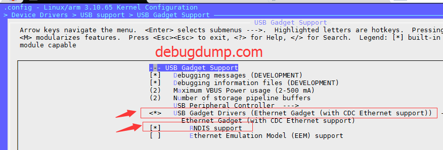

感谢 @szyusong 大神,  把 gadget驱动编译到内核就可以了.
可是问题来了,为什么编译成模块安装不行呢?

直接编译到内核, 模块方式暂时不行,问题未知。
Ubuntu Linux 跑 RIDIS 基本正常。
Win7 枚举正常,得找个驱动装装.

https://whycan.cn/files/members/1028/RNDIS.rar
#43 2018-09-22 19:25:28
已发帖子: 9,441
ippen 说:
谢谢,一会我试一试。

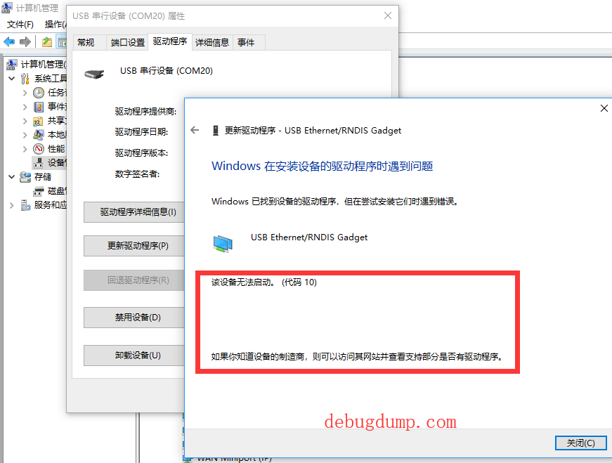

#44 2018-09-22 22:25:12
已发帖子: 9,441
装上了楼上朋友的驱动程序,果然设备无法启动,代码10.
放狗搜了一圈
https://social.technet.microsoft.com/Forums/lync/en-US/04195a63-4c57-4881-a17f-47b823452849/rndis-over-usb-device-works-on-some-installs-of-windows-10-but-not-others-?forum=win10itprohardware
权威答案:
我终于想通了。
由于响应时间的原因,设备未能成功完成某些信息的枚举。IE usb设备在枚举期间没有响应足够的时间。
一旦我修复了这个问题,我就能成功运行设备而不会出现ErrorCode 10问题。
看来得改gadget驱动了。

https://whycan.cn/files/members/3/QQ20180922222312.png
放狗搜了一圈
权威答案:
我终于想通了。
看来得改gadget驱动了。
在 Windows 下可以使用 Bus Hound 抓包分析,我前面的帖子有写抓包的内容,问题出在中断节点 0x84 无法传输数据造成的。Windows下 RNDIS 驱动需要通过中断节点获取 device 的网卡状态变化及数据是否就绪等信息,因此中断节点无法通讯,RNDIS 就无法使用。而 RNDIS 在 Linux 下使用时,好像不会用到中断节点,所以没问题。

楼主 #52 2018-09-23 10:18:24
szyusong
注册时间: 2018-09-08
已发帖子: 35
积分: 35
https://whycan.cn/files/members/3/QQ20180922174301.png
https://whycan.cn/files/members/3/QQ20180922173703.png
https://whycan.cn/files/members/3/QQ20180922174606.png
Win7 枚举正常,得找个驱动装装.
在 windows 下安装 RNDIS 驱动只需要用 kernel 目录下的 Documentation/usb/linux.inf 手动安装就可以。

3.10 内核的 RNDIS 搞定了。
f1c100s 的手册中关于 USB 有这样的说明:
Supports up to 3 User-Configurable Endpoints for Bulk , Isochronous, Control and Interrupt
bi-directional transfers (Endpoint1, Endpoint2)
支持 INT 传输的只有 EP1 和 EP2,目前代码采用的是 EP4,是无法工作的。
按如下修改后,在 Windows 下 RNDIS 没问题了。
static const char ep0name [] = "ep0";
static const char ep1in_bulk_name []  = "ep1in-bulk";
static const char ep1out_bulk_name [] = "ep1out-bulk";
#if 1
static const char ep2in_bulk_name []  = "ep2-int"; // 作为 INT 节点,为了 usb_ep_autoconfig 能查询到
#else
static const char ep2in_bulk_name []  = "ep2in-bulk";
static const char ep2out_bulk_name [] = "ep2out-bulk";
static const char ep3_iso_name []     = "ep3-iso";
static const char ep4_int_name []     = "ep4-int";
static const char ep5in_bulk_name []  = "ep5in-bulk";
static const char ep5out_bulk_name [] = "ep5out-bulk";
	.ep[3] = {
		.num			= 2,
		.ep = {
			.name		= ep2in_bulk_name,
			.ops		= &sunxi_udc_ep_ops,
			.maxpacket	= SW_UDC_EP_FIFO_SIZE,
		.dev		        = &sunxi_udc,
		//.fifo_size	        = SW_UDC_EP_FIFO_SIZE,
		.bEndpointAddress   = (USB_DIR_IN | 2),
#if 1
		.bmAttributes	    = USB_ENDPOINT_XFER_INT,
#else
		.bmAttributes	    = USB_ENDPOINT_XFER_BULK,
按 @szyusong 大神 62#的修改, 装上 52# 的驱动, 看起来终于正常了!
接下来配个ip通讯试一试.
#65 2018-09-25 08:59:30
已发帖子: 9,441

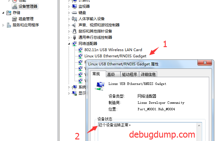

Windows RNDIS 工作看起来正常了, 再次感谢 @szyusong !

昨天我测试的时候,看到数据传输有停顿的情况,抓包看,两次传输数据有时间隔20秒,一直怀疑是中断问题,因为每次传数据都有irq reset,正发毛...........

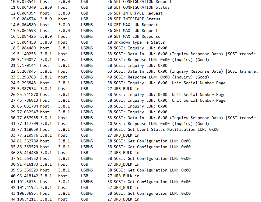

mass_storage 模块还是不能用
截图
从主机抓包,抓到的数据不是连续的,时间是跳跃的,0秒,5秒,25秒,45秒,66秒等,不知道系统卡在哪个环节了
