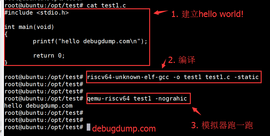

编译qemu模拟器:
sudo apt-get install libpixman-1-dev
git clone https://github.com/riscv/riscv-qemu.git
cd riscv-qemu/
git checkout riscv-qemu-3.0
./configure
make -j4
make install ###安装

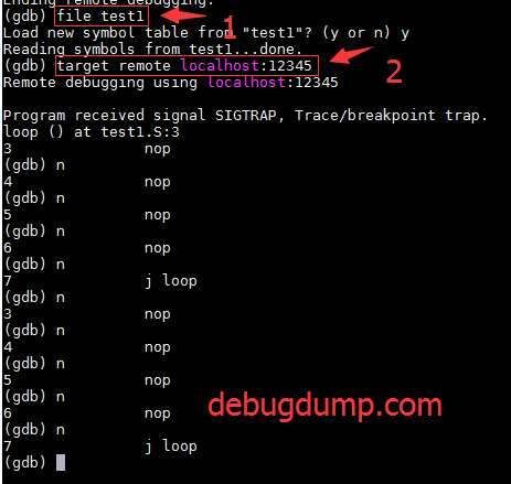

楼主 #6 2018-09-26 11:39:21
Re: risc-v gcc 工具链编译 与 qemu 虚拟机 (ubuntu等发行版linux平台搭建RISCV模拟环境)
test1.S
loop:
nop
nop
nop
nop
j loop
编译(带调试符号):
riscv64-unknown-elf-gcc -save-temps -nostdlib -nostartfiles -ffreestanding -o test1 test1.S -g
启动带调试虚拟机:
qemu-riscv64 -singlestep -g 12345 test1 -nographic
远程调试:
riscv64-unknown-elf-gdb
参考1: http://doppioandante.github.io/2015/07/10/Simple-ARM-programming-on-linux.html

好像一定要用静态链接, 否则会这样:
$ riscv64-linux-gnu-gcc -o hello hello.c
$ qemu-riscv64 hello
qemu-riscv64: Could not open '/lib/ld-linux-riscv64-lp64d.so.1': No such file or directory
#16 2021-06-20 12:38:49
cube
注册时间: 2021-03-11
已发帖子: 288
积分: 202.5
https://askubuntu.com/questions/1144537/arm-32-bit-elf-does-not-execute-using-qemu-arm
按这个加上 LD_LIBRARY_PATH 没用?
$ LD_LIBRARY_PATH=/usr/riscv64-linux-gnu/ qemu-riscv64 hello
$ LD_LIBRARY_PATH=/usr/riscv64-linux-gnu/lib/ qemu-riscv64 hello
#17 2021-06-20 12:40:10
cube
注册时间: 2021-03-11
已发帖子: 288
积分: 202.5
终于搞定, 不是设置LD_LIBRARY_PATH环境变量, 而是加 -L 参数:
$qemu-riscv64 -L /usr/riscv64-linux-gnu/ hello
hello
或者用 QEMU_LD_PREFIX 环境变量:
QEMU_LD_PREFIX=/usr/riscv64-linux-gnu/ qemu-riscv64 hello
参考: https://stackoverflow.com/questions/16158994/how-to-solve-error-while-loading-shared-libraries-when-trying-to-run-an-arm-bi
