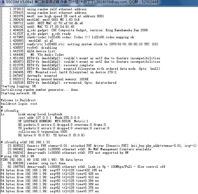

v3s 适配ethernet编译问题
按照http://zero.lichee.pro/%E8%B4%A1%E7%8C%AE/article%206.html教程进行zero适配Ethernet,修改dts和dtsi文件后进行u-boot编译,但是在编译过程中出现编译错误
Error: ./arch/arm/dts/sun8i-v3s.dtsi:290.40-41 syntax error
FATAL ERROR: Unable to parse input tree
scripts/Makefile.lib:322: recipe for target 'arch/arm/dts/sun8i-v3s-licheepi-zero.dtb' failed
make[2]: *** [arch/arm/dts/sun8i-v3s-licheepi-zero.dtb] Error 1
dts/Makefile:36: recipe for target 'arch-dtbs' failed
make[1]: *** [arch-dtbs] Error 2
Makefile:844: recipe for target 'dts/dt.dtb' failed
make: *** [dts/dt.dtb] Error 2
请问是什么问题?

楼主 #3 2018-10-23 14:50:45
605364021
注册时间: 2018-10-23
已发帖子: 251
积分: 251
Re: v3s 适配ethernet编译问题
谢谢回复,我在对dtsi290行进行修改后再次编译,又出现了
ERROR (duplicate_property_names): Duplicate property name clocks in /soc/ethernet@1c30000
ERROR: Input tree has errors, aborting (use -f to force output)
make[2]: *** [arch/arm/dts/sun8i-v3s-licheepi-zero.dtb] Error 2

楼主 #12 2018-10-23 15:51:29
605364021
注册时间: 2018-10-23
已发帖子: 251
积分: 251
贴上日志看下
=> ping 192.168.126.1
*** ERROR: `ipaddr' not set
ping failed; host 192.168.126.1 is not alive
楼主 #13 2018-10-23 15:57:56
605364021
注册时间: 2018-10-23
已发帖子: 251
积分: 251
我进行ipaddr设置后串口调试端是这样
=> setenv ipaddr 192.168.1.100
Using ethernet@1c30000 device
ARP Retry count exceeded; starting again

楼主 #17 2018-10-23 16:18:11
605364021
注册时间: 2018-10-23
已发帖子: 251
积分: 251
setenv ipaddr 192.168.126.100
setenv netmask 255.255.255.0
你的 ip地址设置错了。
=> setenv ipaddr 192.168.126.100
=> setenv netmask 255.255.255.0
=> saveenv
Saving Environment to MMC...
Writing to MMC(0)... done
还是ping不通,但是我在ubuntu上可以ping通
zhang@zhang-virtual-machine:~/u-boot$ ping 192.168.126.1
PING 192.168.126.1 (192.168.126.1) 56(84) bytes of data.
64 bytes from 192.168.126.1: icmp_seq=1 ttl=64 time=0.185 ms
64 bytes from 192.168.126.1: icmp_seq=2 ttl=64 time=0.486 ms
64 bytes from 192.168.126.1: icmp_seq=3 ttl=64 time=0.491 ms
64 bytes from 192.168.126.1: icmp_seq=4 ttl=64 time=0.505 ms
64 bytes from 192.168.126.1: icmp_seq=5 ttl=64 time=0.506 ms
64 bytes from 192.168.126.1: icmp_seq=6 ttl=64 time=0.656 ms
^C
--- 192.168.126.1 ping statistics ---
6 packets transmitted, 6 received, 0% packet loss, time 5000ms
rtt min/avg/max/mdev = 0.185/0.471/0.656/0.142 ms
还有就是v3s开发板需要接网线吗?...

我在串口调试助手上输入ifconfig eth0 up
Welcome to Buildroot
buildroot login: root
# ifconfig eth0 up
ifconfig: SIOCGIFFLAGS: No such device
这会是什么原因吗?
#23 2018-10-23 17:02:48
u-boot 和 linux kernel 的设备树和驱动都是不共用的,
u-boot设置过的,linux kernel 仍然要重新来一次。

我重新移植了linux上的Zimage和dock.dtb文件进tf卡中,但在串口端还是
# ifconfig eth0 up

#30 2018-10-23 18:06:01
明显驱动和dts没配好,本坛搜一下。

# ping 192.168.126.1
PING 192.168.126.1 (192.168.126.1): 56 data bytes
ping: sendto: Network is unreachable
# ifconfig eth0 up
是需要将网线把zero和pc连在一起才能ping通?我刚才试过连在一起也ping不通

U-Boot 2017.01-rc2-00057-g32ab180-dirty (Oct 23 2018 - 15:04:07 +0800) Allwinner Technology
Model: Lichee Pi Zero
DRAM:  64 MiB
MMC:   SUNXI SD/MMC: 0
In:    serial@01c28000
Out:   serial@01c28000
Err:   serial@01c28000
Net:   phy interface0
eth0: ethernet@1c30000
这是板子的启动信息,驱动应该是写进去了的
#37 2018-10-23 23:14:22
v3s
注册时间: 2017-09-08
已发帖子: 105
积分: 105
很明显你在linux没有驱动网卡啊,
uboot驱动了,不代表不用在linux驱动,
他们是独立存在的,
linux仍然要再配置驱动和设备树。
此人很懒,没有签名!

#39 2018-10-23 23:33:50
v3s
注册时间: 2017-09-08
已发帖子: 105
积分: 105
605364021 wrote:
v3s wrote:
很明显你在linux没有驱动网卡啊,
他们是独立存在的,
linux仍然要再配置驱动和设备树。
我按照教程修改了.dtsi文件和.dts文件,并且重新编译了zimge和.dtb文件,把这2个文件拉到了tf卡上。至于您说的linux配置驱动和设备树是修改.dtsi和.dts文件吗?
是的,看下启动日志,网卡有没有驱动起来。
拔插网线,终端有没有提示
此人很懒,没有签名!

晕哥好热心
这是我编译好的uboot, linux&dtb, rootfs: V3s_TFCard.7z
荔枝派Zero 开发板网卡确认没有问题:
/files/members/3/QQ20171215150950.jpg
你试一试, 有什么问题在后面跟帖。
进行ping通的时候 需要用网线将笔记本和开发板连在一起?

插笔记本也可以, 插交换机也行,只要能通。
现在网卡都很人性化了,自适应,随便接随便插。
