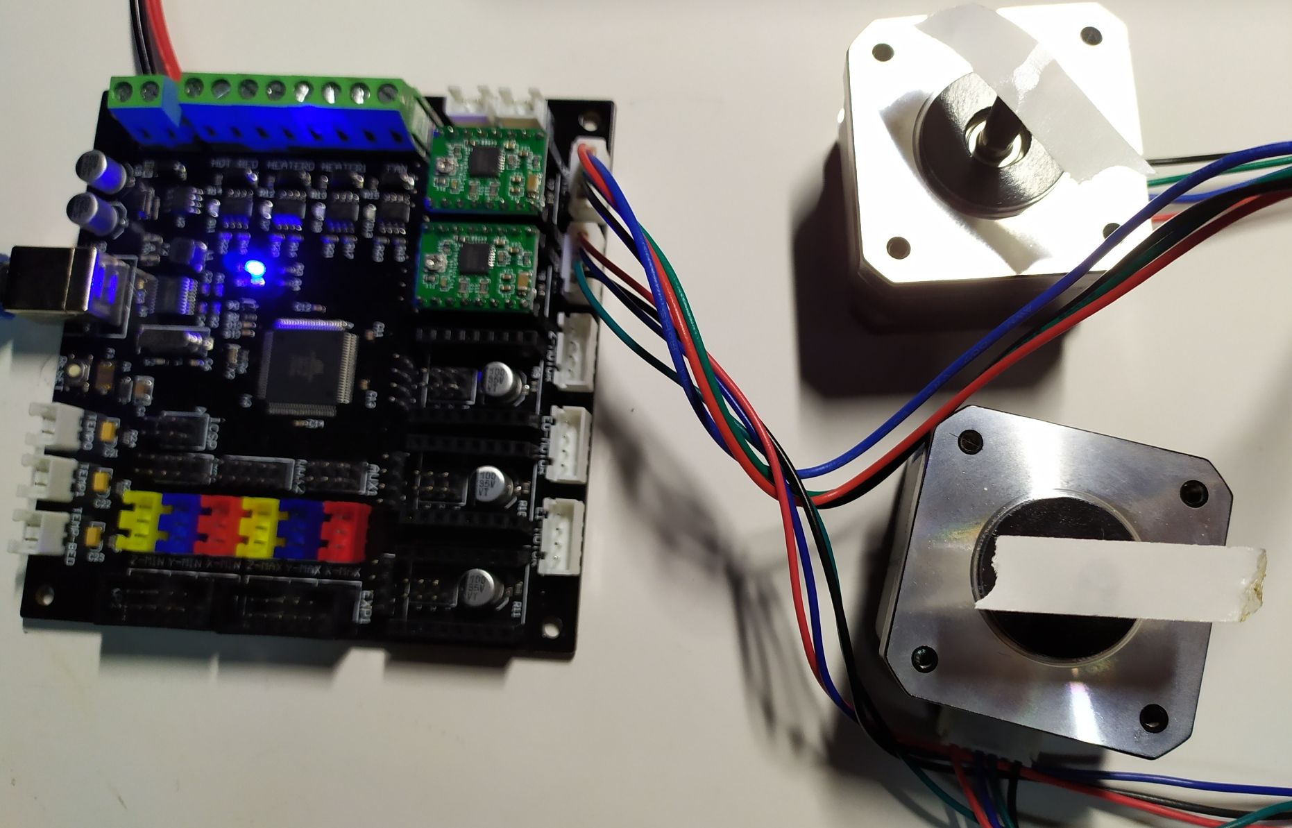

Arduino下驱动步进电机
都是借来的代码 (https://reprap.org/forum/read.php?219,166111,711833#msg-711833)
#define X_STEP_PIN 54
#define X_DIR_PIN 55
#define X_ENABLE_PIN 38
#include "AccelStepper.h"
AccelStepper stepper(1, X_ENABLE_PIN, X_STEP_PIN, X_DIR_PIN);
void setup()
  pinMode(X_ENABLE_PIN , OUTPUT);
  digitalWrite(X_ENABLE_PIN , LOW);
  stepper.setSpeed(400);
void loop()
   stepper.runSpeed();
还需要借下面的两个文件:
https://raw.githubusercontent.com/adafruit/AccelStepper/master/AccelStepper.cpp
https://raw.githubusercontent.com/adafruit/AccelStepper/master/AccelStepper.h
项目地址:
https://github.com/adafruit/AccelStepper

楼主 #3 2019-02-26 20:36:24
Re: Arduino下驱动步进电机
void setup() {
    pinMode(X_STEP_PIN  , OUTPUT);
    pinMode(X_DIR_PIN    , OUTPUT);
void loop () {
  digitalWrite(X_DIR_PIN    , HIGH);
  digitalWrite(X_STEP_PIN, LOW);
  delay(1);//delay ms
  digitalWrite(X_STEP_PIN, HIGH);
GPIO 模拟PWM驱动步进电机.
