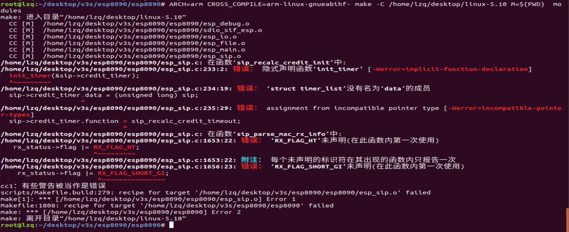

V3S主线驱动wifi-esp8089
参考了几位网友的帖子,wifi还是没有调通,特来开一贴,求教各位大神
下面附上我搬来大神的资源
ESP8089.pdf
esp8089-cleanup.zip
第一个是操作步骤  第二是源码。按照大神步骤来配置内核,不知道为何, 打死他都没有去编译这源码。求教!

#3 2019-03-13 14:41:10
已发帖子: 9,437
Re: V3S主线驱动wifi-esp8089
1. 克隆代码:
2. 修改 Makefile:
obj-$(CONFIG_ESP8089) := esp8089.o
改为:
obj-m := esp8089.o
3. 编译:
ARCH=arm CROSS_COMPILE=arm-linux-gnueabihf- make -C /opt/linux-v3s/ M=${PWD}  modules
4. 修复一个编译错误, 参考: https://github.com/lwfinger/rtlwifi_new/issues/247
step 1: sudo vim /usr/src/linux-headers-$(uname -r)/include/net/mac80211.h
(Note: taking backup of the file is recommended).
step 2 : comment this enum: "enum mac80211_rx_flags { }"
step 3 : Add the following instead:
RX_FLAG_MMIC_ERROR = BIT(0),
RX_FLAG_DECRYPTED = BIT(1),
RX_FLAG_MACTIME_PLCP_START = BIT(2),
RX_FLAG_MMIC_STRIPPED = BIT(3),
RX_FLAG_IV_STRIPPED = BIT(4),
RX_FLAG_FAILED_FCS_CRC = BIT(5),
RX_FLAG_FAILED_PLCP_CRC = BIT(6),
RX_FLAG_MACTIME_START = BIT(7),
RX_FLAG_SHORTPRE = BIT(8),
RX_FLAG_HT = BIT(9),
RX_FLAG_40MHZ = BIT(10),
RX_FLAG_SHORT_GI = BIT(11),
RX_FLAG_NO_SIGNAL_VAL = BIT(12),
RX_FLAG_HT_GF = BIT(13),
RX_FLAG_AMPDU_DETAILS = BIT(14),
RX_FLAG_PN_VALIDATED = BIT(15),
RX_FLAG_DUP_VALIDATED = BIT(16),
RX_FLAG_AMPDU_LAST_KNOWN = BIT(17),
RX_FLAG_AMPDU_IS_LAST = BIT(18),
RX_FLAG_AMPDU_DELIM_CRC_ERROR = BIT(19),
RX_FLAG_AMPDU_DELIM_CRC_KNOWN = BIT(20),
RX_FLAG_MACTIME_END = BIT(21),
RX_FLAG_VHT = BIT(22),
RX_FLAG_LDPC = BIT(23),
RX_FLAG_ONLY_MONITOR = BIT(24),
RX_FLAG_SKIP_MONITOR = BIT(25),
RX_FLAG_STBC_MASK = BIT(26) | BIT(27),
RX_FLAG_10MHZ = BIT(28),
RX_FLAG_5MHZ = BIT(29),
RX_FLAG_AMSDU_MORE = BIT(30),
RX_FLAG_RADIOTAP_VENDOR_DATA = BIT(31),
RX_FLAG_MIC_STRIPPED = BIT_ULL(32),
RX_FLAG_ALLOW_SAME_PN = BIT_ULL(33),

#5 2019-11-11 08:48:13
cris8259
注册时间: 2019-09-25
已发帖子: 283
积分: 82
照样编译不通过,缺少RX_FLAG_ICV_STRIPPED定义

#7 2020-06-30 10:47:43
流氓兔
注册时间: 2020-02-01
已发帖子: 121
积分: 109.5
        RX_FLAG_NO_SIGNAL_VAL           = BIT(8),
        RX_FLAG_AMPDU_DETAILS           = BIT(9),
        RX_FLAG_PN_VALIDATED            = BIT(10),
        RX_FLAG_DUP_VALIDATED           = BIT(11),
        RX_FLAG_AMPDU_LAST_KNOWN        = BIT(12),
        RX_FLAG_AMPDU_IS_LAST           = BIT(13),
        RX_FLAG_AMPDU_DELIM_CRC_ERROR   = BIT(14),
        RX_FLAG_AMPDU_DELIM_CRC_KNOWN   = BIT(15),
        RX_FLAG_MACTIME_END             = BIT(16),
        RX_FLAG_ONLY_MONITOR            = BIT(17),
        RX_FLAG_SKIP_MONITOR            = BIT(18),
        RX_FLAG_AMSDU_MORE              = BIT(19),
        RX_FLAG_RADIOTAP_VENDOR_DATA    = BIT(20),
        RX_FLAG_MIC_STRIPPED            = BIT(21),
        RX_FLAG_ALLOW_SAME_PN           = BIT(22),
        RX_FLAG_ICV_STRIPPED            = BIT(23),
代码这里下载的: https://github.com/Lichee-Pi/esp8089
本站下载: 8e51684e3ee49a3e384fcaee9d7841d6.7z
运行平台: V3s Linux 4.13-y
感谢楼上大神们分享, 搞定了。

按照晕哥的步骤出现这个问题以前在那好像见过说是linux4.15版本的temer改动了。然后不知道怎么操作了,求大神指导下
axxx@ubuntu:~/licheepi/esp8089_driver/esp8089$ ARCH=arm CROSS_COMPILE=arm-linux-gnueabihf- make -C /home/axxx/licheepi/linux M=${PWD}  modules
make: Entering directory '/home/axxx/licheepi/linux'
  CC [M]  /home/axxx/licheepi/esp8089_driver/esp8089/esp_debug.o
  CC [M]  /home/axxx/licheepi/esp8089_driver/esp8089/sdio_sif_esp.o
  CC [M]  /home/axxx/licheepi/esp8089_driver/esp8089/esp_io.o
  CC [M]  /home/axxx/licheepi/esp8089_driver/esp8089/esp_file.o
  CC [M]  /home/axxx/licheepi/esp8089_driver/esp8089/esp_main.o
  CC [M]  /home/axxx/licheepi/esp8089_driver/esp8089/esp_sip.o
/home/axxx/licheepi/esp8089_driver/esp8089/esp_sip.c: In function ‘sip_recalc_credit_init’:
/home/axxx/licheepi/esp8089_driver/esp8089/esp_sip.c:233:2: error: implicit declaration of function ‘init_timer’; did you mean ‘init_timers’? [-Werror=implicit-function-declaration]
  init_timer(&sip->credit_timer);
  init_timers
/home/axxx/licheepi/esp8089_driver/esp8089/esp_sip.c:234:19: error: ‘struct timer_list’ has no member named ‘data’
  sip->credit_timer.data = (unsigned long) sip;
/home/axxx/licheepi/esp8089_driver/esp8089/esp_sip.c:235:29: error: assignment to ‘void (*)(struct timer_list *)’ from incompatible pointer type ‘void (*)(long unsigned int)’ [-Werror=incompatible-pointer-types]
  sip->credit_timer.function = sip_recalc_credit_timeout;
/home/axxx/licheepi/esp8089_driver/esp8089/esp_sip.c: In function ‘sip_parse_mac_rx_info’:
/home/axxx/licheepi/esp8089_driver/esp8089/esp_sip.c:1653:22: error: ‘RX_FLAG_HT’ undeclared (first use in this function); did you mean ‘RX_ENC_HT’?
   rx_status->flag |= RX_FLAG_HT;
                      RX_ENC_HT
/home/axxx/licheepi/esp8089_driver/esp8089/esp_sip.c:1653:22: note: each undeclared identifier is reported only once for each function it appears in
/home/axxx/licheepi/esp8089_driver/esp8089/esp_sip.c:1656:23: error: ‘RX_FLAG_SHORT_GI’ undeclared (first use in this function); did you mean ‘RX_ENC_FLAG_SHORT_GI’?
    rx_status->flag |= RX_FLAG_SHORT_GI;
cc1: some warnings being treated as errors
scripts/Makefile.build:316: recipe for target '/home/axxx/licheepi/esp8089_driver/esp8089/esp_sip.o' failed
make[1]: *** [/home/axxx/licheepi/esp8089_driver/esp8089/esp_sip.o] Error 1
Makefile:1508: recipe for target '_module_/home/axxx/licheepi/esp8089_driver/esp8089' failed
make: *** [_module_/home/axxx/licheepi/esp8089_driver/esp8089] Error 2
make: Leaving directory '/home/axxx/licheepi/linux'

@axxx
我也碰到了相同的问题,请问一下你解决了吗
