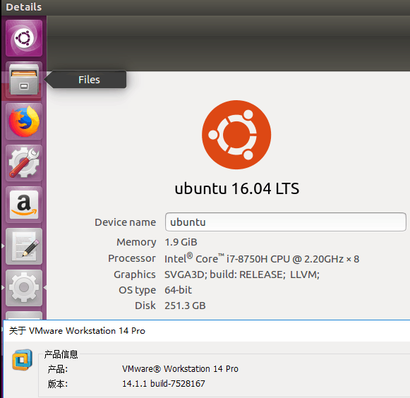

终于搞定 Workstation 14 + ubuntu 16.04LTS 宿主机与客户机不能共享剪贴板问题了.
VMware® Workstation 14 Pro
14.1.1 build-7528167
ubuntu 16.04LTS
不能与宿主机共享剪贴板问题了:

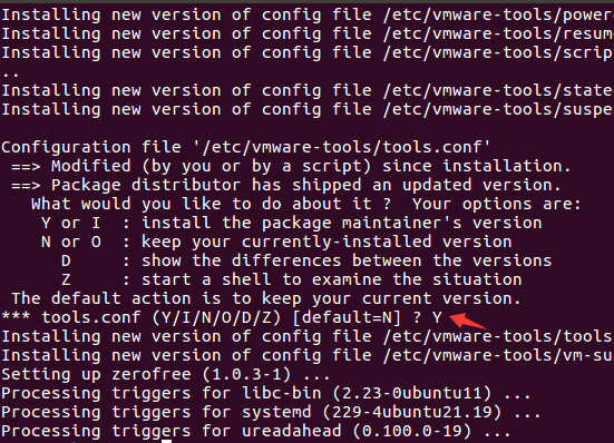

sudo apt-get autoremove open-vm-tools
sudo apt-get install -y open-vm-tools
sudo apt-get install -y open-vm-tools-desktop

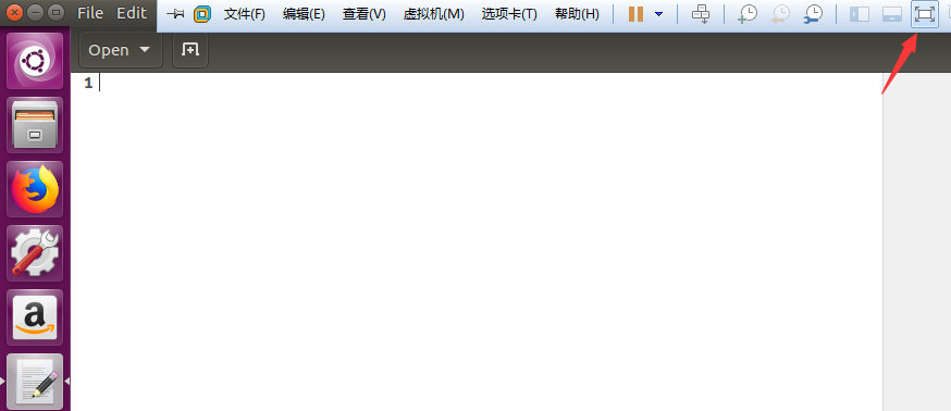

按上面一顿猛操作之后, 剪贴板正常了, 连点击 vmware 上面的全屏, ubuntu 也能跟着全屏(自动调整分辨率)了.
https://askubuntu.com/questions/691585/copy-paste-and-dragdrop-not-working-in-vmware-machine-with-ubuntu/824341#824341
这里输入 Y 强制升级
