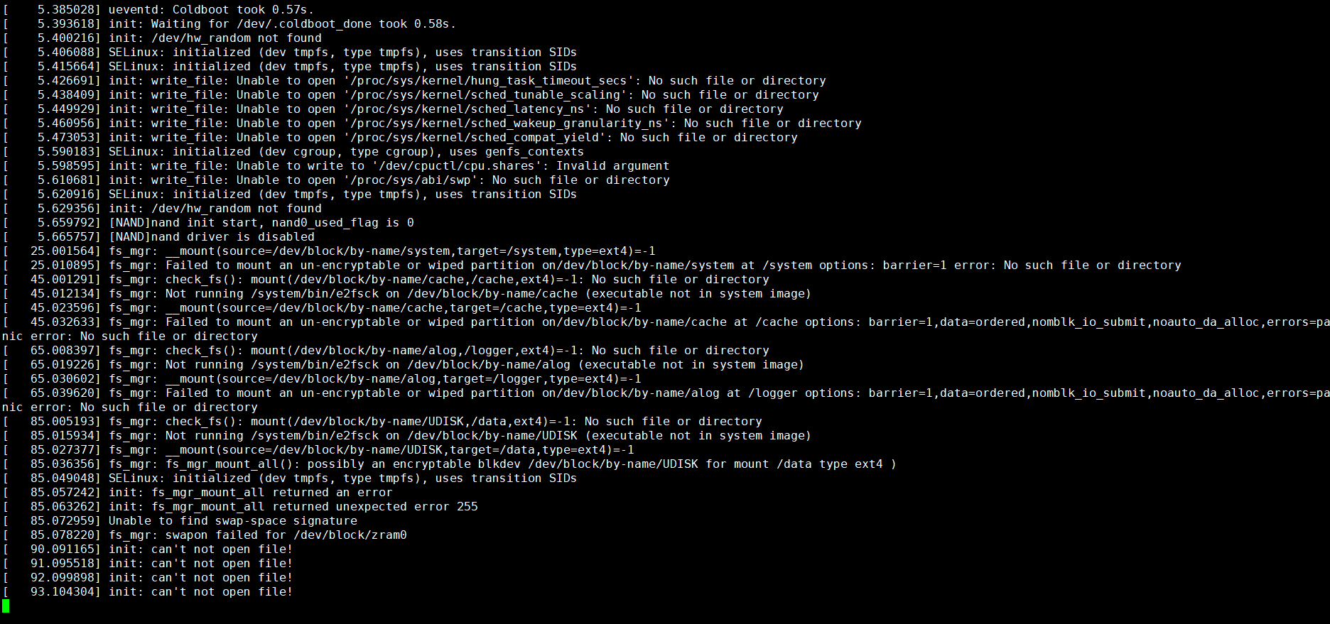

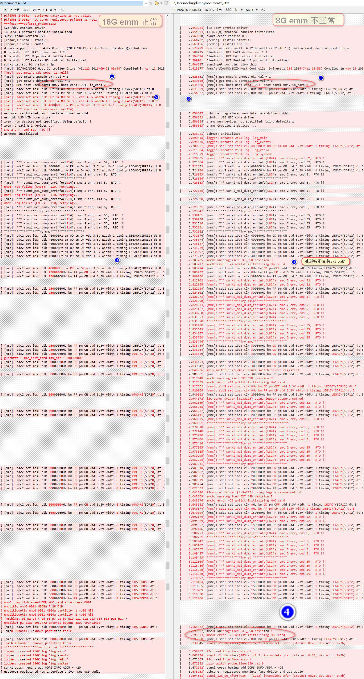

在A83T平台接8G大小的emmc烧录完后,系统不能启动。日志如附件,求大神帮忙看下啥问题。谢谢!

[    0.000000] Linux version 3.4.39 (pengchj@WorldChip) (gcc version 4.6.3 20120201 (prerelease) (crosstool-NG linaro-1.13.1-2012.02-20120222 - Linaro GCC 2012.02) ) #2 SMP PREEMPT Wed May 15 20:10:54 CST 2019
[    0.000000] Machine: sun8i
[    0.000000] Initialized persistent memory from 43084800-430947ff
[    0.000000] cma: CMA: reserved 512 MiB at a0000000
[    0.000000] Memory policy: ECC disabled, Data cache writealloc
[    0.000000] On node 0 totalpages: 524288
[    0.000000] free_area_init_node: node 0, pgdat c0948e40, node_mem_map c1402000
[    0.000000]   Normal zone: 1404 pages used for memmap
[    0.000000]   Normal zone: 158340 pages, LIFO batch:31
[    0.000000]   HighMem zone: 3204 pages used for memmap
[    0.000000]   HighMem zone: 361340 pages, LIFO batch:31
[    0.000000] [mcpm_smp_init_cpus] ncores=8
[    0.000000] PERCPU: Embedded 8 pages/cpu @c2627000 s10752 r8192 d13824 u32768
[    0.000000] pcpu-alloc: s10752 r8192 d13824 u32768 alloc=8*4096
[    0.000000] pcpu-alloc: [0] 0 [0] 1 [0] 2 [0] 3 [0] 4 [0] 5 [0] 6 [0] 7
[    0.000000] Built 1 zonelists in Zone order, mobility grouping on.  Total pages: 519680

[    3.912971] Bluetooth: RFCOMM TTY layer initialized
[    3.918506] Bluetooth: RFCOMM socket layer initialized
[    3.924313] Bluetooth: RFCOMM ver 1.11
[    3.928597] Bluetooth: BNEP (Ethernet Emulation) ver 1.3
[    3.934578] Bluetooth: BNEP filters: protocol multicast
[    3.940443] Bluetooth: HIDP (Human Interface Emulation) ver 1.2
[    3.947554] ThumbEE CPU extension supported.
[    3.952396] Registering SWP/SWPB emulation handler
[    3.959537] rtc_gettime(340): read time 1970-1-1 1:0:8
[    3.965359] rtc0 rtc0: setting system clock to 1970-01-01 01:00:08 UTC (3608)
[    3.974309] sunxi_get_soc_bin: slow chip
[    3.979194] CPU Budget:Register notifier
[    3.983733] CPU Budget:register Success
[    3.988051] sunxi-budget-cooling sunxi-budget-cooling: Cooling device registered: thermal-budget-0
[    4.002349] =========GPS========= :gsp not used in configuration
[    4.009075] ALSA device list:
[    4.012458]   #0: sndac100
[    4.015580]   #1: sndhdmi
[    4.019192] Freeing init memory: 324K
[    4.025712] init: init started!
[    4.033712] SELinux: 2048 avtab hash slots, 5054 rules.
[    4.039692] SELinux:  Android master kernel running Android M policy in compatibility mode.
[    4.051236] SELinux: 2048 avtab hash slots, 5054 rules.
[    4.057144] SELinux:  1 users, 2 roles, 540 types, 0 bools, 1 sens, 1024 cats
[    4.065366] SELinux:  87 classes, 5054 rules
[    4.072126] SELinux:  Completing initialization.
[    4.077391] SELinux:  Setting up existing superblocks.
[    4.083228] SELinux: initialized (dev sysfs, type sysfs), uses genfs_contexts
[    4.091339] SELinux: initialized (dev rootfs, type rootfs), uses genfs_contexts
[    4.099627] SELinux: initialized (dev bdev, type bdev), not configured for labeling
[    4.108325] SELinux: initialized (dev proc, type proc), uses genfs_contexts
[    4.116220] SELinux: initialized (dev tmpfs, type tmpfs), uses transition SIDs
[    4.124359] SELinux: initialized (dev devtmpfs, type devtmpfs), uses transition SIDs
[    4.133631] SELinux: initialized (dev debugfs, type debugfs), uses genfs_contexts
[    4.155613] SELinux: initialized (dev sockfs, type sockfs), uses task SIDs
[    4.163418] SELinux: initialized (dev pipefs, type pipefs), uses task SIDs
[    4.171235] SELinux: initialized (dev anon_inodefs, type anon_inodefs), not configured for labeling
[    4.181466] SELinux: initialized (dev devpts, type devpts), uses transition SIDs
[    4.189807] SELinux: initialized (dev selinuxfs, type selinuxfs), uses genfs_contexts
[    4.198740] SELinux: initialized (dev tmpfs, type tmpfs), uses transition SIDs
[    4.206932] SELinux: initialized (dev sysfs, type sysfs), uses genfs_contexts
[    4.210051] switch_status_update,line:179,switch_data->state:0
[    4.390034] switch_status_update,line:179,switch_data->state:0
[    4.417050] type=1403 audit(3608.940:2): policy loaded auid=4294967295 ses=4294967295
[    4.426434] type=1404 audit(3608.960:3): enforcing=1 old_enforcing=0 auid=4294967295 ses=4294967295
[    4.650232] init: (Initializing SELinux enforcing took 0.62s.)
[    4.663640] init: init second stage started!
[    4.709919] init: waitpid failed: No child processes
[    4.715925] init: (Loading properties from /default.prop took 0.00s.)
[    4.725312] init: (Parsing /init.environ.rc took 0.00s.)
[    4.731582] init: (Parsing /init.usb.rc took 0.00s.)
[    4.737966] init: (Parsing init.sensors.rc took 0.00s.)
[    4.743924] init: (Parsing init.common.rc took 0.01s.)
[    4.749849] init: (Parsing init.sun8i.common.rc took 0.00s.)
[    4.756435] init: (Parsing init.sun8i.usb.rc took 0.00s.)
[    4.762574] init: (Parsing /init.sun8i.rc took 0.03s.)
[    4.768727] init: (Parsing /init.usb.configfs.rc took 0.00s.)
[    4.775288] init: (Parsing /init.zygote32.rc took 0.00s.)
[    4.781544] init: (Parsing /init.trace.rc took 0.00s.)
[    4.787329] init: (Parsing /init.rc took 0.06s.)
[    4.792772] init: SELinux: Could not get canonical path /adb_keys restorecon: No such file or directory.
[    4.803510] init: Starting service 'ueventd'...
[    4.809294] init: Waiting for /dev/.coldboot_done...
[    4.811911] ueventd: ueventd started!
[    5.384952] ueventd: Coldboot took 0.57s.
[    5.393428] init: Waiting for /dev/.coldboot_done took 0.58s.
[    5.399984] init: /dev/hw_random not found
[    5.405846] SELinux: initialized (dev tmpfs, type tmpfs), uses transition SIDs
[    5.415432] SELinux: initialized (dev tmpfs, type tmpfs), uses transition SIDs
[    5.426478] init: write_file: Unable to open '/proc/sys/kernel/hung_task_timeout_secs': No such file or directory
[    5.438165] init: write_file: Unable to open '/proc/sys/kernel/sched_tunable_scaling': No such file or directory
[    5.449653] init: write_file: Unable to open '/proc/sys/kernel/sched_latency_ns': No such file or directory
[    5.460674] init: write_file: Unable to open '/proc/sys/kernel/sched_wakeup_granularity_ns': No such file or directory
[    5.472735] init: write_file: Unable to open '/proc/sys/kernel/sched_compat_yield': No such file or directory
[    5.590183] SELinux: initialized (dev cgroup, type cgroup), uses genfs_contexts
[    5.598602] init: write_file: Unable to write to '/dev/cpuctl/cpu.shares': Invalid argument
[    5.610666] init: write_file: Unable to open '/proc/sys/abi/swp': No such file or directory
[    5.620906] SELinux: initialized (dev tmpfs, type tmpfs), uses transition SIDs
[    5.629340] init: /dev/hw_random not found
[    5.659757] [NAND]nand init start, nand0_used_flag is 0
[    5.665720] [NAND]nand driver is disabled
[   25.001496] fs_mgr: __mount(source=/dev/block/by-name/system,target=/system,type=ext4)=-1
[   25.010824] fs_mgr: Failed to mount an un-encryptable or wiped partition on/dev/block/by-name/system at /system options: barrier=1 error: No such file or directory
[   45.001140] fs_mgr: check_fs(): mount(/dev/block/by-name/cache,/cache,ext4)=-1: No such file or directory
[   45.011972] fs_mgr: Not running /system/bin/e2fsck on /dev/block/by-name/cache (executable not in system image)
[   45.023444] fs_mgr: __mount(source=/dev/block/by-name/cache,target=/cache,type=ext4)=-1
[   45.032470] fs_mgr: Failed to mount an un-encryptable or wiped partition on/dev/block/by-name/cache at /cache options: barrier=1,data=ordered,nomblk_io_submit,noauto_da_alloc,errors=panic error: No such file or directory
[   65.008100] fs_mgr: check_fs(): mount(/dev/block/by-name/alog,/logger,ext4)=-1: No such file or directory
[   65.018939] fs_mgr: Not running /system/bin/e2fsck on /dev/block/by-name/alog (executable not in system image)
[   65.030295] fs_mgr: __mount(source=/dev/block/by-name/alog,target=/logger,type=ext4)=-1
[   65.039311] fs_mgr: Failed to mount an un-encryptable or wiped partition on/dev/block/by-name/alog at /logger options: barrier=1,data=ordered,nomblk_io_submit,noauto_da_alloc,errors=panic error: No such file or directory
[   85.004897] fs_mgr: check_fs(): mount(/dev/block/by-name/UDISK,/data,ext4)=-1: No such file or directory
[   85.015631] fs_mgr: Not running /system/bin/e2fsck on /dev/block/by-name/UDISK (executable not in system image)
[   85.027088] fs_mgr: __mount(source=/dev/block/by-name/UDISK,target=/data,type=ext4)=-1
[   85.036077] fs_mgr: fs_mgr_mount_all(): possibly an encryptable blkdev /dev/block/by-name/UDISK for mount /data type ext4 )
[   85.048770] SELinux: initialized (dev tmpfs, type tmpfs), uses transition SIDs
[   85.056962] init: fs_mgr_mount_all returned an error
[   85.062980] init: fs_mgr_mount_all returned unexpected error 255
[   85.072680] Unable to find swap-space signature
[   85.077924] fs_mgr: swapon failed for /dev/block/zram0
[   90.090902] init: can't not open file!
[   91.095245] init: can't not open file!
[   92.099626] init: can't not open file!
[   93.104035] init: can't not open file!
[   94.108358] init: can't not open file!
[END] 2019/5/16 9:55:50

þHELLO! BOOT0 is starting!
boot0 version : 4.2.0
boot0 commit : ba81bb80fe217e401fc0bee185e0a53ba1a17e7d
rtc[1] value = 0x00010000
rtc[2] value = 0x00020000
rtc[3] value = 0x00030000
DRAM DRIVE INFO: V1.50
DRAM normal_mode value: 00000001
rsb_send_initseq: rsb clk 400Khz -> 3Mhz
PMU: AXP81X
ddr voltage = 1200 mv
ID CHECK VERSION: V0.3
using ic A83T
using axp AXP813
DRAM Type =7 (2:DDR2,3:DDR3,6:LPDDR2,7:LPDDR3)
DRAM CLK =648 MHZ
DRAM zq value: 00003bfb
dram size =2048
card boot number = 2
card no is 2
sdcard 2 line count 8
[mmc]: mmc driver ver 2015-04-13 16:05:39
[mmc]: ***Try SD card 2***
[mmc]: mmc 2 cmd 8 err 00000100
[mmc]: mmc 2 send if cond failed
[mmc]: mmc 2 cmd 55 err 00000100
[mmc]: mmc 2 send app cmd failed
[mmc]: ***Try MMC card 2***
[mmc]: mmc re-update_phase
[mmc]: 8bit ddr!!!
[mmc]: MMC ver 4.0
[mmc]: SD/MMC Card: 8bit, capacity: 7456MB
[mmc]: vendor: Man 0090014a Snr a110d280
[mmc]: product: H8G4a
[mmc]: revision: 9.2
[mmc]: ***SD/MMC 2 init OK!!!***
sdcard 2 init ok
The size of uboot is 000ec000.
sum=77d64102
src_sum=77d64102
set_mmc_para,sdly 50M 0
set_mmc_para,sdly 25M 0
Succeed in loading uboot from sdmmc flash.
Ready to disable icache.
Jump to secend Boot.
[      0.291]MODE
U-Boot 2011.09-rc1-00000-gba81bb8-dirty (Mar 21 2019 - 17:36:40) Allwinner Technology
[      0.300]version: 2.1.0
[      0.303]uboot commit : ba81bb80fe217e401fc0bee185e0a53ba1a17e7d
normal mode
[      0.329]pmbus:   normal or secure os
ready
[      0.333]PMU: AXP81X
[      0.336]PMU: AXP81X found
bat_vol=0, ratio=100
[      0.341]PMU: dcdc2 900
[      0.343]PMU: pll1 1008 Mhz
AXI0=336 Mhz,PLL_PERIPH =1200 Mhz AHB1=200 Mhz, APB1=100 Mhz
dcdc1_vol = 3000, onoff=1
dcdc2_vol = 900, onoff=1
dcdc3_vol = 900, onoff=1
dcdc4_vol = 900, onoff=1
dcdc6_vol = 900, onoff=1
aldo1_vol = 1800, onoff=1
aldo2_vol = 1800, onoff=1
aldo3_vol = 3000, onoff=1
eldo2_vol = 1800, onoff=0
eldo1_vol = 1200, onoff=0
dldo2_vol = 3300, onoff=0
dldo3_vol = 2800, onoff=0
dldo4_vol = 2800, onoff=0
fldo2_vol = 900, onoff=1
dldo1_vol = 3300, onoff=0
gpio0ldo_vol = 3300, onoff=0
find power_sply to end
supply=dcdc1
axp=axp81x, supply=dcdc1, vol=3000
reg addr=0x1c20b04, value=0xa, pmu_vol=3000
supply=dcdc1
reg addr=0x1c20b08, value=0xa, pmu_vol=3000
supply=aldo1
axp=axp81x, supply=aldo1, vol=1800
reg addr=0x1c20b0c, value=0x0, pmu_vol=1800
supply=dcdc1
reg addr=0x1c20b10, value=0xa, pmu_vol=3000
supply=dcdc1
reg addr=0x1c20b14, value=0xa, pmu_vol=3000
supply=dcdc1
reg addr=0x1c20b18, value=0xa, pmu_vol=3000
supply=dcdc1
reg addr=0x1c20b1c, value=0xa, pmu_vol=3000
supply=aldo3
axp=axp81x, supply=aldo3, vol=3000
reg addr=0x1f02f00, value=0xa, pmu_vol=3000
config gpio bias voltage finish
vbus exist
normal dc exist, limit to dc
ac100 reg 0x00 = 0x101
ac100 reg 0xd0 = 0x0
ac100 reg 0xd1 = 0x0
fel key old mode
run key detect
no key found
no key input
dram_para_set start
dram_para_set end
[      1.070]DRAM:  2 GiB
relocation Offset is: 75adf000
board.c 621
gic: secure os not exist
script config pll_de to 504 Mhz
Not Found clk pll_video1 in script
Not Found clk pll_video in script
Not Found clk pll_periph0 in script
============tv_init==========
DRV_DISP_Init end
[      1.389]fetch script data boot_disp.output_disp fail
[      1.394]fetch script data boot_disp.output_type fail
[      1.399]fetch script data boot_disp.output_mode fail
[      1.404]fetch script data boot_disp.auto_hpd fail
[      1.409]lcd0_para.lcd_used=1
disp0 device type(1) enable
disp 0, clk: pll(312000000),clk(312000000),dclk(78000000) dsi_rate(78000000)
     clk real:pll(312000000),clk(0),dclk(0) dsi_rate(78000000)
enable power vcc-mipi, ret=0
enable power vcc-dsi, ret=0
enable power vcc-pd, ret=0
workmode = 0
MMC:	 2
[      1.575][mmc]: mmc driver ver 2016-03-24 19:30:15
[      1.580][mmc]: get sdc_phy_wipe fail.
[      1.584][mmc]: get sdc0 sdc_erase fail.
[      1.588][mmc]: get sdc_2xmode ok, val = 1
[      1.592][mlcd model name D9366
use old lcd!!!
mc]: get sdc_ddrmode ok, val = 1
[      1.737][mmc]: get sdc_f_max fail,use default  50000000Hz
[      1.743][mmc]: get card_line ok, card_line = 8
[      1.747][mmc]: get sdc_ex_dly_used fail,use default
[      1.752][mmc]: SUNXI SD/MMC: 2
[      1.757][mmc]: mmc_config_clock: clk 400000
[      1.772][mmc]: *Try SD card 2*
[      1.777][mmc]: mmc 2 cmd 8 err 100
[      1.783][mmc]: mmc send if cond failed
[      1.788][mmc]: mmc 2 cmd 55 err 100
[      1.794][mmc]: send app cmd failed
[      1.797][mmc]: *Try MMC card 2*
[      1.849][mmc]: mmc_config_clock: clk 25000000
[      1.864][mmc]: mmc re-update_phase
[      1.871][mmc]: mmc re-update_phase
[      1.878][mmc]: mmc re-update_phase
[      1.884][mmc]: ddr8
[      1.888][mmc]: mmc re-update_phase
[      1.895][mmc]: mmc_config_clock: clk 25000000
[      1.905][mmc]: mmc_config_clock: clk 50000000
[      1.911][mmc]: CID 0x90014a48 0x38473461 0x92a110d2 0x802726b9
[      1.916][mmc]: MMC v5.1
[      1.919][mmc]: mmc clk 50000000
[      1.922][mmc]: SD/MMC Card: 8bit, capacity: 7456MB
[      1.927][mmc]: boot0 capacity: 4000KB,boot1 capacity: 4000KB
[      1.933][mmc]: ***SD/MMC 2 init OK!!!***
[      1.938][mmc]: erase_grp_size:0x400WrBlk * 0x200 = 0x80000 Byte
[      1.944][mmc]: secure_feature 0x55
[      1.947][mmc]: secure_removal_type  0x3b
[      1.951]sunxi flash init ok

[    4.641843] [NAND]nand init start, nand0_used_flag is 0
[    4.647740] [NAND]nand driver is disabled
[    4.654603] [mmc]: sdc2 set ios: clk 50000000Hz bm PP pm ON vdd 3.3V width 8 timing UHS-DDR50 dt B
[    4.675466] EXT4-fs (mmcblk0p7): mounted filesystem with ordered data mode. Opts: barrier=1
[    4.685064] fs_mgr: __mount(source=/dev/block/by-name/system,target=/system,type=ext4)=0
[    4.695221] EXT4-fs (mmcblk0p11): VFS: Can't find ext4 filesystem
[    4.850094] fs_mgr: check_fs(): mount(/dev/block/by-name/cache,/cache,ext4)=-1: Invalid argument
[    4.861526] fs_mgr: Running /system/bin/e2fsck on /dev/block/by-name/cache
[    4.942585] e2fsck: e2fsck 1.42.9 (28-Dec-2013)
[    4.942591]
[    4.949466] e2fsck: ext2fs_open2: Bad magic number in super-block
[    4.949470]
[    4.958108] e2fsck: /system/bin/e2fsck: Superblock invalid, trying backup blocks...
[    4.958112]
[    4.968482] e2fsck: /system/bin/e2fsck: Bad magic number in super-block while trying to open /dev/block/by-name/cache
[    4.968487]
[    4.982156] e2fsck:
[    4.982159]
[    4.986365] e2fsck:
[    4.986367]
[    4.990584] e2fsck: The superblock could not be read or does not describe a correct ext2
[    4.990589]
[    5.001441] e2fsck: filesystem.  If the device is valid and it really contains an ext2
[    5.001445]
[    5.012314] e2fsck: filesystem (and not swap or ufs or something else), then the superblock
[    5.012321]
[    5.023545] e2fsck: is corrupt, and you might try running e2fsck with an alternate superblock:
[    5.023551]
[    5.035019] e2fsck:     e2fsck -b 8193 <device>
[    5.035022]
[    5.041860] e2fsck:
[    5.041863]
[    5.046071] e2fsck: e2fsck terminated by exit(8)
[    5.046075]
[    5.054216] EXT4-fs (mmcblk0p11): VFS: Can't find ext4 filesystem
[    5.170082] fs_mgr: __mount(source=/dev/block/by-name/cache,target=/cache,type=ext4)=-1
[    5.180122] fs_mgr: fs_mgr_mount_all(): /dev/block/by-name/cache is wiped and /cache ext4 is formattable. Format it.
[    5.192020] fs_mgr: fs_mgr_do_format: Format /dev/block/by-name/cache as 'ext4'.
[    5.712943] EXT4-fs (mmcblk0p11): mounted filesystem with ordered data mode. Opts: nomblk_io_submit,errors=remount-ro
[    5.725011] fs_mgr: check_fs(): mount(/dev/block/by-name/cache,/cache,ext4)=0: Success
[    5.880061] fs_mgr: check_fs(): unmount(/cache) succeeded
[    5.886167] fs_mgr: Running /system/bin/e2fsck on /dev/block/by-name/cache
[    5.919036] e2fsck: e2fsck 1.42.9 (28-Dec-2013)
[    5.919040]
[    5.925926] e2fsck: /dev/block/by-name/cache: clean, 11/49152 files, 6355/196608 blocks
[    5.925931]
[    5.943077] EXT4-fs (mmcblk0p11): mounted filesystem with ordered data mode. Opts: barrier=1,data=ordered,nomblk_io_submit,noauto_da_alloc,errors=panic
[    5.958462] fs_mgr: __mount(source=/dev/block/by-name/cache,target=/cache,type=ext4)=0
[    5.968323] EXT4-fs (mmcblk0p16): VFS: Can't find ext4 filesystem
[    6.110104] fs_mgr: check_fs(): mount(/dev/block/by-name/alog,/logger,ext4)=-1: Invalid argument
[    6.120070] fs_mgr: Running /system/bin/e2fsck on /dev/block/by-name/alog
[    6.151092] e2fsck: e2fsck 1.42.9 (28-Dec-2013)
[    6.151096]
[    6.157917] e2fsck: ext2fs_open2: Bad magic number in super-block
[    6.157921]
[    6.166531] e2fsck: /system/bin/e2fsck: Superblock invalid, trying backup blocks...
[    6.166535]
[    6.176893] e2fsck: /system/bin/e2fsck: Bad magic number in super-block while trying to open /dev/block/by-name/alog
[    6.176898]
[    6.190431] e2fsck:
[    6.190433]
[    6.194629] e2fsck:
[    6.194631]
[    6.198825] e2fsck: The superblock could not be read or does not describe a correct ext2
[    6.198829]
[    6.209660] e2fsck: filesystem.  If the device is valid and it really contains an ext2
[    6.209665]
[    6.220313] e2fsck: filesystem (and not swap or ufs or something else), then the superblock
[    6.220318]
[    6.231436] e2fsck: is corrupt, and you might try running e2fsck with an alternate superblock:
[    6.231441]
[    6.242856] e2fsck:     e2fsck -b 8193 <device>
[    6.242859]
[    6.249663] e2fsck:
[    6.249665]
[    6.253928] e2fsck: e2fsck terminated by exit(8)
[    6.253932]
[    6.261899] EXT4-fs (mmcblk0p16): VFS: Can't find ext4 filesystem
[    6.380067] fs_mgr: __mount(source=/dev/block/by-name/alog,target=/logger,type=ext4)=-1
[    6.390082] fs_mgr: fs_mgr_mount_all(): /dev/block/by-name/alog is wiped and /logger ext4 is formattable. Format it.
[    6.401870] fs_mgr: fs_mgr_do_format: Format /dev/block/by-name/alog as 'ext4'.
[    6.617902] EXT4-fs (mmcblk0p16): mounted filesystem with ordered data mode. Opts: nomblk_io_submit,errors=remount-ro
[    6.629980] fs_mgr: check_fs(): mount(/dev/block/by-name/alog,/logger,ext4)=0: Success
[    6.790074] fs_mgr: check_fs(): unmount(/logger) succeeded
[    6.796270] fs_mgr: Running /system/bin/e2fsck on /dev/block/by-name/alog
[    6.827870] e2fsck: e2fsck 1.42.9 (28-Dec-2013)
[    6.827874]
[    6.834739] e2fsck: /dev/block/by-name/alog: clean, 11/5120 files, 1358/20480 blocks
[    6.834744]
[    6.851562] EXT4-fs (mmcblk0p16): mounted filesystem with ordered data mode. Opts: barrier=1,data=ordered,nomblk_io_submit,noauto_da_alloc,errors=panic
[    6.866917] fs_mgr: __mount(source=/dev/block/by-name/alog,target=/logger,type=ext4)=0
[    6.876783] EXT4-fs (mmcblk0p1): VFS: Can't find ext4 filesystem
[    7.000081] fs_mgr: check_fs(): mount(/dev/block/by-name/UDISK,/data,ext4)=-1: Invalid argument
[    7.009862] fs_mgr: Running /system/bin/e2fsck on /dev/block/by-name/UDISK
[    7.041918] e2fsck: e2fsck 1.42.9 (28-Dec-2013)
[    7.041922]
[    7.048833] e2fsck: ext2fs_open2: Bad magic number in super-block
[    7.048837]
[    7.057432] e2fsck: /system/bin/e2fsck: Superblock invalid, trying backup blocks...
[    7.057436]
[    7.068847] e2fsck: /system/bin/e2fsck: Bad magic number in super-block while trying to open /dev/block/by-name/UDISK
[    7.068853]
[    7.082523] e2fsck:
[    7.082526]
[    7.086728] e2fsck:
[    7.086730]
[    7.091014] e2fsck: The superblock could not be read or does not describe a correct ext2
[    7.091019]
[    7.101869] e2fsck: filesystem.  If the device is valid and it really contains an ext2
[    7.101873]
[    7.112489] e2fsck: filesystem (and not swap or ufs or something else), then the superblock
[    7.112493]
[    7.123655] e2fsck: is corrupt, and you might try running e2fsck with an alternate superblock:
[    7.123660]
[    7.135113] e2fsck:     e2fsck -b 8193 <device>
[    7.135117]
[    7.141987] e2fsck:
[    7.141990]
[    7.146192] e2fsck: e2fsck terminated by exit(8)
[    7.146195]
[    7.154178] EXT4-fs (mmcblk0p1): VFS: Can't find ext4 filesystem
[    7.290074] fs_mgr: __mount(source=/dev/block/by-name/UDISK,target=/data,type=ext4)=-1
[    7.300046] fs_mgr: fs_mgr_mount_all(): /dev/block/by-name/UDISK is wiped and /data ext4 is formattable. Format it.
[    7.311883] fs_mgr: fs_mgr_mount_all(): also wipe /dev/block/by-name/metadata
[    7.319952] +mmc_blk_issue_secdiscard_rq,1836
[    7.324940] mmc0:mmc_do_erase: erase from 6135808 to 6168575 arg 0x80000000
[    7.336034] -mmc_blk_issue_secdiscard_rq,1890
[    7.336039] fs_mgr: fs_mgr_do_format: Format /dev/block/by-name/UDISK as 'ext4'.
[    9.796040] EXT4-fs (mmcblk0p1): mounted filesystem with ordered data mode. Opts: nomblk_io_submit,errors=remount-ro
[    9.808021] fs_mgr: check_fs(): mount(/dev/block/by-name/UDISK,/data,ext4)=0: Success
[    9.960080] fs_mgr: check_fs(): unmount(/data) succeeded
[    9.966089] fs_mgr: Running /system/bin/e2fsck on /dev/block/by-name/UDISK
[   10.007580] e2fsck: e2fsck 1.42.9 (28-Dec-2013)
[   10.007585]
[   10.014513] e2fsck: /dev/block/by-name/UDISK: clean, 11/276352 files, 36791/1104896 blocks
[   10.014518]
[   10.031798] EXT4-fs (mmcblk0p1): mounted filesystem with ordered data mode. Opts: barrier=1,data=ordered,nomblk_io_submit,noauto_da_alloc,errors=panic
[   10.047103] fs_mgr: __mount(source=/dev/block/by-name/UDISK,target=/data,type=ext4)=0
[   10.293402] Adding 131068k swap on /dev/block/zram0.  Priority:-1 extents:1 across:131068k SS

#6 2019-05-16 20:00:48
Re: 全志A83T无法进系统问题
重点排查 1, 2, 3, 4 看为什么会有这些差异,
顺便报一下 两个 eMMC的型号
是不是8G的不支持 ext_csd 命令?
比较软件这里下载: https://whycan.cn/t_1636.html
楼主 #7 2019-05-16 20:24:01
MrJacky
注册时间: 2019-02-26
Re: 全志A83T无法进系统问题
型号都是一样的8G,16G都在兼容性列表里啊,,应该是哪些没有设置好.
#8 2019-05-16 20:31:32
Re: 全志A83T无法进系统问题
跟踪驱动 ext_csd 命令,前后加调试语句,或试着跳过这个命令。
楼主 #9 2019-05-16 20:46:45
MrJacky
注册时间: 2019-02-26
Re: 全志A83T无法进系统问题
好的,我试试
