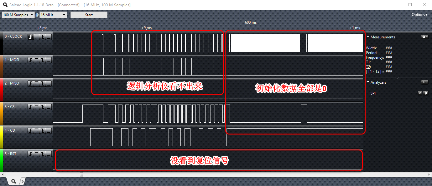

荔枝派zero驱动st7789出现问题!波形完全不对?
0x01.硬件链接
[st7789]            [licheepi zero]
CK  <-------------->  SPI0_CLK
SI  <-------------->  SPI0_SI
SO  <-------------->  SPI0_SO
CS  <-------------->  SPI0_CS
DC  <-------------->  PE1
RST <-------------->  PE20
0x02.增加驱动ST7789驱动
make ARCH=arm menuconfig
CONFIG_FB_TFT=y
CONFIG_FB_TFT_ST7789V=y
0x03.删除sun8i-v3s.dtsi中的
chosen {
        #address-cells = <1>;
        #size-cells = <1>;
        ranges;
        simplefb_lcd: framebuffer@0 {
                compatible = "allwinner,simple-framebuffer",
                             "simple-framebuffer";
                allwinner,pipeline = "de0-lcd0";
                clocks = <&ccu CLK_BUS_TCON0>, <&display_clocks 0>,
                         <&display_clocks 6>, <&ccu CLK_TCON0>;
                status = "disabled";
0x04.修改sun8i-v3s-licheepi-zero-dock.dts文件
#include "sun8i-v3s-licheepi-zero.dts"
    model = "Lichee Pi Zero with Dock";
    compatible = "licheepi,licheepi-zero-dock", "licheepi,licheepi-zero",
                 "allwinner,sun8i-v3s";
    aliases {
            ethernet0 = &emac;
    leds {
            /* The LEDs use PG0~2 pins, which conflict with MMC1 */
            status = "disbaled";
    chosen {
            /delete-node/ framebuffer@0;
&spi0 {
    panel@0 {
            reg = <0>;
            reset-gpios = <&pio 4 20 GPIO_ACTIVE_LOW>;
            dc-gpios = <&pio 4 1 GPIO_ACTIVE_LOW>;
            /*backlight = <&pwm_bl>;*/
            /*spi-cpol;*/
            /*spi-cpha;*/
            buswidth = <8>;
            rotate = <270>;
            bgr;
            fps = <30>;
            port {
                    panel_input: endpoint {
                            remote-endpoint = <&tcon0_out_panel>;

Re: 荔枝派zero驱动st7789出现问题!波形完全不对?
波形是怎么样的
log 是怎样的
smartcar 说:
波形是怎么样的
log 是怎样的
log好像没看到问题
