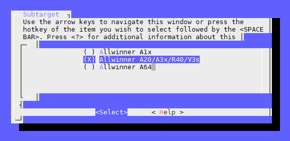

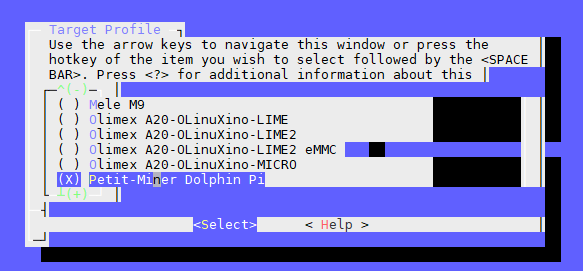

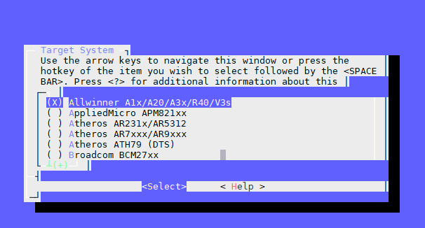

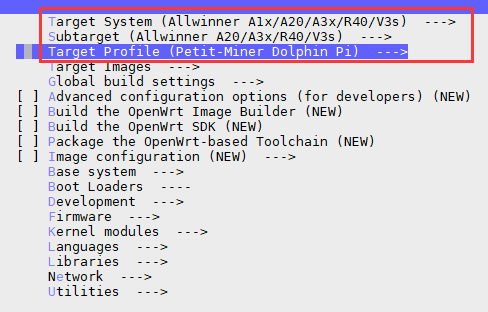

Like every other OpenWRT, clone the repo,
git clone https://github.com/bhorn/openwrt
cd openwrt
git checkout dolphinpi-spinand
run
make menuconfig
make sure your config targets the V3s and the "Dolphin Pi":
  │ │                             Target System (Allwinner A1x/A20/A3x/R40/V3s)  --->
  │ │                             Subtarget (Allwinner A20/A3x/R40/V3s)  --->
  │ │                             Target Profile (Petit-Miner Dolphin Pi)  --->
The devicetree of the dolpinpi
also activate
> Base System > mtd
> Kernel modules > SPI Support > kmod-spi-dev
then run
make
one file shoud appear:
bin/targets/sunxi/cortexa7/openwrt-snapshot-r11418-9eef37be78-sunxi-cortexa7-sun8i-v3s-dolphinpi-squashfs-spinand.img.gz
Now you need an sd-card image for your V3s that can access the spi-nand. To build an image capable of burning to spi-nand, look at the next post.
Then copy the spinand.img.gz to the V3s file-system of the sd-card (e.g. to /root/spinand.img.gz) and boot the V3s from the sd-card.
Now you can run
gzip -cd /root/spinand.img.gz | mtd write - /dev/mtd0
Now you have burned the spinand image to the spi-nand and should be able to boot from it.

I updated the repository. I added an generic V3s device image that will boot from sd-card and can access the spi-nand for burning purposes (warning: output is on uart2!)
The ready-to-use-config is available in the repository, too: https://github.com/bhorn/openwrt/blob/dolphinpi-spinand/sdwithspinandaccess.config
cd openwrt
cp sdwithspinandaccess.config .config
make menuconfig
# no need to change anything, just save and exit
make
# Image is located in bin/targets/sunxi/cortexa7/openwrt-snapshot-[...]-sunxi-cortexa7-sun8i-v3s-rawspinandaccessuart2-ext4-sdcard.img.gz
Build this image and burn it to the sd-card. With this sd-card you can run the command to burn the image like in the previous post.

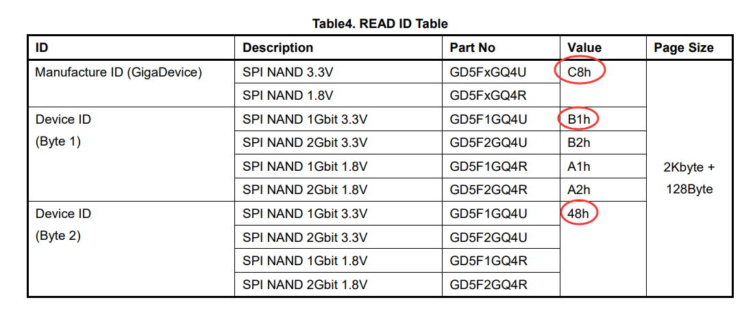

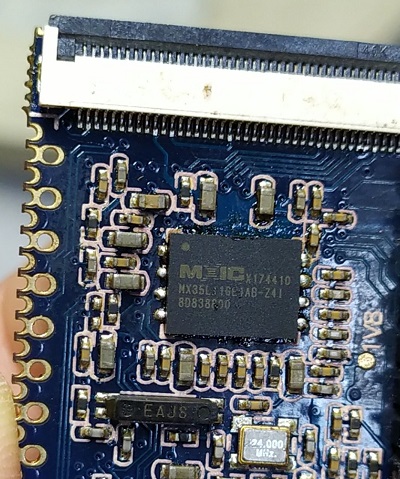

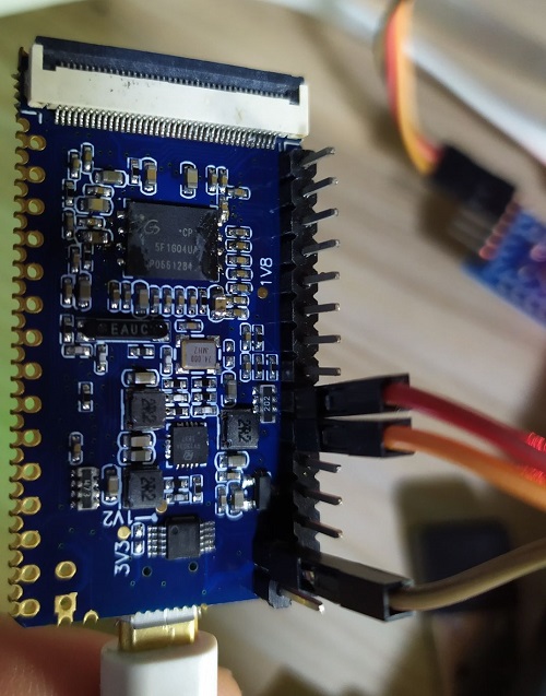

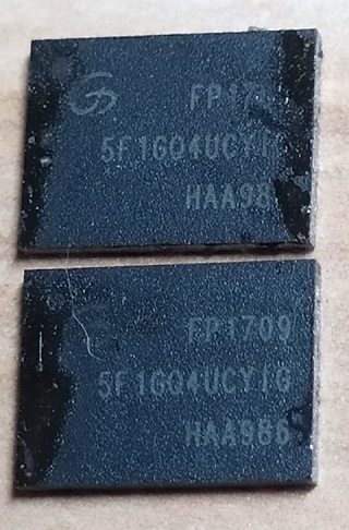

我焊上了 GD5F1GQ4UCYIG, 期待 ID 是: C8 B1 48, 可是linux log提示: unknown raw ID e458a464:
[    1.121140] loop: module loaded
[    1.131309] spi-nand spi0.0: unknown raw ID e458a464
[    1.137088] spi-nand: probe of spi0.0 failed with error -524
[    1.144842] libphy: Fixed MDIO Bus: probed
[    1.150935] dwmac-sun8i 1c30000.ethernet: PTP uses main clock
不知道是不是没有焊接好?

I checked the datasheet. The GD5F1GQ4UCYIG is not compatible with the SPL. It uses a different cache-addressing scheme. Unfortunatly I won't be able to implement support for other chips currently. I have ordered some other SPI-NAND chips. When they arrive, I'll refactor the driver to easily implement other chips.
The next chip I'll implement to the SPL is the W25N01GV. However, this won't be until next week when the chips arrive.
For your error
I don't know what this error means. Its something out of my scope, seems to be a problem with the linux-kernel mtd-driver.

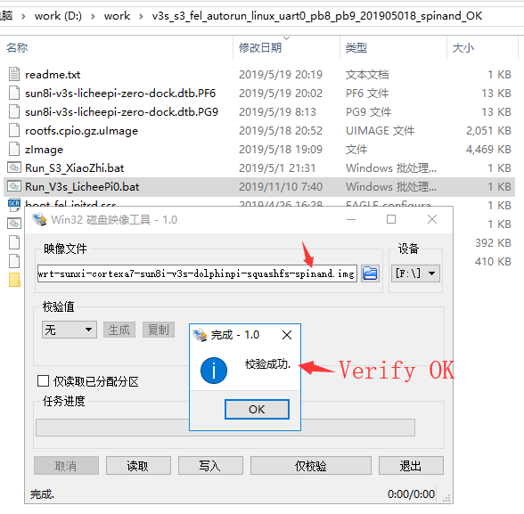

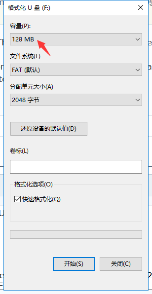

我重新找了一片旧板子, 用 @晕哥 linux5.1的 usb启动 固件, 控制台是 UART0, log显示spi nand 正常, 可以变成一个U盘(USB DISK)
[    0.000000] Linux version 5.1.0-rc4-00035-g0b5cbfb-dirty (root@test4) (gcc version 7.4.1 20181213 [linaro-7.4-2019.02 revision 56ec6f6b99cc167ff0c2f8e1a2eed33b1edc85d4] (Linaro GCC 7n May 6 03:51:59 EDT 2019
[    0.904750] sun8i-v3s-pinctrl 1c20800.pinctrl: 1c20800.pinctrl supply vcc-pc not found, using dummy regulator
[    0.916248] spi-nand spi0.0: GigaDevice SPI NAND was found.
[    0.921916] spi-nand spi0.0: 128 MiB, block size: 128 KiB, page size: 2048, OOB size: 64

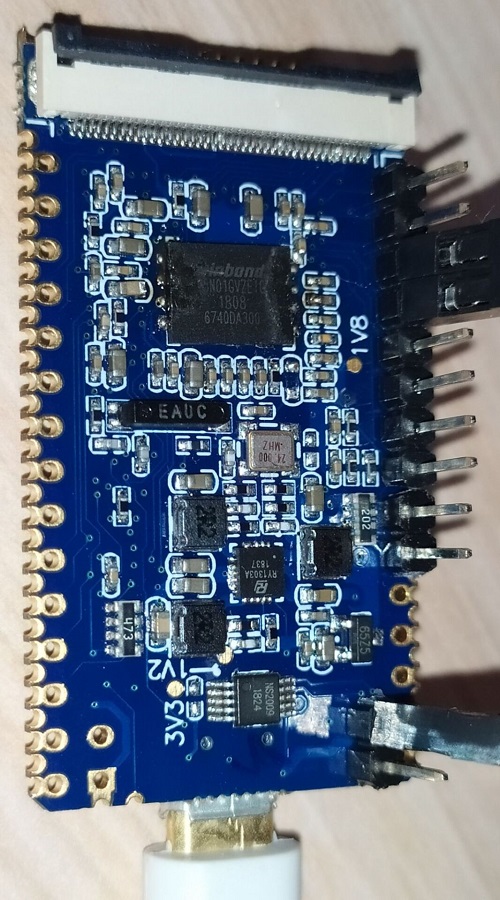

我另外一块V3s + Winbond W25N01 的板子, 用上面的USB启动, 能在电脑端看到128M的U盘,但是用openwrt也是一样的结果:
[    1.103306] console [ttyS0] enabled
[    1.121267] loop: module loaded
[    1.131387] spi-nand spi0.0: unknown raw ID 006faa20
[    1.137160] spi-nand: probe of spi0.0 failed with error -524
[    1.144897] libphy: Fixed MDIO Bus: probed
[    1.150980] dwmac-sun8i 1c30000.ethernet: PTP uses main clock

W25N01.pdf
根据这个手册, 应该输出 00EFAA21 才对, 实际上是显示006faa20, 我可以保证硬件没有问题.

最新消息, 我用 v3s_s3_fel_autorun_linux_uart0_pb8_pb9_201905018_spinand_OK.7z 配合 Win32DiskImager 把 openwrt-sunxi-cortexa7-sun8i-v3s-dolphinpi-ext4-spinand.img.gz 文件写入U盘, spl可以启动,然后挂了:
W25N01, GD5F1GQ4UCYIG 都是一样的结果:
U-Boot SPL 2019.10 (Nov 06 2019 - 15:22:33 +0000)
DRAM: 64 MiB
Trying to boot from sunxi SPI-NAND
sunxi SPI-NAND: Unknown chip aaef
期待楼主把其他 SPI NAND 都测试一遍 ^_^

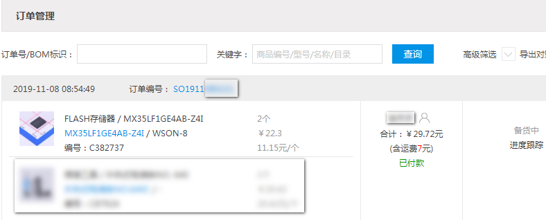

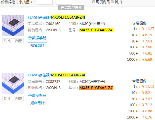

@bamkrsde 感谢回复, 发现立创商城也有mx35lf1ge这个芯片出售, https://so.szlcsc.com/global.html?k=mx35lf1ge
批量价7¥人民币, 我晚点下单去买两个.

已经下单,坐等收货,明天应该可以拿到芯片焊上。

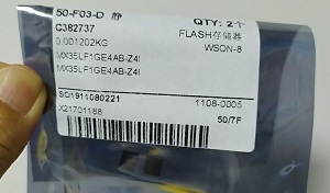

@bamkrsde 嗯,我收到了立创商城寄的mx35lf1ge, 直接焊上了, 没有重新编译, 还是用 v3s_s3_fel_autorun_linux_uart0_pb8_pb9_201905018_spinand_OK.7z 配合 Win32DiskImager 把 openwrt-sunxi-cortexa7-sun8i-v3s-dolphinpi-ext4-spinand.img.gz 文件写入U盘, 可以启动,然后挂了(go die):
first board log:
DRAM: 64 MiB
sunxi SPI-NAND: Found 1Gb Macronix MX35LF1GE4AB (12c2)
U-Boot 2019.10 (Nov 06 2019 - 15:22:33 +0000) Allwinner Technology
Model: Dolphin Pi
DRAM:  64 MiB
MMC:   mmc@01c0f000: 0
In:    serial@01c28800
Out:   serial@01c28800
Err:   serial@01c28800
Net:   No ethernet found.
Macronix SPI NAND was found.

请问是我这种烧录方法不对吗?

写入MX35LF1GE4AB 成功,但是校验失败(verified error).

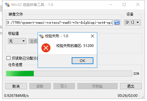

果然启动到文件系统就失败了, 看来得用 TF 卡烧录了.
[    1.692454] VFS: Cannot open root device "(null)" or unknown-block(0,0): error -6
[    1.700263] Please append a correct "root=" boot option; here are the available partitions:
[    1.708928] Kernel panic - not syncing: VFS: Unable to mount root fs on unknown-block(0,0)
Its the kernel-commandline problem from #48

这是我编译出来的镜像: openwrt-sunxi-cortexa7-sun8i-v3s-dolphinpi-20191109.tgz
我烧录了: openwrt-sunxi-cortexa7-sun8i-v3s-dolphinpi-squashfs-spinand.img
芯片是: MX35LF1GE4AB
烧录检验通过.

However, I received my W25N01 chips and already soldered one on.
unknown raw ID 43d60da0
MTD device spi-nand0 not found, ret -19
unknown raw ID 43d60d68
I get the same error. I will dig down on this.
楼主 #56 2019-11-11 21:55:15
bamkrsde
注册时间: 2019-10-31
已发帖子: 29
积分: 29
Re: V3s SPI NAND u-boot @openwrt
It was a bug in u-boot! I thought the u-boot spi-nand is in the same state as the linux spi-nand state. But I was wrong. The u-boot spi-nand winbond-implementation missed the W25N01 (however it embedded the W25M02 which is basically two W25N01 in one package). I updated the repo to include the W25N01.

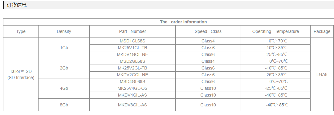

现在不是出了SDIO接口的nand flash 吗,用SDIO的接口会不会比SPI速度更快,有没有谁搞下SDIO 启动的
#59 2019-11-12 10:29:55
SDIO接口的 NAND?那个接口就是TF卡,把他当TF卡用就可以了,硬件上面做了FTL层,处理了写平衡和坏卡。

米客方德: http://www.mkfounder.com/
是这家吗?
#62 2019-11-12 11:23:14
642242855
注册时间: 2019-10-31
已发帖子: 213
积分: 105
是这家吗?
是的,就是这家,很多产品是很实用,没有用过批量的,质量就不清楚
我git pull最新的代码编译, 用 win32diskimager烧录openwrt-sunxi-cortexa7-sun8i-v3s-dolphinpi-squashfs-spinand.img,
在 w25n01 上 u-boot 可以识别spi nand, 并正常启动, 但是 linux 驱动识别 flash id 出错:
[    1.108748] loop: module loaded
[    1.119116] spi-nand spi0.0: unknown raw ID 0067a800
[    1.124152] spi-nand: probe of spi0.0 failed with error -524
[    1.132691] libphy: Fixed MDIO Bus: probed
完整log:

同一个文件烧到 MX flash, 可以识别id并执行mtd分区, 但是 rootfs 有问题:

请问是我的烧录文件有问题吗?或者是我的烧录方法有问题?

我发现 rootfs 在 0x000000ae0000-0x000008000000 这个位置,
实际上我的 openwrt-sunxi-cortexa7-sun8i-v3s-dolphinpi-squashfs-spinand.img 这个烧录文件也才 0x6AFE16 个字节,所以根本没有烧录 rootfs
这是我编译出来的文件: openwrt-sunxi-cortexa7-sun8i-v3s-dolphinpi-20191113.tgz
@bamkrsde 请问这个文件正常吗?

Use the new spinand.config (cp spinand.config .config; make menuconfig)! The Targets changed! The make menuconfig should look like:
Target Systems (Allwinner A1x/A20/A3x/R48/V3s)
Subtarget (Allwinner V3s)
#72 2019-11-14 17:32:21

我先 git pull, 然后 把 spi clock 修改成了 25000000, win32diskimager burn 之后, 出现这个问题:

死马做活马医, 强行用 mtd erase 命令擦除 ubi0区:
=> mtd erase ubi0
Erasing 0x00000000 ... 0x07efffff (1016 eraseblock(s))
=> ubi part ubi0
重新用 win32diskimager 烧录进去, 启动OK:

终于启动, 泪水都快流出来了。
现在还是百思不得其解, 为什么一定要用 mtd erase ubi0 这个擦除命令呢?明明我用win32diskimager校验是正确的!
本站下载: openwrt-snapshot-r11644-205ff32af0-sunxi-cortexa7v3sspinand-sun8i-v3s-dolphinpi-ubifs-ubispinand_img.gz
解压后,用win32diskimager 烧入,校验正确之后再重启。

Sorry for not replying earlier. Please understand that I can only help you with generic problems. I wasn't able to tell you how you are able to erase your spi-nand because I don't know what tools and workflow you are using.
xgui wrote:
终于启动, 泪水都快流出来了。
Its a bit difficult to explain. I'll try to make it as simple as possible.
Ubi stores some meta-data at every physical erase block (PEB). For example, your spi-nand has a PEB-size of 128K and a page-size of 2K.
The first 2 pages of each PEB is used to store metadata (erase-cycle-count and other data).
At every start, the ubi-driver iterates over all PEBs and tries to read the meta-data.
When you write your image to the spi-nand, all data is stored in the front of the spi-nand. After your image there is the free space to use that isn't touched while writing your image.
When the ubi-driver iterates over this free space, it sees some garbage meta-data, complains about it and throws an error.
Thus you have to delete the free space entirely so ubi actually identifies it as free space and not as used data-blocks with garbage meta-data.
I hope this explanation was good enough to understand the ubi-problem.
#84 2019-12-05 08:28:28
xgui
注册时间: 2019-09-07
已发帖子: 224
积分: 224
@bamkrsde
Thanks very much for your help, who from a distant friend.
I am very new to nand and ubi file systems. I am going to learn PEB.
非常感谢你这位来自远方朋友的帮助, 我对 nand 和 ubi 文件系统很陌生, 我现在去学习 PEB 方面的知识。
