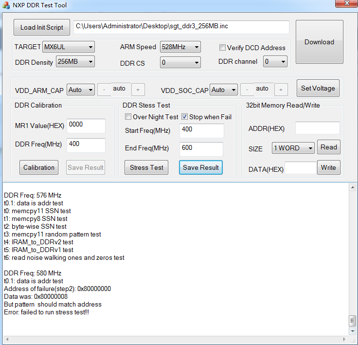

拿出吃灰半年的SIN-IMX6UL测试下DDR3,大家也可以发下正点原子和野火的测试log
DDR型号:H5TQ2G63FFRPBI
测试结果:
DDR Freq: 576 MHz
t0.1: data is addr test
t0: memcpy11 SSN test
t1: memcpy8 SSN test
t2: byte-wise SSN test
t3: memcpy11 random pattern test
t4: IRAM_to_DDRv2 test
t5: IRAM_to_DDRv1 test
t6: read noise walking ones and zeros test
DDR Freq: 580 MHz
Address of failure(step2): 0x80000000
Data was: 0x80000008
But pattern  should match address
Error: failed to run stress test!!!

这个是通过USB连接板子测试DDR吗?

对的 通过USB控制的
