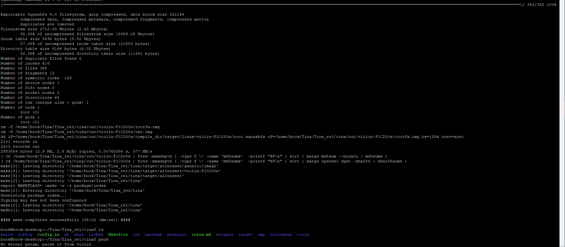

感谢楼主, 用了两小时,终于成功了:
Parallel mksquashfs: Using 1 processor
Creating 4.0 filesystem on /opt/f1c100s/Tina_rel/tina/out/violin-F1C200s/compile_dir/target/linux-violin-F1C200s/root.squashfs, block size 262144.
Pseudo file "/dev" exists in source filesystem "/opt/f1c100s/Tina_rel/tina/out/violin-F1C200s/compile_dir/target/rootfs/dev".
Ignoring, exclude it (-e/-ef) to override.
[==================================================================================================================================/] 393/393 100%
Exportable Squashfs 4.0 filesystem, gzip compressed, data block size 262144
        compressed data, compressed metadata, compressed fragments, compressed xattrs
        duplicates are removed
Filesystem size 2712.83 Kbytes (2.65 Mbytes)
        45.45% of uncompressed filesystem size (5969.16 Kbytes)
Inode table size 5569 bytes (5.44 Kbytes)
        27.01% of uncompressed inode table size (20615 bytes)
Directory table size 6182 bytes (6.04 Kbytes)
        52.11% of uncompressed directory table size (11864 bytes)
Number of duplicate files found 6
Number of inodes 617
Number of files 389
Number of fragments 13
Number of symbolic links  163
Number of device nodes 1
Number of fifo nodes 0
Number of socket nodes 0
Number of directories 64
Number of ids (unique uids + gids) 1
Number of uids 1
        root (0)
Number of gids 1
        root (0)
rm -f /opt/f1c100s/Tina_rel/tina/out/violin-F1C200s/rootfs.img
rm -f /opt/f1c100s/Tina_rel/tina/out/violin-F1C200s/usr.img
dd if=/opt/f1c100s/Tina_rel/tina/out/violin-F1C200s/compile_dir/target/linux-violin-F1C200s/root.squashfs of=/opt/f1c100s/Tina_rel/tina/out/violin-F1C200s/rootfs.img bs=128k conv=sync
21+1 records in
22+0 records out
2883584 bytes (2.9 MB, 2.8 MiB) copied, 0.00159815 s, 1.8 GB/s
( cd /opt/f1c100s/Tina_rel/tina/out/violin-F1C200s ; find -maxdepth 1 -type f \! -name 'md5sums'  -printf "%P\n" | sort | xargs md5sum --binary > md5sums )
( cd /opt/f1c100s/Tina_rel/tina/out/violin-F1C200s ; find -maxdepth 1 -type f \! -name 'md5sums'  -printf "%P\n" | sort | xargs openssl dgst -sha256 > sha256sums )
make[5]: Leaving directory '/opt/f1c100s/Tina_rel/tina/target/allwinner/generic/image'
make[4]: Leaving directory '/opt/f1c100s/Tina_rel/tina/target/allwinner/violin-F1C200s'
make[3]: Leaving directory '/opt/f1c100s/Tina_rel/tina/target/allwinner'
make[2]: Leaving directory '/opt/f1c100s/Tina_rel/tina'
export MAKEFLAGS= ;make -w -r package/index
make[2]: Entering directory '/opt/f1c100s/Tina_rel/tina'
Generating package index...
Signing key has not been configured
make[1]: Leaving directory '/opt/f1c100s/Tina_rel/tina'
#### make completed successfully (20:00 (mm:ss)) ####
tina@ubuntu:/opt/f1c100s/Tina_rel/tina$
烧录怎么搞呢?

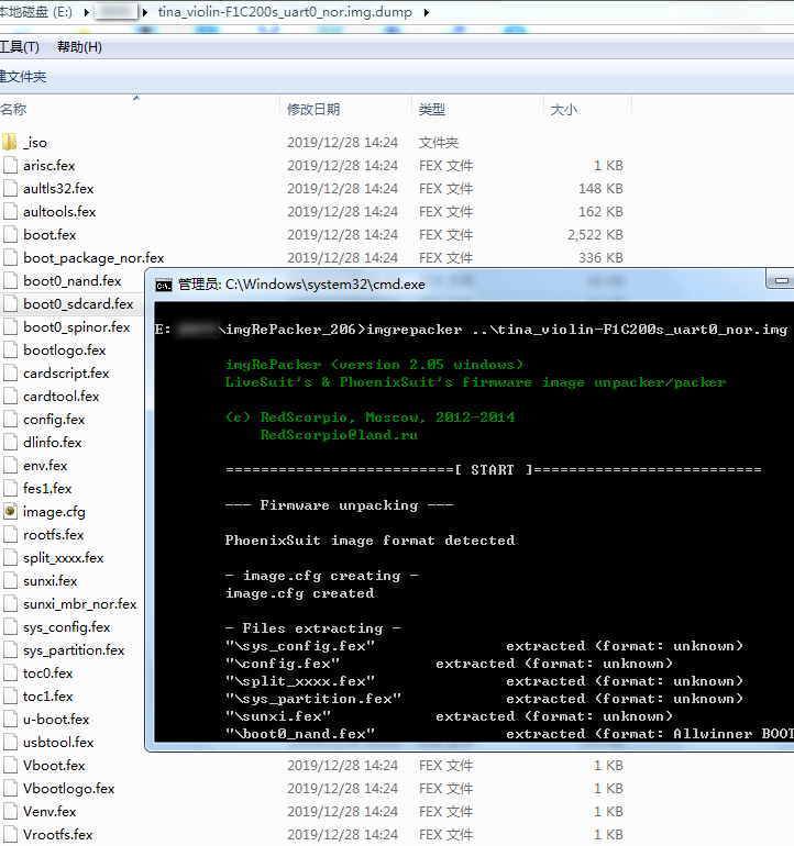

感谢 @湘楚浪子 https://whycan.cn/t_917.html#p30343
tina_violin-F1C200s_uart0_nor.img 解压成功:
E:\xxxx\imgRePacker_206>imgrepacker ..\tina_violin-F1C200s_uart0_nor.img
        imgRePacker (version 2.05 windows)
        LiveSuit's & PhoenixSuit's firmware image unpacker/packer
        (c) RedScorpio, Moscow, 2012-2014
            RedScorpio@land.ru
        ==========================[ START ]==========================
        --- Firmware unpacking ---
        PhoenixSuit image format detected
        - image.cfg creating -
        image.cfg created
        - Files extracting -
        "\sys_config.fex"               extracted (format: unknown)
        "\config.fex"           extracted (format: unknown)
        "\split_xxxx.fex"               extracted (format: unknown)
        "\sys_partition.fex"            extracted (format: unknown)
        "\sunxi.fex"            extracted (format: unknown)
        "\boot0_nand.fex"               extracted (format: Allwinner BOOT0 file)
        "\boot0_sdcard.fex"             extracted (format: Allwinner BOOT0 file)
        "\boot0_spinor.fex"             extracted (format: Allwinner BOOT0 file)
        "\u-boot.fex"           extracted (format: unknown)
        "\toc1.fex"             extracted (format: unknown/empty?)
        "\toc0.fex"             extracted (format: unknown/empty?)
        "\fes1.fex"             extracted (format: Allwinner BOOT0 file)
        "\boot_package_nor.fex"         extracted (format: unknown)
        "\usbtool.fex"          extracted (format: Windows PE file)
        "\aultools.fex"         extracted (format: Compiled lua file)
        "\aultls32.fex"         extracted (format: Compiled lua file)
        "\cardtool.fex"         extracted (format: Windows PE file)
        "\cardscript.fex"               extracted (format: unknown)
        "\sunxi_mbr_nor.fex"            extracted (format: unknown)
        "\dlinfo.fex"           extracted (format: unknown)
        "\arisc.fex"            extracted (format: unknown/empty?)
        "\bootlogo.fex"         extracted (format: bitmap image file)
        "\Vbootlogo.fex"                extracted (format: unknown/empty?)
        "\env.fex"              extracted (format: unknown)
        "\Venv.fex"             extracted (format: unknown/empty?)
        "\boot.fex"             extracted (format: unknown)
        "\Vboot.fex"            extracted (format: unknown/empty?)
        "\rootfs.fex"           extracted (format: unknown)
        "\Vrootfs.fex"          extracted (format: unknown/empty?)
        ==========================[ STOP  ]==========================

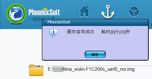

烧写成功, 不知道能不能启动。

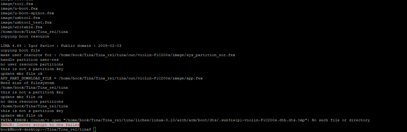

编译的结果是这样的:
FluxBB make_result 测试
输入pack指令,出现这种情况。
FluxBB Error_pack 测试
进去发现,根本就找不到lichee/linux-3.10/arch/arm/boot/dts/.sun3iw1p1-violin-F1C200s.dtb.dts.tmp文件
请问如何解决呢?
最近编辑记录 LinjieGuo (2020-04-14 15:02:37)
在线
#32 2020-04-15 12:14:46
LinjieGuo
注册时间: 2019-07-24
已发帖子: 591
积分: 595
Re: 试一试 Ubuntu 18.04 编译f1c200s tina 3.x
找到原因了,不能再NTFS格式的文件系统下编译,否则会出现上面情况

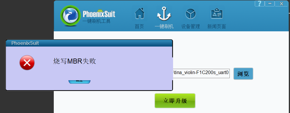

楼主:
       你好,烧录时提示这个错误,nor flash为25Q128;试过插入TF卡也一样提示这个错误,这个有办法解决吗?
#42 2020-08-06 09:28:54
aaayao
注册时间: 2019-10-30
已发帖子: 85
积分: 55
tina123456 说:
输入pack命令:
你好!这个image is for nor的配置能分享一下吗?谢谢了!
我用默认配置编译出来的是image is for nand/emmc,这个没有办法烧录成功。
