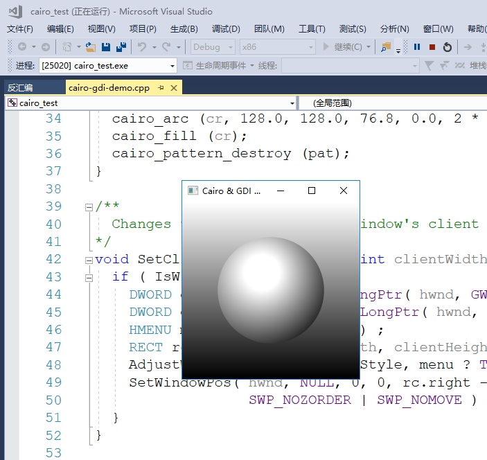

楼主 #3 2020-01-01 23:19:53
win32prog
注册时间: 2019-11-28
已发帖子: 138
积分: 138
Re: 找到一个 win32 gdi & cairo 绘图引擎的 demo
cairo-gdi-demo.cpp
Demonstrates how to get Cairo Graphics working with the Windows API and GDI.

费了九牛二虎之力才搞定的VC2017版本: cairo-gdi-demo.7z

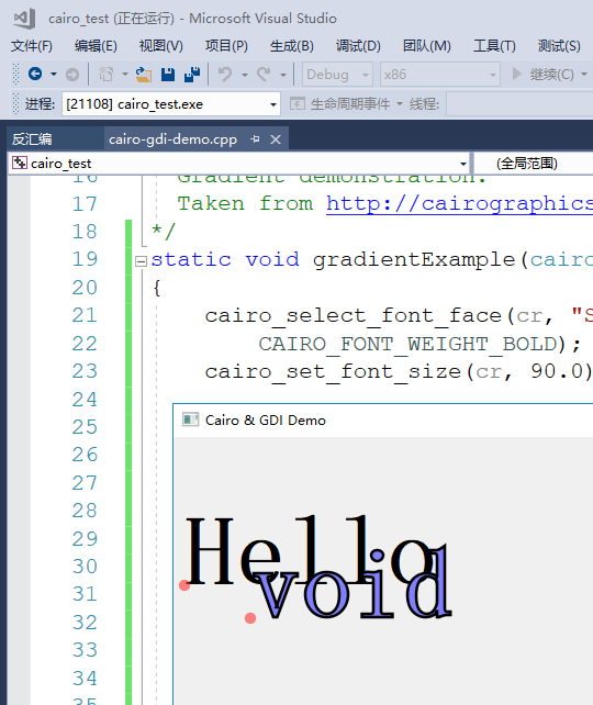

楼主 #4 2020-01-01 23:24:57
win32prog
注册时间: 2019-11-28
已发帖子: 138
积分: 138

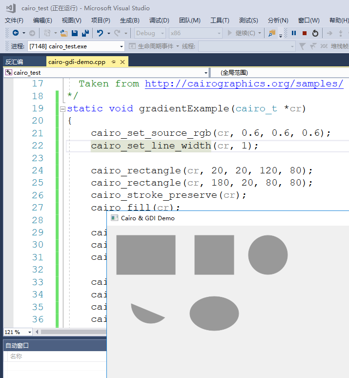

楼主 #5 2020-01-01 23:30:36
win32prog
注册时间: 2019-11-28
已发帖子: 138
积分: 138
static void do_drawing(cairo_t *cr)
  cairo_set_source_rgb(cr, 0.6, 0.6, 0.6);
  cairo_set_line_width(cr, 1);
  cairo_rectangle(cr, 20, 20, 120, 80);
  cairo_rectangle(cr, 180, 20, 80, 80);
  cairo_stroke_preserve(cr);
  cairo_fill(cr);
  cairo_arc(cr, 330, 60, 40, 0, 2*M_PI);
  cairo_fill(cr);
  cairo_arc(cr, 90, 160, 40, M_PI/4, M_PI);
  cairo_close_path(cr);
  cairo_fill(cr);
  cairo_translate(cr, 220, 180);
  cairo_scale(cr, 1, 0.7);
  cairo_arc(cr, 0, 0, 50, 0, 2*M_PI);
  cairo_fill(cr);
http://zetcode.com/gfx/cairo/shapesfills/
楼主 #6 2020-01-01 23:45:47
win32prog
注册时间: 2019-11-28
已发帖子: 138
积分: 138
cairo_curve_to(cr, x1, y1, x2, y2, x3, y3);
https://www.cairographics.org/manual/cairo-Paths.html
https://www.cairographics.org/samples/
试了一下, 这里面的 demo 都可以跑, 包括贝塞尔曲线.

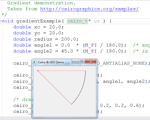

#7 2020-01-03 14:59:55
红白机
注册时间: 2020-01-02
已发帖子: 133
积分: 133
居然发现有同道中人 ^_^
线条抗锯齿关闭:
cairo_set_antialias(cr, CAIRO_ANTIALIAS_NONE);
字体抗锯齿关闭:
cairo_font_options_set_antialias(options, CAIRO_ANTIALIAS_NONE);
#8 2020-01-03 15:38:59
红白机
注册时间: 2020-01-02
已发帖子: 133
积分: 133
	double xc = 20.0;
	double yc = 20.0;
	double radius = 200.0;
	double angle1 = 0.0  * (M_PI / 180.0);  /* angles are specified */
	double angle2 = 45.0 * (M_PI / 180.0);  /* in radians           */
	cairo_set_line_width(cr, 1.0);
	cairo_arc(cr, xc, yc, radius, angle1, angle2);
	cairo_stroke(cr);
	/* draw helping lines */
	cairo_set_source_rgba(cr, 1, 0.2, 0.2, 0.6);
	cairo_arc(cr, xc, yc, 3.0, 0, 2 * M_PI);
	cairo_fill(cr);
	cairo_arc(cr, xc, yc, radius, angle1, angle1);
	cairo_line_to(cr, xc, yc);
	cairo_arc(cr, xc, yc, radius, angle2, angle2);
	//cairo_fill(cr);
	cairo_stroke(cr);
	cairo_fill(cr);
参考1 https://www.cairographics.org/samples/
参考2 https://www.cairographics.org/tutorial/
最近编辑记录 红白机 (2020-01-03 15:40:26)

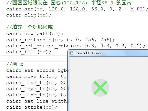

#9 2020-01-03 17:05:24
红白机
注册时间: 2020-01-02
已发帖子: 133
积分: 133
	//画图区域限制在 圆心(128,128) 半径36.8 的圆内
	cairo_arc(cr, 128.0, 128.0, 36.8, 0, 2 * M_PI);
	cairo_clip(cr);
	//填充一个矩形区域
	cairo_new_path(cr);
	cairo_rectangle(cr, 0, 0, 256, 256);
	cairo_set_source_rgba(cr, 0.3, 0.3, 0.3, 0.1);
	cairo_fill(cr);
	//画 x
	cairo_set_source_rgba(cr, 0, 1, 0, 0.5);
	cairo_move_to(cr, 0, 0);
	cairo_line_to(cr, 256, 256);
	cairo_move_to(cr, 256, 0);
	cairo_line_to(cr, 0, 256);
	cairo_set_line_width(cr, 10.0);
	cairo_stroke(cr);
参考3 https://github.com/apachecn/zetcode-zh/
参考4 https://github.com/apachecn/zetcode-zh/blob/master/docs/graph/30.md
