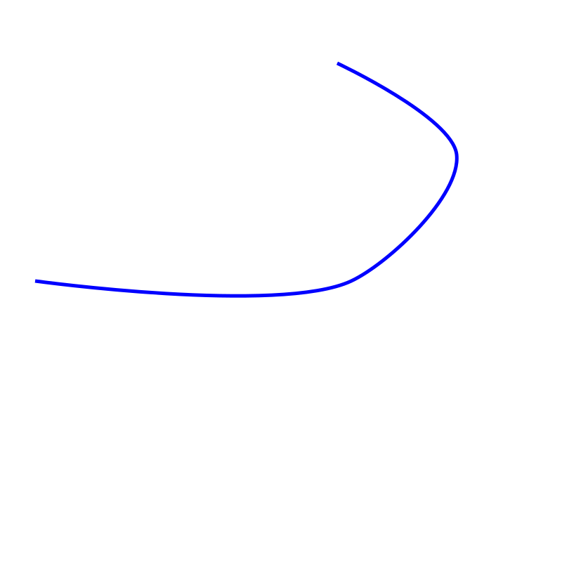

里面有 Makefile 可以直接用 make 编译,
也可以用以下命令行编译:
gcc -o bspline  bspline.c bspline_constr.c bspline_ctrl.c  `pkg-config cairo --cflags --libs` -lm
运行:
./bspline
楼主 #3 2020-01-03 11:32:20
红白机
注册时间: 2020-01-02
已发帖子: 133
积分: 133
Re: cairo 2D 画图引擎生成b样条曲线 (b-spline curve)
这是生成的b样条曲线文件。

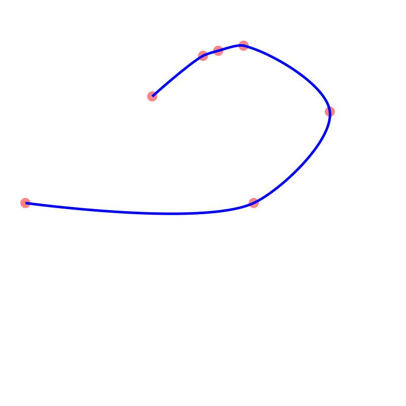

不用客气,别人写的,我只是借花献佛而已。
楼主 #7 2020-01-03 13:51:56
红白机
注册时间: 2020-01-02
已发帖子: 133
积分: 133
改了几行代码, 把点都标出来 bspline.c

   point_t pt[] = {{50, 400}, {500, 400}, {650, 220}, {480,90}, {430, 100}, {400, 110}, {300, 190}, };
   // Alternative array of points.
   //point_t pt[] = {{160, 190}, {100, 400}, {470, 600}, {300, 200}, {400, 150},
   //   {470, 250}, {575, 400}, {630, 390}, {650, 300}, {670, 210}};
  /* This parameter defines if the points shall be connected in a loop (start
    * = 0) or as open line (start = 1). */
   int start = 1;
   // Number of points in array.
   cnt = sizeof(pt) / sizeof(*pt);
//#define WITH_RAND
#ifdef WITH_RAND
   srand(time(NULL));
   for (int i = 0; i < cnt; i++)
      pt[i].x = rand() % 800, pt[i].y = rand() % 800;
   // Create and init Cairo drawing context.
   dst = cairo_image_surface_create(CAIRO_FORMAT_ARGB32, 800, 800);
   ctx = cairo_create(dst);
   COL_BG(ctx);
   cairo_paint(ctx);
   for(int i=0;i<sizeof(pt)/sizeof(pt[0]);i++)
        draw_dot(ctx, pt[i].x, pt[i].y);
#if 0
   draw_dot(ctx, pt[0].x, pt[0].y);
   draw_dot(ctx, pt[1].x, pt[1].y);
   draw_dot(ctx, pt[2].x, pt[2].y);
   draw_dot(ctx, pt[3].x, pt[3].y);
   // Draw curve between the points pt.
   draw_curve(ctx, pt, cnt, start);
   // Save image and destroy Cairo context.
   cairo_destroy(ctx);
   cairo_surface_write_to_png(dst, "bspline.png");
   cairo_surface_destroy(dst);
代码参考: https://www.cairographics.org/samples/
