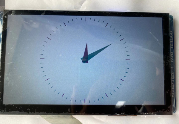

### 六、编译qt例程
qt自带例程的编译可以参考晕哥这个视频:- buildroot成功后如何编译Qt应用程序](<https://www.bilibili.com/video/av16396112/)>)
看log或许更直观:
vmtest@linux-test:~/work/yuanzi/code-build/rootfs/buildroot-2017.08.1/output/build/qt5base-5.9.1/examples/widgets/widgets/analogclock$ pwd
/home/vmtest/work/yuanzi/code-build/rootfs/buildroot-2017.08.1/output/build/qt5base-5.9.1/examples/widgets/widgets/analogclock
vmtest@linux-test:~/work/yuanzi/code-build/rootfs/buildroot-2017.08.1/output/build/qt5base-5.9.1/examples/widgets/widgets/analogclock$ ls
analogclock.cpp  analogclock.h  analogclock.pro  main.cpp
vmtest@linux-test:~/work/yuanzi/code-build/rootfs/buildroot-2017.08.1/output/build/qt5base-5.9.1/examples/widgets/widgets/analogclock$ /home/vmtest/work/yuanzi/
code-build/rootfs/buildroot-2017.08.1/output/host/bin/qmake analogclock.pro
vmtest@linux-test:~/work/yuanzi/code-build/rootfs/buildroot-2017.08.1/output/build/qt5base-5.9.1/examples/widgets/widgets/analogclock$ time make
/home/vmtest/work/yuanzi/code-build/rootfs/buildroot-2017.08.1/output/host/bin/arm-buildroot-linux-gnueabihf-g++ -c -pipe -D_LARGEFILE_SOURCE -D_LARGEFILE64_SOURCE -D_FILE_OFFSET_BITS=64 -Os --sysroot=/home/vmtest/work/yuanzi/code-build/rootfs/buildroot-2017.08.1/output/host/arm-buildroot-linux-gnueabihf/sysroot -O2 -O3 -fno-exceptions -Wall -W -D_REENTRANT -fPIC -DQT_NO_EXCEPTIONS -D_LARGEFILE64_SOURCE -D_LARGEFILE_SOURCE -DQT_NO_DEBUG -DQT_WIDGETS_LIB -DQT_GUI_LIB -DQT_CORE_LIB -I. -I../../../../include -I../../../../include/QtWidgets -I../../../../include/QtGui -I../../../../include/QtCore -I.moc -I../../../../mkspecs/devices/linux-buildroot-g++ -o .obj/analogclock.o analogclock.cpp
/home/vmtest/work/yuanzi/code-build/rootfs/buildroot-2017.08.1/output/host/bin/arm-buildroot-linux-gnueabihf-g++ -c -pipe -D_LARGEFILE_SOURCE -D_LARGEFILE64_SOURCE -D_FILE_OFFSET_BITS=64 -Os --sysroot=/home/vmtest/work/yuanzi/code-build/rootfs/buildroot-2017.08.1/output/host/arm-buildroot-linux-gnueabihf/sysroot -O2 -O3 -fno-exceptions -Wall -W -D_REENTRANT -fPIC -DQT_NO_EXCEPTIONS -D_LARGEFILE64_SOURCE -D_LARGEFILE_SOURCE -DQT_NO_DEBUG -DQT_WIDGETS_LIB -DQT_GUI_LIB -DQT_CORE_LIB -I. -I../../../../include -I../../../../include/QtWidgets -I../../../../include/QtGui -I../../../../include/QtCore -I.moc -I../../../../mkspecs/devices/linux-buildroot-g++ -o .obj/main.o main.cpp
/home/vmtest/work/yuanzi/code-build/rootfs/buildroot-2017.08.1/output/host/bin/arm-buildroot-linux-gnueabihf-g++ -pipe -D_LARGEFILE_SOURCE -D_LARGEFILE64_SOURCE -D_FILE_OFFSET_BITS=64 -Os --sysroot=/home/vmtest/work/yuanzi/code-build/rootfs/buildroot-2017.08.1/output/host/arm-buildroot-linux-gnueabihf/sysroot -O2 -O3 -fno-exceptions -Wall -W -dM -E -o .moc/moc_predefs.h /home/vmtest/work/yuanzi/code-build/rootfs/buildroot-2017.08.1/output/host/mkspecs/features/data/dummy.cpp
/home/vmtest/work/yuanzi/code-build/rootfs/buildroot-2017.08.1/output/build/qt5base-5.9.1/bin/moc -DQT_NO_EXCEPTIONS -D_LARGEFILE64_SOURCE -D_LARGEFILE_SOURCE -DQT_NO_DEBUG -DQT_WIDGETS_LIB -DQT_GUI_LIB -DQT_CORE_LIB --include .moc/moc_predefs.h -I/home/vmtest/work/yuanzi/code-build/rootfs/buildroot-2017.08.1/output/build/qt5base-5.9.1/mkspecs/devices/linux-buildroot-g++ -I/home/vmtest/work/yuanzi/code-build/rootfs/buildroot-2017.08.1/output/build/qt5base-5.9.1/examples/widgets/widgets/analogclock -I/home/vmtest/work/yuanzi/code-build/rootfs/buildroot-2017.08.1/output/build/qt5base-5.9.1/include -I/home/vmtest/work/yuanzi/code-build/rootfs/buildroot-2017.08.1/output/build/qt5base-5.9.1/include/QtWidgets -I/home/vmtest/work/yuanzi/code-build/rootfs/buildroot-2017.08.1/output/build/qt5base-5.9.1/include/QtGui -I/home/vmtest/work/yuanzi/code-build/rootfs/buildroot-2017.08.1/output/build/qt5base-5.9.1/include/QtCore -I/home/vmtest/work/yuanzi/code-build/rootfs/buildroot-2017.08.1/output/host/arm-buildroot-linux-gnueabihf/include/c++/6.4.0 -I/home/vmtest/work/yuanzi/code-build/rootfs/buildroot-2017.08.1/output/host/arm-buildroot-linux-gnueabihf/include/c++/6.4.0/arm-buildroot-linux-gnueabihf -I/home/vmtest/work/yuanzi/code-build/rootfs/buildroot-2017.08.1/output/host/arm-buildroot-linux-gnueabihf/include/c++/6.4.0/backward -I/home/vmtest/work/yuanzi/code-build/rootfs/buildroot-2017.08.1/output/host/lib/gcc/arm-buildroot-linux-gnueabihf/6.4.0/include -I/home/vmtest/work/yuanzi/code-build/rootfs/buildroot-2017.08.1/output/host/lib/gcc/arm-buildroot-linux-gnueabihf/6.4.0/include-fixed -I/home/vmtest/work/yuanzi/code-build/rootfs/buildroot-2017.08.1/output/host/arm-buildroot-linux-gnueabihf/include -I/home/vmtest/work/yuanzi/code-build/rootfs/buildroot-2017.08.1/output/host/arm-buildroot-linux-gnueabihf/sysroot/usr/include analogclock.h -o .moc/moc_analogclock.cpp
/home/vmtest/work/yuanzi/code-build/rootfs/buildroot-2017.08.1/output/host/bin/arm-buildroot-linux-gnueabihf-g++ -c -pipe -D_LARGEFILE_SOURCE -D_LARGEFILE64_SOURCE -D_FILE_OFFSET_BITS=64 -Os --sysroot=/home/vmtest/work/yuanzi/code-build/rootfs/buildroot-2017.08.1/output/host/arm-buildroot-linux-gnueabihf/sysroot -O2 -O3 -fno-exceptions -Wall -W -D_REENTRANT -fPIC -DQT_NO_EXCEPTIONS -D_LARGEFILE64_SOURCE -D_LARGEFILE_SOURCE -DQT_NO_DEBUG -DQT_WIDGETS_LIB -DQT_GUI_LIB -DQT_CORE_LIB -I. -I../../../../include -I../../../../include/QtWidgets -I../../../../include/QtGui -I../../../../include/QtCore -I.moc -I../../../../mkspecs/devices/linux-buildroot-g++ -o .obj/moc_analogclock.o .moc/moc_analogclock.cpp
/home/vmtest/work/yuanzi/code-build/rootfs/buildroot-2017.08.1/output/host/bin/arm-buildroot-linux-gnueabihf-g++ --sysroot=/home/vmtest/work/yuanzi/code-build/rootfs/buildroot-2017.08.1/output/host/arm-buildroot-linux-gnueabihf/sysroot -Wl,-O1 -Wl,--enable-new-dtags -o analogclock .obj/analogclock.o .obj/main.o .obj/moc_analogclock.o   -L/home/vmtest/work/yuanzi/code-build/rootfs/buildroot-2017.08.1/output/build/qt5base-5.9.1/lib -lQt5Widgets -lQt5Gui -lQt5Core -lrt -ldl -latomic -lpthread
real	0m5.039s
user	0m2.604s
sys	0m0.948s
analogclock      analogclock.h    main.cpp
analogclock.cpp  analogclock.pro  Makefile
vmtest@linux-test:~/work/yuanzi/code-build/rootfs/buildroot-2017.08.1/output/build/qt5base-5.9.1/examples/widgets/widgets/analogclock$ file analogclock
analogclock: ELF 32-bit LSB executable, ARM, EABI5 version 1 (SYSV), dynamically linked, interpreter /lib/ld-, for GNU/Linux 4.1.0, not stripped
