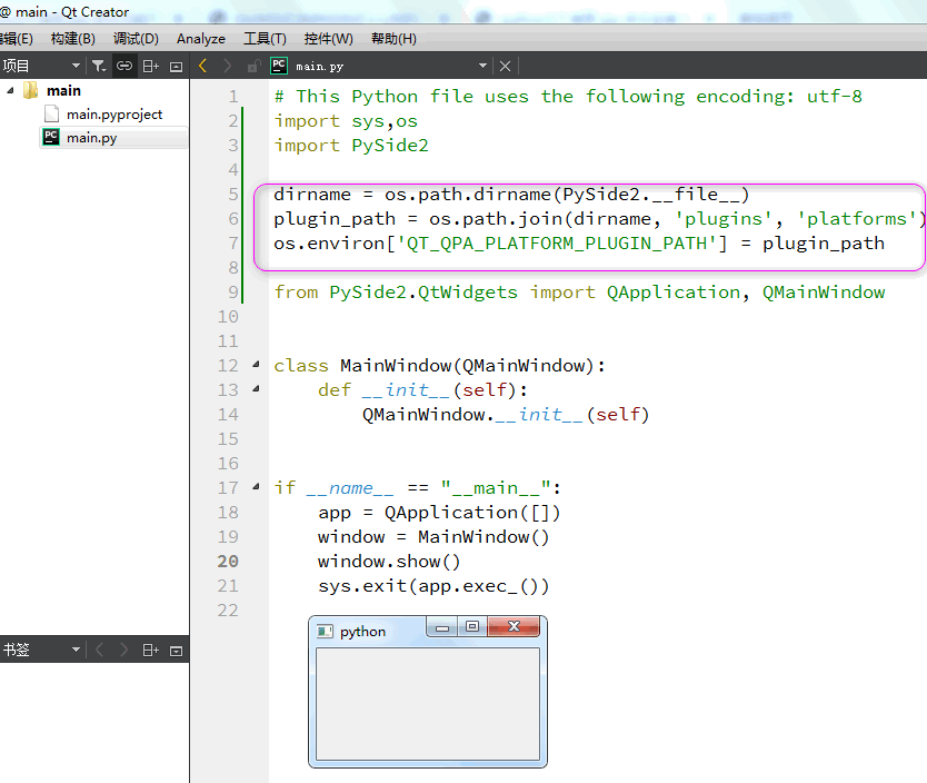

楼主 #3 2020-02-19 11:18:36
pythinker
注册时间: 2019-02-12
已发帖子: 215
积分: 215
Re: python3.7 使用 pip 命令安装 PySide2 Qt5 软件包了, 也可以手动安装.
找到解决方案了: https://blog.csdn.net/ouening/article/details/81093697
# This Python file uses the following encoding: utf-8
import sys,os
import PySide2
dirname = os.path.dirname(PySide2.__file__)
plugin_path = os.path.join(dirname, 'plugins', 'platforms')
os.environ['QT_QPA_PLATFORM_PLUGIN_PATH'] = plugin_path
from PySide2.QtWidgets import QApplication, QMainWindow
class MainWindow(QMainWindow):
    def __init__(self):
        QMainWindow.__init__(self)
if __name__ == "__main__":
    app = QApplication([])
    window = MainWindow()
    window.show()
    sys.exit(app.exec_())
