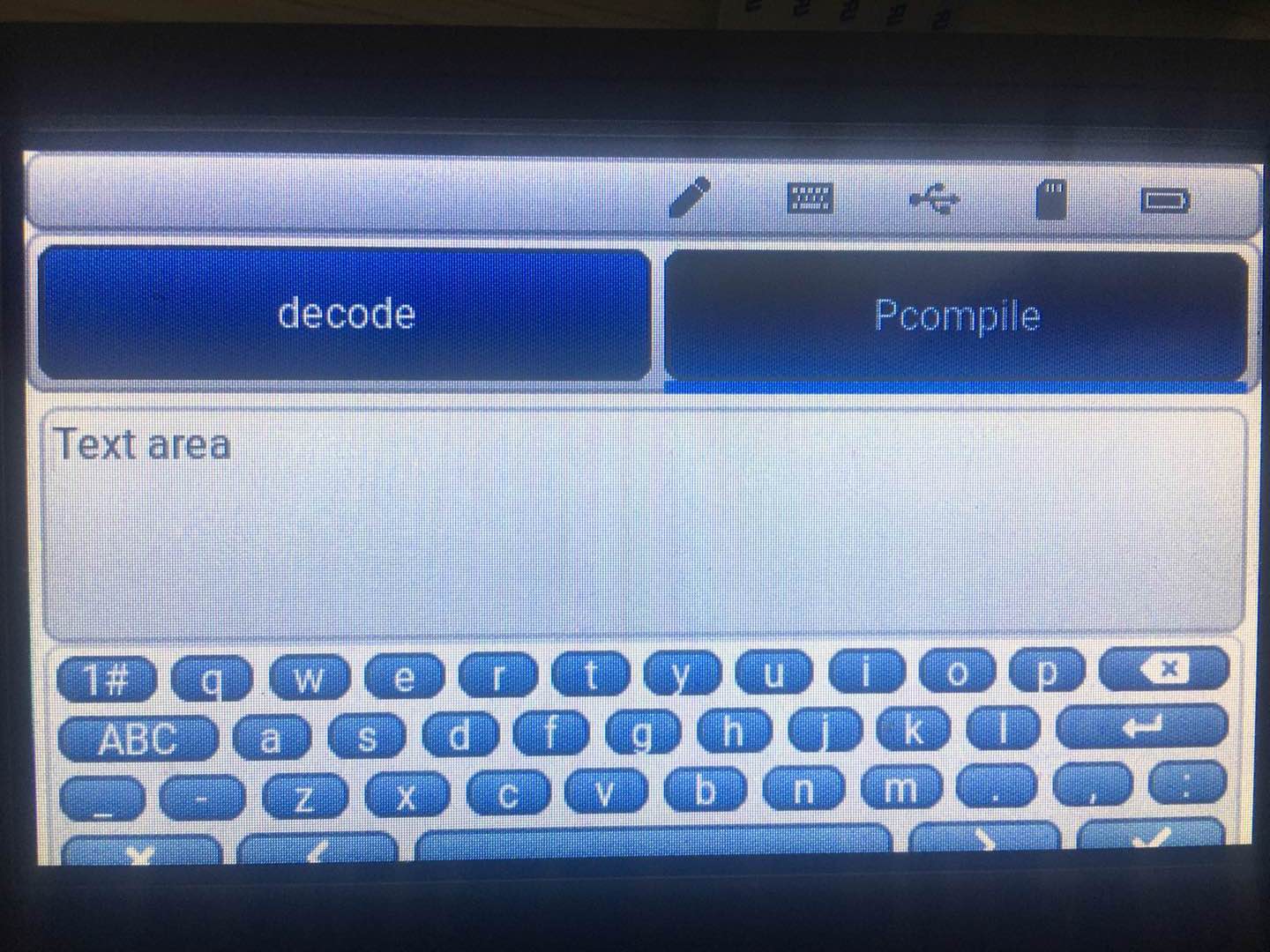

littlevGL的tabview控件如何更改按钮的大小
如图 我觉得tab 1 2 3 三个按钮太大了 想改它们的高度 如何改
lv_obj_t * obj = lv_tabview_create(scr, NULL);
lv_obj_set_size(obj, 197, 231);
lv_obj_t * t1 = lv_tabview_add_tab(obj, "Tab 1");
lv_obj_t * t2 = lv_tabview_add_tab(obj, "Tab 2");
//lv_obj_set_size(t1, 20,20);
//lv_obj_set_event_cb(obj, general_event_handler);
lv_obj_t * label = lv_label_create(t1, NULL);
lv_label_set_text(label, "This the first tab");
label = lv_label_create(t2, NULL);
lv_label_set_text(label, "Second tab");
按道理应该是lv_obj_set_size(t1, 20,20); 但是没有用

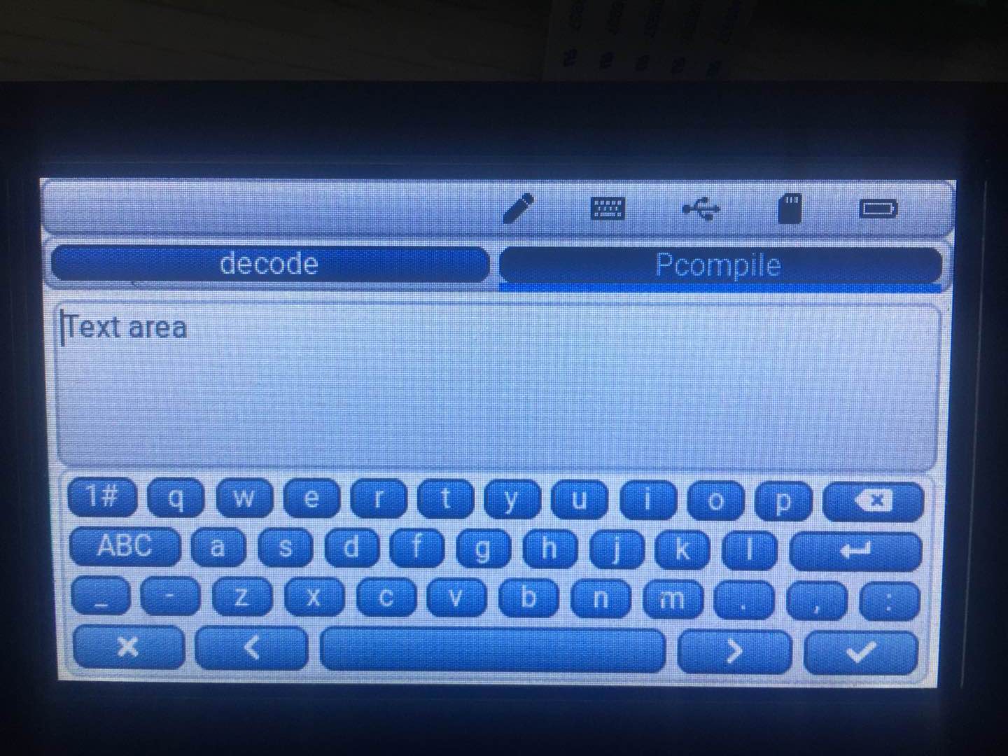

micropython参考C:
   self.styles = lv.style_t()
   lv.style_copy(self.styles,lv.style_btn_rel)
   self.styles.text.font = lv.font_roboto_16
   self.styles.body.padding.left = 0
   self.styles.body.padding.right = 0
   self.styles.body.padding.top = 0
   self.styles.body.padding.bottom = 0
   self.tabview = lv.tabview(self)
   #self.tabview.set_btns_hidden(True)
   self.tabview.set_style(self.tabview.STYLE.BTN_REL, self.styles);
   #self.tabview.set_pos(5, 10);
   self.tabview.align(self.cont, lv.ALIGN.OUT_BOTTOM_MID, 0, 0)
   self.decode = Decode_Simple(self.app, self.tabview.add_tab('decode'))
   self.Pcompile = Pcompile_Simple(self.app, self.tabview.add_tab('Pcompile'))
micropython运行
