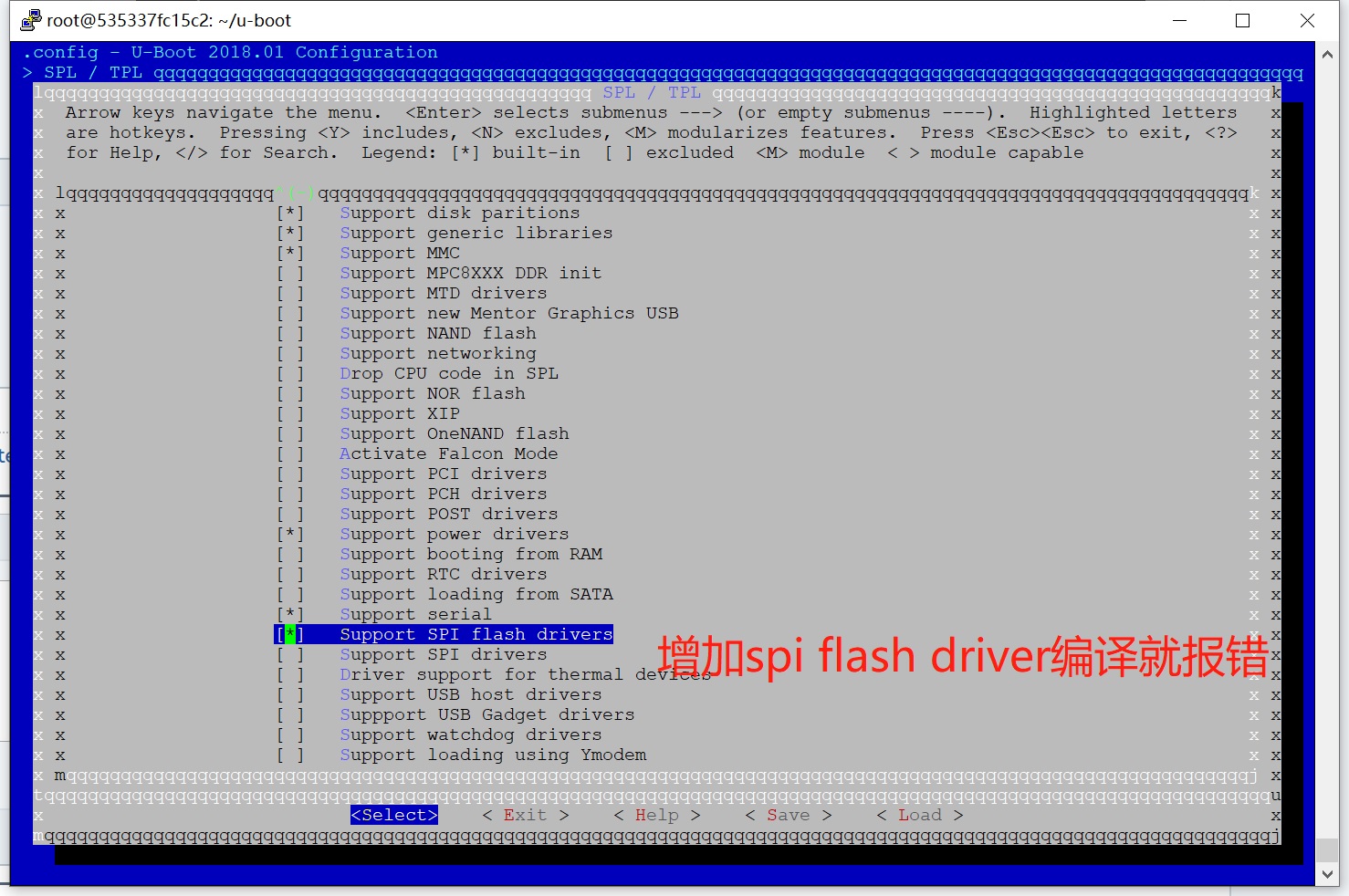

荔枝派Nano F1C100s u-boot都正常,挂在根文件时出错了
板子买的是荔枝派Nano ,spi-flash的,烧写的16M的,因为flash芯片不是默认支持的,芯片型号xt25f128b,改动了下
参考
https://whycan.cn/t_3138.html
uboot修改:
1.
/u-boot/include/configs/suniv.h
#define CONFIG_BOOTCOMMAND "sf probe 0 50000000; " \
"sf read 0x80C00000 0x100000 0x4000; " \
"sf read 0x80008000 0x110000 0x400000; " \
"bootz 0x80008000 - 0x80C00000"
2.
因为使用的flash为xt25f128b
所以修改
/u-boot/drivers/mtd/spi/spi_flash_ids.c
{"w25q128fw", INFO(0xef6018, 0x0, 64 * 1024, 256, RD_FULL | WR_QPP | SECT_4K) },
{"xt25f128b", INFO(0x0b4018, 0x0, 64 * 1024, 256, RD_FULL | WR_QPP | SECT_4K) },
3.
/linux/arch/arm/boot/dts/suniv-f1c100s-licheepi-nano.dts
修改flash名称
compatible = "winbond,xt25f128b", "jedec,spi-nor";
linux修改
1.
/linux/drivers/mtd/devies/m25p80.c
搜jedec 在最后增加xt25定义
{"w25q80bl"}, {"w25q128"}, {"w25q256"}, {"xt25f128b"}
2.
/linux/drivers/mtd/spi-nor
flash_info spi_nor_ids[]中
{ "w25q128", INFO(0xef4018, 0, 64 * 1024, 256, SECT_4K) },
{ "w25q128", INFO(0xef4018, 0, 64 * 1024, 256, 0) },
{ "xt25f128b", INFO(0x0b4018, 0, 64 * 1024, 256, 0) },
编译都很顺利,生成16M的Nano_flash_800480.bin 文件,启动的时候停在Waiting for root device /dev/mmcblk0p2...   ,盼高手指点下怎么回事?串口信息如下:

#2 2020-05-17 17:41:20
已发帖子: 3,394
Re: 荔枝派Nano F1C100s u-boot都正常,挂在根文件时出错了
[    0.000000] Kernel command line: console=tty0 console=ttyS0,115200 panic=5 rootwait root=/dev/mmcblk0p2 rw
你的 bootargs 错了,
而且你的log也没有打印发现 mtd 分区.

楼主 #5 2020-05-17 22:55:27
heiheizi
注册时间: 2019-10-25
积分: 40
照着改了下还是不行,串口信息如下:

楼主 #7 2020-05-18 10:57:53
heiheizi
注册时间: 2019-10-25
积分: 40
报错信息:
include/configs/suniv.h:19:0: warning: "CONFIG_BOOTCOMMAND" redefined
 #define CONFIG_BOOTCOMMAND "setenv bootargs console=tty0 console=ttyS0,115200 panic=5 rootwait root=/dev/mmcblk0p2 rw "\
In file included from ././include/linux/kconfig.h:4:0,
                 from <command-line>:0:
include/generated/autoconf.h:144:0: note: this is the location of the previous definition
 #define CONFIG_BOOTCOMMAND "run distro_bootcmd"
  LD      spl/drivers/mmc/built-in.o
scripts/Makefile.spl:349: recipe for target 'spl/drivers' failed
make[1]: *** [spl/drivers] Error 2
make[1]: *** Waiting for unfinished jobs....
In file included from include/config.h:5:0,
                 from include/common.h:21,
                 from lib/rand.c:11:
  CC      spl/lib/panic.o
                 from lib/panic.c:12:
  CC      spl/lib/strto.o
                 from lib/strto.c:12:
  LD      spl/lib/built-in.o
Makefile:1400: recipe for target 'spl/u-boot-spl' failed
make: *** [spl/u-boot-spl] Error 2
