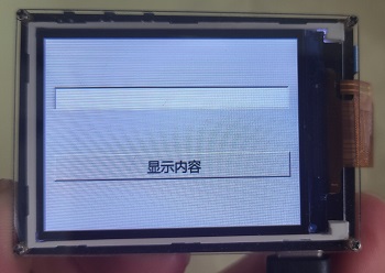

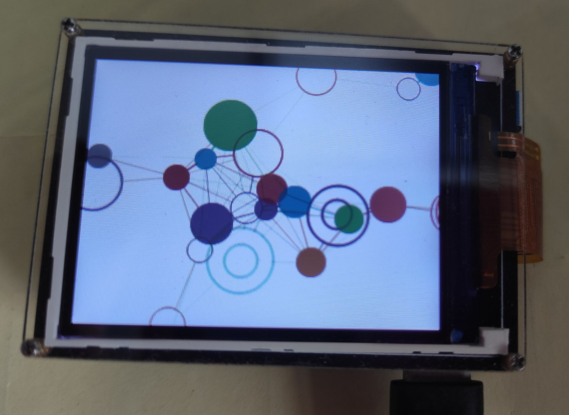

小智 X3 卡片电脑 运行 Python3 + PyQt5
buildroot-2019.08 配置文件:

Re: 小智 X3 卡片电脑 运行 Python3 + PyQt5
楼主 #3 2020-06-02 15:34:43
小智跑腿
注册时间: 2020-04-26
已发帖子: 78
积分: 78
执行命令:
QT_QPA_GENERIC_PLUGINS=evdevkeyboard:/dev/input/event0 QT_QPA_FONTDIR=/usr/share/fonts/ python BubbleTips.py -platform linuxfb:fb="/dev/fb1"
https://github.com/PyQt5/PyQt/blob/master/Demo/CircleLine.py
#!/usr/bin/env python
# -*- coding: utf-8 -*-
Created on 2019年3月19日
@author: Irony
@site: https://pyqt5.com https://github.com/892768447
@email: 892768447@qq.com
@file: CircleLine
@description:
from math import floor, pi, cos, sin
from random import random, randint
from time import time
from PyQt5.QtCore import QTimer, Qt
from PyQt5.QtGui import QColor, QPainter, QPainterPath, QPen
from PyQt5.QtWidgets import QWidget
__Author__ = 'Irony'
__Copyright__ = 'Copyright (c) 2019'
# 最小和最大半径、半径阈值和填充圆的百分比
radMin = 10
radMax = 80
filledCircle = 30  # 填充圆的百分比
concentricCircle = 60  # 同心圆百分比
radThreshold = 25  # IFF special, over this radius concentric, otherwise filled
# 最小和最大移动速度
speedMin = 0.3
speedMax = 0.6
# 每个圆和模糊效果的最大透明度
maxOpacity = 0.6
colors = [
    QColor(52, 168, 83),
    QColor(117, 95, 147),
    QColor(199, 108, 23),
    QColor(194, 62, 55),
    QColor(0, 172, 212),
    QColor(120, 120, 120)
circleBorder = 10
backgroundLine = colors[0]
backgroundColor = QColor(38, 43, 46)
backgroundMlt = 0.85
lineBorder = 2.5
# 最重要的是:包含它们的整个圆和数组的数目
maxCircles = 8
points = []
# 实验变量
circleExp = 1
circleExpMax = 1.003
circleExpMin = 0.997
circleExpSp = 0.00004
circlePulse = False
# 生成随机整数 a<=x<=b
def randint(a, b):
    return floor(random() * (b - a + 1) + a)
# 生成随机小数
def randRange(a, b):
    return random() * (b - a) + a
# 生成接近a的随机小数
def hyperRange(a, b):
    return random() * random() * random() * (b - a) + a
class Circle:
    def __init__(self, background, width, height):
        self.background = background
        self.x = randRange(-width / 2, width / 2)
        self.y = randRange(-height / 2, height / 2)
        self.radius = hyperRange(radMin, radMax)
        self.filled = (False if randint(
            0, 100) > concentricCircle else 'full') if self.radius < radThreshold else (
                False if randint(0, 100) > concentricCircle else 'concentric')
        self.color = colors[randint(0, len(colors) - 1)]
        self.borderColor = colors[randint(0, len(colors) - 1)]
        self.opacity = 0.05
        self.speed = randRange(speedMin, speedMax)  # * (radMin / self.radius)
        self.speedAngle = random() * 2 * pi
        self.speedx = cos(self.speedAngle) * self.speed
        self.speedy = sin(self.speedAngle) * self.speed
        spacex = abs((self.x - (-1 if self.speedx < 0 else 1) *
                      (width / 2 + self.radius)) / self.speedx)
        spacey = abs((self.y - (-1 if self.speedy < 0 else 1) *
                      (height / 2 + self.radius)) / self.speedy)
        self.ttl = min(spacex, spacey)
class CircleLineWindow(QWidget):
    def __init__(self, *args, **kwargs):
        super(CircleLineWindow, self).__init__(*args, **kwargs)
        # 设置背景颜色
        palette = self.palette()
        palette.setColor(palette.Background, backgroundColor)
        self.setAutoFillBackground(True)
        self.setPalette(palette)
        # 获取屏幕大小
        geometry = QApplication.instance().desktop().availableGeometry()
        self.screenWidth = geometry.width()
        self.screenHeight = geometry.height()
        self._canDraw = True
        self._firstDraw = True
        self._timer = QTimer(self, timeout=self.update)
        self.init()
    def init(self):
        points.clear()
        # 链接的最小距离
        self.linkDist = min(self.screenWidth, self.screenHeight) / 2.4
        # 初始化点
        for _ in range(maxCircles * 3):
            points.append(Circle('', self.screenWidth, self.screenHeight))
        self.update()
    def showEvent(self, event):
        super(CircleLineWindow, self).showEvent(event)
    def hideEvent(self, event):
        super(CircleLineWindow, self).hideEvent(event)
        # 窗口最小化要停止绘制, 减少cpu占用
        self._canDraw = False
    def paintEvent(self, event):
        super(CircleLineWindow, self).paintEvent(event)
        if not self._canDraw:
            return
        painter = QPainter(self)
        painter.setRenderHint(QPainter.Antialiasing)
        painter.setRenderHint(QPainter.SmoothPixmapTransform)
        self.draw(painter)
    def draw(self, painter):
        if circlePulse:
            if circleExp < circleExpMin or circleExp > circleExpMax:
                circleExpSp *= -1
            circleExp += circleExpSp
        painter.translate(self.screenWidth / 2, self.screenHeight / 2)
        if self._firstDraw:
            t = time()
        self.renderPoints(painter, points)
        if self._firstDraw:
            self._firstDraw = False
            # 此处有个比例关系用于设置timer的时间,如果初始窗口很小,没有比例会导致动画很快
            t = (time() - t) * 1000 * 2
            # 比例最大不能超过1920/800
            t = int(min(2.4, self.screenHeight / self.height()) * t) - 1
            t = t if t > 15 else 15  # 不能小于15s
            print('start timer(%d msec)' % t)
            # 开启定时器
            self._timer.start(t)
    def drawCircle(self, painter, circle):
        #         circle.radius *= circleExp
        if circle.background:
        else:
            circle.radius /= circleExp
        radius = circle.radius
        r = radius * circleExp
        # 边框颜色设置透明度
        c = QColor(circle.borderColor)
        c.setAlphaF(circle.opacity)
        painter.save()
        if circle.filled == 'full':
            # 设置背景刷
            painter.setBrush(c)
            painter.setPen(Qt.NoPen)
        else:
            # 设置画笔
            painter.setPen(
                QPen(c, max(1, circleBorder * (radMin - circle.radius) / (radMin - radMax))))
        # 画实心圆或者圆圈
        painter.drawEllipse(circle.x - r, circle.y - r, 2 * r, 2 * r)
        painter.restore()
        if circle.filled == 'concentric':
            r = radius / 2
            # 画圆圈
            painter.save()
            painter.setBrush(Qt.NoBrush)
            painter.setPen(
            painter.restore()
        circle.x += circle.speedx
        circle.y += circle.speedy
        if (circle.opacity < maxOpacity):
            circle.opacity += 0.01
        circle.ttl -= 1
    def renderPoints(self, painter, circles):
        for i, circle in enumerate(circles):
            if circle.ttl < -20:
                # 重新初始化一个
                circle = Circle('', self.screenWidth, self.screenHeight)
                circles[i] = circle
            self.drawCircle(painter, circle)
        circles_len = len(circles)
        for i in range(circles_len - 1):
            for j in range(i + 1, circles_len):
                deltax = circles[i].x - circles[j].x
                deltay = circles[i].y - circles[j].y
                dist = pow(pow(deltax, 2) + pow(deltay, 2), 0.5)
                # if the circles are overlapping, no laser connecting them
                if dist <= circles[i].radius + circles[j].radius:
                    continue
                # otherwise we connect them only if the dist is < linkDist
                if dist < self.linkDist:
                    xi = (1 if circles[i].x < circles[j].x else -
                          1) * abs(circles[i].radius * deltax / dist)
                    yi = (1 if circles[i].y < circles[j].y else -
                          1) * abs(circles[i].radius * deltay / dist)
                    xj = (-1 if circles[i].x < circles[j].x else 1) * \
                        abs(circles[j].radius * deltax / dist)
                    yj = (-1 if circles[i].y < circles[j].y else 1) * \
                        abs(circles[j].radius * deltay / dist)
                    path = QPainterPath()
                    path.moveTo(circles[i].x + xi, circles[i].y + yi)
                    path.lineTo(circles[j].x + xj, circles[j].y + yj)
#                     samecolor = circles[i].color == circles[j].color
                    c = QColor(circles[i].borderColor)
                    c.setAlphaF(min(circles[i].opacity, circles[j].opacity)
                                * ((self.linkDist - dist) / self.linkDist))
                    painter.setPen(QPen(c, (
                        lineBorder * backgroundMlt if circles[i].background else lineBorder) * (
                        (self.linkDist - dist) / self.linkDist)))
                    painter.drawPath(path)
if __name__ == '__main__':
    import sys
    from PyQt5.QtWidgets import QApplication
    app = QApplication(sys.argv)
    w = CircleLineWindow()
    w.resize(800, 600)
    w.show()
    sys.exit(app.exec_())
执行命令:
QT_QPA_GENERIC_PLUGINS=evdevkeyboard:/dev/input/event0 QT_QPA_FONTDIR=/usr/share/fonts/ python CircleLine.py -platform linuxfb:fb="/dev/fb1"
