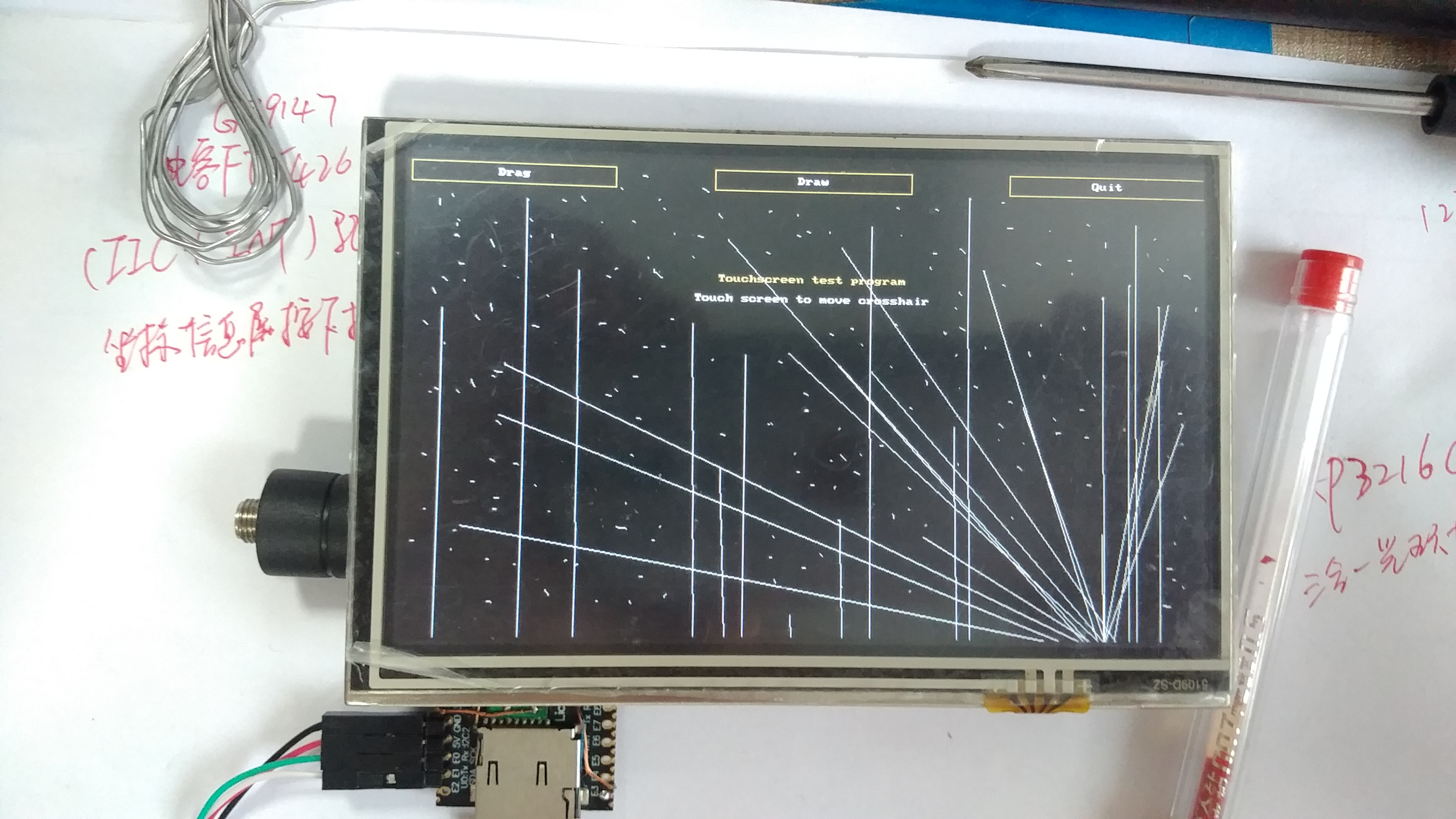

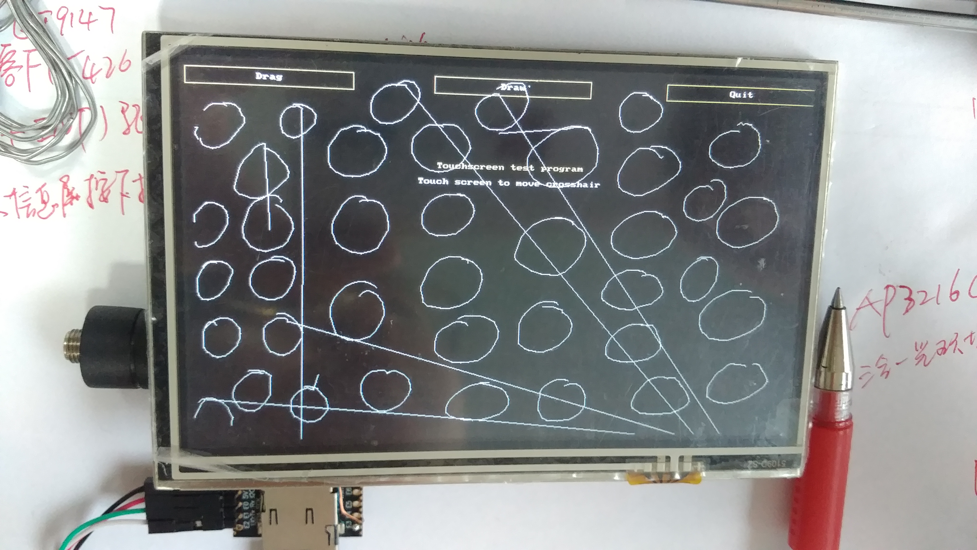

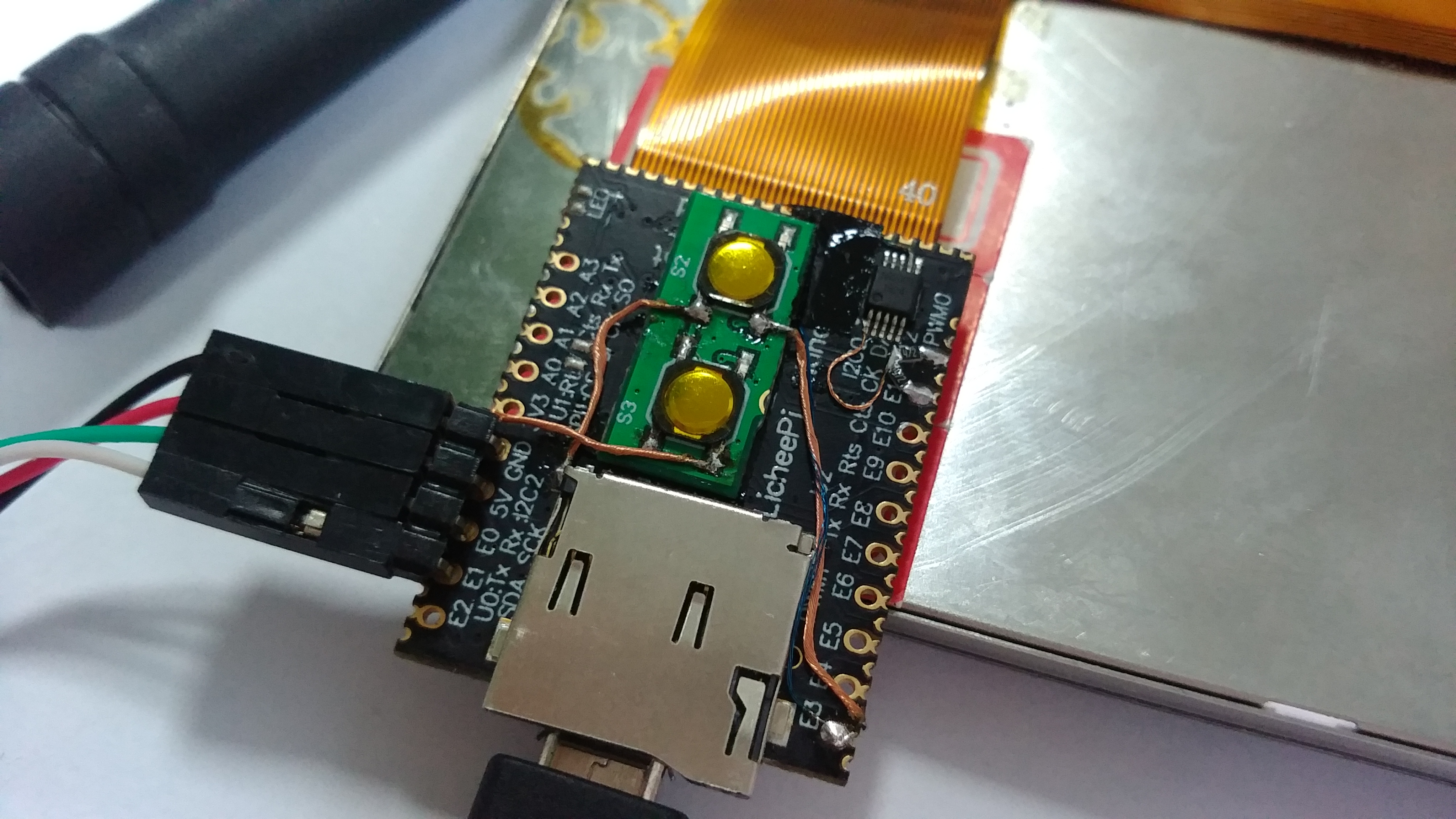

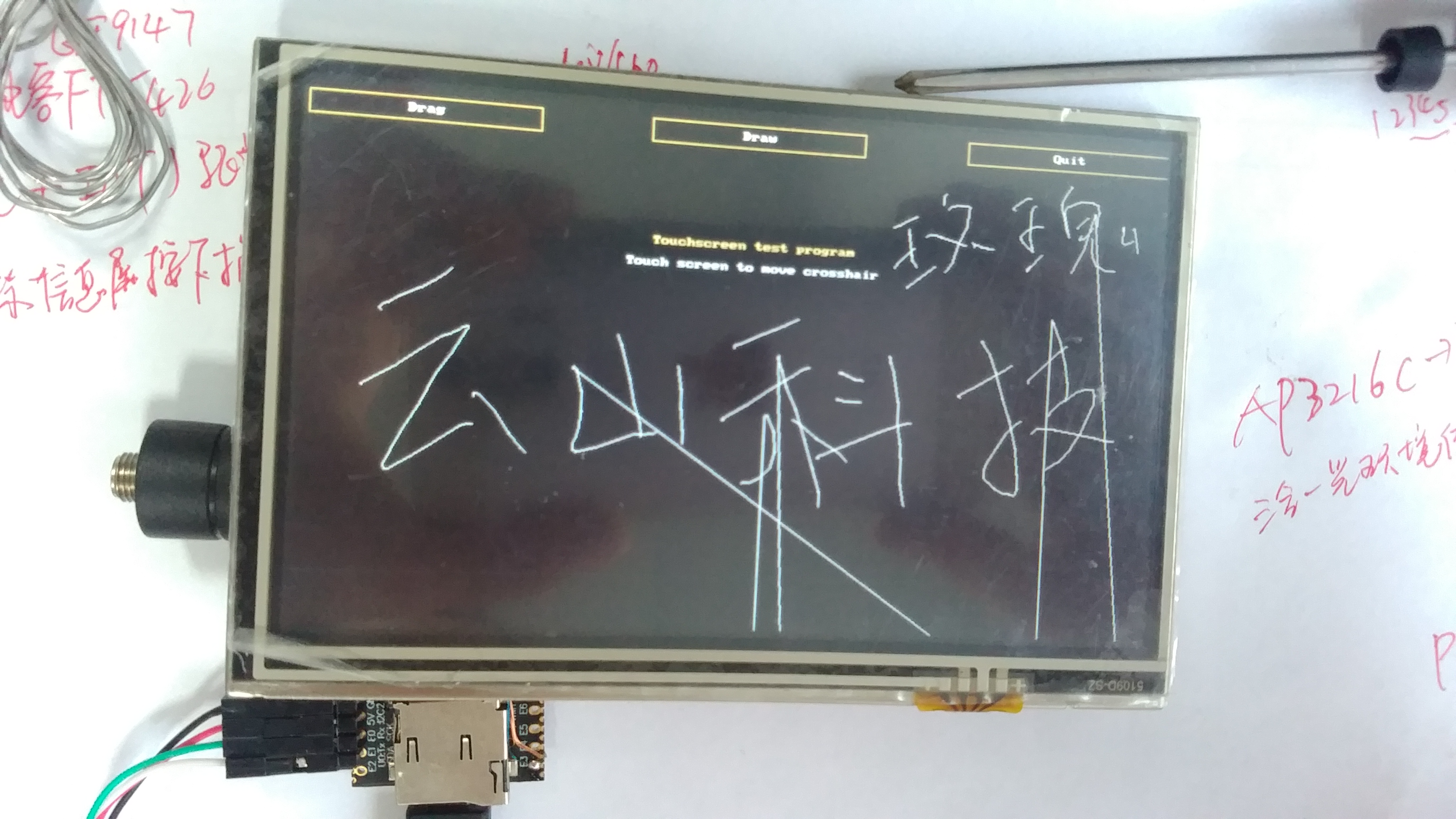

nano移植驱动ns2009,触摸测试效果有飞线
1. 使用内核的2007触摸驱动,
2. 填nano硬件i2c坑上拉电阻,
3. 触摸使用中断模式,跳线增加ns2009中断,使用PE3口,
4. buildroot编译tslib,
求解:
1.触摸测试的飞线,怎么解决?
2.测试的时候nano板子,发热特别厉害,是怎么回事?
手术后的nano:
1测试写字:
2测试画圈:
3测试画点:
#2 2020-07-14 16:02:45
已发帖子: 3,394
Re: nano移植驱动ns2009,触摸测试效果有飞线
改这个文件: /etc/ts.conf
# Access plugins
# Uncomment if you wish to use the linux input layer event interface
module_raw input
# For other driver modules, see the ts.conf man page
# Filter plugins
# Uncomment if first or last samples are unreliable
# module skip nhead=1 ntail=1
# Uncomment if needed for devices that measure pressure
module pthres pmin=1
# module debounce drop_threshold=40
# Uncomment if needed to filter spikes
# module median depth=5
# Uncomment to enable smoothing of fraction N/D
# module iir N=6 D=10
# module lowpass factor=0.1 threshold=1
# Uncomment if needed to filter noise samples
module dejitter delta=100
# Uncomment and adjust if you need to invert an axis or both
# module invert x0=800 y0=480
# Uncomment to use ts_calibrate's settings
module linear
把被屏蔽的 module 启动起来,并且逐个修改参数,慢慢测试试一试。
话说F1C100s自带的RTP外设默认就把这些飞点和抖动都处理好了,非常的流畅。
