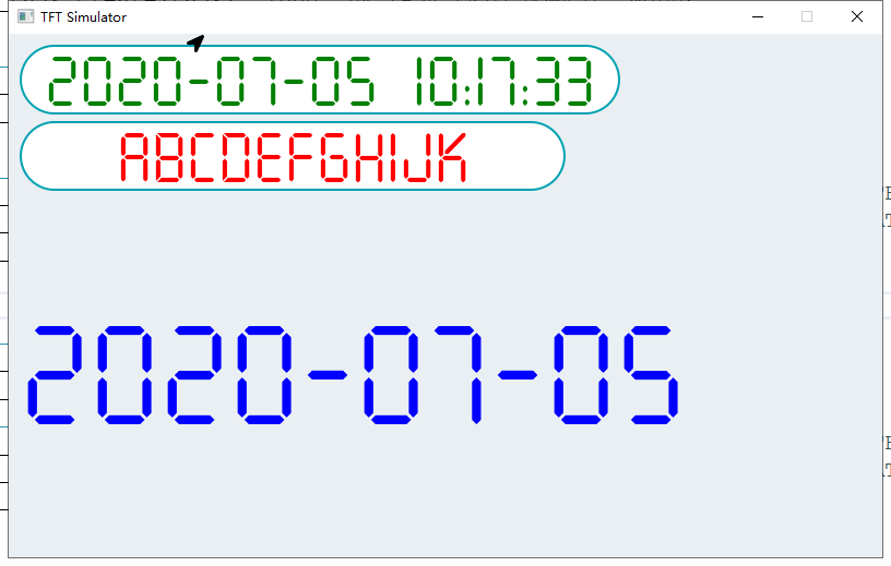

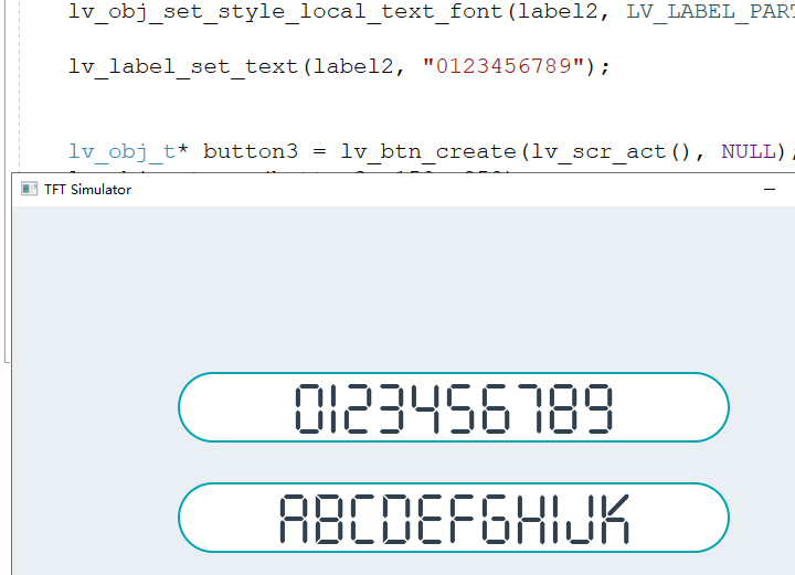

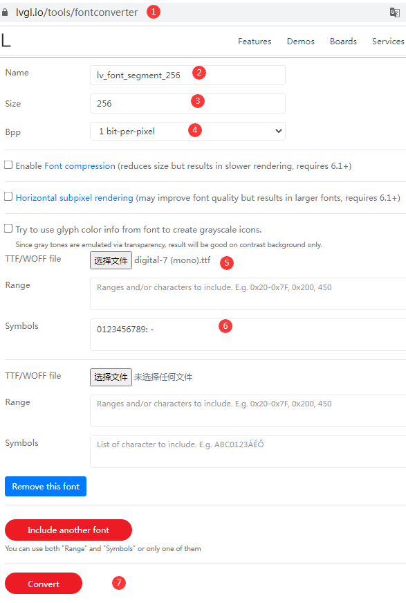

又找到一个段码字体: https://fontmeme.com/fonts/seven-segment-font/
ttf段码字体本站下载: seven-segment.zip
littlevgl 字体生成:
lv_font_conv --no-compress --format lvgl --font "D:\8899\7 Segment.ttf" -o font_segment_64.c --bpp 4 --size 64 --symbols "0123456789abcdefghijklmnopqrstuvwxyzABCDEFGHIJKLMNOPQRSTUVWXYZ " -r 0x20-0x7F
	lv_obj_t* label2 = lv_label_create(button2, NULL);
	lv_obj_set_style_local_text_font(label2, LV_LABEL_PART_MAIN, LV_STATE_DEFAULT, &font_segment_64);
	lv_label_set_text(label2, "0123456789");
	lv_obj_t* button3 = lv_btn_create(lv_scr_act(), NULL);
	lv_obj_set_pos(button3, 150, 250);
	lv_obj_set_size(button3, 500, 64);
	lv_obj_t* label3 = lv_label_create(button3, NULL);
	lv_obj_set_style_local_text_font(label3, LV_LABEL_PART_MAIN, LV_STATE_DEFAULT, &font_segment_64);
	lv_label_set_text(label3, "ABCDEFGHIJK");
楼主 #7 2020-08-05 10:39:36

代码:
void lv_test2()
	lv_task_create(task2, 1000, LV_TASK_PRIO_LOWEST, NULL);
	lv_obj_t* button2 = lv_btn_create(lv_scr_act(), NULL);
	lv_obj_set_pos(button2, 10, 10);
	lv_obj_set_size(button2, 550, 64);
	lv_obj_set_style_local_text_color(label2, LV_LABEL_PART_MAIN, LV_STATE_DEFAULT, LV_COLOR_GREEN);
	lv_label_set_text(label2, "2020-07-05 10:17:33");
	lv_obj_set_pos(button3, 10, 80);
	lv_obj_set_style_local_text_color(label3, LV_LABEL_PART_MAIN, LV_STATE_DEFAULT, LV_COLOR_RED);
	lv_obj_t* label4 = lv_label_create(lv_scr_act(), NULL);
	lv_obj_set_pos(label4, 10, 250);
	lv_obj_set_size(label4, 650, 128);
	lv_obj_set_style_local_text_font(label4, LV_LABEL_PART_MAIN, LV_STATE_DEFAULT, &font_segment_128);
	lv_obj_set_style_local_text_color(label4, LV_LABEL_PART_MAIN, LV_STATE_DEFAULT, LV_COLOR_BLUE);
	lv_label_set_text(label4, "2020-07-05");
字体生成:
lv_font_conv --no-compress --format lvgl --font "D:\8899\7 Segment.ttf" -o font_segment_128.c --bpp 4 --size 128 --symbols "0123456789abcdefghijklmnopqrstuvwxyzABCDEFGHIJKLMNOPQRSTUVWXYZ: " -r 0x20-0x7F

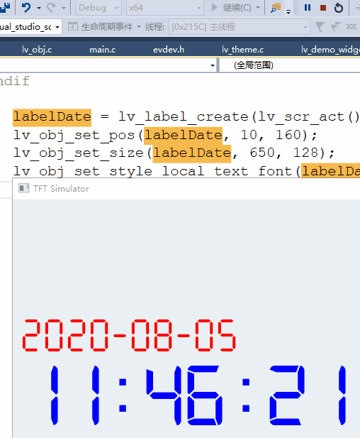

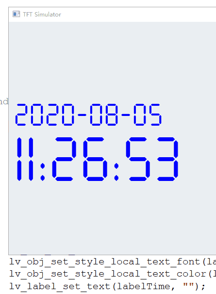

void task2(lv_task_t* task)
	char strdate[16];
	char strtime[16];
	time_t t = time(NULL);
	struct tm tm = *localtime(&t);
	snprintf(strdate, sizeof(strdate) - 1, "%04d-%02d-%02d", tm.tm_year + 1900, tm.tm_mon + 1, tm.tm_mday);
	snprintf(strtime, sizeof(strtime) - 1, "%02d:%02d:%02d", tm.tm_hour, tm.tm_min, tm.tm_sec);
	lv_label_set_text(labelDate, strdate);
	lv_label_set_text(labelTime, strtime);
void lv_test2()
	labelDate = lv_label_create(lv_scr_act(), NULL);
	lv_obj_set_pos(labelDate, 10, 160);
	lv_obj_set_size(labelDate, 650, 128);
	lv_obj_set_style_local_text_font(labelDate, LV_LABEL_PART_MAIN, LV_STATE_DEFAULT, &font_segment_64);
	lv_obj_set_style_local_text_color(labelDate, LV_LABEL_PART_MAIN, LV_STATE_DEFAULT, LV_COLOR_BLUE);
	lv_label_set_text(labelDate, "");
	labelTime = lv_label_create(lv_scr_act(), NULL);
	lv_obj_set_pos(labelTime, 10, 220);
	lv_obj_set_size(labelTime, 650, 128);
	lv_obj_set_style_local_text_font(labelTime, LV_LABEL_PART_MAIN, LV_STATE_DEFAULT, &font_segment_128);
	lv_obj_set_style_local_text_color(labelTime, LV_LABEL_PART_MAIN, LV_STATE_DEFAULT, LV_COLOR_BLUE);
	lv_label_set_text(labelTime, "");
	lv_task_create(task2, 900, LV_TASK_PRIO_LOWEST, NULL);
	//lv_task_ready(task2);

达克罗德 说:
这字体真好看
不完美, 因为不等宽.
我去找一个等宽字体看看.

终于找到一个等宽的段码字体: https://www.1001fonts.com/monospaced+lcd-fonts.html
本站下载: digital-7.zip

lv_font_conv --no-compress --format lvgl --font "D:\8899\digital-7\digital-7 (mono).ttf" -o lv_font_segment_24.c --bpp 4 --size 24 --symbols "0123456789abcdefghijklmnopqrstuvwxyzABCDEFGHIJKLMNOPQRSTUVWXYZ: " -r 0x20-0x7F
lv_font_conv --no-compress --format lvgl --font "D:\8899\digital-7\digital-7 (mono).ttf" -o lv_font_segment_32.c --bpp 4 --size 32 --symbols "0123456789abcdefghijklmnopqrstuvwxyzABCDEFGHIJKLMNOPQRSTUVWXYZ: " -r 0x20-0x7F
lv_font_conv --no-compress --format lvgl --font "D:\8899\digital-7\digital-7 (mono).ttf" -o lv_font_segment_48.c --bpp 4 --size 48 --symbols "0123456789abcdefghijklmnopqrstuvwxyzABCDEFGHIJKLMNOPQRSTUVWXYZ: " -r 0x20-0x7F
lv_font_conv --no-compress --format lvgl --font "D:\8899\digital-7\digital-7 (mono).ttf" -o lv_font_segment_64.c --bpp 4 --size 64 --symbols "0123456789abcdefghijklmnopqrstuvwxyzABCDEFGHIJKLMNOPQRSTUVWXYZ: " -r 0x20-0x7F
lv_font_conv --no-compress --format lvgl --font "D:\8899\digital-7\digital-7 (mono).ttf" -o lv_font_segment_128.c --bpp 4 --size 128 --symbols "0123456789abcdefghijklmnopqrstuvwxyzABCDEFGHIJKLMNOPQRSTUVWXYZ: " -r 0x20-0x7F
