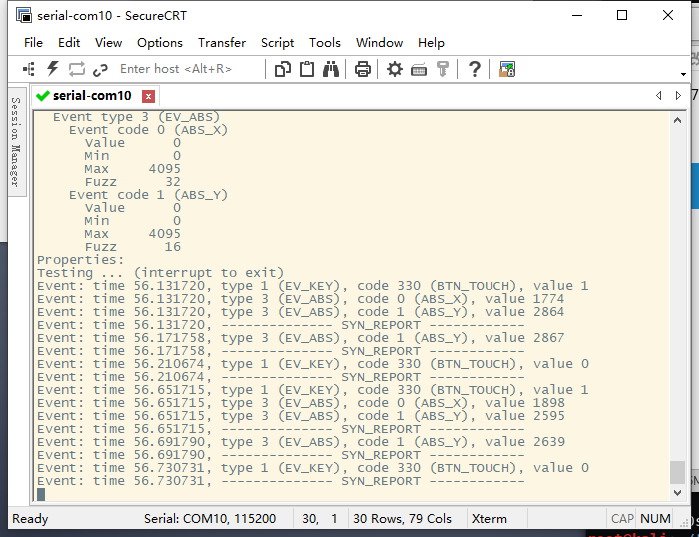

移植NS2009电阻触摸屏驱动后,触摸有数据,屏幕不显示
问题描述:本来屏幕好使,尝试移植ns2009电阻触摸驱动后,开机uboot屏幕有显示,启动内核时,屏幕一点一点变黑,进入系统后evtest 测试触摸有数据。
运行LVGL程序提示
Error: cannot open framebuffer device: No such file or directory

[    1.134632] input: ns2009_ts as /devices/platform/soc/1c27000.twi/i2c-0/0-0048/input/input0

[    1.259679] suniv-pinctrl 1c20800.pinctrl: pin PD0 already requested by 1c27000.twi; cannot claim for 1c0c000.lcd-controller
[    1.270999] suniv-pinctrl 1c20800.pinctrl: pin-96 (1c0c000.lcd-controller) status -22
[    1.278881] suniv-pinctrl 1c20800.pinctrl: could not request pin 96 (PD0) from group PD0  on device 1c20800.pinctrl
[    1.289334] sun4i-tcon 1c0c000.lcd-controller: Error applying setting, reverse things back
[    1.297629] sun4i-tcon: probe of 1c0c000.lcd-controller failed with error -22

Re: 移植NS2009电阻触摸屏驱动后,触摸有数据,屏幕不显示
看log确实没有framebuffer相关记录了,是不是改了dts?
dts增加了 twi0 和 pio 是不是和 屏幕驱动有冲突呢?

我对比了一下,发现这段初始化frame buffer device的时候,PD0被twi占用了,导致没有fb0。我在改改试试。
多谢 流氓兔,小二大佬^_^
这是正常的
[    1.227428] sun4i-drm display-engine: bound 1e60000.display-backend (ops 0xc0739c38)
[    1.236224] sun4i-drm display-engine: bound 1c0c000.lcd-controller (ops 0xc0738f1c)
[    1.244009] [drm] Supports vblank timestamp caching Rev 2 (21.10.2013).
[    1.250666] [drm] No driver support for vblank timestamp query.
[    1.304634] Console: switching to colour frame buffer device 60x34
[    1.328041] sun4i-drm display-engine: fb0:  frame buffer device
[    1.335169] [drm] Initialized sun4i-drm 1.0.0 20150629 for display-engine on minor 0
这是不正常的
