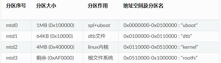

分区规划
下表为分区规划表

读取 spi-flash 1M(0x100000)位置 64KB(0x4000)大小的 dtb 到地址 0x80C00000
读取 spi-flash 1M+64K(0x110000)位置 4MB(0x400000)大小的 zImage 到地址 0x80008000
从 0x80008000 启动内核,从 0x80C00000 读取设备树配置

        partitions {
            #address-cells = <1>;
            #size-cells = <1>;
            partition@0 {
                label = "u-boot";
                reg = <0x000000 0x100000>;
                read-only;
            partition@100000 {
                label = "dtb";
                reg = <0x100000 0x10000>;
                read-only;
            partition@110000 {
                label = "kernel";
                reg = <0x110000 0x400000>;
                read-only;
            partition@510000 {
                label = "rootfs";
                reg = <0x510000 0xAF0000>;
此处在dts中为mtd设备预先划分好了分区内容,内核将会自动解析

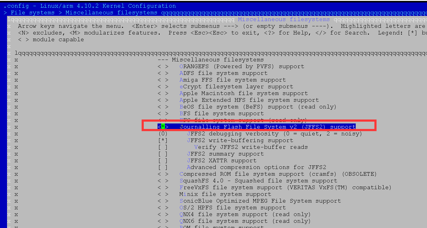

内核配置修改
勾选 File systems ‣ Miscellaneous filesystems ‣ Journalling Flash File System v2 (JFFS2) support
