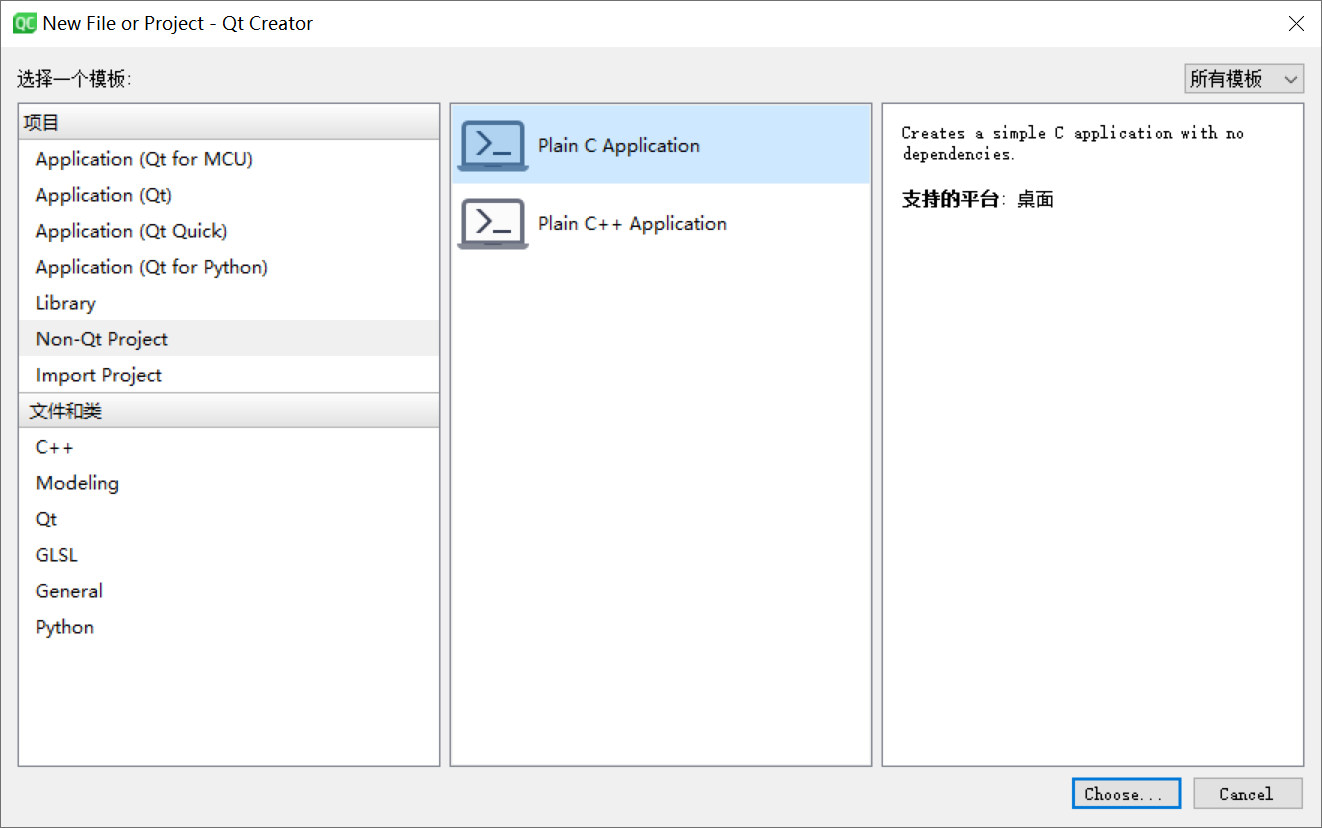

2、创建项目(Qt Creator)
按照如下设置创建项目:
名称:lv_sim_win
创建路径:C:\Ubuntu\github\lv_sim_codeblocks_win
Build system:Qbs
Kit Selection:tdm64-gcc
创建后,关闭Qt Creator,将lv_sim_win目录下的lv_sim_win.qbs和lv_sim_win.qbs.user拷贝到lv_sim_codeblocks_win目录下,删除lv_sim_win目录
打开lv_sim_win项目,编辑lv_sim_win.qbs文件,内容如下:
CppApplication {
    consoleApplication: false
    cpp.includePaths: [
    cpp.staticLibraries: [
        FileInfo.path(cpp.compilerPath) + "/../x86_64-w64-mingw32/lib/libgdi32.a"
    files: [
        "main.c",
        "lvgl/src/*/*.c",
        "lv_drivers/display/*.c",
        "lv_drivers/indev/*.c",
        "lv_drivers/win_drv.c",
        "lv_examples/src/*/*.c",
    excludeFiles: [
        "lv_examples/src/lv_ex_*/*.c"
然后就可以编译、运行、调试了
