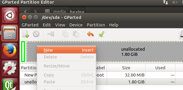

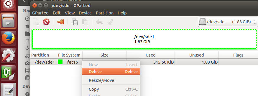

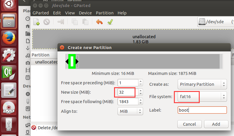

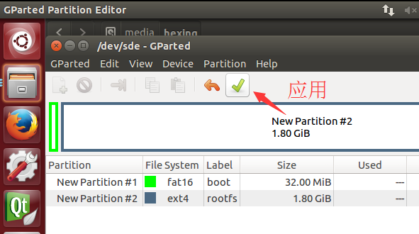

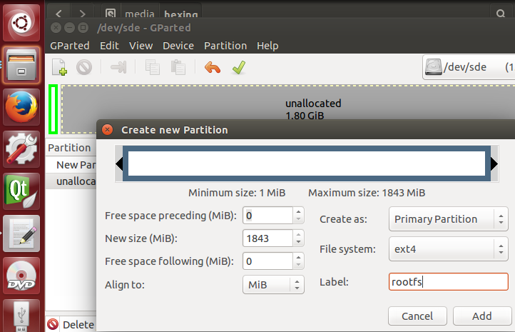

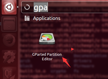

  1. 先编译出u-boot, Linux, dtb 文件, 用buildroot编译出根文件系统.
  2. 烧录TF卡,打开gparted
    1) 删除TF卡所有分区
    2) 将uboot写入到sd卡8k偏移处。
    sudo dd if=u-boot-sunxi-with-spl_480800.bin of=/dev/sdb bs=1024 seek=8
    3) 建立第一个分区,大小32M(可以随意填写), 格式FAT16, 把zImage, sun8i-v3s-licheepi-zero-dock.dtb拷贝到 这个分区
  3. TF卡插入荔枝派Zero开发板, 插入串口, 启动。

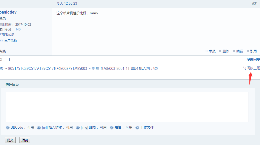

另外问下,论坛上收到对自己的回复,没新信息提醒吗。。。好像只能随时关注帖子

@Jmhh247 是的, 抱歉现在还没有通知功能, 计划后续加上邮件和手机短信功能, 目前我个人精力和能力都有限, 等以后人气好了希望可以全职经营网站。

感谢支持, 刚刚研究了一下, 搞定了 EMAIL 订阅的问题, 初步验证是可以用的.
按上面的链接, 可以订阅主题的所有回复, 如果该主题有新帖子,会通过EMAIL推送.

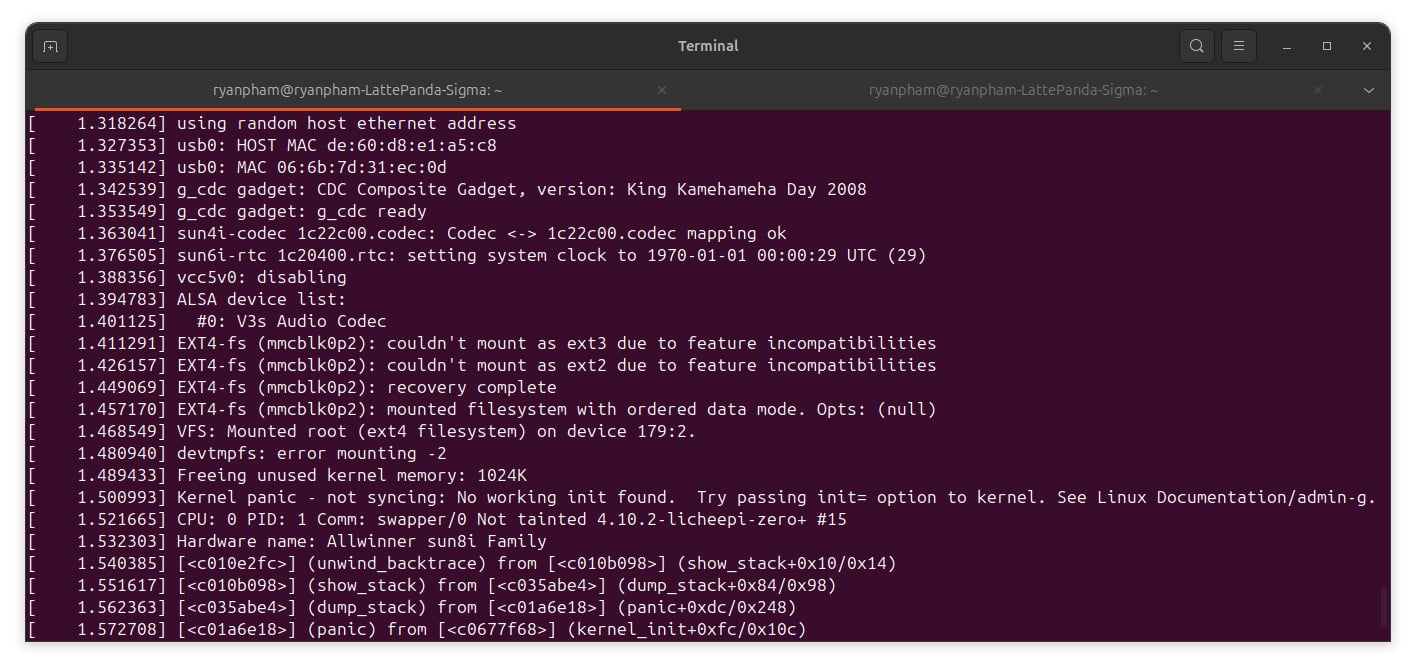

#27 2019-01-07 16:54:59
千石级灯
注册时间: 2018-12-20
已发帖子: 47
积分: 47
Re: 【视频分享】制作荔枝派Zero开发板(全志V3s) TF/SD卡启动盘
@晕哥
晕哥,我之前配置好的内核和根文件系统,之前烧进tft卡能够跑起来,但是现在我重新烧了之后,一直出现如下问题,解决不了,请晕哥帮忙分析下原因:
egulator
[    1.284498] musb-hdrc musb-hdrc.1.auto: MUSB HDRC host driver
[    1.290342] musb-hdrc musb-hdrc.1.auto: new USB bus registered, assigned bus number 3
[    1.299464] hub 3-0:1.0: USB hub found
[    1.303332] hub 3-0:1.0: 1 port detected
[    1.309655] using random self ethernet address
[    1.314111] using random host ethernet address
[    1.319705] usb0: HOST MAC 6a:d5:57:40:e4:d4
[    1.324025] usb0: MAC 0e:cd:1a:52:8f:7c
[    1.328015] g_cdc gadget: CDC Composite Gadget, version: King Kamehameha Day 2008
[    1.335495] g_cdc gadget: g_cdc ready
[    1.341732] sun4i-codec 1c22c00.codec: Codec <-> 1c22c00.codec mapping ok
[    1.350212] sun6i-rtc 1c20400.rtc: setting system clock to 1970-01-01 00:00:15 UTC (15)
[    1.358525] vcc5v0: disabling
[    1.361499] ALSA device list:
[    1.364463]   #0: V3s Audio Codec
[    1.369788] EXT4-fs (mmcblk0p2): couldn't mount as ext3 due to feature incompatibilities
[    1.379157] EXT4-fs (mmcblk0p2): couldn't mount as ext2 due to feature incompatibilities
[    1.406827] EXT4-fs (mmcblk0p2): recovery complete
[    1.411647] EXT4-fs (mmcblk0p2): mounted filesystem with ordered data mode. Opts: (null)
[    1.419913] VFS: Mounted root (ext4 filesystem) on device 179:2.
[    1.439708] devtmpfs: mounted
[    1.443910] Freeing unused kernel memory: 1024K
[    1.468423] Starting init: /sbin/init exists but couldn't execute it (error -5)
[    1.477461] Starting init: /bin/sh exists but couldn't execute it (error -5)
[    1.484519] Kernel panic - not syncing: No working init found.  Try passing init= option to kernel. See Linux Documentation/admin-guide/init.rst for guidance.
[    1.498672] CPU: 0 PID: 1 Comm: swapper/0 Not tainted 4.13.16-licheepi-zero+ #14
[    1.506055] Hardware name: Allwinner sun8i Family
[    1.510793] [<c010e4c4>] (unwind_backtrace) from [<c010b21c>] (show_stack+0x10/0x14)
[    1.518537] [<c010b21c>] (show_stack) from [<c066afdc>] (dump_stack+0x84/0x98)
[    1.525764] [<c066afdc>] (dump_stack) from [<c011b568>] (panic+0xdc/0x248)
[    1.532643] [<c011b568>] (panic) from [<c067d9f0>] (kernel_init+0x100/0x110)
[    1.539688] [<c067d9f0>] (kernel_init) from [<c0107578>] (ret_from_fork+0x14/0x3c)
[    1.547262] Rebooting in 5 seconds..
楼主 #28 2019-01-07 16:56:52
已发帖子: 9,483
文件系统挂载成功, 但是你的文件系统出了问题, 测试了几个文件都没有执行成功.
建议换卡重烧试一试。
#29 2019-01-07 20:19:08
千石级灯
注册时间: 2018-12-20
已发帖子: 47
积分: 47
@晕哥
晕哥,我换了两张8G的tft卡,重新烧了一遍还是出现刚才那个问题,之前使用的是1G的tft卡,想问下v3s开发板对tft卡的容量也有要求的呢?还是由其他问题引起的呢?
楼主 #30 2019-01-07 20:26:52
已发帖子: 9,483
@千石级灯
从这log看, 你的文件系统挂在成功,并且已经找到文件,当时执行失败了.
你到ubuntu挂载tf卡, 检查文件的 md5 码是不是和原来的文件一致,
并且检查文件是否有执行属性.

各位达人,我Linux新手,下载了V3s_TFCard,按照步骤写好TF卡,但好像启动不了。
提示信息如下:
[    0.000000] Linux version 4.13.0-licheepi-zero+ (hexing@ubuntu) (gcc version 4.8.4 (Ubuntu/Linaro 4.8.4-2ubuntu1~14.04.1)) #46 SMP Fri Dec 15 14:36:43 CST 2017
[    0.000000] percpu: Embedded 16 pages/cpu @c3de6000 s33920 r8192 d23424 u65536
[    0.000000] Kernel command line: console=ttyS0,115200 panic=5 mtdparts=spi32766.0:1M(uboot),64k(dtb),4M(kernel),-(rootfs) rootwait root=/dev/mmcblk0p2 earlyprintk rw  vt.global_cursor_default=0
[    0.000000] Memory: 53572K/64036K available (6144K kernel code, 222K rwdata, 1480K rodata, 1024K init, 266K bss, 10464K reserved, 0K cma-reserved, 0K highmem)
[    0.000000]       .data : 0xc0a00000 - 0xc0a37b00   ( 223 kB)
[    0.000000]        .bss : 0xc0a3ebec - 0xc0a8153c   ( 267 kB)
[    0.000000] 	RCU event tracing is enabled.
[    0.000000] 	RCU restricting CPUs from NR_CPUS=8 to nr_cpu_ids=1.
[    0.000194] clocksource: timer: mask: 0xffffffff max_cycles: 0xffffffff, max_idle_ns: 79635851949 ns
[    0.000431] Console: colour dummy device 80x30
[    0.000468] Calibrating delay loop (skipped), value calculated using timer frequency.. 48.00 BogoMIPS (lpj=240000)
[    0.000485] pid_max: default: 32768 minimum: 301
[    0.000610] Mount-cache hash table entries: 1024 (order: 0, 4096 bytes)
[    0.000625] Mountpoint-cache hash table entries: 1024 (order: 0, 4096 bytes)
[    0.001233] CPU: Testing write buffer coherency: ok
[    0.001608] /cpus/cpu@0 missing clock-frequency property
[    0.001633] CPU0: thread -1, cpu 0, socket 0, mpidr 80000000
[    0.002074] Setting up static identity map for 0x40100000 - 0x40100060
[    0.002255] Hierarchical SRCU implementation.
[    0.002749] smp: Bringing up secondary CPUs ...
[    0.002764] smp: Brought up 1 node, 1 CPU
[    0.002774] SMP: Total of 1 processors activated (48.00 BogoMIPS).
[    0.002781] CPU: All CPU(s) started in SVC mode.
[    0.003551] devtmpfs: initialized
[    0.006692] VFP support v0.3: implementor 41 architecture 2 part 30 variant 7 rev 5
[    0.006994] clocksource: jiffies: mask: 0xffffffff max_cyc[    0.896270] ehci-platform 1c1a000.usb: USB 2.0 started, EHCI 1.0[    1.011370] hub 2-0:1.0: USB hub found
[    1.015211] hub 2-0:1.0: 1 port detected
[    1.022872] udc-core: couldn't find an available UDC - added [g_cdc] to list of pending drivers
[    1.032488] input: 1c22800.lradc as /devices/platform/soc/1c22800.lradc/input/input0
[    1.041516] sun6i-rtc 1c20400.rtc: rtc core: registered rtc-sun6i as rtc0
[    1.048423] sun6i-rtc 1c20400.rtc: RTC enabled
[    1.052977] i2c /dev entries driver
[    1.058015] input: ns2009_ts as /devices/platform/soc/1c2ac00.i2c/i2c-0/0-0048/input/input1
[    1.067528] sunxi-wdt 1c20ca0.watchdog: Watchdog enabled (timeout=16 sec, nowayout=0)
[    1.136300] sunxi-mmc 1c0f000.mmc: base:0xc407b000 irq:23
[    1.184441] mmc0: host does not support reading read-only switch, assuming write-enable
[    1.194788] mmc0: new high speed SD card at address b368
[    1.200626] sunxi-mmc 1c10000.mmc: base:0xc423b000 irq:24
[    1.207096] usbcore: registered new interface driver usbhid
[    1.212673] usbhid: USB HID core driver
[    1.217474] mmcblk0: mmc0:b368 NCard 948 MiB
[    1.223956] sun4i-codec 1c22c00.codec: ASoC: /soc/codec-analog@01c23000 not registered
[    1.232014] sun4i-codec 1c22c00.codec: Failed to register our card
[    1.238509]  mmcblk0: p1 p2
[    1.246742] NET: Registered protocol family 17
[    1.251321] Key type dns_resolver registered
[    1.255737] Registering SWP/SWPB emulation handler
[    1.265108] simple-framebuffer 43e89000.framebuffer: framebuffer at 0x43e89000, 0x177000 bytes, mapped to 0xc4400000
[    1.275821] simple-framebuffer 43e89000.framebuffer: format=x8r8g8b8, mode=800x480x32, linelength=3200
[    1.292132] Console: switching to colour frame buffer device 100x30
[    1.304579] simple-framebuffer 43e89000.framebuffer: fb0: simplefb registered!
[    1.313166] usb_phy_generic usb_phy_generic.0.auto: usb_phy_generic.0.auto supply vcc not found, using dummy regulator
[    1.324610] musb-hdrc musb-hdrc.1.auto: MUSB HDRC host driver
[    1.330462] musb-hdrc musb-hdrc.1.auto: new USB bus registered, assigned bus number 3
[    1.339570] hub 3-0:1.0: USB hub found
[    1.343436] hub 3-0:1.0: 1 port detected
[    1.348767] using random self ethernet address
[    1.353260] using random host ethernet address
[    1.359873] usb0: HOST MAC 16:b7:19:bf:dd:37
[    1.364189] usb0: MAC be:20:76:d4:fc:ad
[    1.368196] g_cdc gadget: CDC Composite Gadget, version: King Kamehameha Day 2008
[    1.375673] g_cdc gadget: g_cdc ready
[    1.382070] sun4i-codec 1c22c00.codec: Codec <-> 1c22c00.codec mapping ok
[    1.390587] sun6i-rtc 1c20400.rtc: setting system clock to 1970-01-01 00:00:10 UTC (10)
[    1.398919] vcc5v0: disabling
[    1.401897] ALSA device list:
[    1.404860]   #0: V3s Audio Codec
[    1.410433] EXT4-fs (mmcblk0p2): couldn't mount as ext3 due to feature incompatibilities
[    1.419934] EXT4-fs (mmcblk0p2): couldn't mount as ext2 due to feature incompatibilities
[    1.751275] random: crng init done
[    2.069362] EXT4-fs (mmcblk0p2): recovery complete
[    2.077323] EXT4-fs (mmcblk0p2): mounted filesystem with ordered data mode. Opts: (null)
[    2.085489] VFS: Mounted root (ext4 filesystem) on device 179:2.
[    2.092928] devtmpfs: mounted
[    2.097258] Freeing unused kernel memory: 1024K
mount: you must be root
mkdir: can't create directory '/dev/pts': Permission denied
mkdir: can't create directory '/dev/shm': Permission denied
hostname: sethostname: Operation not permitted
Starting logging: OK
Starting network: ip: RTNETLINK answers: Operation not permitted
ip: SIOCSIFFLAGS: Operation not permitted
FAIL
can't open /dev/console: Permission denied
楼主 #55 2019-05-07 14:56:33
已发帖子: 9,483
貌似第二个分区缺文件或者目录的权限有问题

#65 2020-03-31 00:43:21
carl
注册时间: 2020-03-27
按照晕哥的步骤做了,我的主机是Ubuntu16.04,用的是USB 的读卡器,TF卡是sandisk,16G
1.将TF卡分全部删除
2.sudo dd if=u-boot-sunxi-with-spl.bin of=/dev/sdb bs=1024 seek=8
3.出现问题,GParted分区工具提示GPT 崩溃,继续流程
4.创建2个分区,一个32M,一个是剩下的全部,这个时候还是会提醒GPT崩溃,点击确定之后可以进行分区
5.将zimage和dtb文件拷贝到文件32M,另一个是将root.tar解压到15G的另一个分区。
以上步骤完成后,插入TF卡,没有任何的反应,怀疑是uboot没有烧进去。重复第2个步骤,然后出现找不到mmcblk2的log,VFS无法挂载
log如下:从下面的log看,
[ 1.405767] VFS: Cannot open root device "mmcblk0p2" or unknown-block(179,2): error -6
[ 1.413788] Please append a correct "root=" boot option; here are the available partitions:
[ 1.422164] b300 15159296 mmcblk0
这个分区是mmcblk0,而启动命令参数是root=/dev/mmcblk0p2,难道需要改启动参数。但是我使用的晕哥的这个固件(uboot,zimage,dtb,rootfs)
U-Boot 2017.01-rc2-00075-gec3f3ba-dirty (Dec 15 2017 - 14:00:51 +0800) Allwinner Technology
Model: Lichee Pi Zero
DRAM:  64 MiB
MMC:   SUNXI SD/MMC: 0
In:    serial@01c28000
Out:   serial@01c28000
Err:   serial@01c28000
Net:   phy interface0
eth0: ethernet@1c30000
starting USB...
No controllers found
GUID Partition Table Entry Array CRC is wrong: 0x9e95e65e != 0xb897ee45
part_get_info_efi: *** ERROR: Invalid GPT ***
part_get_info_efi: ***        Using Backup GPT ***
reading zImage
4016104 bytes read in 642 ms (6 MiB/s)
11803 bytes read in 28 ms (411.1 KiB/s)
   Loading Device Tree to 42dfa000, end 42dffe1a ... OK
[    0.000430] Console: colour dummy device 80x30
[    0.000467] Calibrating delay loop (skipped), value calculated using timer frequency.. 48.00 BogoMIPS (lpj=240000)
[    0.000483] pid_max: default: 32768 minimum: 301
[    0.000611] Mount-cache hash table entries: 1024 (order: 0, 4096 bytes)
[    0.000627] Mountpoint-cache hash table entries: 1024 (order: 0, 4096 bytes)
[    0.001227] CPU: Testing write buffer coherency: ok
[    0.001600] /cpus/cpu@0 missing clock-frequency property
[    0.001626] CPU0: thread -1, cpu 0, socket 0, mpidr 80000000
[    0.002072] Setting up static identity map for 0x40100000 - 0x40100060
[    0.002251] Hierarchical SRCU implementation.
[    0.002744] smp: Bringing up secondary CPUs ...
[    0.002760] smp: Brought up 1 node, 1 CPU
[    0.002769] SMP: Total of 1 processors activated (48.00 BogoMIPS).
[    0.002776] CPU: All CPU(s) started in SVC mode.
[    0.003541] devtmpfs: initialized
[    0.006698] VFP support v0.3: implementor 41 architecture 2 part 30 variant 7 rev 5
[    0.007007] clocksource: jiffies: mask: 0xffffffff max_cycles: 0xffffffff, max_idle_ns: 19112604462750000 ns
[    0.007033] futex hash table entries: 256 (order: 2, 16384 bytes)
[    0.007198] pinctrl core: initialized pinctrl subsystem
[    0.008076] random: get_random_u32 called from bucket_table_alloc+0xf0/0x250 with crng_init=0
[    0.008221] NET: Registered protocol family 16
[    0.008710] DMA: preallocated 256 KiB pool for atomic coherent allocations
[    0.009845] hw-breakpoint: found 5 (+1 reserved) breakpoint and 4 watchpoint registers.
[    0.009864] hw-breakpoint: maximum watchpoint size is 8 bytes.
[    0.023323] SCSI subsystem initialized
[    0.023636] usbcore: registered new interface driver usbfs
[    0.023705] usbcore: registered new interface driver hub
[    0.023807] usbcore: registered new device driver usb
[    0.024055] pps_core: LinuxPPS API ver. 1 registered
[    0.024066] pps_core: Software ver. 5.3.6 - Copyright 2005-2007 Rodolfo Giometti <giometti@linux.it>
[    0.024089] PTP clock support registered
[    0.024321] Advanced Linux Sound Architecture Driver Initialized.
[    0.026181] clocksource: Switched to clocksource arch_sys_counter
[    0.037007] NET: Registered protocol family 2
[    0.037605] TCP established hash table entries: 1024 (order: 0, 4096 bytes)
[    0.037640] TCP bind hash table entries: 1024 (order: 1, 8192 bytes)
[    0.037664] TCP: Hash tables configured (established 1024 bind 1024)
[    0.037789] UDP hash table entries: 256 (order: 1, 8192 bytes)
[    0.037840] UDP-Lite hash table entries: 256 (order: 1, 8192 bytes)
[    0.038059] NET: Registered protocol family 1
[    0.038654] RPC: Registered named UNIX socket transport module.
[    0.038678] RPC: Registered udp transport module.
[    0.038684] RPC: Registered tcp transport module.
[    0.038689] RPC: Registered tcp NFSv4.1 backchannel transport module.
[    0.040660] workingset: timestamp_bits=30 max_order=14 bucket_order=0
[    0.049614] NFS: Registering the id_resolver key type
[    0.049672] Key type id_resolver registered
[    0.049679] Key type id_legacy registered
[    0.049728] jffs2: version 2.2. (NAND) © 2001-2006 Red Hat, Inc.
[    0.051209] random: fast init done
[    0.054050] Block layer SCSI generic (bsg) driver version 0.4 loaded (major 249)
[    0.054076] io scheduler noop registered
[    0.054084] io scheduler deadline registered
[    0.054340] io scheduler cfq registered (default)
[    0.054354] io scheduler mq-deadline registered
[    0.054361] io scheduler kyber registered
[    0.058679] sun8i-v3s-pinctrl 1c20800.pinctrl: initialized sunXi PIO driver
[    0.127895] Serial: 8250/16550 driver, 8 ports, IRQ sharing disabled
[    0.131119] console [ttyS0] disabled
[    0.151398] 1c28000.serial: ttyS0 at MMIO 0x1c28000 (irq = 36, base_baud = 1500000) is a U6_16550A
[    0.742095] console [ttyS0] enabled
[    0.750265] m25p80 spi32766.0: unrecognized JEDEC id bytes: 00, 00, 00
[    0.756919] m25p80: probe of spi32766.0 failed with error -2
[    0.763129] libphy: Fixed MDIO Bus: probed
[    0.767891] dwmac-sun8i 1c30000.ethernet: PTP uses main clock
[    0.773685] dwmac-sun8i 1c30000.ethernet: No regulator found
[    0.779473] dwmac-sun8i 1c30000.ethernet: Will use internal PHY
[    0.785469] dwmac-sun8i 1c30000.ethernet: Current syscon value is not the default 148000 (expect 38000)
[    0.795050] dwmac-sun8i 1c30000.ethernet: Chain mode enabled
[    0.800744] dwmac-sun8i 1c30000.ethernet: No HW DMA feature register supported
[    0.807973] dwmac-sun8i 1c30000.ethernet: Normal descriptors
[    0.813625] dwmac-sun8i 1c30000.ethernet: RX Checksum Offload Engine supported
[    0.820849] dwmac-sun8i 1c30000.ethernet: COE Type 2
[    0.825807] dwmac-sun8i 1c30000.ethernet: TX Checksum insertion supported
[    0.832777] libphy: stmmac: probed
[    0.838129] ehci_hcd: USB 2.0 'Enhanced' Host Controller (EHCI) Driver
[    0.844666] ehci-platform: EHCI generic platform driver
[    0.850307] ehci-platform 1c1a000.usb: EHCI Host Controller
[    0.855929] ehci-platform 1c1a000.usb: new USB bus registered, assigned bus number 1
[    0.863906] ehci-platform 1c1a000.usb: irq 26, io mem 0x01c1a000
[    0.896201] ehci-platform 1c1a000.usb: USB 2.0 started, EHCI 1.00
[    0.903457] hub 1-0:1.0: USB hub found
[    0.907404] hub 1-0:1.0: 1 port detected
[    0.911895] ohci_hcd: USB 1.1 'Open' Host Controller (OHCI) Driver
[    0.918195] ohci-platform: OHCI generic platform driver
[    0.923767] ohci-platform 1c1a400.usb: Generic Platform OHCI controller
[    0.930496] ohci-platform 1c1a400.usb: new USB bus registered, assigned bus number 2
[    0.938458] ohci-platform 1c1a400.usb: irq 27, io mem 0x01c1a400
[    1.011318] hub 2-0:1.0: USB hub found
[    1.015158] hub 2-0:1.0: 1 port detected
[    1.022800] udc-core: couldn't find an available UDC - added [g_cdc] to list of pending drivers
[    1.032406] input: 1c22800.lradc as /devices/platform/soc/1c22800.lradc/input/input0
[    1.041447] sun6i-rtc 1c20400.rtc: rtc core: registered rtc-sun6i as rtc0
[    1.048356] sun6i-rtc 1c20400.rtc: RTC enabled
[    1.052904] i2c /dev entries driver
[    1.057933] input: ns2009_ts as /devices/platform/soc/1c2ac00.i2c/i2c-0/0-0048/input/input1
[    1.067453] sunxi-wdt 1c20ca0.watchdog: Watchdog enabled (timeout=16 sec, nowayout=0)
[    1.136231] sunxi-mmc 1c0f000.mmc: base:0xc407b000 irq:23
[    1.183269] mmc0: host does not support reading read-only switch, assuming write-enable
[    1.193289] mmc0: new high speed SDHC card at address 0007
[    1.199310] sunxi-mmc 1c10000.mmc: base:0xc423b000 irq:24
[    1.205679] usbcore: registered new interface driver usbhid
[    1.211346] usbhid: USB HID core driver
[    1.216082] mmcblk0: mmc0:0007 SL16G 14.5 GiB
[    1.222782] sun4i-codec 1c22c00.codec: ASoC: /soc/codec-analog@01c23000 not registered
[    1.230838] sun4i-codec 1c22c00.codec: Failed to register our card
[    1.238750] NET: Registered protocol family 17
[    1.243320] Key type dns_resolver registered
[    1.247864] Registering SWP/SWPB emulation handler
[    1.261903] simple-framebuffer 43e89000.framebuffer: framebuffer at 0x43e89000, 0x177000 bytes, mapped to 0xc4400000
[    1.272623] simple-framebuffer 43e89000.framebuffer: format=x8r8g8b8, mode=800x480x32, linelength=3200
[    1.288900] Console: switching to colour frame buffer device 100x30
[    1.301305] simple-framebuffer 43e89000.framebuffer: fb0: simplefb registered!
[    1.309914] usb_phy_generic usb_phy_generic.0.auto: usb_phy_generic.0.auto supply vcc not found, using dummy regulator
[    1.321320] musb-hdrc musb-hdrc.1.auto: MUSB HDRC host driver
[    1.327158] musb-hdrc musb-hdrc.1.auto: new USB bus registered, assigned bus number 3
[    1.336384] hub 3-0:1.0: USB hub found
[    1.340276] hub 3-0:1.0: 1 port detected
[    1.345313] using random self ethernet address
[    1.349872] using random host ethernet address
[    1.355458] usb0: HOST MAC aa:79:94:aa:a8:cf
[    1.359890] usb0: MAC 9a:8b:a7:5b:c9:82
[    1.363775] g_cdc gadget: CDC Composite Gadget, version: King Kamehameha Day 2008
[    1.371290] g_cdc gadget: g_cdc ready
[    1.377744] sun4i-codec 1c22c00.codec: Codec <-> 1c22c00.codec mapping ok
[    1.387235] sun6i-rtc 1c20400.rtc: setting system clock to 1970-01-01 00:00:57 UTC (57)
[    1.395493] vcc5v0: disabling
[    1.398554] ALSA device list:
[    1.401524]   #0: V3s Audio Codec

Hello I create the image as guideline from but I met a problem as image bellow:
Could you please help me
最近编辑记录 ryanpham (2025-05-04 17:20:08)

ryanpham wrote:
/files/members/16486/Untitled.jpegHello I create the image as guideline from but I met a problem as image bellow:
(V3s/V3x/S3/S3L/R11通吃)小智V3x开发板smallwitpi lite u-boot/linux/buildroot测试
https://whycan.com/t_7248.html
