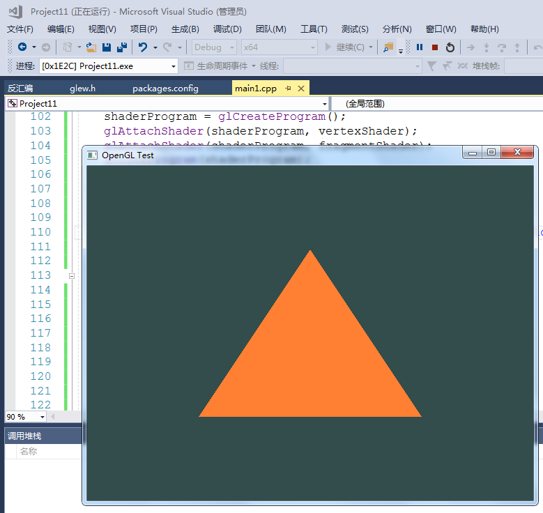

}VC2017工程本站下载: vc2017_glfw_opengl_demo2.7z

while (!glfwWindowShouldClose(window))
processInput(window);
glClearColor(0.2, 0.3, 0.3, 1);
glClear(GL_COLOR_BUFFER_BIT);
glBindVertexArray(VAO);
glUseProgram(shaderProgram);
glDrawArrays(GL_TRIANGLES, 0, 3);
glfwSwapBuffers(window);
glfwPollEvents();
Sleep(20);
}VC2017工程本站下载: vc2017_glfw_opengl_demo3.7z
