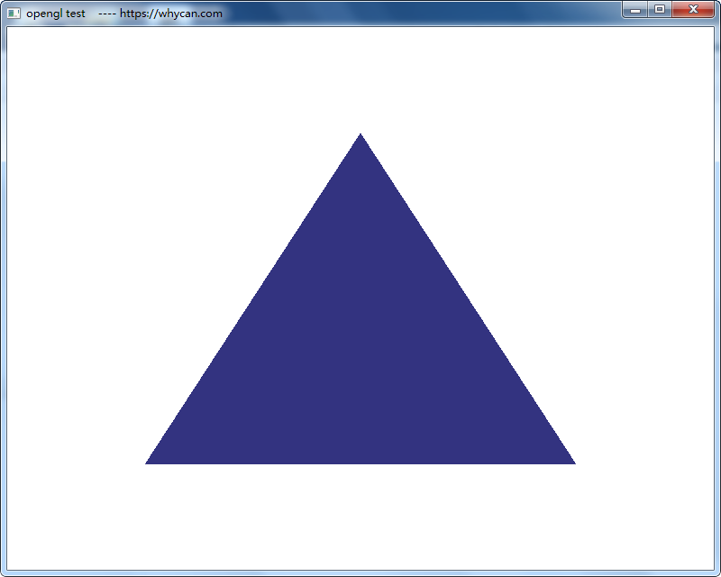

试一试 直接用 win32 api 运行 OpenGL 程序
/* An example of an OpenGL animation loop using the Win32 API. Also
   demonstrates palette management for RGB and color index modes and
   general strategies for message handling. */
#include <windows.h>			/* must include this before GL/gl.h */
#include <windowsx.h>
#include <GL/gl.h>			/* OpenGL header file */
#include <stdio.h>
#pragma comment(lib, "opengl32.lib")
HDC hDC;				/* device context */
HPALETTE hPalette = 0;			/* custom palette (if needed) */
GLboolean animate = GL_TRUE;		/* animation flag */
#define IDT_TIMER1 1000
float fZoom = 1.0f;
POINT m_lastPos = {0, 0};
float m_xMove;
float m_yMove;
bool in_drag = false;//是否处于拖动模式
void display()
	glClear(GL_COLOR_BUFFER_BIT);
	glLoadIdentity();
	glClearColor(1, 1, 1, 1);
	glScalef(fZoom, fZoom, 0);
	glTranslatef(m_xMove, m_yMove, -10.0);
	glBegin(GL_TRIANGLES);                      // Drawing Using Triangles
	glColor3f(0.2, 0.2, 0.5);
	glVertex3f(0.0f, 1.0f, 0.0f);              // Top
	glVertex3f(-1.0f, -1.0f, 0.0f);              // Bottom Left
	glVertex3f(1.0f, -1.0f, 0.0f);              // Bottom Right
	glEnd();
	glColor3f(0.2f, 0.2f, 0.5f);
	glVertex3f(-0.0f, 1.0f, 0.0f);              // Top
	glEnd();
	glFlush();
	SwapBuffers(hDC);			/* nop if singlebuffered */
LONG WINAPI WindowProc(HWND hWnd, UINT uMsg, WPARAM wParam, LPARAM lParam)
	static PAINTSTRUCT ps;
	int delta = 0;
	char strLog[64];
	switch (uMsg) {
	case WM_CREATE:
		//SetTimer(hWnd, IDT_TIMER1, 1, NULL);
		break;
	case WM_PAINT:
		BeginPaint(hWnd, &ps);
		display();
		EndPaint(hWnd, &ps);
	case WM_TIMER:
		switch (wParam)
		case IDT_TIMER1:
			PostMessage(hWnd, WM_PAINT, 0, 0);
		break;
	case WM_MOUSEWHEEL:
		if ((wParam & MK_CONTROL) == MK_CONTROL)
			delta += (short)HIWORD(wParam);     // 120 or -120
			if (delta >= 120)
				fZoom += 0.03f;
			else if (delta <= -120)
				fZoom -= 0.03f;
			if (fZoom < 0.00001f)
				fZoom = 0.01f;
		if (HIBYTE(GetKeyState(VK_MENU)) & 0x80)
			OutputDebugString("alt is press\n");
//		PostMessage(hWnd, WM_PAINT, 0, 0);
		SendMessage(hWnd, WM_PAINT, 0, 0);
		snprintf(strLog, sizeof(strLog), "%f\n", fZoom);
		OutputDebugString(strLog);
		break;
	case WM_MBUTTONUP:
		break;
	case WM_LBUTTONDOWN:
			POINT pt;
			pt.x = GET_X_LPARAM(lParam);
			pt.y = GET_Y_LPARAM(lParam);
			snprintf(strLog, sizeof(strLog), "press: %d,%d\n", pt.x, pt.y);
			m_lastPos = pt;
			in_drag = true;
		break;
	case WM_LBUTTONUP:
		POINT pt2;
		pt2.x = GET_X_LPARAM(lParam);
		pt2.y = GET_Y_LPARAM(lParam);
		snprintf(strLog, sizeof(strLog), "release: %d,%d\n", pt2.x, pt2.y);
		in_drag = false;
		break;
	case WM_MOUSEMOVE:
		if (((wParam & MK_CONTROL) == MK_CONTROL) && in_drag)
			POINT pt3;
			int dx, dy;
			float dx_scale, dy_scale;
			pt3.x = GET_X_LPARAM(lParam);
			pt3.y = GET_Y_LPARAM(lParam);
			snprintf(strLog, sizeof(strLog), "move: %d,%d\n", pt3.x, pt3.y);
			dx = pt3.x - m_lastPos.x;
			dy = pt3.y - m_lastPos.y;
			dx_scale = dx * (1 / (float)800);
			dy_scale = -dy * (1 / (float)640);
			m_xMove = m_xMove + dx_scale;
			m_yMove = m_yMove + dy_scale;
			m_lastPos = pt3;
		break;
	case WM_SIZE:
		glViewport(0, 0, LOWORD(lParam), HIWORD(lParam));
	case WM_CHAR:
		switch (wParam) {
		case 27:			/* ESC key */
			PostQuitMessage(0);
			break;
		case ' ':
			animate = !animate;
			break;
#if 0
	case WM_ACTIVATE:
		if (IsIconic(hWnd))
			animate = GL_FALSE;
		else
			animate = GL_TRUE;
	case WM_PALETTECHANGED:
		if (hWnd == (HWND)wParam)
			break;
		/* fall through to WM_QUERYNEWPALETTE */
	case WM_QUERYNEWPALETTE:
		if (hPalette) {
			UnrealizeObject(hPalette);
			SelectPalette(hDC, hPalette, FALSE);
			RealizePalette(hDC);
			return TRUE;
		return FALSE;
	case WM_CLOSE:
		PostQuitMessage(0);
	return DefWindowProc(hWnd, uMsg, wParam, lParam);
HWND CreateOpenGLWindow(char* title, int x, int y, int width, int height,
	BYTE type, DWORD flags)
	int         n, pf;
	HWND        hWnd;
	WNDCLASS    wc;
	LOGPALETTE* lpPal;
	PIXELFORMATDESCRIPTOR pfd;
	static HINSTANCE hInstance = 0;
	/* only register the window class once - use hInstance as a flag. */
	if (!hInstance) {
		hInstance = GetModuleHandle(NULL);
		wc.style = CS_OWNDC;
		wc.lpfnWndProc = (WNDPROC)WindowProc;
		wc.cbClsExtra = 0;
		wc.cbWndExtra = 0;
		wc.hInstance = hInstance;
		wc.hIcon = LoadIcon(NULL, IDI_WINLOGO);
		wc.hCursor = LoadCursor(NULL, IDC_ARROW);
		wc.hbrBackground = NULL;
		wc.lpszMenuName = NULL;
		wc.lpszClassName = "OpenGL";
		if (!RegisterClass(&wc)) {
			MessageBox(NULL, "RegisterClass() failed:  "
				"Cannot register window class.", "Error", MB_OK);
			return NULL;
	hWnd = CreateWindow("OpenGL", title, WS_OVERLAPPEDWINDOW |
		WS_CLIPSIBLINGS | WS_CLIPCHILDREN,
		x, y, width, height, NULL, NULL, hInstance, NULL);
	if (hWnd == NULL) {
		MessageBox(NULL, "CreateWindow() failed:  Cannot create a window.",
			"Error", MB_OK);
		return NULL;
	hDC = GetDC(hWnd);
	/* there is no guarantee that the contents of the stack that become
	   the pfd are zeroed, therefore _make sure_ to clear these bits. */
	memset(&pfd, 0, sizeof(pfd));
	pfd.nSize = sizeof(pfd);
	pfd.nVersion = 1;
	pfd.dwFlags = PFD_DRAW_TO_WINDOW | PFD_SUPPORT_OPENGL | flags;
	pfd.iPixelType = type;
	pfd.cColorBits = 32;
	pf = ChoosePixelFormat(hDC, &pfd);
	if (pf == 0) {
		MessageBox(NULL, "ChoosePixelFormat() failed:  "
			"Cannot find a suitable pixel format.", "Error", MB_OK);
	if (SetPixelFormat(hDC, pf, &pfd) == FALSE) {
		MessageBox(NULL, "SetPixelFormat() failed:  "
			"Cannot set format specified.", "Error", MB_OK);
	DescribePixelFormat(hDC, pf, sizeof(PIXELFORMATDESCRIPTOR), &pfd);
	if (pfd.dwFlags & PFD_NEED_PALETTE ||
		pfd.iPixelType == PFD_TYPE_COLORINDEX) {
		n = 1 << pfd.cColorBits;
		if (n > 256) n = 256;
		lpPal = (LOGPALETTE*)malloc(sizeof(LOGPALETTE) +
			sizeof(PALETTEENTRY) * n);
		memset(lpPal, 0, sizeof(LOGPALETTE) + sizeof(PALETTEENTRY) * n);
		lpPal->palVersion = 0x300;
		lpPal->palNumEntries = n;
		GetSystemPaletteEntries(hDC, 0, n, &lpPal->palPalEntry[0]);
		/* if the pixel type is RGBA, then we want to make an RGB ramp,
		   otherwise (color index) set individual colors. */
		if (pfd.iPixelType == PFD_TYPE_RGBA) {
			int redMask = (1 << pfd.cRedBits) - 1;
			int greenMask = (1 << pfd.cGreenBits) - 1;
			int blueMask = (1 << pfd.cBlueBits) - 1;
			int i;
			/* fill in the entries with an RGB color ramp. */
			for (i = 0; i < n; ++i) {
				lpPal->palPalEntry[i].peRed =
					(((i >> pfd.cRedShift)   & redMask) * 255) / redMask;
				lpPal->palPalEntry[i].peGreen =
					(((i >> pfd.cGreenShift) & greenMask) * 255) / greenMask;
				lpPal->palPalEntry[i].peBlue =
					(((i >> pfd.cBlueShift)  & blueMask) * 255) / blueMask;
				lpPal->palPalEntry[i].peFlags = 0;
		else {
			lpPal->palPalEntry[0].peRed = 0;
			lpPal->palPalEntry[0].peGreen = 0;
			lpPal->palPalEntry[0].peBlue = 0;
			lpPal->palPalEntry[0].peFlags = PC_NOCOLLAPSE;
			lpPal->palPalEntry[1].peRed = 255;
			lpPal->palPalEntry[1].peGreen = 0;
			lpPal->palPalEntry[1].peBlue = 0;
			lpPal->palPalEntry[1].peFlags = PC_NOCOLLAPSE;
			lpPal->palPalEntry[2].peRed = 0;
			lpPal->palPalEntry[2].peGreen = 255;
			lpPal->palPalEntry[2].peBlue = 0;
			lpPal->palPalEntry[2].peFlags = PC_NOCOLLAPSE;
			lpPal->palPalEntry[3].peRed = 0;
			lpPal->palPalEntry[3].peGreen = 0;
			lpPal->palPalEntry[3].peBlue = 255;
			lpPal->palPalEntry[3].peFlags = PC_NOCOLLAPSE;
		hPalette = CreatePalette(lpPal);
		if (hPalette) {
		free(lpPal);
	ReleaseDC(hWnd, hDC);
	return hWnd;
int APIENTRY WinMain(HINSTANCE hCurrentInst, HINSTANCE hPreviousInst,
	LPSTR lpszCmdLine, int nCmdShow)
	HGLRC hRC;				/* opengl context */
	HWND  hWnd;				/* window */
	MSG   msg;				/* message */
	DWORD buffer = PFD_DOUBLEBUFFER;	/* buffering type */
	BYTE  color = PFD_TYPE_RGBA;	/* color type */
	if (strstr(lpszCmdLine, "-sb")) {
		buffer = 0;
	if (strstr(lpszCmdLine, "-ci")) {
		color = PFD_TYPE_COLORINDEX;
	if (strstr(lpszCmdLine, "-h")) {
		MessageBox(NULL, "animate [-ci] [-sb]\n"
			"  -sb   single buffered\n"
			"  -ci   color index\n",
			"Usage help", MB_ICONINFORMATION);
		exit(0);
	hWnd = CreateOpenGLWindow((char*)"opengl test    ---- https://whycan.com", 0, 0, 800, 640, color, buffer);
	if (hWnd == NULL)
		exit(1);
	hDC = GetDC(hWnd);
	hRC = wglCreateContext(hDC);
	wglMakeCurrent(hDC, hRC);
	ShowWindow(hWnd, SW_SHOW);
	UpdateWindow(hWnd);
	while (GetMessage(&msg, NULL, 0, 0))
		TranslateMessage(&msg);
		DispatchMessage(&msg);
	wglMakeCurrent(NULL, NULL);
	wglDeleteContext(hRC);
	DestroyWindow(hWnd);
	if (hPalette)
		DeleteObject(hPalette);
不依赖任何第三方库, 可执行文件下载: win32_opengl_test_1.7z

Re: 试一试 直接用 win32 api 运行 OpenGL 程序
按住 CTRL 键, 可以平移和缩放。

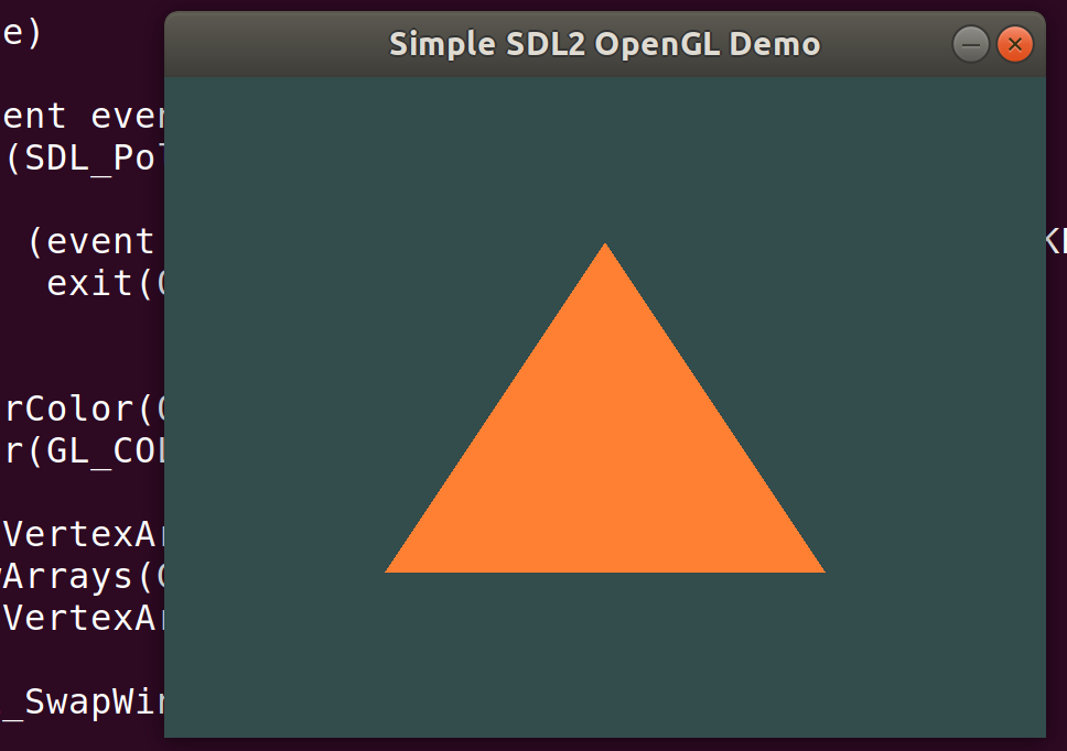

sudo apt-get install libsdl2-*-dev
#include <stdio.h>
#include <stdbool.h>
#include <SDL.h>
#include <SDL_opengles2.h> // 注意这里使用的是ES2的头文件,如果你的系统支持,可以使用<SDL_opengl.h>代替
const char *vertexShaderSource = "#version 330 core\n"
                                 "layout (location = 0) in vec3 aPos;\n"
                                 "void main()\n"
                                 "{\n"
                                 "   gl_Position = vec4(aPos.x, aPos.y, aPos.z, 1.0);\n"
                                 "}\0";
const char *fragmentShaderSource = "#version 330 core\n"
                                   "out vec4 FragColor;\n"
                                   "void main()\n"
                                   "{\n"
                                   "   FragColor = vec4(1.0f, 0.5f, 0.2f, 1.0f);\n"
                                   "}\n"
                                   "\0";
    SDL_Init(SDL_INIT_VIDEO);
    SDL_Window *window = SDL_CreateWindow("Simple SDL2 OpenGL Demo",
                                          SDL_WINDOWPOS_UNDEFINED,
                                          800, 600,
                                          SDL_WINDOW_OPENGL | SDL_WINDOW_SHOWN);
    SDL_GLContext context = SDL_GL_CreateContext(window);
    SDL_GL_MakeCurrent(window, context);
    // Request an OpenGL 3.3 context
    SDL_GL_SetAttribute(SDL_GL_CONTEXT_MAJOR_VERSION, 3);
    SDL_GL_SetAttribute(SDL_GL_CONTEXT_MINOR_VERSION, 3);
    SDL_GL_SetAttribute(SDL_GL_CONTEXT_PROFILE_MASK, SDL_GL_CONTEXT_PROFILE_CORE);
    GLuint vertexShader = glCreateShader(GL_VERTEX_SHADER);
    GLuint fragmentShader = glCreateShader(GL_FRAGMENT_SHADER);
    glShaderSource(vertexShader, 1, &vertexShaderSource, NULL);
    glShaderSource(fragmentShader, 1, &fragmentShaderSource, NULL);
    glCompileShader(vertexShader);
    glCompileShader(fragmentShader);
    GLuint shaderProgram = glCreateProgram();
    glAttachShader(shaderProgram, vertexShader);
    glAttachShader(shaderProgram, fragmentShader);
    glBindFragDataLocation(shaderProgram, 0, "FragColor");
    glLinkProgram(shaderProgram);
    glUseProgram(shaderProgram);
    float vertices[] = {
        -0.5f, -0.5f, 0.0f,
         0.5f, -0.5f, 0.0f,
         0.0f,  0.5f, 0.0f
    GLuint VBO, VAO;
    glGenVertexArrays(1, &VAO);
    glGenBuffers(1, &VBO);
    glBindVertexArray(VAO);
    glBindBuffer(GL_ARRAY_BUFFER, VBO);
    glBufferData(GL_ARRAY_BUFFER, sizeof(vertices), vertices, GL_STATIC_DRAW);
    glVertexAttribPointer(0, 3, GL_FLOAT, GL_FALSE, 3 * sizeof(float), (void*)0);
    glEnableVertexAttribArray(0);
    glBindBuffer(GL_ARRAY_BUFFER, 0);
    glBindVertexArray(0);
    while (true)
        SDL_Event event;
        while (SDL_PollEvent(&event))
            if (event.type == SDL_QUIT || (event.type == SDL_KEYDOWN && event.key.keysym.sym == SDLK_ESCAPE))
                exit(0);
        glClearColor(0.2f, 0.3f, 0.3f, 1.0f);
        glDrawArrays(GL_TRIANGLES, 0, 3);
        SDL_GL_SwapWindow(window);
    glDeleteVertexArrays(1, &VAO);
    glDeleteBuffers(1, &VBO);
    glDeleteProgram(shaderProgram);
    glDeleteShader(vertexShader);
    glDeleteShader(fragmentShader);
    SDL_GL_DeleteContext(context);
    SDL_DestroyWindow(window);
    SDL_Quit();
编译指令:
gcc -o test test.c `sdl2-config --cflags --libs` `pkg-config --cflags --libs sdl2_image` -lGL

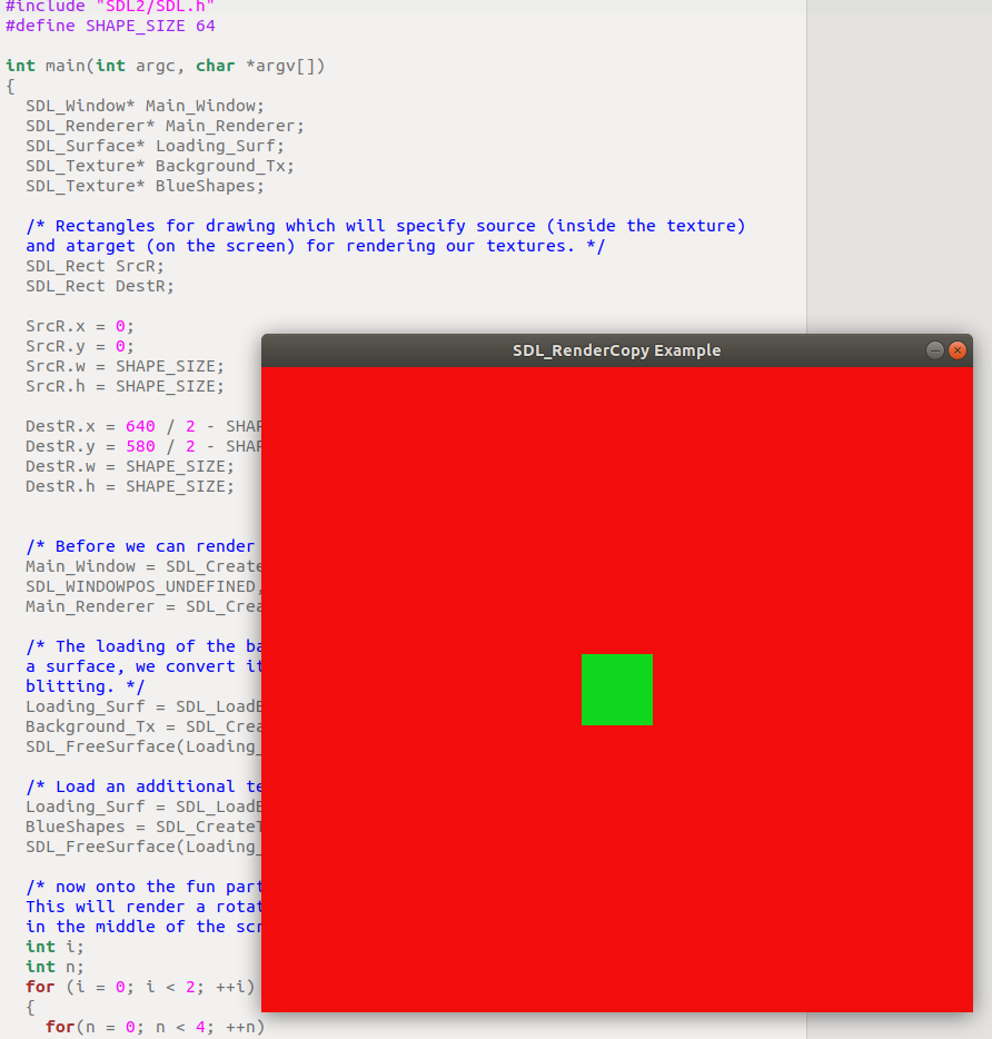

https://github.com/it-elektronika/SDL_RANDOM/blob/master/SDL_RenderCopy.c
#include "SDL2/SDL.h"
#define SHAPE_SIZE 64
  SDL_Window* Main_Window;
  SDL_Renderer* Main_Renderer;
  SDL_Surface* Loading_Surf;
  SDL_Texture* Background_Tx;
  SDL_Texture* BlueShapes;
  /* Rectangles for drawing which will specify source (inside the texture)
  and atarget (on the screen) for rendering our textures. */
  SDL_Rect SrcR;
  SDL_Rect DestR;
  SrcR.x = 0;
  SrcR.y = 0;
  SrcR.w = SHAPE_SIZE;
  SrcR.h = SHAPE_SIZE;
  DestR.x = 640 / 2 - SHAPE_SIZE / 2;
  DestR.y = 580 / 2 - SHAPE_SIZE / 2;
  DestR.w = SHAPE_SIZE;
  DestR.h = SHAPE_SIZE;
  /* Before we can render anything, we need a window and a renderer */
  Main_Window = SDL_CreateWindow("SDL_RenderCopy Example",
  SDL_WINDOWPOS_UNDEFINED, SDL_WINDOWPOS_UNDEFINED, 640, 580, 0);
  Main_Renderer = SDL_CreateRenderer(Main_Window, -1, SDL_RENDERER_SOFTWARE);
  /* The loading of the background texture. Since SDL_LoadBMP() returns
  a surface, we convert it to a texture afterwards for fast accelerated
  blitting. */
  Loading_Surf = SDL_LoadBMP("red.bmp");
  Background_Tx = SDL_CreateTextureFromSurface(Main_Renderer, Loading_Surf);
  SDL_FreeSurface(Loading_Surf); /* we got the texture now -> free surface */
  /* Load an additional texture */
  Loading_Surf = SDL_LoadBMP("green.bmp");
  BlueShapes = SDL_CreateTextureFromSurface(Main_Renderer, Loading_Surf);
  /* now onto the fun part.
  This will render a rotating selection of the blue shapes
  in the middle of the screen */
  int i;
  int n;
  for (i = 0; i < 2; ++i)
    for(n = 0; n < 4; ++n)
      SrcR.x = SHAPE_SIZE * (n % 2);
      if (n > 1)
        SrcR.y = SHAPE_SIZE;
      } else
        SrcR.y = 0;
      /* render background, whereas NULL for source and destination
      rectangles just means "use the default" */
      SDL_RenderCopy(Main_Renderer, Background_Tx, NULL, NULL);
      /* render the current animation step of our shape */
      SDL_RenderCopy(Main_Renderer, BlueShapes, &SrcR, &DestR);
      SDL_RenderPresent(Main_Renderer);
      SDL_Delay(500);
  /* The renderer works pretty much like a big canvas:
  when you RenderCopy() you are adding paint, each time adding it
  on top.
  You can change how it blends with the stuff that
  the new data goes over.
  When your 'picture' is complete, you show it
  by using SDL_RenderPresent(). */
  /* SDL 1.2 hint: If you're stuck on the whole renderer idea coming
  from 1.2 surfaces and blitting, think of the renderer as your
  main surface, and SDL_RenderCopy() as the blit function to that main
  surface, with SDL_RenderPresent() as the old SDL_Flip() function.*/
  SDL_DestroyTexture(BlueShapes);
  SDL_DestroyTexture(Background_Tx);
  SDL_DestroyRenderer(Main_Renderer);
  SDL_DestroyWindow(Main_Window);
编译指令:
gcc -o test2 test2.c `sdl2-config --cflags --libs` `pkg-config --cflags --libs sdl2_image` -lGL
