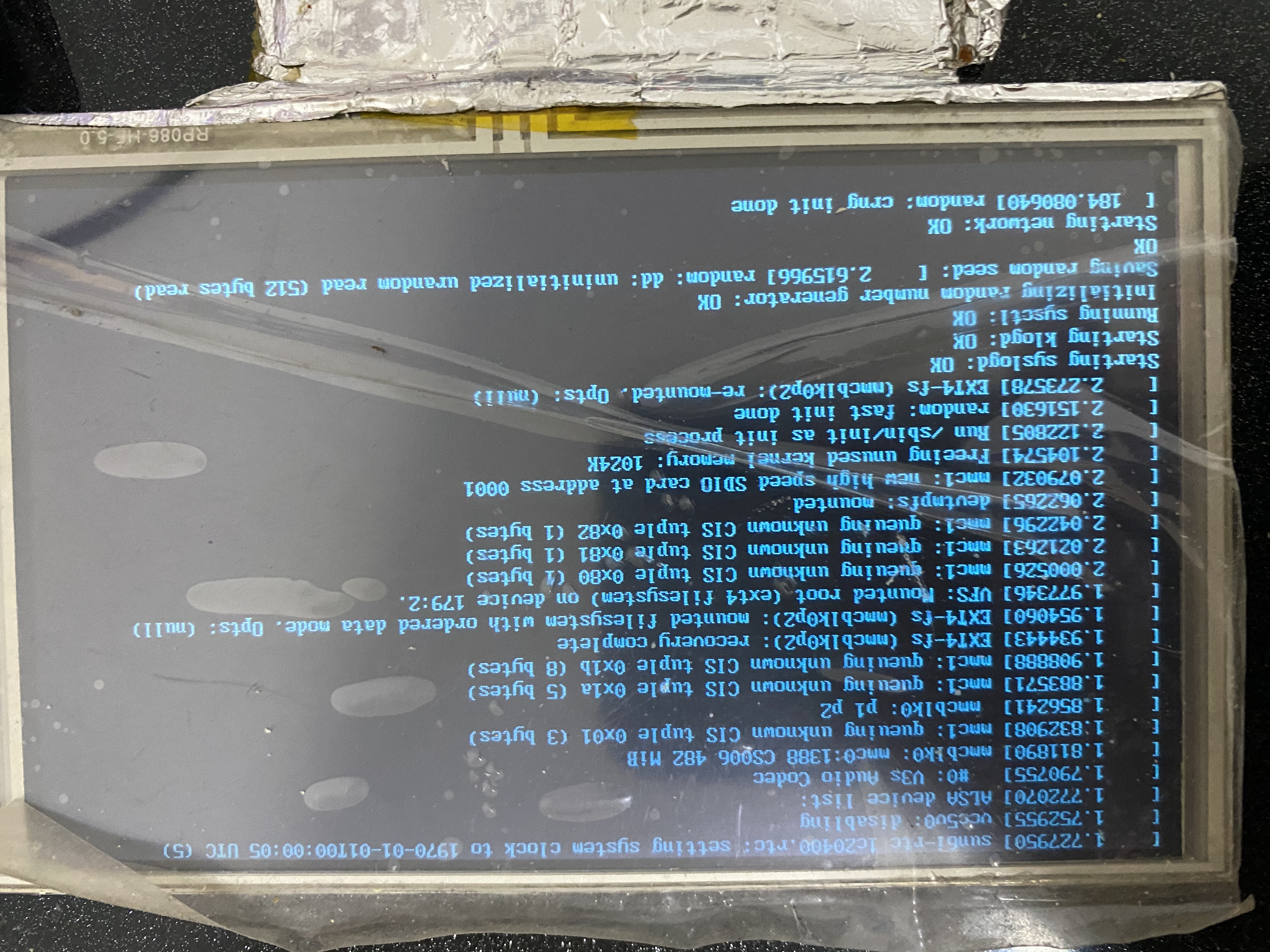

我做的V3S板子,可以正常启动linux系统,可以正常进入系统,只不过屏幕显示内核log,然后串口也有打印,通过串口输入指令cat /dev/random > /dev/fb0不能让屏幕花屏,估计是屏幕用于提示登录被占用了吧,如何禁用显示器shell呢

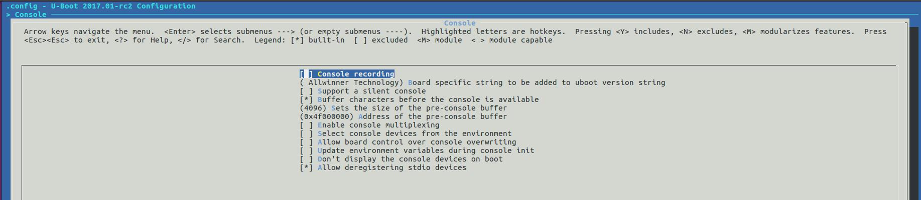

需要添加什么参数呢,目前我只添加了这个(图中我选中的部分,其他的没有,因为接我的不一样),然后重新烧录,屏幕确实不提示登录了,但还是不能到内核禁用屏幕log

改了这里LCD应该就没有kernel log吧?

有,难道是内核也要配置?

[    1.296736] using random host ethernet address
[    1.305856] usb0: HOST MAC ee:b3:c7:d5:76:2c
[    1.313712] usb0: MAC 96:76:0c:f8:cd:30
[    1.321125] g_cdc gadget: CDC Composite Gadget, version: King Kamehameha Day 2008
[    1.332139] g_cdc gadget: g_cdc ready
[    1.341739] sun4i-codec 1c22c00.codec: Codec <-> 1c22c00.codec mapping ok
[    1.354374] sun6i-rtc 1c20400.rtc: setting system clock to 1970-01-01 00:00:05 UTC (5)
[    1.366175] vcc5v0: disabling
[    1.372612] ALSA device list:
[    1.378943]   #0: V3s Audio Codec
[    1.387277] mmc1: queuing unknown CIS tuple 0x01 (3 bytes)
[    1.396432] EXT4-fs (mmcblk0p2): couldn't mount as ext3 due to feature incompatibilities
[    1.410073] EXT4-fs (mmcblk0p2): couldn't mount as ext2 due to feature incompatibilities
[    1.427478] mmc1: queuing unknown CIS tuple 0x1a (5 bytes)
[    1.440851] mmc1: queuing unknown CIS tuple 0x1b (8 bytes)
[    1.452930] mmc1: queuing unknown CIS tuple 0x80 (1 bytes)
[    1.461834] mmc1: queuing unknown CIS tuple 0x81 (1 bytes)
[    1.470416] mmc1: queuing unknown CIS tuple 0x82 (1 bytes)
[    1.478935] mmc1: new high speed SDIO card at address 0001
[    1.488164] random: fast init done
[    1.494333] musb-hdrc musb-hdrc.1.auto: VBUS_ERROR in b_idle (80, <SessEnd), retry #0, port1 00000100
[    1.516606] EXT4-fs (mmcblk0p2): recovery complete
[    1.526398] EXT4-fs (mmcblk0p2): mounted filesystem with ordered data mode. Opts: (null)
[    1.537628] VFS: Mounted root (ext4 filesystem) on device 179:2.
[    1.550532] devtmpfs: mounted
[    1.557969] Freeing unused kernel memory: 1024K
[    1.678031] EXT4-fs (mmcblk0p2): re-mounted. Opts: data=ordered
Welcome to Buildroot
ljn login:

日志发现一句Setting up a 800x480 lcd console (overscan 0x0)感觉是罪魁祸首,但是不知道如何消除掉
还得请问各位大佬
另外还发现一个问题,读取的是带dock的那个设备树,为啥ifconfig查不到eth0呢
奉上dtb文件,没有改动过,荔枝派内核5.2分支的原版
ljn login: root
Password:
# ifconfig
          collisions:0 txqueuelen:1000
# ifconfig -a

楼主 #30 2021-02-04 00:31:26
mysteryli
注册时间: 2020-03-05
已发帖子: 511
积分: 416
Re: V3S禁用屏幕log,用于显示qt
再贴一下屏幕的log,之前忘记拍照了
