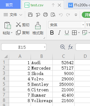

通过回调函数,把数据表所有数据输出到 csv(逗号分隔符) 文件
select_all_export_to_csv.c
#include <sqlite3.h>
#include <stdio.h>
FILE* fp_csv;
int callback(void *, int, char **, char **);
int main(void) {
    sqlite3 *db;
    char *err_msg = 0;
    fp_csv = fopen("test.csv", "w");
    if(!fp_csv)
        fprintf(stderr, "Cannot open test.csv\n");
        return 2;
    int rc = sqlite3_open("test.db", &db);
    if (rc != SQLITE_OK) {
        fprintf(stderr, "Cannot open database: %s\n",
                sqlite3_errmsg(db));
        sqlite3_close(db);
        return 1;
    char *sql = "SELECT * FROM Cars";
    rc = sqlite3_exec(db, sql, callback, 0, &err_msg);
    if (rc != SQLITE_OK ) {
        fprintf(stderr, "Failed to select data\n");
        fprintf(stderr, "SQL error: %s\n", err_msg);
        sqlite3_free(err_msg);
        sqlite3_close(db);
        return 1;
    sqlite3_close(db);
    fclose(fp_csv);
int callback(void *NotUsed, int argc, char **argv,
                    char **azColName) {
    NotUsed = 0;
    for (int i = 0; i < argc; i++) {
        printf("%s = %s\n", azColName[i], argv[i] ? argv[i] : "NULL");
        fprintf(fp_csv, "%s,", argv[i] ? argv[i] : "NULL");
    printf("\n");
    fprintf(fp_csv, "\n");
gcc -o select_all_export_to_csv select_all_export_to_csv.c -lsqlite3
$ ./select_all_export_to_csv
Id = 1
Name = Audi
Price = 52642
Id = 2
Name = Mercedes
Price = 57127
Id = 3
Name = Skoda
Price = 9000
Id = 4
Name = Volvo
Price = 29000
Id = 5
Name = Bentley
Price = 350000
Id = 6
Name = Citroen
Price = 21000
Id = 7
Name = Hummer
Price = 41400
Id = 8
Name = Volkswagen
Price = 21600
一切OK!
