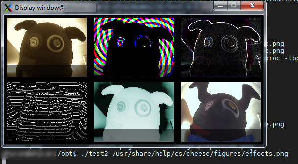

编译命令行:
g++ -o test test.cpp -lopencv_core -lopencv_imgproc -lopencv_ximgproc -lopencv_highgui -lopencv_stitching -lopencv_imgcodecs
运行:
./test2 /usr/share/help/cs/cheese/figures/cheese.png

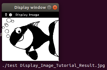

楼主 #4 2021-09-20 10:46:12
raspberryman
注册时间: 2019-12-27
已发帖子: 503
积分: 465
Re: 试一试 搭建 OpenCV 入门环境
#include <opencv2/core/core.hpp>
#include <opencv2/highgui/highgui.hpp>
#include <opencv2/imgproc.hpp>
#include <iostream>
using namespace cv;
using namespace std;
int main( int argc, char** argv )
    if( argc != 2)
     cout <<" Usage: display_image ImageToLoadAndDisplay" << endl;
     return -1;
    Mat image, image2;
    //image = imread(argv[1], CV_LOAD_IMAGE_COLOR);   // Read the file
    image = imread(argv[1], IMREAD_GRAYSCALE);   // Read the file
    threshold(image, image2, 128, 255, THRESH_BINARY | THRESH_OTSU);
    if(! image2.data )                              // Check for invalid input
        cout <<  "Could not open or find the image" << std::endl ;
        return -1;
    namedWindow( "Display window", WINDOW_AUTOSIZE);// Create a window for display.
    imshow( "Display window", image2);                   // Show our image inside it.
    waitKey(0);                                          // Wait for a keystroke in the window
