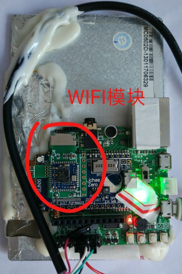

各路大神,荔枝派v3s(有底板的那种)开发板怎挂载wifi【RTL8723BS】,求写入门教程!
各路大神,荔枝派v3s(有底板的那种)开发板怎挂载wifi,求写入门教程!
#2 2017-12-25 11:35:19
已发帖子: 9,520
Re: 各路大神,荔枝派v3s(有底板的那种)开发板怎挂载wifi【RTL8723BS】,求写入门教程!
是用荔枝派的RTL8723BS 模组吗?有空我用主线内核试一试。
楼主 #3 2017-12-25 11:53:22
zhuacai
注册时间: 2017-12-16
已发帖子: 234
积分: 233.5
对,我是用: git clone https://github.com/Lichee-Pi/linux.git -b zero-4.13.y分支的内核

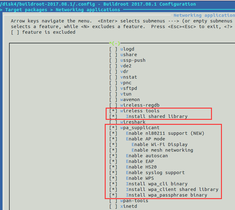

buildroot
-> make menuconfig
-> Target packages -> Networking applications
选中
wireless tools
wpa_supplicant
/files/members/3/QQ20171227164732.png
晕哥,配置上wpa_supplicant就出错

zhuacai wrote:
buildroot
-> make menuconfig
选中
wireless tools
wpa_supplicant
sae.c:(.text+0x1b58): undefined reference to `crypto_bignum_to_bin'
sae.c:(.text+0x1bdc): undefined reference to `crypto_ec_point_deinit'
sae.c:(.text+0x1bec): undefined reference to `crypto_ec_point_from_bin'
sae.c:(.text+0x1c08): undefined reference to `crypto_ec_point_is_on_curve'
sae.c:(.text+0x1c2c): undefined reference to `crypto_bignum_cmp'
make[1]: *** [wpa_supplicant] Error 1
make[1]: Leaving directory `/home/vv3/Downloads/buildroot-2017.08.1/output/build/wpa_supplicant-2.6/wpa_supplicant'
openssl, libnl 也要编译进来。
