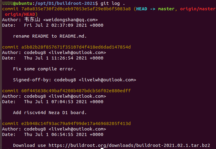

使用git命令clone源码
book@virtual-machine:~$ mkdir -p ~/Neza-D1/ && cd ~/Neza-D1/
book@virtual-machine:~/Neza-D1$ git clone https://gitee.com/weidongshan/neza-d1-buildroot.git buildroot-2021

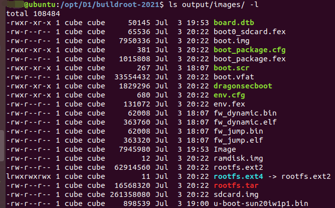

编译完整系统镜像
book@virtual-machine:~/Neza-D1/buildroot-2021$ make neza-d1_defconfig //加载配置文件
book@virtual-machine:~/Neza-D1/buildroot-2021$ make all //完整编译系统
编译生成的系统镜像在output/image目录下,其中sdcard.img为完整的系统镜像。

楼主 #1 2021-07-03 20:44:46
已发帖子: 3,410
积分: 1907
Re: [转载 aw-ol.com] 【极简操作】使用builroot 2021一键编译生成D1 nezha 系统镜像!
编译成功!

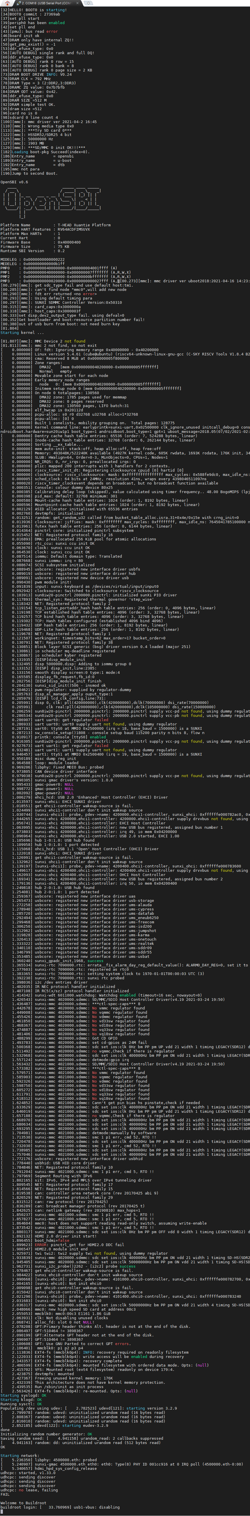

目前发现两个问题,
① HDMI没有输出
② 第二次启动文件系统挂掉。
这是第二次启动的记录:

[    1.257436] hub 2-0:1.0: USB hub found
[    1.261705] hub 2-0:1.0: 1 port detected
[    1.267047] usbcore: registered new interface driver uas
[    1.273146] usbcore: registered new interface driver usb-storage
[    1.279934] usbcore: registered new interface driver ums-alauda
[    1.286617] usbcore: registered new interface driver ums-cypress
[    1.293399] usbcore: registered new interface driver ums-datafab
[    1.300177] usbcore: registered new interface driver ums_eneub6250
[    1.307150] usbcore: registered new interface driver ums-freecom
[    1.313930] usbcore: registered new interface driver ums-isd200
[    1.320620] usbcore: registered new interface driver ums-jumpshot
[    1.327502] usbcore: registered new interface driver ums-karma
[    1.334097] usbcore: registered new interface driver ums-onetouch
[    1.340989] usbcore: registered new interface driver ums-realtek
[    1.347772] usbcore: registered new interface driver ums-sddr09
[    1.354460] usbcore: registered new interface driver ums-sddr55
[    1.361149] usbcore: registered new interface driver ums-usbat
[    1.368172] sunxi_gpadc_init,1968, success
[    1.373441] sunxi-rtc 7090000.rtc: errata__fix_alarm_day_reg_default_value(): ALARM0_DAY_REG=0, set it to 1
[    1.385515] sunxi-rtc 7090000.rtc: registered as rtc0
[    1.391279] sunxi-rtc 7090000.rtc: setting system clock to 1970-01-01T01:06:40 UTC (4000)
[    1.400435] sunxi-rtc 7090000.rtc: sunxi rtc probed
[    1.406243] i2c /dev entries driver
[    1.410273] IR NEC protocol handler initialized
[    1.415347] IR RC5(x/sz) protocol handler initialized
[    1.421696] usbcore: registered new interface driver uvcvideo
[    1.428133] USB Video Class driver (1.1.1)
[    1.432710] sunxi cedar version 1.1
[    1.436848] sunxi-cedar 1c0e000.ve: Adding to iommu group 0
[    1.443118] VE: install start!!!
[    1.443118]
[    1.448634] VE: cedar-ve the get irq is 1
[    1.448634]
[    1.454937] VE: ve_debug_proc_info:(____ptrval____), data:(____ptrval____), lock:(____ptrval____)
[    1.454937]
[    1.466513] VE: install end!!!
[    1.466513]
[    1.472837] sunxi-wdt 6011000.watchdog: Watchdog enabled (timeout=16 sec, nowayout=0)
[    1.485034] sunxi-mmc 4020000.sdmmc: SD/MMC/SDIO Host Controller Driver(v4.19 2021-03-24 19:50)
[    1.494979] sunxi-mmc 4020000.sdmmc: ***ctl-spec-caps*** 8
[    1.501172] sunxi-mmc 4020000.sdmmc: No vmmc regulator found
[    1.507502] sunxi-mmc 4020000.sdmmc: No vqmmc regulator found
[    1.513928] sunxi-mmc 4020000.sdmmc: No vdmmc regulator found
[    1.520350] sunxi-mmc 4020000.sdmmc: No vd33sw regulator found
[    1.526873] sunxi-mmc 4020000.sdmmc: No vd18sw regulator found
[    1.533395] sunxi-mmc 4020000.sdmmc: No vq33sw regulator found
[    1.539914] sunxi-mmc 4020000.sdmmc: No vq18sw regulator found
[    1.546789] sunxi-mmc 4020000.sdmmc: Got CD GPIO
[    1.552271] sunxi-mmc 4020000.sdmmc: set cd-gpios as 24M fail
[    1.558876] sunxi-mmc 4020000.sdmmc: sdc set ios:clk 0Hz bm PP pm UP vdd 21 width 1 timing LEGACY(SDR12) dt B
[    1.569999] sunxi-mmc 4020000.sdmmc: no vqmmc,Check if there is regulator
[    1.588586] sunxi-mmc 4020000.sdmmc: sdc set ios:clk 400000Hz bm PP pm ON vdd 21 width 1 timing LEGACY(SDR12) dt B
[    1.612757] sunxi-mmc 4020000.sdmmc: detmode:gpio irq
[    1.619071] sunxi-mmc 4021000.sdmmc: SD/MMC/SDIO Host Controller Driver(v4.19 2021-03-24 19:50)
[    1.629021] sunxi-mmc 4021000.sdmmc: ***ctl-spec-caps*** 8
[    1.635212] sunxi-mmc 4021000.sdmmc: No vmmc regulator found
[    1.641548] sunxi-mmc 4021000.sdmmc: No vqmmc regulator found
[    1.647971] sunxi-mmc 4021000.sdmmc: No vdmmc regulator found
[    1.654395] sunxi-mmc 4021000.sdmmc: No vd33sw regulator found
[    1.660917] sunxi-mmc 4021000.sdmmc: No vd18sw regulator found
[    1.667436] sunxi-mmc 4021000.sdmmc: No vq33sw regulator found
[    1.673957] sunxi-mmc 4021000.sdmmc: No vq18sw regulator found
[    1.680500] sunxi-mmc 4021000.sdmmc: Cann't get pin bias hs pinstate,check if needed
[    1.689277] sunxi-mmc 4020000.sdmmc: sdc set ios:clk 400000Hz bm PP pm ON vdd 21 width 1 timing LEGACY(SDR12) dt B
[    1.701742] sunxi-mmc 4021000.sdmmc: sdc set ios:clk 0Hz bm PP pm UP vdd 21 width 1 timing LEGACY(SDR12) dt B
[    1.712916] sunxi-mmc 4021000.sdmmc: no vqmmc,Check if there is regulator
[    1.724589] sunxi-mmc 4020000.sdmmc: sdc set ios:clk 400000Hz bm PP pm ON vdd 21 width 1 timing LEGACY(SDR12) dt B
[    1.736254] sunxi-mmc 4021000.sdmmc: sdc set ios:clk 400000Hz bm PP pm ON vdd 21 width 1 timing LEGACY(SDR12) dt B
[    1.748928] sunxi-mmc 4020000.sdmmc: sdc set ios:clk 400000Hz bm PP pm ON vdd 21 width 1 timing LEGACY(SDR12) dt B
[    1.760605] sunxi-mmc 4021000.sdmmc: detmode:manually by software
[    1.769129] sunxi-mmc 4021000.sdmmc: smc 1 p1 err, cmd 52, RTO !!
[    1.776021] sunxi-mmc 4020000.sdmmc: sdc set ios:clk 400000Hz bm PP pm ON vdd 21 width 1 timing LEGACY(SDR12) dt B
[    1.787575] sunxi-mmc 4021000.sdmmc: smc 1 p1 err, cmd 52, RTO !!
[    1.794539] sunxi-mmc 4021000.sdmmc: sdc set ios:clk 400000Hz bm PP pm ON vdd 21 width 1 timing LEGACY(SDR12) dt B
[    1.812632] sunxi-mmc 4021000.sdmmc: sdc set ios:clk 400000Hz bm PP pm ON vdd 21 width 1 timing LEGACY(SDR12) dt B
[    1.827834] usbcore: registered new interface driver usbhid
[    1.834100] usbhid: USB HID core driver
[    1.840521] NET: Registered protocol family 10
[    1.846871] sunxi-mmc 4021000.sdmmc: smc 1 p1 err, cmd 5, RTO !!
[    1.853630] Segment Routing with IPv6
[    1.857819] sit: IPv6, IPv4 and MPLS over IPv4 tunneling driver
[    1.865186] NET: Registered protocol family 17
[    1.870204] NET: Registered protocol family 15
[    1.875174] can: controller area network core (rev 20170425 abi 9)
[    1.882168] NET: Registered protocol family 29
[    1.887152] can: raw protocol (rev 20170425)
[    1.891930] can: broadcast manager protocol (rev 20170425 t)
[    1.898267] can: netlink gateway (rev 20190810) max_hops=1
[    1.905855] sunxi-mmc 4021000.sdmmc: smc 1 p1 err, cmd 5, RTO !!
[    1.913443] sunxi-mmc 4021000.sdmmc: smc 1 p1 err, cmd 5, RTO !!
[    1.920225] mmc0: host does not support reading read-only switch, assuming write-enable
[    1.929166] sunxi-mmc 4021000.sdmmc: smc 1 p1 err, cmd 5, RTO !!
[    1.935947] sunxi-mmc 4021000.sdmmc: sdc set ios:clk 0Hz bm PP pm OFF vdd 0 width 1 timing LEGACY(SDR12) dt B
[    1.947767] HDMI 2.0 driver init start!
[    1.952090] boot_hdmi=false
[    1.955258] ERROR: pinctrl_get for HDMI2.0 DDC fail
[    1.962192] HDMI2.0 module init end
[    1.981260] twi twi2: twi2 supply twi not found, using dummy regulator
[    1.989092] sunxi-mmc 4020000.sdmmc: sdc set ios:clk 400000Hz bm PP pm ON vdd 21 width 1 timing SD-HS(SDR25) dt B
[    2.000660] sunxi-mmc 4020000.sdmmc: sdc set ios:clk 50000000Hz bm PP pm ON vdd 21 width 1 timing SD-HS(SDR25) dt B
[    2.017970] sunxi_i2c_probe()2262 - [i2c2] probe success
[    2.033682] get ehci0-controller wakeup-source is fail.
[    2.039634] sunxi ehci0-controller don't init wakeup source
[    2.045882] [sunxi-ehci0]: probe, pdev->name: 4101000.ehci0-controller, sunxi_ehci: 0xffffffe0007cc700, 0x:ffffffd005222000, irq_no:2e
[    2.059372] [sunxi-ehci0]: Not init ehci0
[    2.064300] get ohci0-controller wakeup-source is fail.
[    2.070270] sunxi ohci0-controller don't init wakeup source
[    2.076516] [sunxi-ohci0]: probe, pdev->name: 4101400.ohci0-controller, sunxi_ohci: 0xffffffe0007cd240
[    2.086915] [sunxi-ohci0]: Not init ohci0
[    2.091550] sunxi-mmc 4020000.sdmmc: sdc set ios:clk 50000000Hz bm PP pm ON vdd 21 width 4 timing SD-HS(SDR25) dt B
[    2.103302] mmc0: new high speed SD card at address 00c3
[    2.110290] mmcblk0: mmc0:00c3 E1161 1.86 GiB
[    2.119021] input: gpio_keys as /devices/platform/gpio_keys/input/input1
[    2.128075] clk: Not disabling unused clocks
[    2.132891] alloc_fd: slot 0 not NULL!
[    2.141296] GPT:Primary header thinks Alt. header is not at the end of the disk.
[    2.149601] GPT:182784 != 3898367
[    2.153306] GPT:Alternate GPT header not at the end of the disk.
[    2.160029] GPT:182784 != 3898367
[    2.163732] GPT: Use GNU Parted to correct GPT errors.
[    2.169538]  mmcblk0: p1 p2 p3 p4
[    2.176874] EXT4-fs (mmcblk0p4): INFO: recovery required on readonly filesystem
[    2.185074] EXT4-fs (mmcblk0p4): write access will be enabled during recovery
[    2.195749] JBD2: no valid journal superblock found
[    2.201232] EXT4-fs (mmcblk0p4): error loading journal
[    2.208069] List of all partitions:
[    2.212005] b300         1949184 mmcblk0
[    2.212010]  driver: mmcblk
[    2.219628]   b301             128 mmcblk0p1 43d16a52-2727-486a-afc0-3a274ff79b58
[    2.219631]
[    2.229677]   b302             128 mmcblk0p2 a41ba826-943c-485c-8e38-7c09559841e8
[    2.229681]
[    2.239713]   b303           32768 mmcblk0p3 1a2c878e-fb78-4717-81e5-5de5374ca63b
[    2.239716]
[    2.249759]   b304           40960 mmcblk0p4 ee39a451-6aa0-42e1-9f22-f7bfc5dc0a53
[    2.249762]
[    2.259792] No filesystem could mount root, tried:
[    2.259796]  ext3
[    2.265259]  ext2
[    2.267399]  ext4
[    2.269557]  vfat
[    2.271695]  msdos
[    2.273848]
[    2.277770] Kernel panic - not syncing: VFS: Unable to mount root fs on unknown-block(179,4)
[    2.287181] CPU: 0 PID: 1 Comm: swapper Not tainted 5.4.61 #15
[    2.293677] Call Trace:
[    2.296410] [<ffffffe00002e392>] walk_stackframe+0x0/0xa0
[    2.302426] [<ffffffe00002e4f2>] show_stack+0x2a/0x34
[    2.308060] [<ffffffe00050f764>] dump_stack+0x20/0x28
[    2.313692] [<ffffffe000032eae>] panic+0xe4/0x272
[    2.318935] [<ffffffe000000f5c>] mount_block_root+0x26e/0x28a
[    2.325336] [<ffffffe000000ffe>] mount_root+0x86/0x90
[    2.330964] [<ffffffe000001118>] prepare_namespace+0x110/0x152
[    2.337463] [<ffffffe000000b7a>] kernel_init_freeable+0x17e/0x19a
[    2.344261] [<ffffffe000522600>] kernel_init+0x12/0xe6
[    2.349995] [<ffffffe00002d00c>] ret_from_exception+0x0/0xc
[    2.356208] ---[ end Kernel panic - not syncing: VFS: Unable to mount root fs on unknown-block(179,4) ]---
