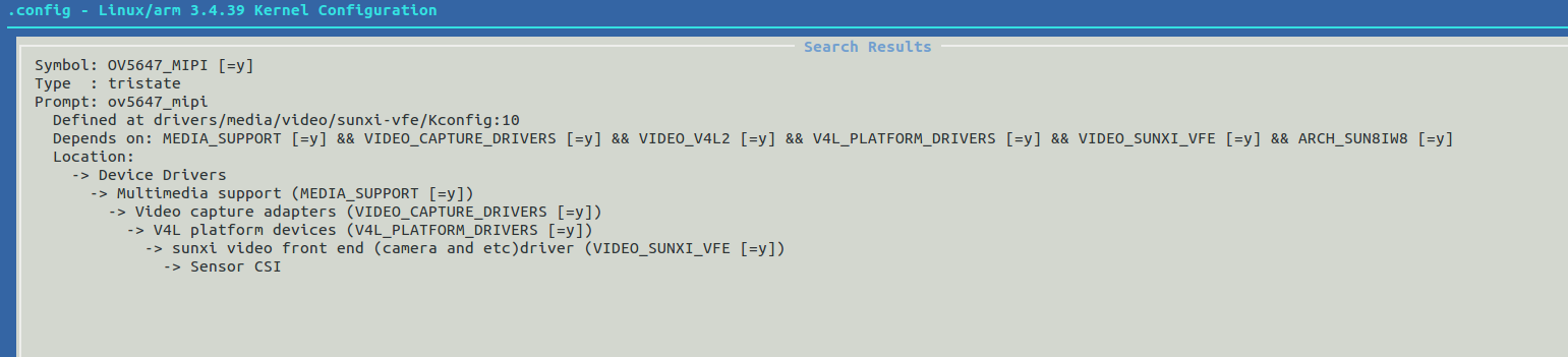

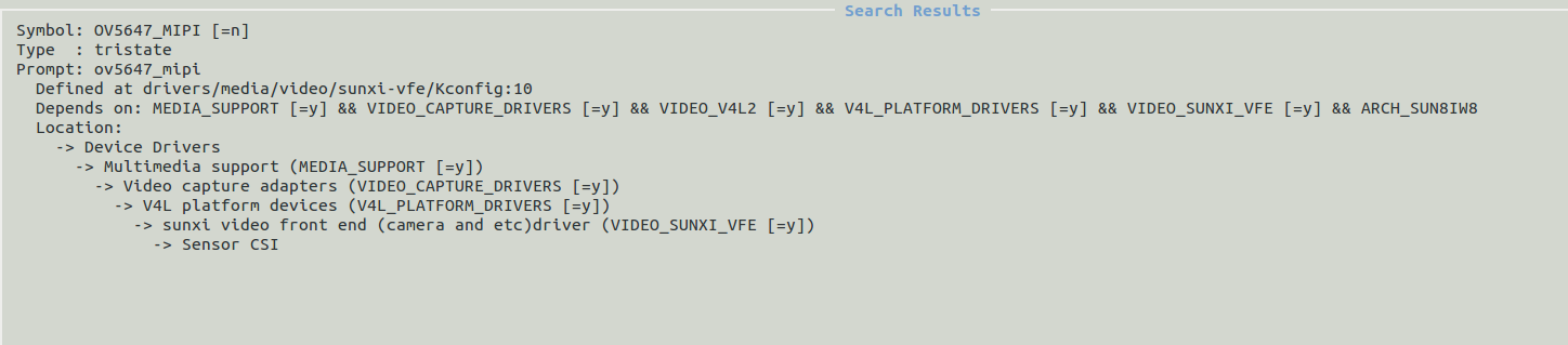

Re: licheepi zero BSP 内核(linux3.4) 编译教程
楼主,请问下在linux3.4目录下,make menuconfig里面ov5647_mipi前面为什么只能是M,不能是*??我现在想直接把它编译进去,而不是手动insmod,这个是在哪里设置的呢??
注:配置文件是使用你的lichee_BSP_config
#26 2018-04-12 13:32:58
已发帖子: 9,436
应该是可以直接编译进去的,你先试一试,看会有什么错误。
在线
#27 2018-04-12 14:46:45
quinncy
已发帖子: 24
积分: 24
@晕哥,问题解决了,是因为上层的sunxi video front end (camera and etc)driver这一项前面被设置成了M,所以下面的都必须是M。修改方法是直接将这一项前面的M换成*就可以设置ov5647_mipi编译进内核了。(手动insmod的话需要额外拷贝很多关于v4l2的.ko文件,建议还是直接编译进内核)
@qianhao 请问楼主大神,不知道你有没有用BSP内核配置MIPI摄像头?是否成功?我配置完了之后 出现
Check open /system/etc/hawkview/ov5648/isp_test_param.ini failed!
[    1.134553] [VFE]vfe_init end
[    1.139000] platform reg-15-cs-ldo0: Driver reg-15-cs-ldo0 requests probe def                                                                                                           erral
[    1.147745] [VFE]probe_work_handle start!
[    1.152339] [VFE]..........................vfe clk open!.....................                                                                                                           ..
[    1.160854] platform reg-15-cs-aldo1: Driver reg-15-cs-aldo1 requests probe d                                                                                                           eferral
[    1.169790] platform reg-15-cs-aldo2: Driver reg-15-cs-aldo2 requests probe d                                                                                                           eferral
[    1.178853] [VFE]v4l2 subdev register input_num = 0
[    1.184522] [VFE]vfe sensor detect start! input_num = 0
[    1.190457] [VFE]Find sensor name is "ov5648", i2c address is 6c, type is "RA                                                                                                           W" !
[    1.199006] [VFE]Sub device register "ov5648" i2c_addr = 0x6c start!
[    1.206192] [VFE]v4l2_device_register_subdev return 0
[    1.212044] [VFE]registered sensor subdev is OK!
[    1.217287] [VFE]Check sensor!
[    1.220800] [VFE]Sub device register "ov5648" is OK!
[    1.226701] platform reg-15-cs-dldo1: Driver reg-15-cs-dldo1 requests probe d                                                                                                           eferral
[    1.235708] platform reg-15-cs-dldo2: Driver reg-15-cs-dldo2 requests probe d                                                                                                           eferral
[    1.244626] platform reg-15-cs-buck1: Driver reg-15-cs-buck1 requests probe d                                                                                                           eferral
[    1.253605] platform reg-15-cs-buck2: Driver reg-15-cs-buck2 requests probe d                                                                                                           eferral
[    1.262584] platform reg-15-cs-buck3: Driver reg-15-cs-buck3 requests probe d                                                                                                           eferral
[    1.271360] [VFE]Check open /system/etc/hawkview/ov5648/isp_test_param.ini fa                                                                                                           iled!
[    1.271369] Match isp cfg  start!
[    1.283831] [VFE]read ini start
[    1.287641] [VFE]Fetch ini file form "/system/etc/hawkview/ov5648/isp_test_pa                                                                                                           ram.ini"
[    1.296718] platform reg-15-cs-buck4: Driver reg-15-cs-buck4 requests probe d                                                                                                           eferral
[    1.305736] platform reg-15-cs-ldoio0: Driver reg-15-cs-ldoio0 requests probe                                                                                                            deferral
[    1.314813] sunxi_wdt_init_module: sunxi WatchDog Timer Driver v1.0
[    1.324709] [VFE_WARN]read ini info fail
[    1.329864] sunxi_wdt_probe: devm_ioremap return wdt_reg 0xf1c20ca0, res->sta                                                                                                           rt 0x01c20ca0, res->end 0x01c20cbf
[    1.341192] [VFE]V4L2 device registered as video0
[    1.347048] [VFE]..........................vfe clk close!....................                                                                                                           ...
[    1.355709] sunxi_wdt_probe: initialized (g_timeout=16s, g_nowayout=0)
[    1.363126] wdt_enable, write reg 0xf1c20cb8 val 0x00000000
[    1.369547] wdt_set_tmout, write 0x000000b0 to mode reg 0xf1c20cb8, actual ti                                                                                                           meout 16 sec
[    1.378808] [VFE]probe_work_handle end!

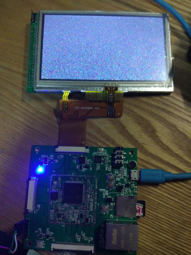

背光配置改为了 PB9, LCD改为 4.3寸到 480x272, 跑起来了.
