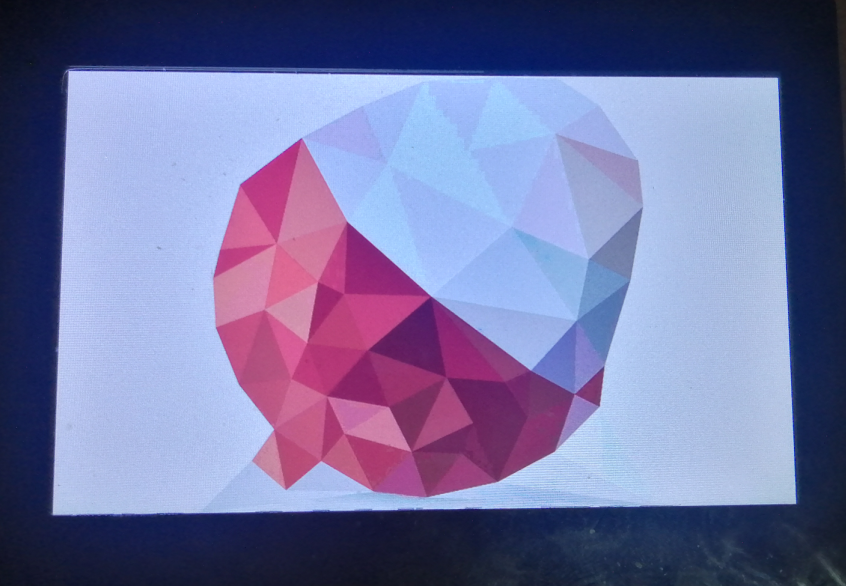

logo图片过大导致uboot编译出错的问题
报错
binman: Node '/binman/u-boot-img': Entry contents size is 0xa6fb1 (683953) but entry size is 0x76000 (483328)
Makefile:1148: recipe for target 'u-boot-sunxi-with-spl.bin' failed
make: *** [u-boot-sunxi-with-spl.bin] Error 1
解决
make ARCH=arm menuconfig
Environment  --->
      Select the location of the environment (Environment in an MMC│
      (0xf0000) Environment Offset
      (0x8000) Environment Size

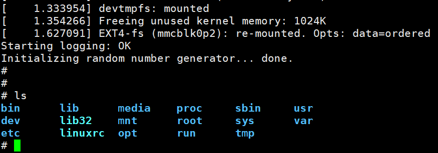

结果
  COPY    spl/u-boot-spl.bin
  MKSUNXI spl/sunxi-spl.bin
  BINMAN  u-boot-sunxi-with-spl.bin
正常
