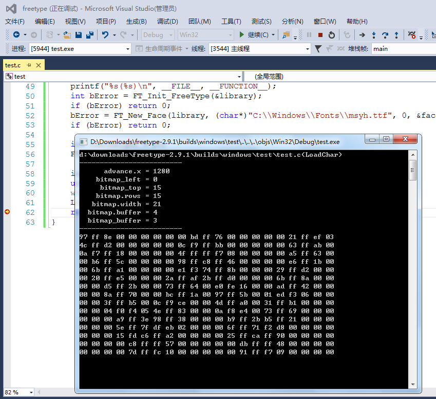

参考网上例程,做了一个用libfreetype解析微软雅黑msyh.ttf文件的demo

W输出:
hexing@ubuntu:/tmp$ ./test
test.c(main)
test.c(LoadChar)
      advance.x = 1280
    bitmap_left = 0
     bitmap_top = 15
    bitmap.rows = 15
   bitmap.width = 20
  bitmap.buffer = 8
  bitmap_buffer = 3
de ff 1f 00 00 00 00 00 29 ff ff 29 00 00 00 00 00 1e ff dd
9a ff 5d 00 00 00 00 00 7a ff ff 7b 00 00 00 00 00 5b ff 99
56 ff 9b 00 00 00 00 00 cc ff ff cd 00 00 00 00 00 98 ff 55
13 fd d9 00 00 00 00 1e ff e3 e7 ff 1f 00 00 00 00 d5 fd 12
00 cd ff 18 00 00 00 6f ff a6 af ff 71 00 00 00 13 fe cc 00
00 89 ff 56 00 00 00 c0 ff 50 5a ff c3 00 00 00 4e ff 88 00
00 45 ff 94 00 00 15 fc f0 07 0b f4 fd 17 00 00 8b ff 44 00
00 08 f7 d2 00 00 63 ff 9e 00 00 a5 ff 67 00 00 c8 f7 08 00
00 00 bc fe 12 00 b5 ff 44 00 00 4b ff b9 00 0a fa bb 00 00
00 00 78 ff 4f 0d f8 e7 03 00 00 05 ec fa 10 42 ff 77 00 00
00 00 34 ff 8d 58 ff 91 00 00 00 00 97 ff 5e 7e ff 33 00 00
00 00 02 ed c7 a7 ff 38 00 00 00 00 3c ff ae b9 ec 02 00 00
00 00 00 ab ee e9 de 00 00 00 00 00 01 e0 ea e9 aa 00 00 00
00 00 00 67 ff ff 85 00 00 00 00 00 00 88 ff ff 66 00 00 00
00 00 00 22 ff ff 2c 00 00 00 00 00 00 2d ff ff 22 00 00 00

@晕哥,你这个demo有两个问题请教:
1、FT_Set_Pixel_Sizes(face, textHeight, 0); 这里应该是笔误哈,textHeight和0这两个参数位置要互换?
2、设置的像素高度为20px,但为什么字模点阵里面只有16行的高呢?
是不是freetype有特殊处理,只获取了字的完全高度?如果我想把转换为20px的点阵,有接口支持么?谢谢。

这生成的点阵数据和16位置是什么对应关系?
按照这个数据描点,文字有毛刺

楼主 #11 2019-12-16 13:44:26
已发帖子: 9,517
Re: 参考网上例程,做了一个用libfreetype解析微软雅黑msyh.ttf文件的demo
tianjjff wrote:
晕哥,请教下,Makefile不是很懂,这两个是什么作用'freetype-config --cflags freetype-config --libs`
用来生成这个命令行: gcc -o test test.c freetype-config --cflags freetype-config --libs
