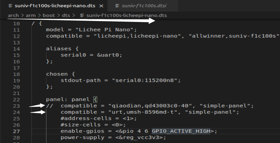

荔枝派nano/全志F1C100S/F1C200S内核添加对800*480屏幕的支持
linux-nano-5.2-tf内核中默认的是480*272显示屏
修改设备树加入800*480显示屏配置
	//	compatible = "qiaodian,qd43003c0-40", "simple-panel";
		compatible = "urt,umsh-8596md-t", "simple-panel";
