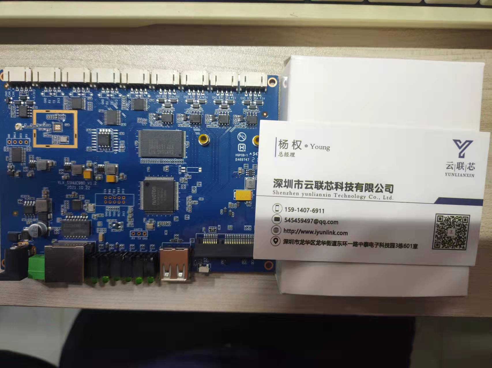

非常感谢这次的活动,今天下班收到板子,晚上迫不及待开箱来点个灯,先来张全家福
这次玩点跟官方不一样的,都啥年代了还不用设备树(ps:主要自己只会用设备树,请轻点喷~)
先来上个心跳灯~

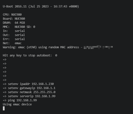

启动信息:
NUC980 IBR 20180813
Boot from NAND
DDR-OK
NAND boot!D dow#S
U-Boot 2016.11 (Dec 15 2021 - 22:25:13 +0800)
CPU: NUC980
Board: NUC980
DRAM:  64 MiB
NAND:  128 MiB
In:    serial
Out:   serial
Err:   serial
Net:   emac
Using emac device
TFTP from server 192.168.60.239; our IP address is 192.168.60.238
Filename '980uimage'.
Load address: 0x7fc0
Loading: #################################################################
         1015.6 KiB/s
done
Bytes transferred = 3046936 (2e7e18 hex)
Using emac device
Filename 'nuc980.dtb'.
Load address: 0x407fc0
Loading: ###
         985.4 KiB/s
done
Bytes transferred = 30275 (7643 hex)
## Booting kernel from Legacy Image at 00007fc0 ...
   Image Name:   Linux-4.4.207
   Data Size:    3046872 Bytes = 2.9 MiB
   Load Address: 00008000
   Entry Point:  00008000
   Verifying Checksum ... OK
## Flattened Device Tree blob at 00407fc0
   Booting using the fdt blob at 0x407fc0
   XIP Kernel Image ... OK
   Loading Device Tree to 03e82000, end 03e8c642 ... OK
Starting kernel ...goto kernel

请问nuc980的uboot 以太网正常使用吗?我的按照文档开启了以太网无法使用,网上找到资料说是980的uboot网络部分又有BUG
#10 2023-07-25 16:55:32
codemomo
注册时间: 2020-03-02
Re: 云联芯NUC980设备树折腾-从点灯开始
登云钓月 说:
好像是有点问题,我这边uboot配好了,一ping就挂掉了,用dhcp也会挂掉,就离谱。我用的emac1,之前配成emac0还给我报error,绝了。
