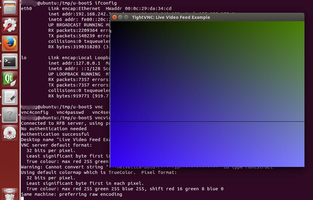

ubuntu 编译运行 libvncserver
  1. sudo apt-get install libtool
  2. sudo apt-get install vncviewer
  3. wget https://github.com/LibVNC/libvncserver/archive/LibVNCServer-0.9.11.tar.gz
    tar xvf LibVNCServer-0.9.11.tar.gz
    cd LibVNCServer-0.9.11
    ./autogen.sh
    ./configure
    make
    cd examples
    ./camera
  4. vncviewer localhost

楼主 #2 2018-02-15 12:38:14
落雁
已发帖子: 62
积分: 62
Re: ubuntu 编译运行 libvncserver
短短几行代码就可以构建一个简单的 vnc 服务端程序:
https://libvnc.github.io/
#include <rfb/rfb.h>
int main(int argc,char** argv)
  rfbScreenInfoPtr server=rfbGetScreen(&argc,argv,400,300,8,3,4);
  server->frameBuffer=malloc(400*300*4);
  rfbInitServer(server);
  rfbRunEventLoop(server,-1,FALSE);
  return(0);

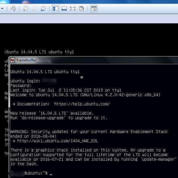

#5 2019-08-24 11:38:44
firstman
注册时间: 2019-04-06
已发帖子: 279
积分: 279
https://github.com/ponty/framebuffer-vncserver
我现在用这个 demo 在 ubuntu 跑起来 demo
但是不能输入:
firstman@ubuntu:/opt/framebuffer-vncserver/build$ sudo ./framebuffer-vncserver
Initializing framebuffer device /dev/fb0...
  xres=800, yres=600, xresv=2048, yresv=1920, xoffs=0, yoffs=0, bpp=32
  offset:length red=16:8 green=8:8 blue=0:8
No touch device
Initializing VNC server:
	width:  800
	height: 600
	bpp:    32
	port:   5900
Initializing server...
24/08/2019 11:08:40 Listening for VNC connections on TCP port 5900
24/08/2019 11:08:40 Listening for VNC connections on TCP6 port 5900
24/08/2019 11:16:22 Got connection from client 192.168.1.189
24/08/2019 11:16:22   other clients:
24/08/2019 11:16:22 Normal socket connection
24/08/2019 11:16:22 Client Protocol Version 3.3
24/08/2019 11:16:22 Protocol version sent 3.3, using 3.3
24/08/2019 11:16:23 Pixel format for client 192.168.1.189:
24/08/2019 11:16:23   32 bpp, depth 32, little endian
24/08/2019 11:16:23   true colour: max r 31 g 31 b 31, shift r 0 g 5 b 10
24/08/2019 11:16:23 no translation needed
24/08/2019 11:16:23 rfbProcessClientNormalMessage: ignoring unsupported encoding type Enc(0x00000003)
24/08/2019 11:16:23 Using hextile encoding for client 192.168.1.189
请问楼主, No touch device 如何解决?
代码在这里: https://github.com/ponty/framebuffer-vncserver/blob/master/src/framebuffer-vncserver.c
