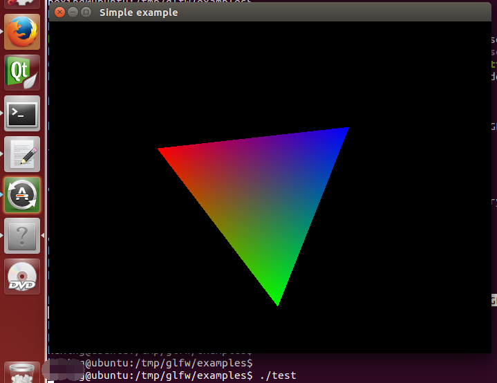

楼主 #1 2018-02-18 22:00:03
编译glfw 的演示程序试一试
http://www.glfw.org/docs/latest/quick.html

执行:

参考这里:
https://whycan.cn/t_764.html#p2949
sudo apt-get install cmake
cd /tmp
git clone https://github.com/glfw/glfw.git
cd glfw
cmake CMakeLists.txt
make
sudo make install
把上面的代码拷到 glfw/examples目录
执行编译指令:
gcc -o test test.c -lglfw3 -lGLEW -lGL -lX11 -lXi -lXrandr -lXxf86vm -lXinerama -lXcursor -lrt -lm -pthread -ldl -I../deps/ ../deps/glad.c
运行结果:
