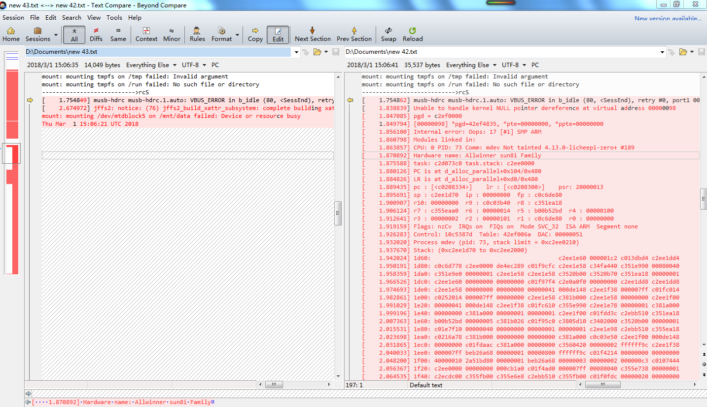

焊了一块 V3s的板子, Linux启动有时候会出现这个问题, 板子应该没什么问题,机焊4片正常的。

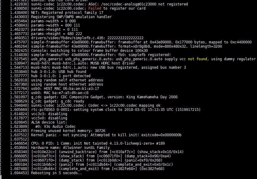

楼主 #2 2018-02-28 18:02:27
F1F2
注册时间: 2017-09-11
已发帖子: 99
积分: 99
Re: 焊了一块 V3s的板子, Linux启动有时候会出现这个问题, 板子应该没什么问题,机焊4片正常的。
上面是开机就这样的。
下面这个是用着用着就挂:
[  399.566106] Unable to handle kernel NULL pointer dereference at virtual address 00000100

楼主 #4 2018-03-01 16:10:36
F1F2
注册时间: 2017-09-11
已发帖子: 99
积分: 99
mount: mounting tmpfs on /dev/shm failed: Invalid argument
mount: mounting tmpfs on /tmp failed: Invalid argument
mount: mounting tmpfs on /run failed: No such file or directory
--------------------------->rcS
[    1.764843] musb-hdrc musb-hdrc.1.auto: VBUS_ERROR in b_idle (80, <SessEnd), retry #0, port1 00000100
[    1.948796] Unable to handle kernel NULL pointer dereference at virtual address 000000d0
[    1.957049] pgd = c2ef0000
[    1.959756] [000000d0] *pgd=42ee2835, *pte=00000000, *ppte=00000000
[    1.966062] Internal error: Oops: 17 [#1] SMP ARM
[    1.970761] Modules linked in:
[    1.973820] CPU: 0 PID: 73 Comm: mdev Not tainted 4.13.0-licheepi-zero+ #189
[    1.980856] Hardware name: Allwinner sun8i Family
[    1.985553] task: c2d06840 task.stack: c2edc000
[    1.990090] PC is at lockref_get+0x8/0xa0
[    1.994101] LR is at d_splice_alias+0x184/0x40c
[    1.998623] pc : [<c030ee14>]    lr : [<c0206aa0>]    psr: 20000013
[    2.004879] sp : c2eddd88  ip : c0c02b60  fp : 00000000
[    2.010095] r10: 00000000  r9 : c2edde60  r8 : 000000d0
[    2.015312] r7 : c35e9c38  r6 : 00000100  r5 : c35ebb00  r4 : c35e9d48
[    2.021829] r3 : 00000100  r2 : 00000002  r1 : 00000000  r0 : 000000d0
[    2.028347] Flags: nzCv  IRQs on  FIQs on  Mode SVC_32  ISA ARM  Segment none
[    2.035471] Control: 10c5387d  Table: 42ef006a  DAC: 00000051
[    2.041207] Process mdev (pid: 73, stack limit = 0xc2edc210)
[    2.046858] Stack: (0xc2eddd88 to 0xc2ede000)
[    2.051213] dd80:                   c35e9d48 c35ebb00 00000100 c35e9c38 00000080 c0206aa0
[    2.059381] dda0: 00000002 c35e9d48 c2df6b90 c35eb840 c35e9c38 00000001 c2edde60 c02501cc
[    2.067548] ddc0: c35e9d48 c35eb840 c35eb8b0 c01f9824 c2df6a50 00000000 c2edddd8 c2edddd8
[    2.075716] dde0: c2edde58 00000000 00000000 00000041 000db420 c2eddf38 000007ff c01fc014
[    2.083883] de00: 00000000 c2edde58 0000002f c2edde58 c381a010 c2edde58 00000000 c2eddf00
[    2.092050] de20: 00000041 000db420 c2eddf38 c01fc610 c2eddf10 c01f8e60 00000000 c381a000
[    2.100218] de40: 00000000 c381a000 00000001 00000001 c2eddf00 c01fdd3c c2ebb510 c35e9c38
[    2.108385] de60: 608b2289 00000005 c381a024 c2ebeb40 c3805d10 c3402000 c35eb840 00000001
[    2.116552] de80: c0252180 00000040 00000000 00000000 00000001 c2edde98 c2ebb510 c35e9bb0
[    2.124719] dea0: c0216a78 c381b000 c381a024 2f737973 c381a000 c0c03e50 c2eddf00 000db420
[    2.132887] dec0: 00000000 c01fdaac c381a000 00000000 c35eb6e0 00000002 ffffff9c c2eddf38
[    2.141054] dee0: 000007ff beab79c0 00000001 00000800 ffffff9c c01f4214 00000000 2e7ddb00
[    2.149222] df00: 00000383 00000000 00000000 beab79c0 00000003 00000003 000000c3 c0107444
[    2.157389] df20: c2edc000 00000000 000d31c0 c01f4ad0 000007ff 00000000 000007ff 000041ed
[    2.165556] df40: 00000002 00001000 00000000 00000000 00000000 00000000 00000383 00000000
[    2.173723] df60: 0000000e 00000000 00000000 00000000 00000000 00000000 00000001 2e7ddb00
[    2.181890] df80: 00000001 2e7ddb00 00000001 2e7ddb00 00000000 00000000 00000000 00000000
[    2.190057] dfa0: 000db420 c0107280 000db420 00000003 000db420 beab79c0 beab79c0 00096924
[    2.198224] dfc0: 000db420 00000003 00000003 000000c3 00000001 0004fdd0 00050be0 000d31c0
[    2.206391] dfe0: 000c1620 beab79a0 000906d8 b6ee4460 20000010 000db420 00000000 00000000
[    2.214579] [<c030ee14>] (lockref_get) from [<c0206aa0>] (d_splice_alias+0x184/0x40c)
[    2.222409] [<c0206aa0>] (d_splice_alias) from [<c02501cc>] (kernfs_iop_lookup+0x84/0xa4)
[    2.230585] [<c02501cc>] (kernfs_iop_lookup) from [<c01f9824>] (lookup_slow+0x84/0x140)
[    2.238583] [<c01f9824>] (lookup_slow) from [<c01fc014>] (walk_component+0x1c4/0x294)
[    2.246404] [<c01fc014>] (walk_component) from [<c01fc610>] (path_lookupat+0x60/0x1ec)
[    2.254312] [<c01fc610>] (path_lookupat) from [<c01fdd3c>] (filename_lookup+0x8c/0xe8)
[    2.262222] [<c01fdd3c>] (filename_lookup) from [<c01f4214>] (vfs_statx+0x5c/0xb0)
[    2.269786] [<c01f4214>] (vfs_statx) from [<c01f4ad0>] (SyS_stat64+0x28/0x44)
[    2.276919] [<c01f4ad0>] (SyS_stat64) from [<c0107280>] (ret_fast_syscall+0x0/0x3c)
[    2.284568] Code: e3e00000 eafffff1 e92d41f0 e1a08000 (e1c020d0)
[    2.290702] ---[ end trace 608badd80a3d5ab1 ]---
Segmentation fault
感觉应该是硬件问题,
把 CPU旁边的1.2V和1.8V都焊上电容,
还是没什么卵用,
把V3s重新拖焊一下也是如此,不过概率小很多了。
楼主 #5 2018-03-01 17:13:05
F1F2
注册时间: 2017-09-11
已发帖子: 99
积分: 99
板子只改了一点重新做了一次板子, 基本没改过V3s附件元器件,
奇怪旧版4片板子都没这个问题,
刚刚试过了, 连续50次重启旧板都正常。
楼主 #6 2018-03-01 17:17:52
F1F2
注册时间: 2017-09-11
已发帖子: 99
积分: 99

[    0.237243] io scheduler noop registered
[    0.237253] io scheduler deadline registered
[    0.237508] io scheduler cfq registered (default)
[    0.237521] io scheduler mq-deadline registered
[    0.237528] io scheduler kyber registered
[    0.241844] sun8i-v3s-pinctrl 1c20800.pinctrl: initialized sunXi PIO driver
[    0.308822] Serial: 8250/16550 driver, 8 ports, IRQ sharing disabled
[    0.312108] console [ttyS0] disabled
[    0.332379] 1c28000.serial: ttyS0 at MMIO 0x1c28000 (irq = 33, base_baud = 1500000) is a U6_16550A
[    1.170835] console [ttyS0] enabled
[    1.195915] 1c28400.serial: ttyS1 at MMIO 0x1c28400 (irq = 34, base_baud = 1500000) is a U6_16550A
[    1.226393] 1c28800.serial: ttyS2 at MMIO 0x1c28800 (irq = 35, base_baud = 1500000) is a U6_16550A
[    1.239324] m25p80 spi32766.0: mx25l25635e (32768 Kbytes)
[    1.244759] 6 cmdlinepart partitions found on MTD device spi32766.0
[    1.251137] Creating 6 MTD partitions on "spi32766.0":
[    1.256308] 0x000000000000-0x0000000f0000 : "uboot"
[    1.262617] 0x0000000f0000-0x000000100000 : "dtb"
[    1.268620] 0x000000100000-0x000000180000 : "background"
[    1.275237] 0x000000180000-0x000000300000 : "animation"
[    1.281671] 0x000000300000-0x000000c00000 : "kernel"
[    1.287985] 0x000000c00000-0x000002000000 : "appendfs"
[    1.294579] libphy: Fixed MDIO Bus: probed
[    1.299310] dwmac-sun8i 1c30000.ethernet: PTP uses main clock
[    1.305187] dwmac-sun8i 1c30000.ethernet: No regulator found
[    1.310896] dwmac-sun8i 1c30000.ethernet: Will use internal PHY
[    1.316938] dwmac-sun8i 1c30000.ethernet: Current syscon value is not the default 148000 (expect 38000)
[    1.326512] dwmac-sun8i 1c30000.ethernet: Chain mode enabled
[    1.332170] dwmac-sun8i 1c30000.ethernet: No HW DMA feature register supported
[    1.339409] dwmac-sun8i 1c30000.ethernet: Normal descriptors
[    1.345063] dwmac-sun8i 1c30000.ethernet: RX Checksum Offload Engine supported
[    1.352289] dwmac-sun8i 1c30000.ethernet: COE Type 2
[    1.357260] dwmac-sun8i 1c30000.ethernet: TX Checksum insertion supported
[    1.364240] libphy: stmmac: probed
[    1.373396] ehci_hcd: USB 2.0 'Enhanced' Host Controller (EHCI) Driver
[    1.380072] ehci-platform: EHCI generic platform driver
[    1.385624] ehci-platform 1c1a000.usb: EHCI Host Controller
[    1.391241] ehci-platform 1c1a000.usb: new USB bus registered, assigned bus number 1
[    1.399215] ehci-platform 1c1a000.usb: irq 25, io mem 0x01c1a000
[    1.435132] ehci-platform 1c1a000.usb: USB 2.0 started, EHCI 1.00
[    1.442306] hub 1-0:1.0: USB hub found
[    1.446251] hub 1-0:1.0: 1 port detected
[    1.450726] ohci_hcd: USB 1.1 'Open' Host Controller (OHCI) Driver
[    1.457028] ohci-platform: OHCI generic platform driver
[    1.462582] ohci-platform 1c1a400.usb: Generic Platform OHCI controller
[    1.469310] ohci-platform 1c1a400.usb: new USB bus registered, assigned bus number 2
[    1.477262] ohci-platform 1c1a400.usb: irq 26, io mem 0x01c1a400
[    1.550185] hub 2-0:1.0: USB hub found
[    1.554012] hub 2-0:1.0: 1 port detected
[    1.561244] usbcore: registered new interface driver usb-storage
[    1.567903] udc-core: couldn't find an available UDC - added [g_cdc] to list of pending drivers
[    1.577450] input: 1c22800.lradc as /devices/platform/soc/1c22800.lradc/input/input0
[    1.586007] i2c /dev entries driver
[    1.590876] input: ns2009_ts as /devices/platform/soc/1c2ac00.i2c/i2c-0/0-0048/input/input1
[    1.601849] rtc-pcf8563 0-0051: low voltage detected, date/time is not reliable.
[    1.609563] rtc-pcf8563 0-0051: rtc core: registered rtc-pcf8563 as rtc0
[    1.617959] sunxi-wdt 1c20ca0.watchdog: Watchdog enabled (timeout=16 sec, nowayout=0)
[    1.685165] sunxi-mmc 1c0f000.mmc: base:0xc4255000 irq:23
[    1.691658] usbcore: registered new interface driver usbhid
[    1.697320] usbhid: USB HID core driver
[    1.702818] sun4i-codec 1c22c00.codec: ASoC: /soc/codec-analog@01c23000 not registered
[    1.710865] sun4i-codec 1c22c00.codec: Failed to register our card
[    1.718377] NET: Registered protocol family 17
[    1.722979] Registering SWP/SWPB emulation handler
[    1.735497] params->width = 0 000
[    1.738875] params->width = 800 111
[    1.742359] params->height = 0 111
[    1.745834] params->height = 480 222
[    1.749414] drivers/video/fbdev/simplefb.c.436: 22222222222222222
[    1.755757] simple-framebuffer 43e89000.framebuffer: framebuffer at 0x43e89000, 0x177000 bytes, mapped to 0xc4400000
[    1.766312] simple-framebuffer 43e89000.framebuffer: format=x8r8g8b8, mode=800x480x32, linelength=3200
[    1.782463] Console: switching to colour frame buffer device 100x30
[    1.794868] simple-framebuffer 43e89000.framebuffer: fb0: simplefb registered!
[    1.807539] usb_phy_generic usb_phy_generic.0.auto: usb_phy_generic.0.auto supply vcc not found, using dummy regulator
[    1.818897] musb-hdrc musb-hdrc.1.auto: MUSB HDRC host driver
[    1.824665] musb-hdrc musb-hdrc.1.auto: new USB bus registered, assigned bus number 3
[    1.833740] hub 3-0:1.0: USB hub found
[    1.837713] hub 3-0:1.0: 1 port detected
[    1.842758] using random self ethernet address
[    1.847315] using random host ethernet address
[    1.852781] usb0: HOST MAC 32:a8:ae:be:0d:76
[    1.857205] usb0: MAC fa:ed:c9:39:1a:2d
[    1.861100] g_cdc gadget: CDC Composite Gadget, version: King Kamehameha Day 2008
[    1.868624] g_cdc gadget: g_cdc ready
[    1.874861] sun4i-codec 1c22c00.codec: Codec <-> 1c22c00.codec mapping ok
[    1.885713] rtc-pcf8563 0-0051: low voltage detected, date/time is not reliable.
[    1.893121] rtc-pcf8563 0-0051: hctosys: unable to read the hardware clock
[    1.900784] vcc3v3: disabling
[    1.903765] vcc5v0: disabling
[    1.906774] ALSA device list:
[    1.909741]   #0: V3s Audio Codec
[    1.917234] Freeing unused kernel memory: 3072K
mknod: /dev/console: File exists
mknod: /dev/ttyS0: File exists
mknod: /dev/null: File exists
create directory: /dev /proc /sys /sbin /root /tmp /run /dev/shm
mknod: /dev/console, /dev/ttyS0, /dev/null
exec /sbin/init
有时候会这样, 不知道什么鬼,看起来vfs有问题,
但是应用也能正常使用
最近编辑记录 F1F2 (2018-03-01 17:19:26)
